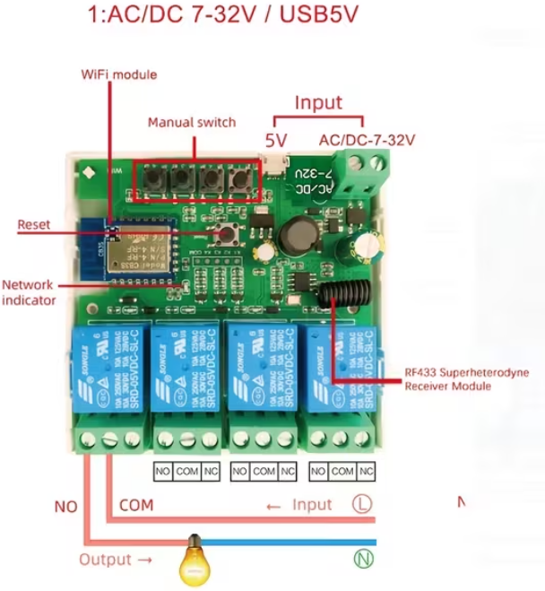

#1 21889088 23 Apr 2026 00:48 DennyWells DennyWells Level 1 Posts: 1 Topic author Post #1 21889088 23 Apr 2026 00:48 tuya 4-way Wi-Fi RF remote relay. Anyone have the original Tuya config file for this board? I have reflashed successfully but have lost the original config details.
#2 21889160 23 Apr 2026 08:22 divadiow divadiow Level 38 Posts: 5065 Help: 438 Rate: 893 Helpful post? (0) Post #2 21889160 23 Apr 2026 08:22 https://www.elektroda.com/rtvforum/topic4021221.html https://www.elektroda.com/rtvforum/topic3874289-180.html#20265559 search templates here https://openbekeniot.github.io/webapp/devicesList.html and to extract yours maybe: https://www.elektroda.com/rtvforum/topic4171389.html#21885498
#3 21892984 29 Apr 2026 00:11 p.kaczmarek2 p.kaczmarek2 Moderator Smart Home Posts: 14621 Help: 655 Rate: 12637 Helpful post? (0) Post #3 21892984 29 Apr 2026 00:11 OBK will run fine on it, I think. Here is OBK RF tutorial, now supporting this kind of devices: BK7231 RF receiver driver tutorial - how to use SYN590R or similar to control multiple devices Have you managed to flash it? I am creating multiplatform open source firmware (Tasmota replacement), right now supporting BK7231T, BK7231N, XR809, BL602, W800, W600, LN882H and soon supporting RTL and W701: https://github.com/openshwprojects/OpenBK7231T If you like my work, support me at: https://paypal.me/openshwprojects Helpful post? Buy me a coffee.
