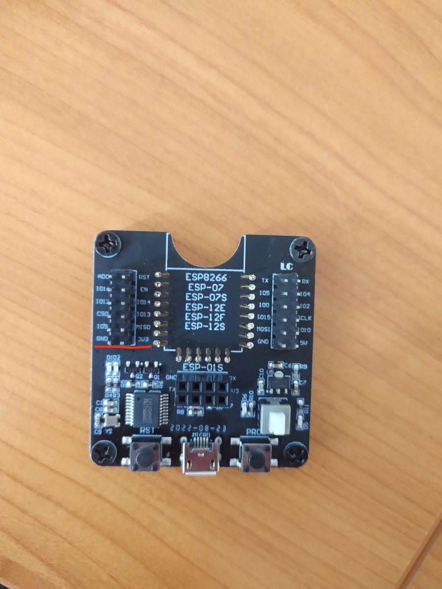

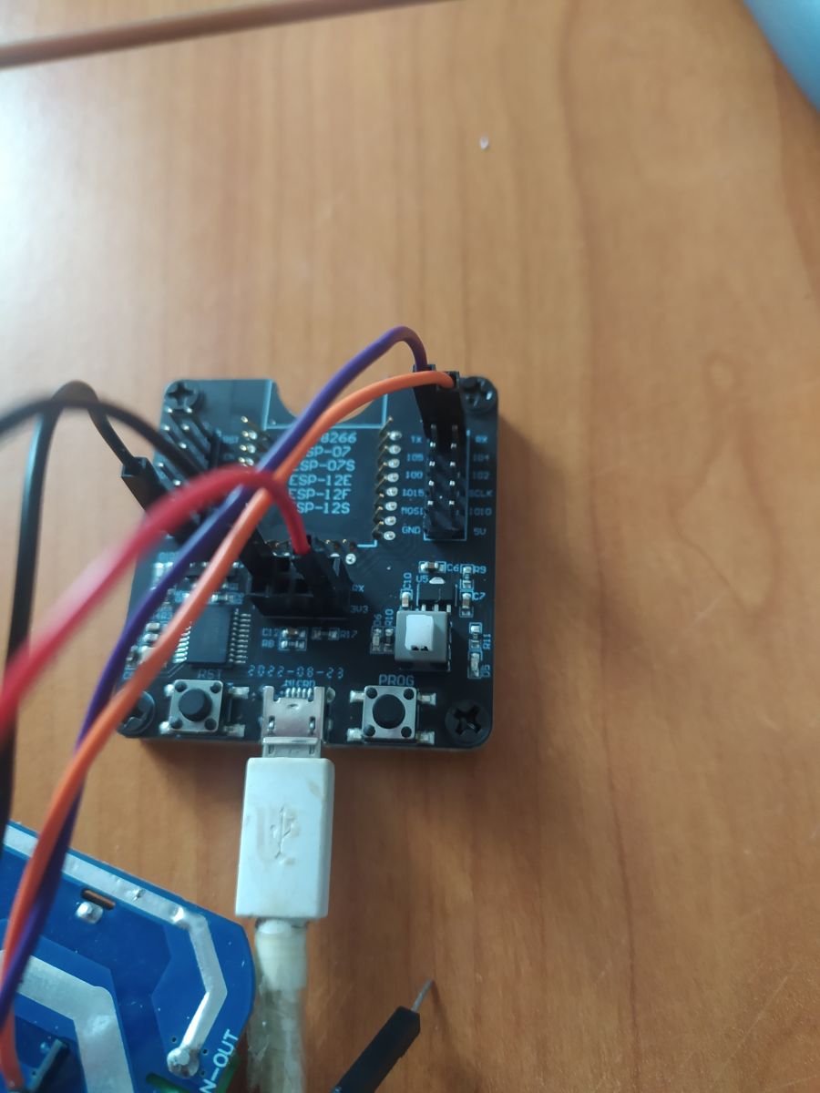

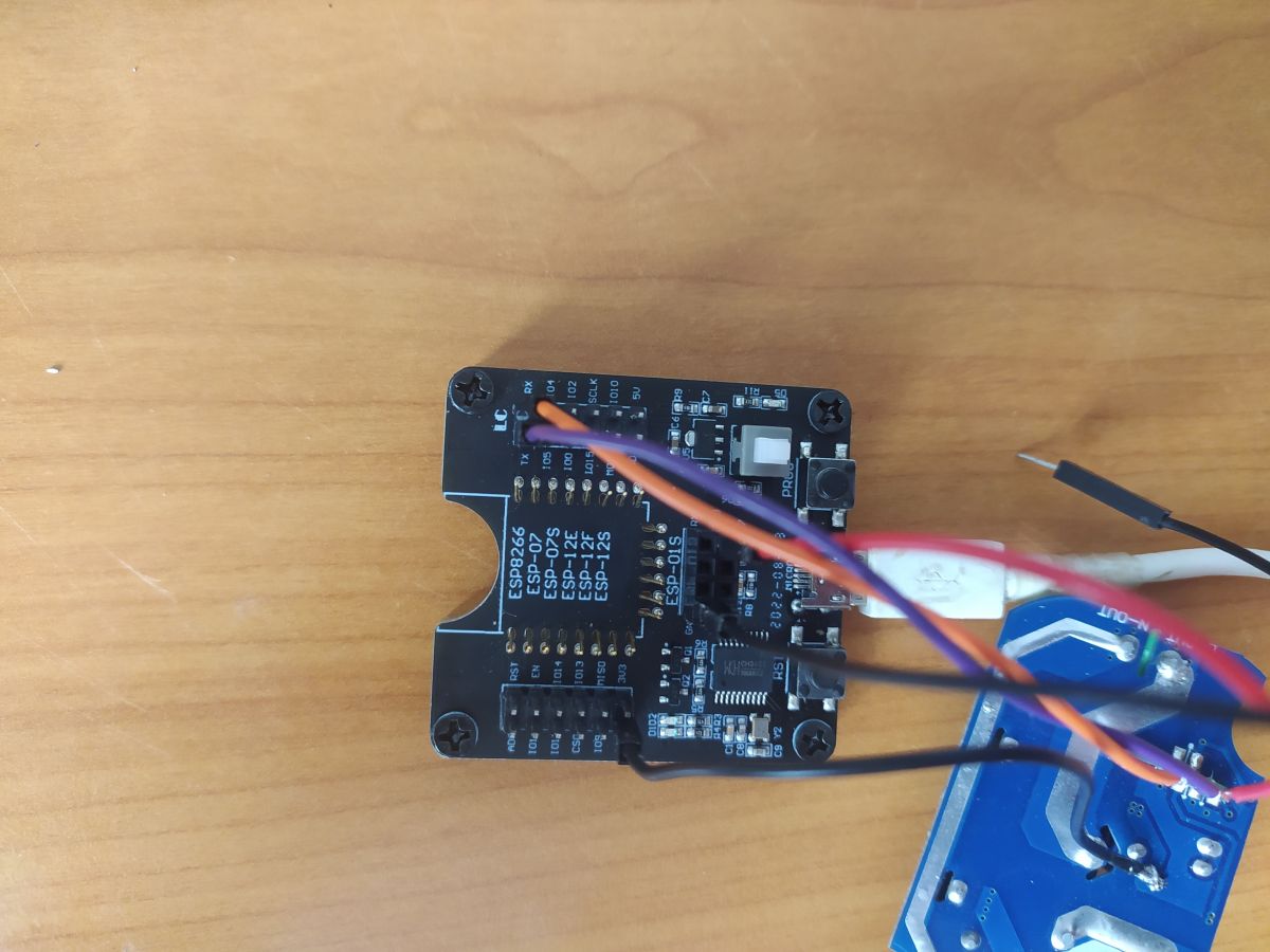

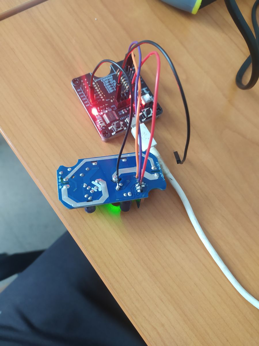

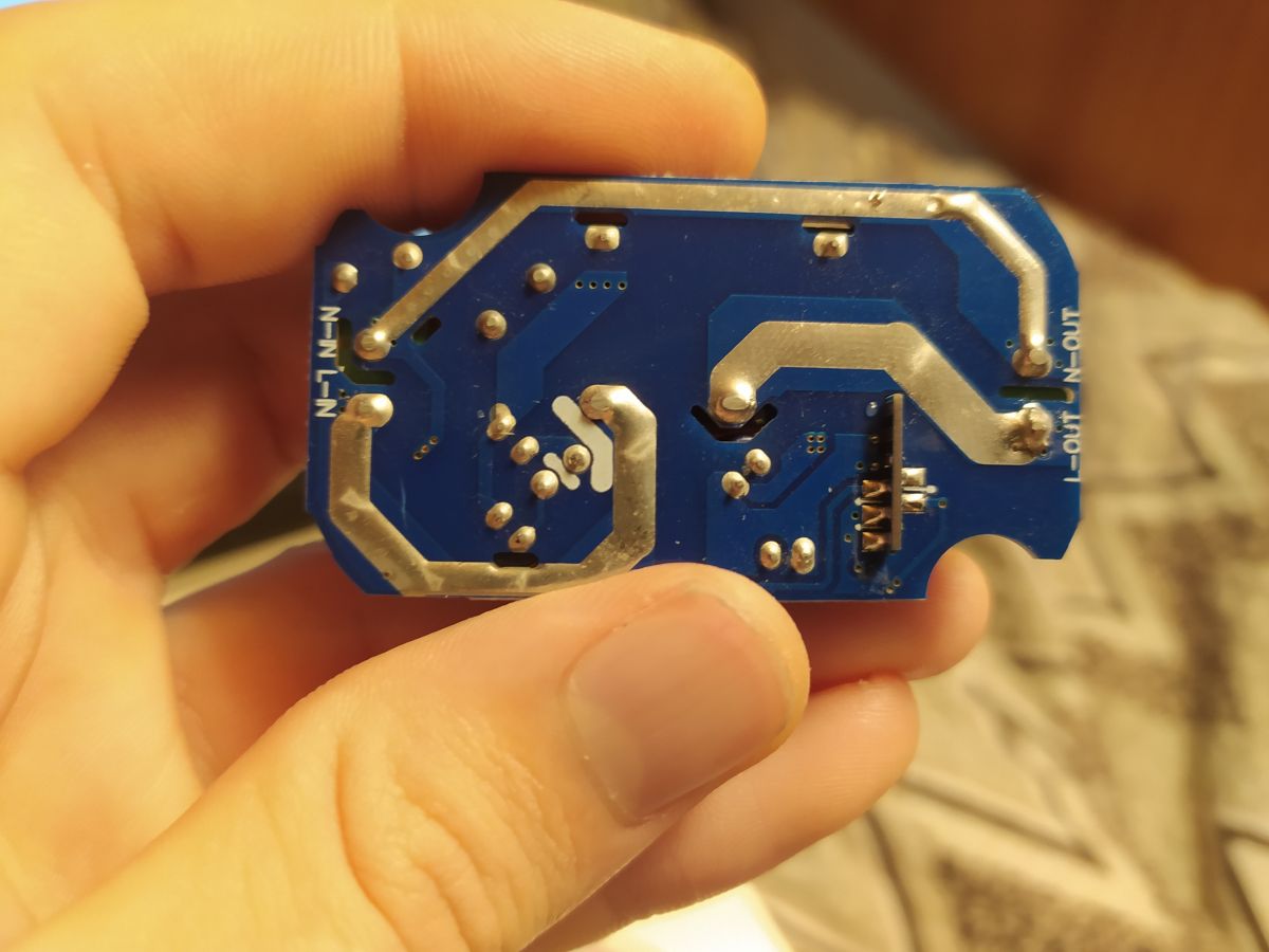

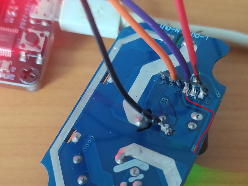

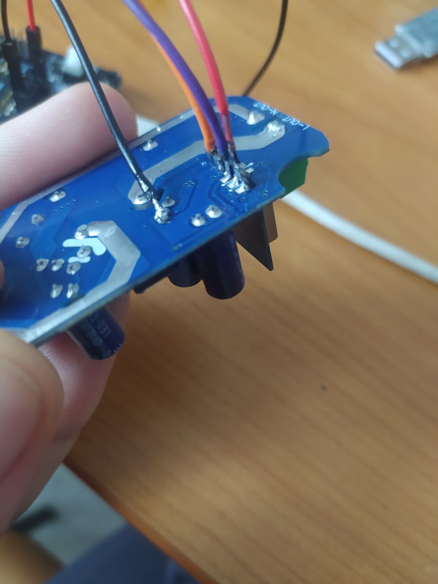

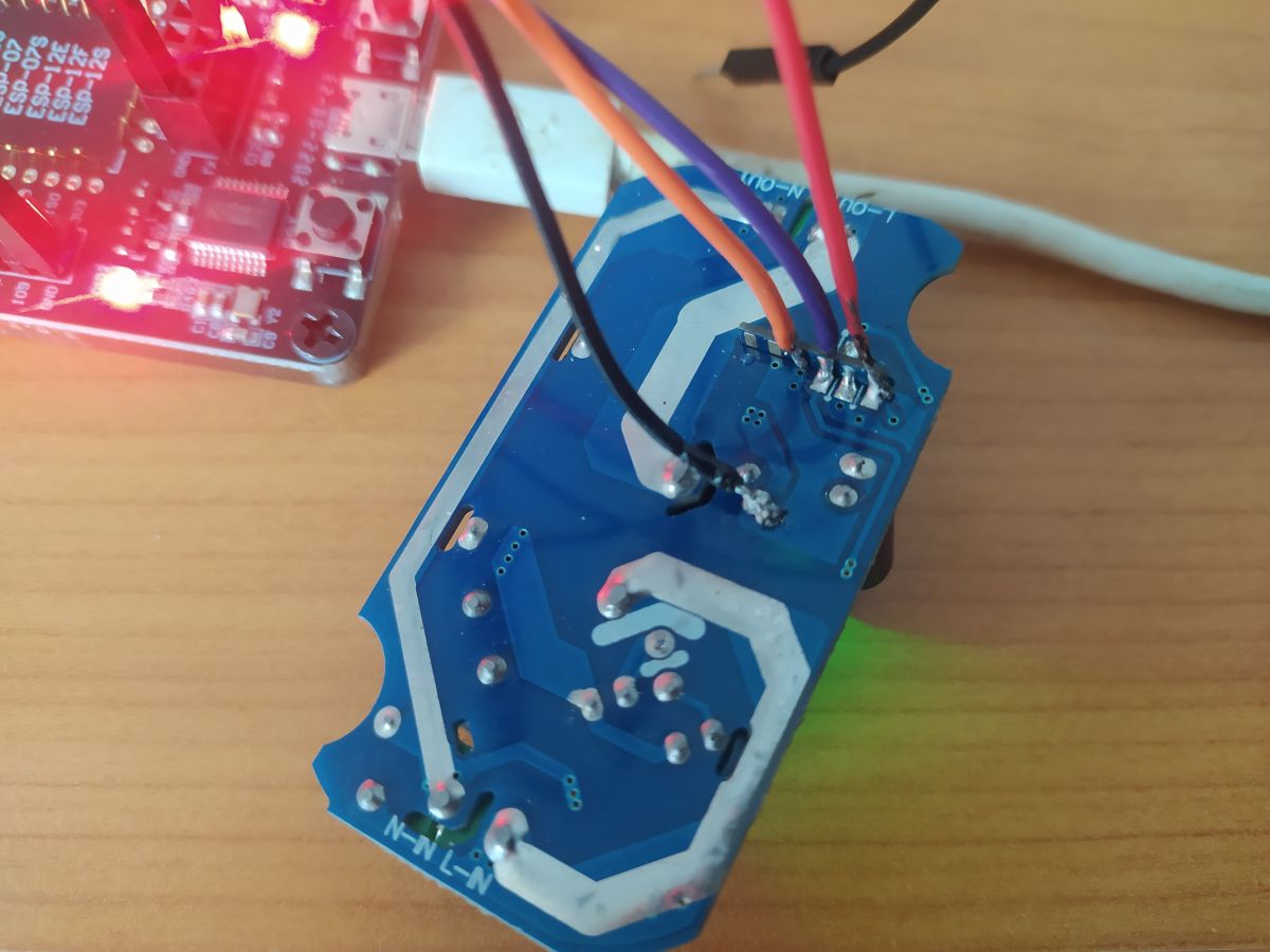

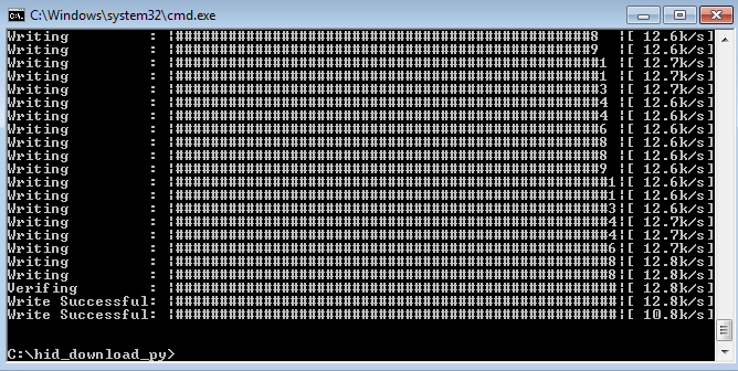

    We perform all connections to the USB adapter from the first post.
    I am using a board to connect the esp-01.
    Qiachip Smart Switch - BK7231N / CB2S - interior, programming20221012_0..117.jpg (103.79 kB)You must be logged in to download this attachment.
    Installing python, for W7 the latest version is 3.8.10
    https://www.python.org/downloads/windows/
    When installing, note Add python 3.5 to PATH.

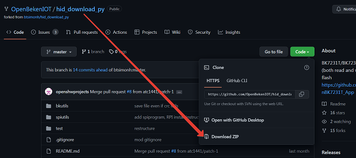

    Next, go to https://github.com/OpenBekenIOT/hid_download_py
    Green "CODE" button, Download ZIP.
    Qiachip Smart Switch - BK7231N / CB2S - interior, programming2022-10-12...-24-25.png (96.38 kB)You must be logged in to download this attachment.
    I moved the archive to the root of the system disk I have, unpacked it, renamed it to hid_download_py, deleting the text "-master".
    There should be no attachments, i.e. by opening C:\hid_download_py there should be files and several folders at once.
    We go to the address https://github.com/openshwprojects/OpenBK7231T_App/releases
    Download the file BK7231N -> UART Flash-> OpenBK7231N_QIO_x.xx.xx.bin
    I created the folder BK7231 in the root of disk E, transferred the downloaded file to it.
    It remains to flash.

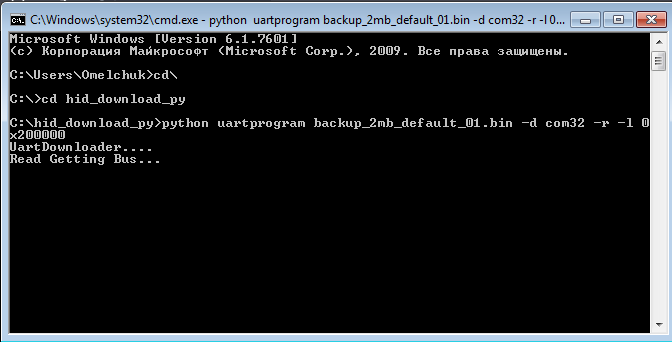

    Running the command line cmd.exe
    Going to the root of the disk: cd\
    I go to the directory with the program: cd hid_download_py
    Qiachip Smart Switch - BK7231N / CB2S - interior, programming2022-10-12...-53-38.png (3.35 kB)You must be logged in to download this attachment.
    By this point, it is already necessary to know which port number the TTL-USB converter has.

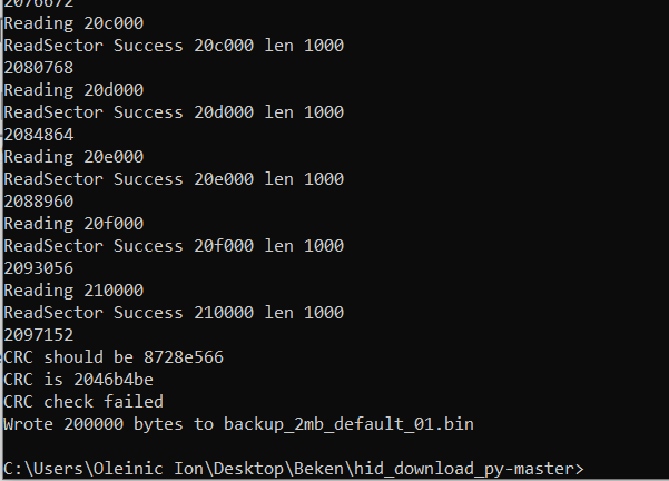

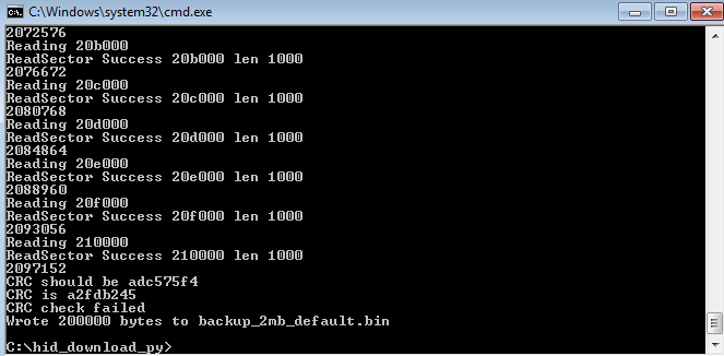

    I read the firmware, I have com-port #32, with the command: python uartprogram backup_2mb_default_01.bin -d com32 -r -l 0x200000
    After pressing "enter", I briefly connect CEN and GND, the firmware is read and the file specified in the command is created in the hid_download_py folder.
    After the inscription Getting BUSY ... we connect CEN and GND for a moment. If nothing has started within two to three seconds, repeat cen + gnd.
    Qiachip Smart Switch - BK7231N / CB2S - interior, programming2022-10-12...-37-57.png (10.3 kB)You must be logged in to download this attachment.
    Qiachip Smart Switch - BK7231N / CB2S - interior, programming2022-10-12...-53-58.png (10.8 kB)You must be logged in to download this attachment.

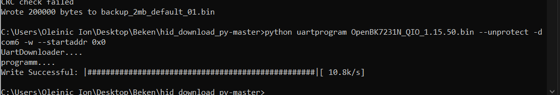

    After reading, we load the necessary file with the command: python uartprogram E:\BK7231\OpenBK7231N_QIO_1.12.103.bin --unprotect -d com32 -w --startaddr 0x0
    where E:\BK7231\OpenBK7231N_QIO_1.12.103.bin the path to the file and its name.
    the procedure is the same as when reading.
    Qiachip Smart Switch - BK7231N / CB2S - interior, programming2022-10-12...-58-17.png (12.97 kB)You must be logged in to download this attachment.

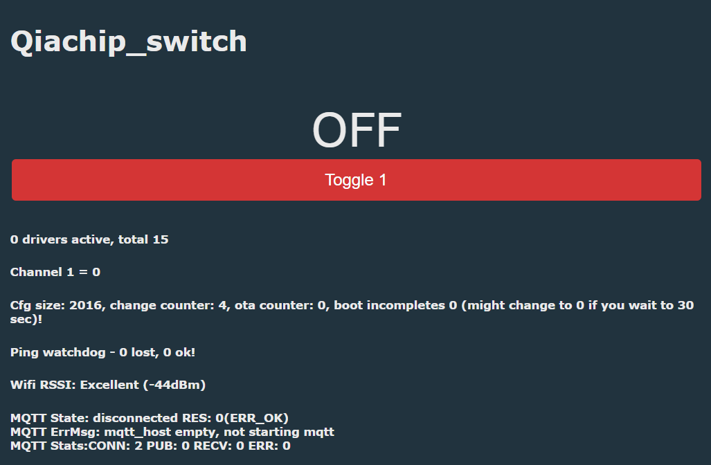

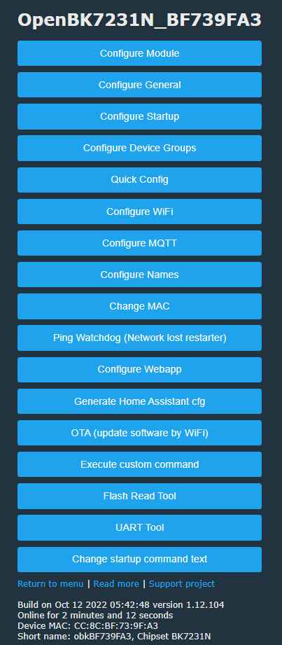

    Let's move on to testing...
    Qiachip Smart Switch - BK7231N / CB2S - interior, programming2022-10-12...-06-04.png (21.86 kB)You must be logged in to download this attachment.

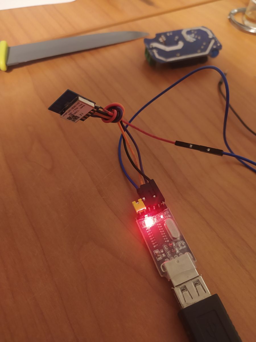

  • CH340G power still fails to flash firmware
    #183 20234827
    kajarit
    Posts: 14
    kajarit wrote:
    Ah ok @kajarit , I mistaken your post with @gowthaml

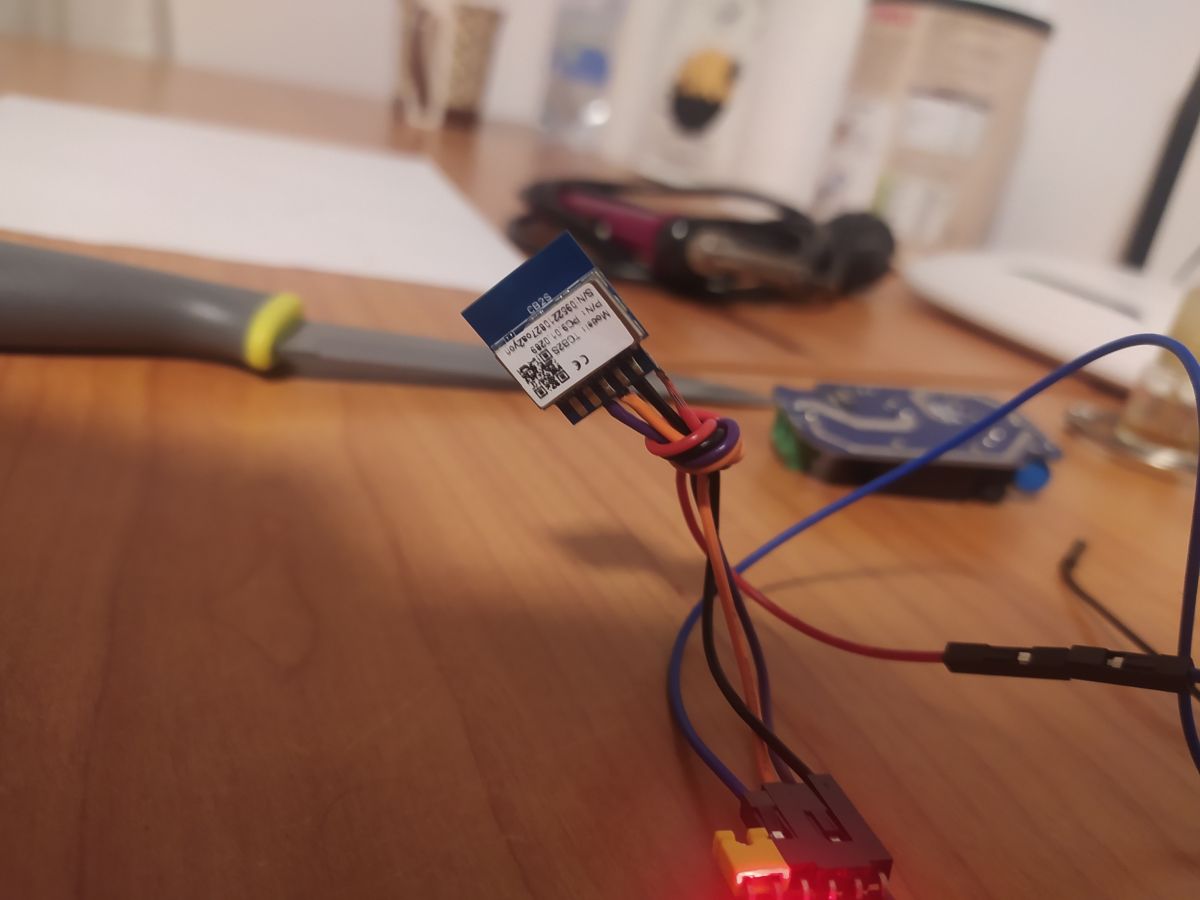

    Maybe your UART to USB converter has not enough current capability? Can you show photos? Have you tried powering it from external LDO 3.3V?
    Powering it through the "golden" CH340G which is - in theory - able to provide 150mA according to specs.
    Qiachip Smart Switch - BK7231N / CB2S - interior, programming Qiachip Smart Switch - BK7231N / CB2S - interior, programming
    Still no success, I'm trying to debug the code to find some clue why it can't write the firmware...

    #185 20236155
    kajarit
    Posts: 14
    gowthaml wrote:
    @kajarit While flashing firmware you need to ground the RST pin of cb3s and when flashing tool waiting for device for flashing you need to remove the ground of the RST pin it will start flashing.
    Sure, I do it that way, so it starts with:
    UartDownloader....
    programm....
    Getting Bus...
    Then I connect GND to CEN (3), then it continues:
    Gotten Bus...
    Erasing
    Writing
    WriteSector 1 Failed
    Any other ideas?

    Backup FW
    This is working, however I was told to ignore the CRC check error message at the end.
    python3 uartprogram backup_2mb_default.bin -d /dev/tty.usbserial-1420 -r -l 0x200000 -b 115200
    Upload FW

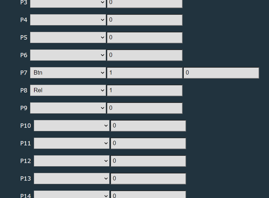

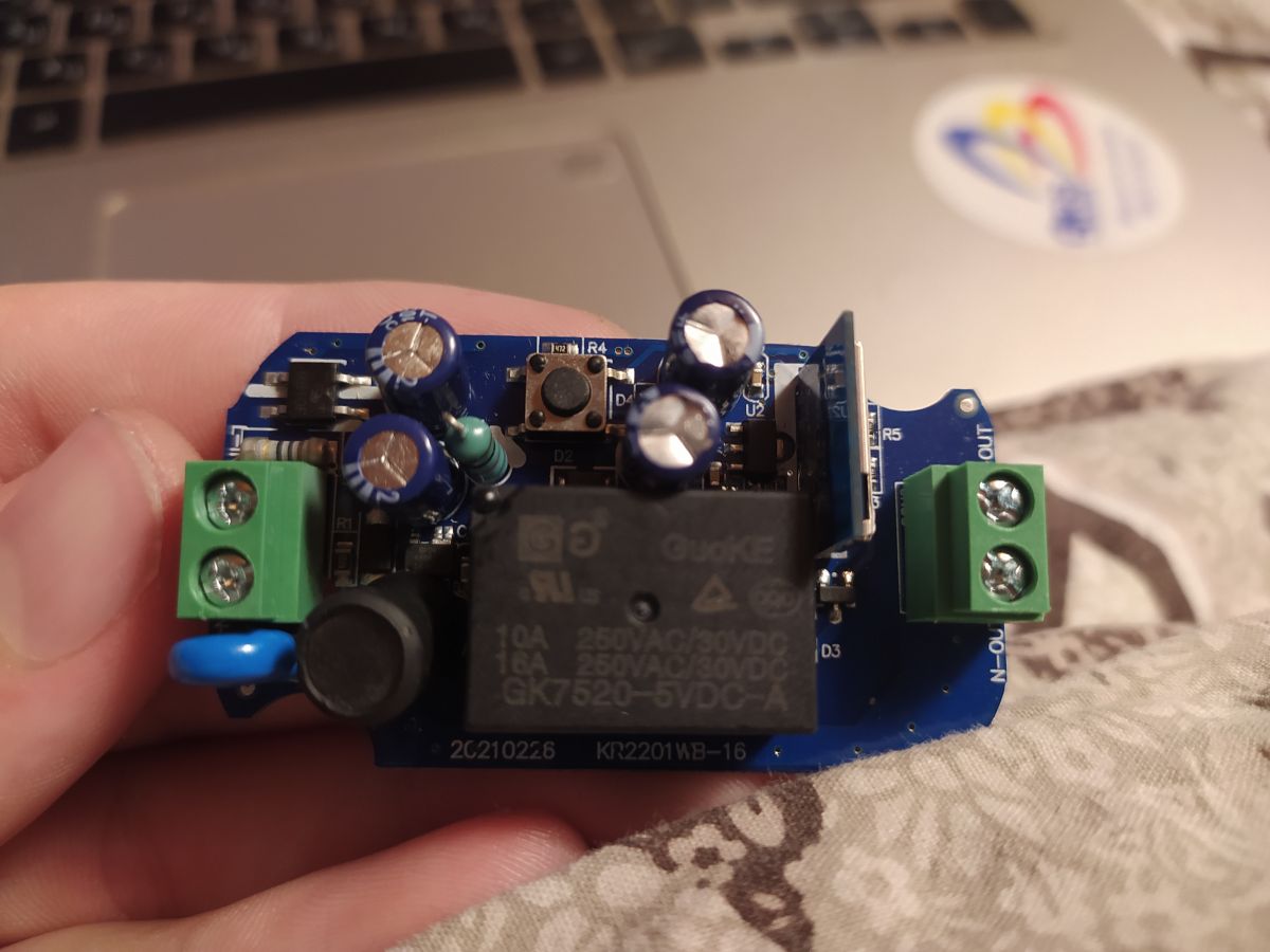

  • Relay template mismatch on CB3S four-relay board

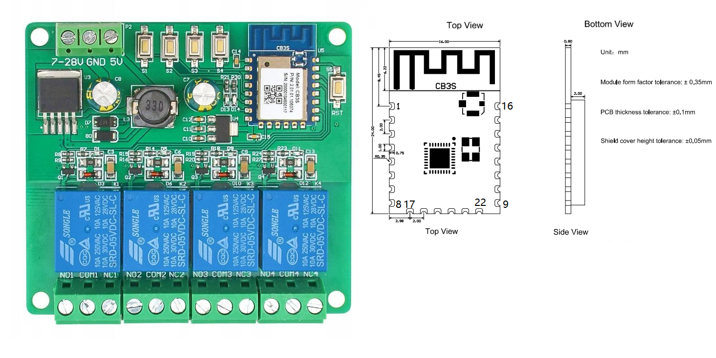

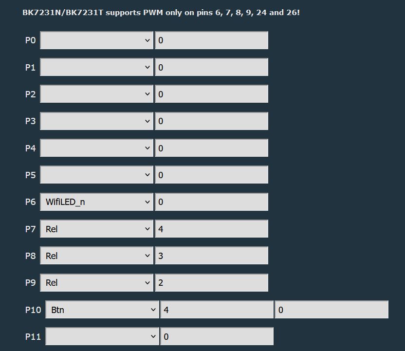

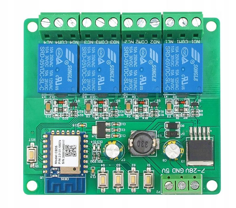

    #193 20263286
    elo2
    Posts: 6
    I tried to run the Tuya module with four relays based on the CB3S WiFi system, after connecting the converter, programming using bk_writer went without any problems, I uploaded and ran the latest version of OpenBK7231N_QIO_1.14.104.bin. The soft started, I configured the WiFi but unfortunately I failed in the relay configuration, none of the saved templates worked, I ran 2, 3 and 4 logically, but e.g. the buttons on the board no longer worked, only "3" turned on the 4th relay correctly. Maybe someone has seen this board and can tell me how to configure it so that all relays work properly. Finally, I uploaded a backup of the original Tuya software and everything works, but unfortunately the Tuya local integration in HA is not satisfactory. :(

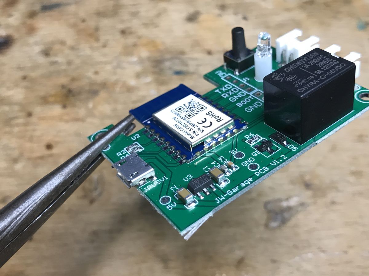

  • CB2S pinout and programming notes
    #194 20264353
    Posts: 14767
    Rate: 12909
    @kajarit uzupelniamy Readme
    @elo2 nie ma powodu by się poddawać. Przecież nawet na zdjęciu widać co jest co.
    Pin number Symbol I/O type Function
    1 RST I Low-level reset, high level active (the pin has been pulled high internally), correspond to CEN of the IC
    2 ADC3 AI ADC pin, which corresponds to P23 of the IC
    3 CEN I Enabling pin, which is pulled high internally to be compatible with other modules
    4 P14 I/O A common GPIO interface, which corresponds to P14 of the IC
    5 P26 I/O GPIOP_26, which corresponds to P26 of the IC, PWM 5
    6 P24 I/O GPIOP_24, which corresponds to P24 of the IC, PWM 4
    7 P6 I/O GPIOP_6, which corresponds to P6 of the IC, PWM 0
    8 VCC P Power supply pin (3.3V)
    9 GND P Power supply reference ground
    10 P9 I/O GPIOP_9, which corresponds to P9 of the IC, PWM 3
    11 TXD2 I/O UART2_TXD (used to display the module internal information), which corresponds to P0 of the IC
    12 CSN I/O Production test control pin. If it is used as a common I/O pin, it must be connected to the VCC externally. Do not connect it to the ground before the module is powered on.
    13 P8 I/O GPIOP_8, which corresponds to P8 of the IC, PWM 2
    14 P7 I/O GPIOP_7, which corresponds to P7 of the IC, PWM 1
    15 RXD1 I/O UART1_RXD (user serial interface), which corresponds to P10 of the IC. Do not connect it to the VCC. By default, the MCU serial port should be in low-level or high-impedance state.
    16 TXD1 I/O UART1_TXD (user serial interface), which corresponds to P11 of the IC. Do not connect it to the VCC. By default, the MCU serial port should be in low-level or high-impedance state.
    17 ADC3 AI (Not recommended. If needed, please use Pin 2) ADC port, which corresponds to P23 of the IC. Programmed SPI
    18 P22 I/O (Not recommended ) GPIOP_22, which corresponds to P22 of the IC. Programmed SPI
    19 CSN I/O The pull-up resistor is needed during usage of customers. Do not connect it to the ground before the module is powered on. Correspond to P21 of the IC.
    20 P20 I/O (Not recommended. ) GPIOP_20, which corresponds to P20 of the IC. Programmed SPI

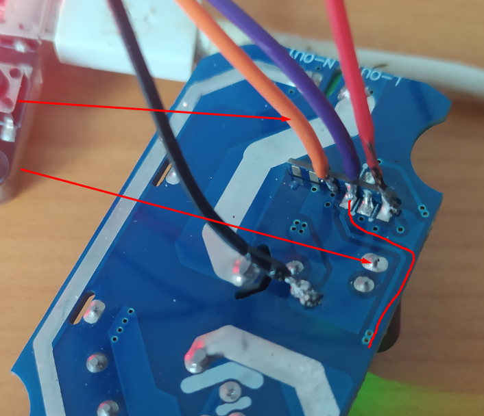

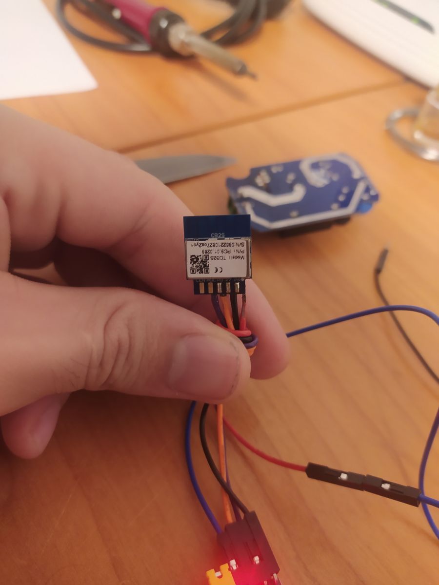

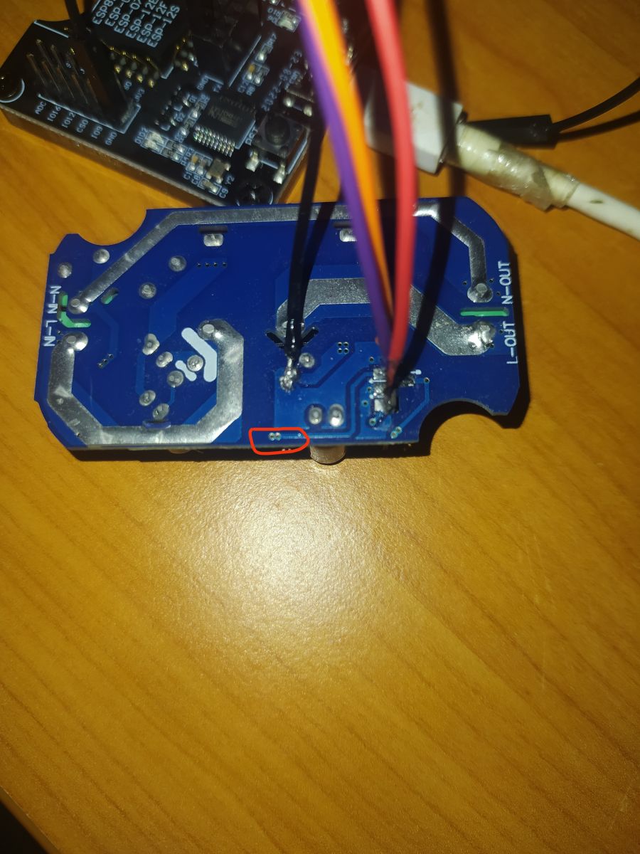

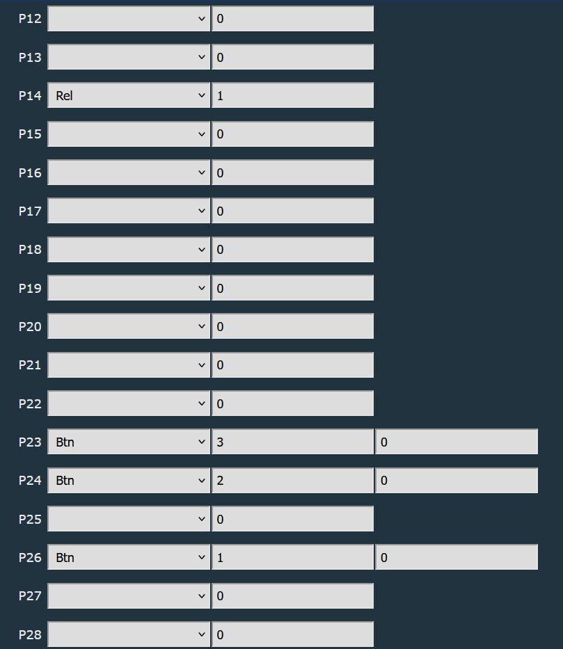

    I can see where the paths are from here, I started to fill you in:
    It looks like ADC3, P26 and P24 are buttons, and e.g. P6 is an LED. You can also more or less see what goes to the relays... you can guess the rest... try it and let me know if I can help.
    PS: Where did you buy the CD?

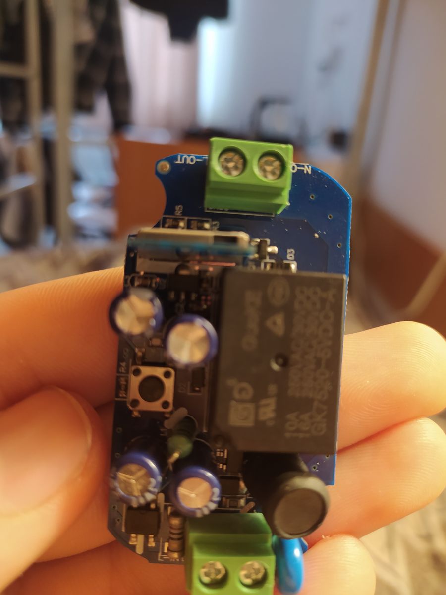

  • Tracing paths and voltmeter checks solved wiring
    #195 20265559
    elo2
    Posts: 6
    Thanks for the help, actually I figured it out yesterday, all I need to do is trace the paths, eventually the voltmeter and checking the states helped, the effect below is everything working.
    I have three such boards, two control the underfloor heating circuits and the third one controls the pumps, and the last one has already been converted and connected to the HA. All in all, the only thing missing is integration with HA, an app would be useful, as in the case of e.g. Tasmota, but after manually entering the configuration file it works beautifully, it was more fun with local tuya...
    Thank you for your help, in answer to your question, I ordered the tiles via Shopee from China for PLN 46 each.

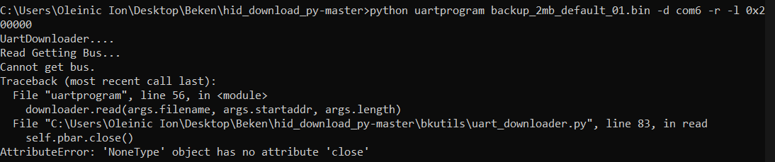

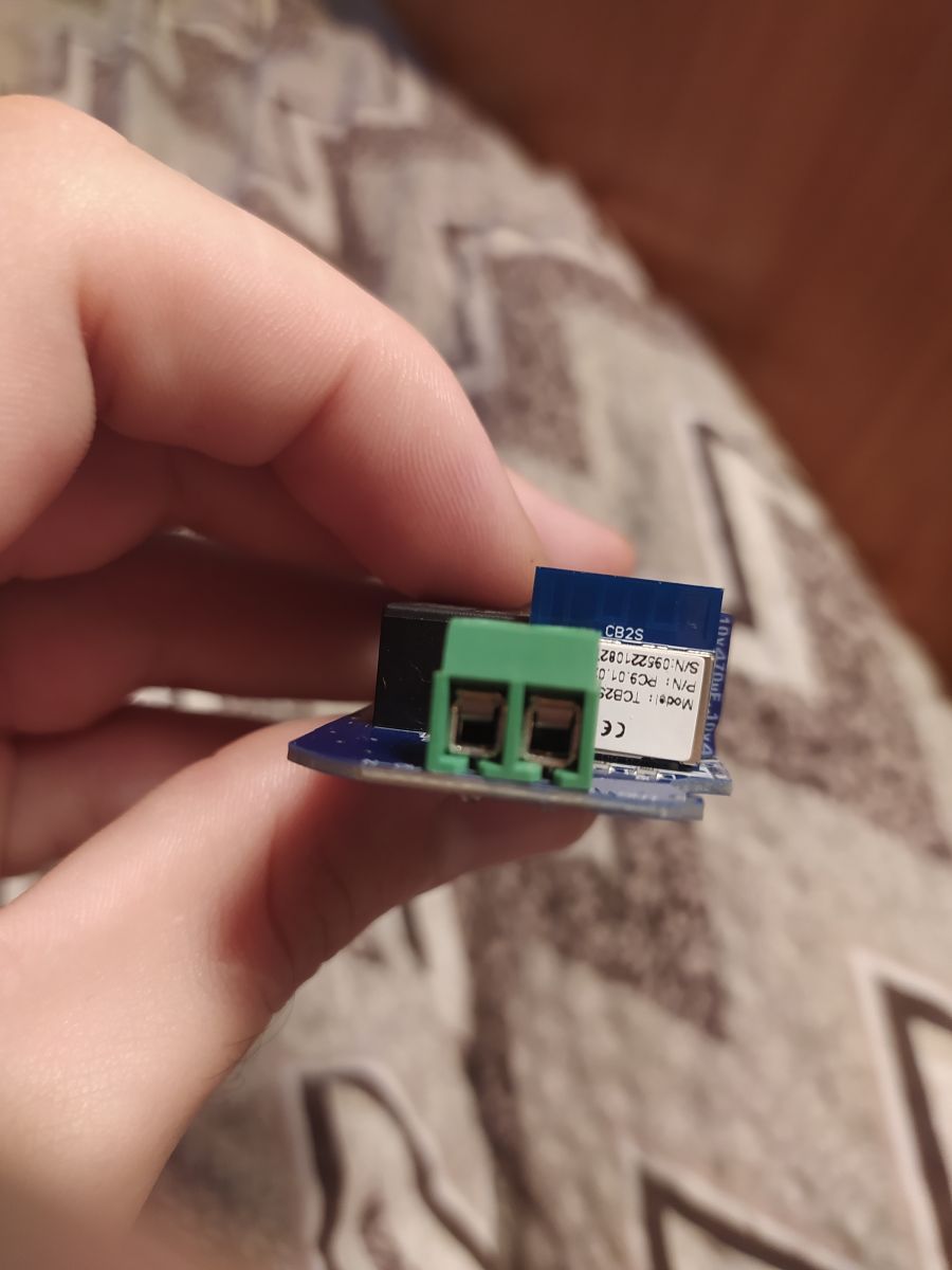

  • Questions about CB2S power wiring and flashing tools
    #196 20293493
    ionoleinic
    Posts: 48
    Hi community, I am new to OpenBeken and i am using tasmota for my devices.I saw that many devices that arrived from aliexpress are with cb2s and cbu modules.and i found this topic and OpenBeken community.I am glad that people works together on these big projects as a alternative of tuya cloud firmaware, and i think that tasmota and OpenBeken should work together for a best result.
    So, i have a switch module like this https://www.elektroda.com/rtvforum/topic3874289.html based on cb2s module.My module is slightly different as pcb arangement. p.kaczmarek2 i saw that you connect power and ground to ams 1117 voltage regulator.I dont know where exactly i should connect 5V and ground on my pcb.
    Can i power cb2s module direct from usb UART module with 3.3V to cb2s pins and if not, why? i saw that somebody power through ams1117 regulator, somebody doesnt.
    And one more question about flashing cb2s module.Can i use BKwriter 1.60 for flashing OpenBK7231N_app_QIO_1.0.0.bin on cb2s module or i still use hid_download_py for this.

    1. I do not recommend getting 3.3V directly from USB to UART because from my experience it is not reliable, those devices does not have current capability
    2. You can use IoT device onboard AMS1117 if one is on the board of your device. If not, then you have to use external one
    3. Never power device directly from mains while having UART connected!
    4. better use hid_download_py to flash N devices (and use QIO for N devices, offset 0)
    Depending on your soldering skills, the easiest approach for this device might be first desoldering whole CB2S, then soldering only 3.3V, GND, RX and TX and using 3.3V to do a reboot (just disconnect a power so device reboots), this is done while hid_download_py is waiting for "getting bus".
    The alternate option would be to use CEN for resetting, but this might be a bit more tricky.
    There are many approaches for that. We even have one video about similar device, but it is not translated yet - there are only subtitles.
    NOTE: the above video shows a bit more problematic case of relay - the case of relay with RX pin used for button, in that case one also has to cut the trace/remove capacitor from RX signal. Of course, there is always the "desolder whole CB2S" method as well, which I already mentioned in this post.
    In general, there are few different ways you can use to approach this.

    So, i should desolder module from pcb, flash it and solder back.Can i try to flash without desolder it? or it can be dangerous for module?
    I dont have another ams 1117 LOD regulator, but i have esp programmer. Qiachip Smart Switch - BK7231N / CB2S - interior, programming
    Can i use these pins to power cb2s module or it has low current too as USB to UART?

    #199 20293589
    Posts: 14767
    Rate: 12909
    ionoleinic wrote:
    Thank you for reply.
    I flash many times without desoldering and you can do this, but:
    1. You need to power to the module.
    METHOD 1: you need to find VIN of the LDO that is on the board and supply 5V here
    METHOD 2: supply 3.3V to CB2S directly
    2. You need to be able to RESET device in that configuration
    METHOD 1: you need to solder extra CEN wire and short CEN to GND to reset for 250ms (very tricky, I always have to attempt it 10 times before getting right)
    METHOD 2: you need to RESET/reboot device with disconnecting VDD wire from module (or from LDO) and keep USB to UART converter connected, but here comes the problem: if there is an electrolytic capacitor on board, it might take a large current when you connect wire, and it can overload your USB port . It will not damage the computer, your PC is safe, but it can temporary disconnect USB to UART dongle and cause programming to fail. This is why I used to desolder temporarily 220uF 16V caps (or similar) from devices...
    The important thing to know is that you have to RESET (either by power off/on or by CEN) after starting programming, while the programmer is trying to connect to BK.
    I think they should be ok. I can see AMS1117.
  • CB2S reboots when reading firmware dump

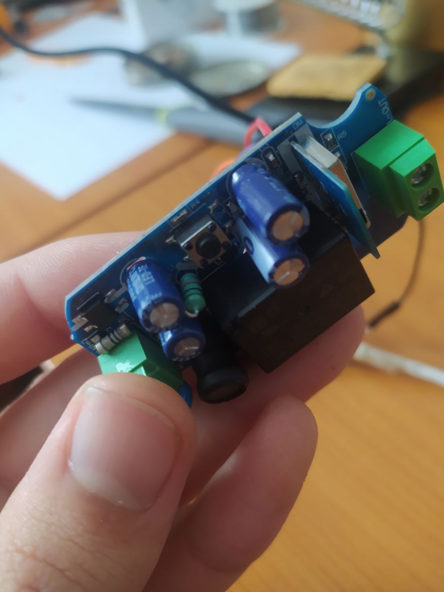

    #200 20293707
    ionoleinic
    Posts: 48
    Thank you, i will try also to save current firmware for guys from Tuya Cloudcutter.
    Added after 2 [hours] 19 [minutes]:
    I am getting this error when i am trying to read firmware
    cb2s reboots but want to read data from it.
    Added after 5 [minutes]:
    I tried with disconecting power and with CEN method.Same error.
    Qiachip Smart Switch - BK7231N / CB2S - interior, programming Qiachip Smart Switch - BK7231N / CB2S - interior, programming Qiachip Smart Switch - BK7231N / CB2S - interior, programming Qiachip Smart Switch - BK7231N / CB2S - interior, programming
  • Suspect RX pin trace or external component issue

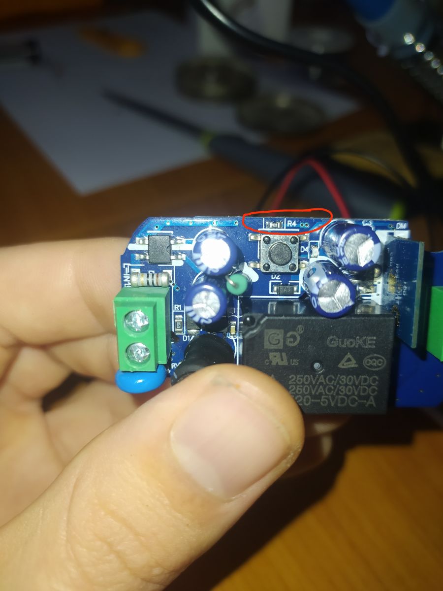

    #201 20294037
    Posts: 14767
    Rate: 12909
    Can you try bkWriter 1.60, at least for the reading?
    but it looks like "hid_download_py" should work. Maybe your device has button or a resistor or a capacitor connected to RX or TX pin, like the one in mentioned Youtube video?
    Wait, what is this trace doing?
    Is it the RX pin trace? RX pin is used for something else?
    Don't you have the same issue like the one in our Youtube video?
  • Suspects resistor, not the button trace
    #202 20294125
    ionoleinic
    Posts: 48
    OMG, there is a button :)
    Qiachip Smart Switch - BK7231N / CB2S - interior, programming Qiachip Smart Switch - BK7231N / CB2S - interior, programming [img-2]
    What should i do now? Desolder or cut trace? If i cut and not solder trace back button will not work, right?
    Added after 20 [minutes]:
    maybe rezistor is the problem and not button...
  • #203 20294186
    Posts: 14767
    Rate: 12909
    Wait... does orange wire connects to the power supply capacitor pin?
    It is not clear from the photo, but maybe this module has different pinout? I am confused right now.
    Can you check that with a multimeter?
  • #204 20294196
    ionoleinic
    Posts: 48
    checked, there is ground connection of capacitor, it is not connected with rx or tx.
  • #205 20294204
    Posts: 14767
    Rate: 12909
    It is possible that this button has a pull down or up resistor that interferes with programming.
    You have two options:
    1. cut the trace and fix it later (just like on my Youtube video)
    2. choose the "desolder whole module" route, it's very easy with a flux and solder wick, and program module outside the board
    The method 2 is more reliable.
  • CB2S pinout differs: P7 button, P8 relay, P10 LED_n
    #206 20296206
    ionoleinic
    Posts: 48
    Hi people, i flashed cb2s module with succes, but with my esp programers are hapennig strange things (I have 2 of them and both are doing same thing).I dont know if it should be that, but esp programer read from cb2s only and only if power 3.3V is not connected to cb2s and tx with rx are inversed (Tx -> Tx and Rx -> Rx).
    I didn't tried to flash with this method.
    Succesfuly flashed with USB to UART programmer.
    Thank you, p.kaczmarek2, for help.
    Added after 34 [minutes]:
    My module has a different pinout configuration:
    P7: Btn
    P8: Rel
    P10: LED_n
  • #207 20297992
