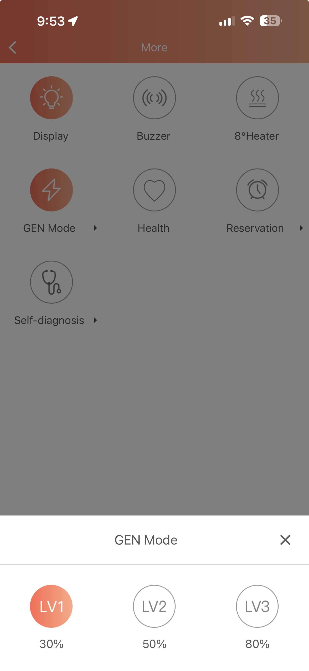

  • #250 21764091
    vietxtlife
    Posts: 26
    >>21761976 Hey, could we put the GEN option in HA? I want to do automations with GEN function. Thanks, guys

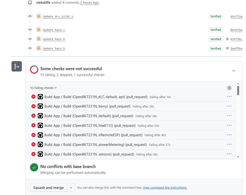

    Is this your PR? It does not build yet, you have a compile error:

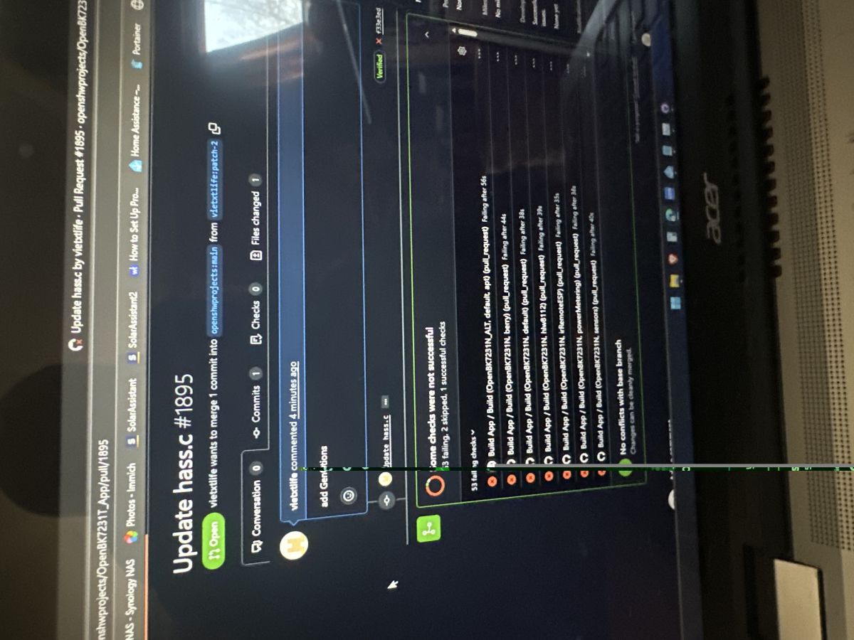

    vietxtlife
    Posts: 26
    >>21779457 Yes, that's what I tried. Honestly, I don't know what I'm doing. All I did was search for what you said "hass_createSelectEntityIndexedCustom" and write a new part for GenOptions in the two files I uploaded here. If you could look over those 2 files to see if I messed up somewhere.

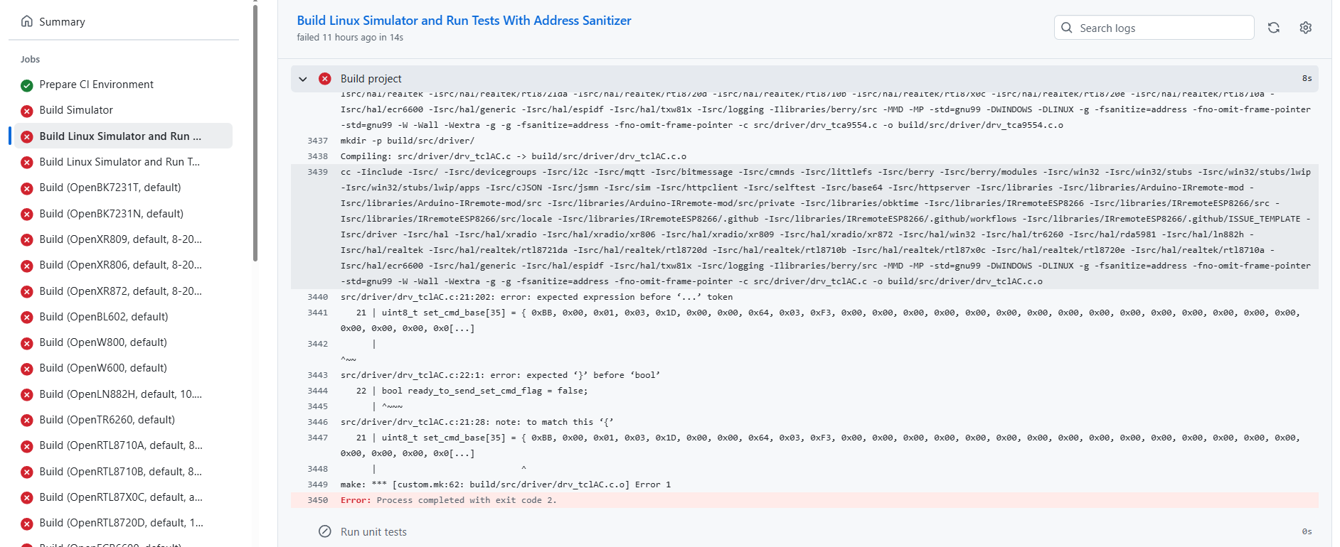

  • #260 21779890
    Posts: 14633
    Help: 655
    Rate: 12647
    Is the mentioned PR same as uploaded files? If so, there is no need to upload C files, all changes are visible via Github... or are you saying that there is something more in files than in your PR? If so, please submit it to Github, so it's easier to see what was changed.
    Github shows why your changes didn't compile:
    Compilation error in CI showing missing brace in drv_tclAC.c file

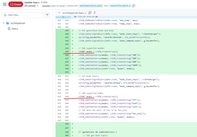

  • #262 21780258
    Posts: 14633
    Help: 655
    Rate: 12647

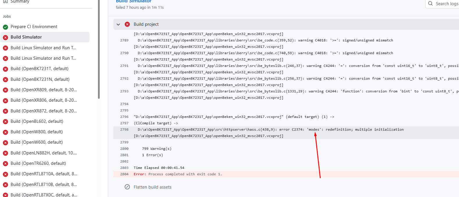

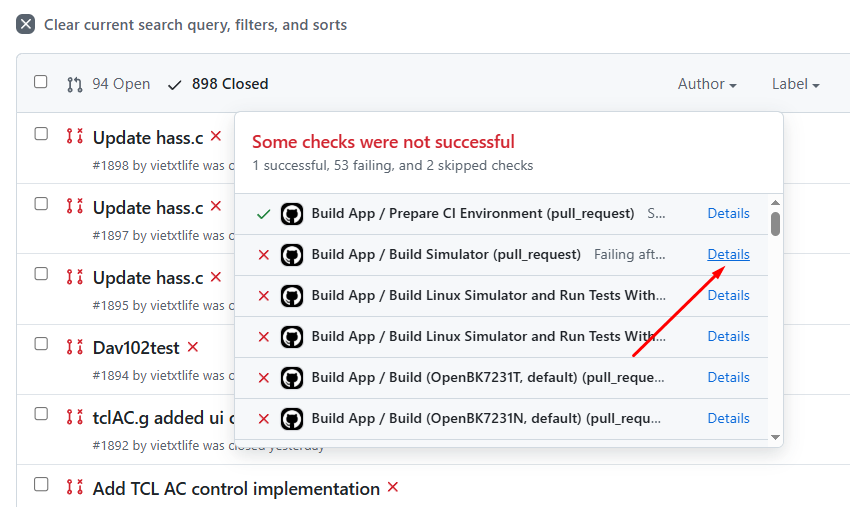

    Ok, so do you know, that if you click here on "Details":
    Closed pull requests list showing mostly failed CI test results
    You get an error message there:
    Build error showing redefinition and multiple initialization of variable “modes”
    Currently it says:
     D:\a\OpenBK7231T_App\OpenBK7231T_App\src\httpserver\hass.c(438,9): error C2374: 'modes': redefinition; multiple initialization
    It says line 438, right? So go to line 438.
    I can see you have variable "modes" declared twice:
    Screenshot showing source code changes in hass.c file on GitHub
    It's good that you are trying to add it, possibly with a help of an LLM, but it would benefit you a lot if you read the error messages.
    Otherwise I'll look into it when I get some time, but I'm just a single person and this project is huge so sometimes I can't really help right away.

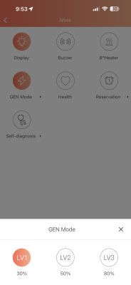

  • #263 21781377
    vietxtlife
    Posts: 26
    App settings screen showing GEN Mode with power levels 30%, 50%, and 80%

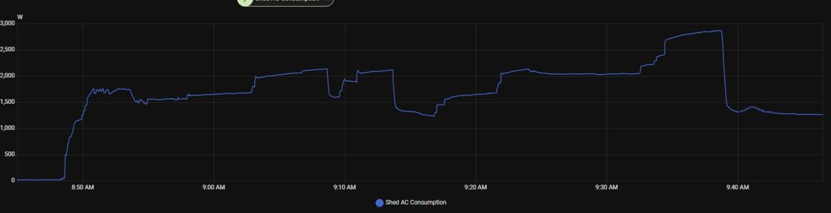

    So today I managed to capture a graph of the mini split Gen Options operate and how much power it consumed as each Gen option is engaged. Though today is on the extreme side of things, we have -9 °C with our weather, so the mini split is working really hard to heat the room it's in.
    Power consumption chart of shed AC in watts between 8:50 AM and 9:45 AM
    Looking at the graph, each time power usage goes up or down is when I engaged Gen options. With LV1 = 30% the mini split uses roughly 1200 W, LV2 = 50% = 1800 W, LV3 = 80% = 2300 W, and with no Gen = 100% = 2900 W. And because I have the mini split on all day, you can see how much energy can be saved here.
    I control it from the Tuya app, by the way, and the graph is taken from the energy monitor CT clamp that only monitors the mini split circuit

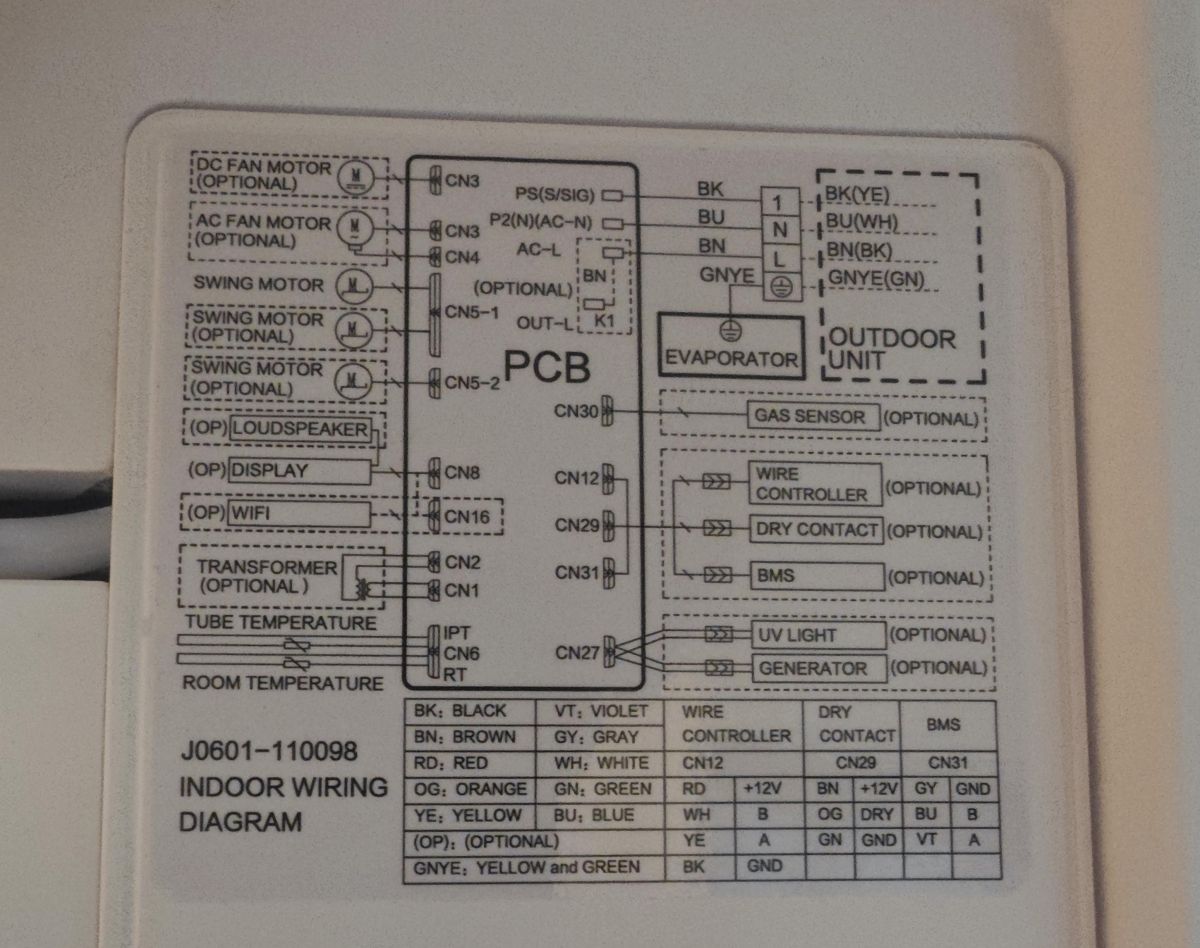

  • Daitsu multisplit uses same WBR3 Tuya module
    #267 21916056

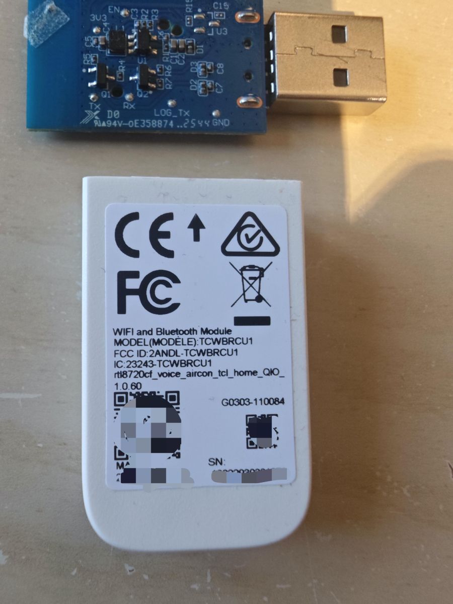

    Nauttor
    Posts: 17
    Hi all,
    I've been following this thread with great interest, I can see amazing progress so far for the Dellas AC. I want to add my 2 cents on what I have seen so far. I'm in Spain and here we have a pretty common brand and machine that looks the same, if not the same sold behind the brand Daitsu. My Ac is a 3x multisplit. The model is the one below:
    Exterior units: Daitsu DOSM-21KDT
    Interior units: DS-18KZ & DS-9KZ
    Request for Help – Flashing Della Minisplit WiFi Module (WBR3 on TCWBRCU1)
    USB plug circuit board next to a white Wi‑Fi/Bluetooth module label with certification marks
    From the description of the USB module it says:
    WIFI ad Blutoth Module
    MODEL(MODÉLE):TCWBRCU1
    FCC ID:2ANDL-TCWBRCU1
    IC:23243-TCWBRCU1
    rt18720cf_voice_aircon_tcl_home_Ql0_1.0.60
    G0303-110084
    Inside as expected the same WBR3 module.
    I added it to the tuya app, and I get to extract from the cloud api the DPIDs. I guess this will confirm if it is or not the same device.
