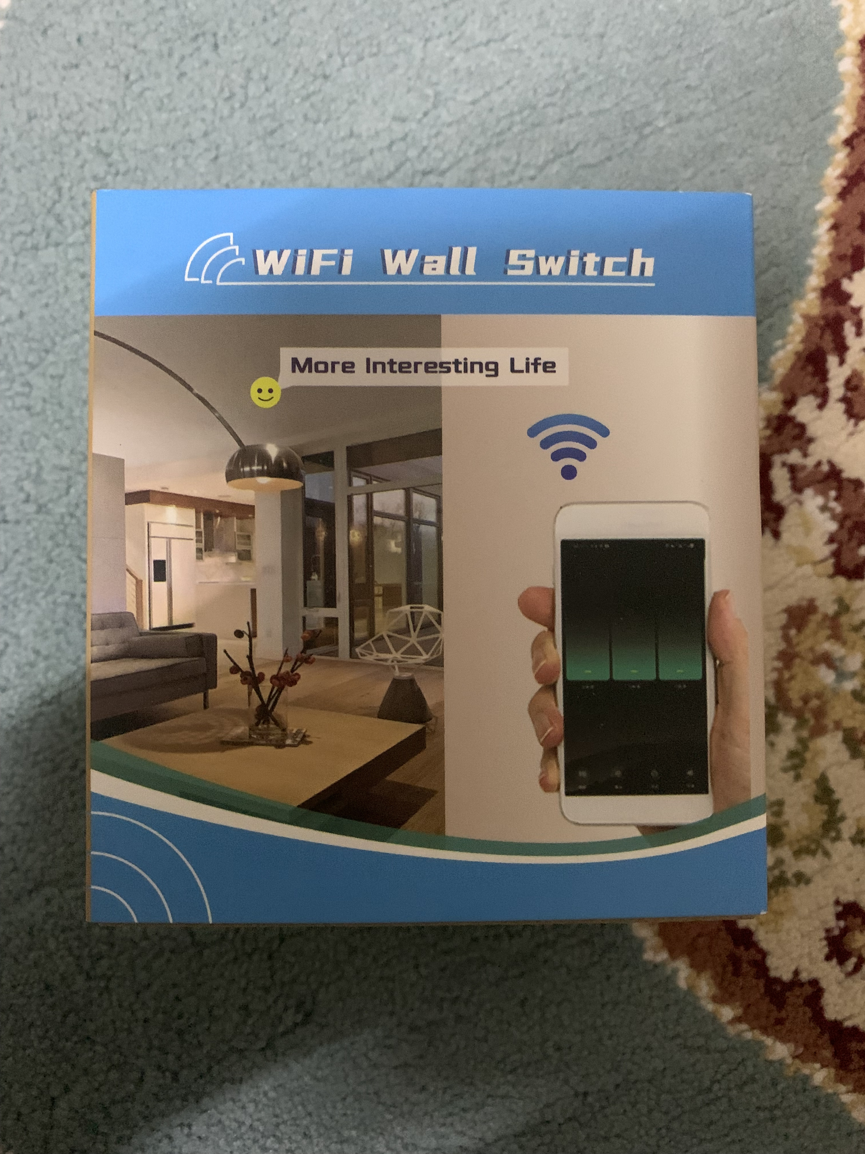

This is a short teardown of Generic Tuya Wall Switch Push Button Type (No Neutral) with CB3S module.
Basic information:
Brand: Tuya
Model: LSPS5
Chip: BK7231N [CB3S]
Local Vendor: https://www.aliexpress.com/item/1005003379628923.html
There are other stores selling similar switches, the original store i bought from had increased their prices.
Teardown Photos:
Flashing Method:
Using serial method with hid_download tool. Start flashing and do a power cycle or ground the CEN pin.
UART TX --> PCB RX
UART RX --> PCB RX
UART GND --> PCB GND
UART 3.3V --> PCB 3.3V
