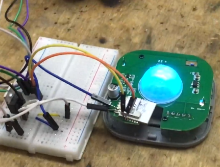

There is a module inside CBU , its documentation is on the Tuya website, a OpenBeken supports BK7231N.
Let's take a look at the board:
Not much happens on this board. The PIR sensor is typical, such as in popular modules for Arduino. My attention was caught by the U3 chip, i.e. 7333, 3.3V LDO regulator. I thought that there would be a slightly more efficient step down converter here, but no. All in all, it makes some sense, here there are three nominally 1.5V batteries, i.e. 4.5V in total, of course less and less with their discharge. Tuya battery powered products with converters instead of regulators are rather two batteries, then there is 3V, and the converter increases them to 3.3V.
The on-off button allows you to turn off the sensor completely without removing the battery:
Transistors R1 and A09T, whose roles I have not analyzed:
CBU:
This device does not use TuyaMCU. There is no additional microcontroller here, nothing is blocking UART1 from the CBU. The CBU controls everything by itself and falls into a deep sleep when nothing happens. This device wakes up and connects to WiFi only when a status needs to be reported.

Let's analyze what we've got here. First, there's the pairing button, Button, on the P20. There is a WiFi LED here on the P26. There is a PIR sensor on the P16. And we have a battery status control system, i.e. ADC + GPIO which turns on the resistor divider. These GPIOs are there to save energy and to make the resistor divider only let current when we make a measurement. Tuya also determines the maximum and minimum battery voltages, it is used for calculations.
There was already a topic about the battery controller here:
https://www.elektroda.com/rtvforum/topic3959103.html
Now it's all about deep sleep. The WiFi module cannot work all the time, it would drain the batteries too quickly. To do this, we will use the deep sleep solution described here:
https://www.elektroda.com/rtvforum/topic3960149.html
Also, check out this topic on deep sleep:
https://www.elektroda.pl/rtvforum/topic3972898.html
https://www.elektroda.com/rtvforum/topic3972898.html
In summary, here is what needs to be configured:
- set the Button role for the button to P20 to be able to wake the device from a deep sleep in an emergency
- set the role of LED (or WiFi LED - at your discretion, or LED_n) to P26, select channel 1 there
- set the role of DoorSensorWithDeepSleep for P16, because we will use the door sensor driver to report movement, also set channel 1
- additionally, depending on which PCB version you have, you may need to configure DSEdge to select the type of edge that wakes up the sensor (rising, falling, or respectively increasing when the system goes to sleep with a low state on the sensor or falling when the system goes to sleep with a high state on sensor)
- configure the battery driver, as in the previously linked topic

Here is the final result:
The LED lights up as soon as motion is detected.
