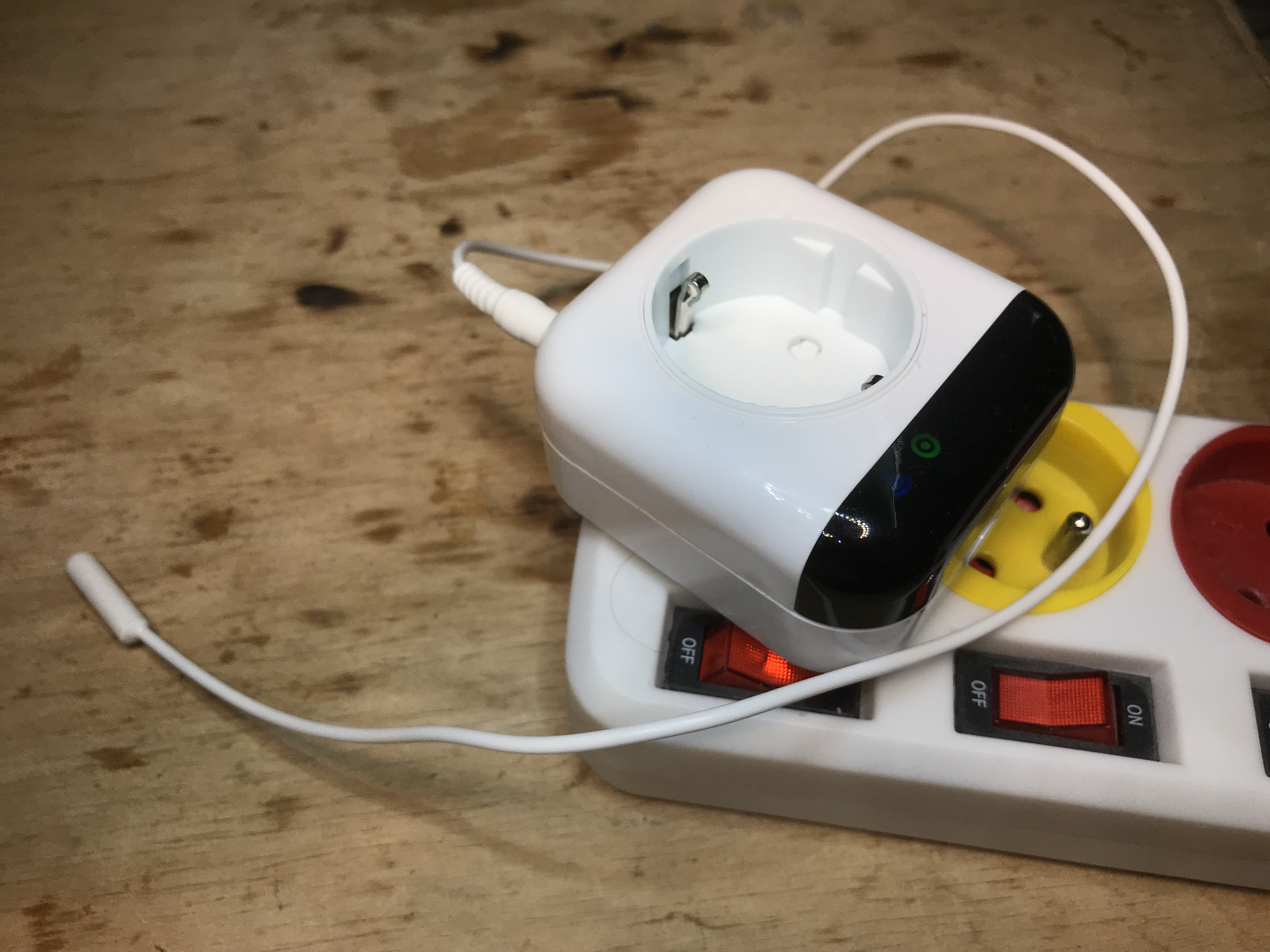

Here I will show you how you can script the behaviour of TuyaMCU BK7231N relay flashed with OpenBeken firmware. In this topic I will cover a creation of scripts, mapping TuyaMCU variables to OpenBeken channels, displaying them, creation of custom HTTP buttons and setup of a custom OBK script timer.
This topic will not cover the automatic temperature/heating control itself, because I am planning to show it in the separate part.

For this topic I used a TuyaMCU BK7231N thermostat (relay+external temperature probe) device, but in this case I will focus mostly on the relay control:
TuyaMCU socket adapter on a wooden table Smart electric socket with an external temperature probe. Smart plug connected to a power strip White electric plug adapter on a wooden surface.
