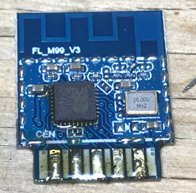

FL_M99_V3 module with a microcontroller on a blue PCB marked with 26.000 MHz.
Some of new Tuya IoT devices are based on FL_M99_V1/FL_M99_V2/FL_M99_V3 modules, which are using BK7231N/BL2028N WiFi 2.4GHz + Bluetooth microcontroller. They can be flashed with OpenBeken, which will provide basic Tasmota compatibility and Home Assistant features. Here's a basic FL_M99 pinout and flashing guide.
There have been already multiple reports of similiar modules on our forum, including:
- mini smart switch - Belon BL2028N
- Aubess 2gang Mini Smart Switch BK7231N /CB2S
I have also received recently a WiFi smart switch based on FL_M99_V1, here is this module photo:
FL_M99_V3 IoT module on a wooden background Close-up of FL_M99_V3 module with BK7231N microcontroller. FL_M99_V1 electronic module with visible pins on a white casing.
Module pinout seems to match CB2S:
Technical drawing of the CB2S module with pin labels and dimensions.
Diagram of the FL_M99 module pin layout.

Availability of 5 PWM outputs makes this module suitable for RGBCW lighting, extra ADC pin can be also used for light sensor.
How to flash FL_M99_V1/FL_M99_V2/FL_M99_V3?
Flash it like CB2S, either in circuit, or desolder it from the board.
You can use our BK7231 flasher for that:
You can watch our old (hid_download_py) and new (BK7231tool flasher) guides:
I am usually just desoldering the module, here is my setup:
FL_M99 module connected to a breadboard with wires and a USB adapter. Orange FL_M99 module with attached wires on a wooden surface.
I do not solder CEN, I just do power on/off cycle by disconnecting and reconnecting 3.3V wire.
