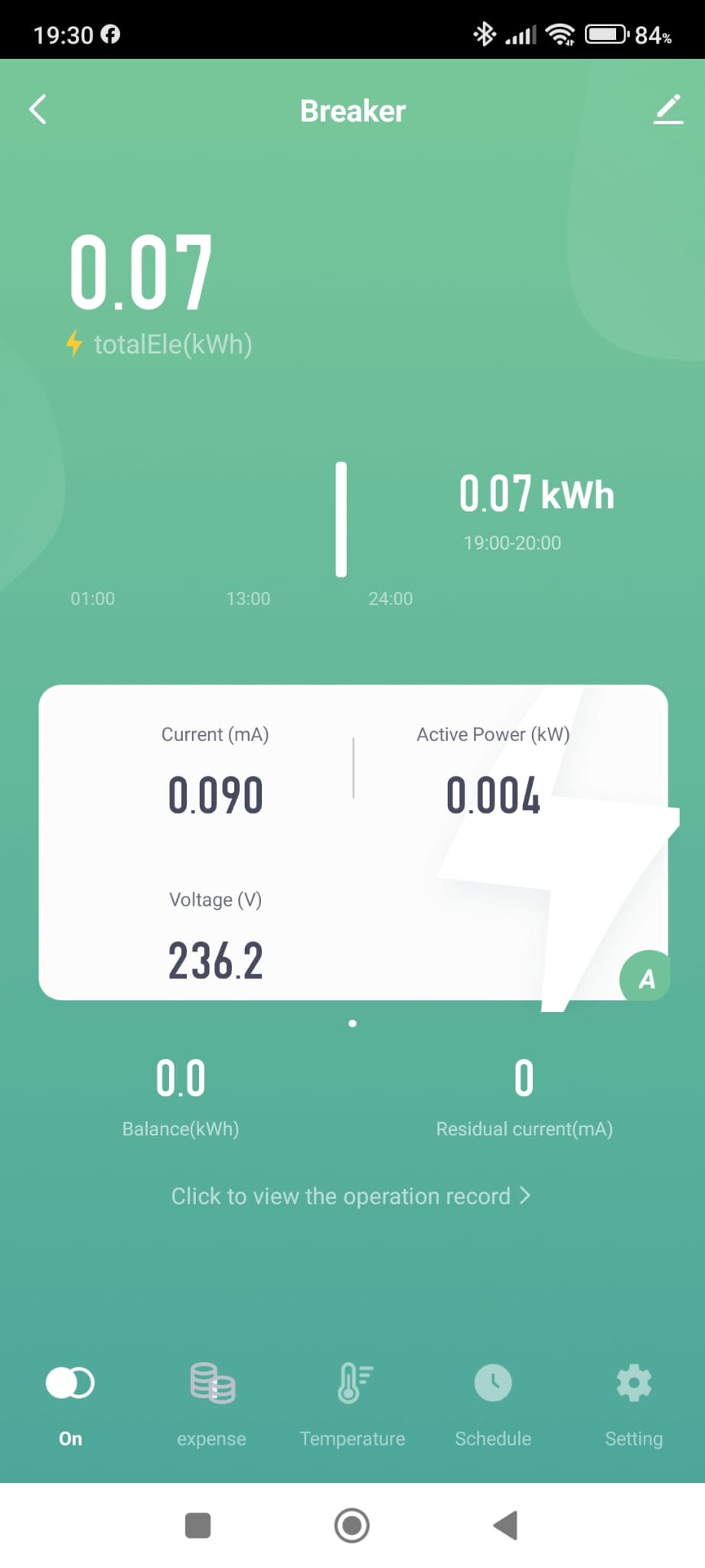

To start with, we can get an idea of the number of DpIDs of the device by "discovering" it in the Tuya App and exploring its control pages. The most interesting screenshots of them for our example are these:
Screenshot of an app displaying energy consumption. Screenshot of an energy expense management app with the prepayment switch turned off. Screenshot of an app showing temperature as NaN°C in four fields. Screenshot of an app showing settings for various electrical alarms. Screenshot of app settings showing a leakage alarm with a 30 mA threshold and control toggle enabled. Screenshot of an app with over-voltage alarm settings.
In the first screen, we can see the device can report power, voltage, current, residual current, total energy, and "balance energy" (remaining prepaid energy). The second one allows setting prepayment on or off and recharging or clearing balance energy. The third one should show temperature, but it's a feature the device doesn't support (clearly, the manufacturer is "recycling" the interface from another device...). The fourth allows testing the residual current protection and gives access to the following ones, where you can activate or deactivate the different alarms (whether they should trip the switch or not) and set their thresholds. Each of these values/settings, or groups of them, should have a DpID that we would want to monitor/control in OBK, once we flash the device with it.

With this, combined with the previous information from the Tuya App we can already make an idea about the DpID numbers associated with each of the measurements/settings of the device, but we can also get more information from the Tuya developer's website. For example, in step 7 of the previous procedure, instead of "Device Logs", click "Device Debugging", and you'll get the following screen:
