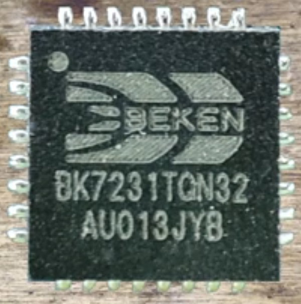

BEKEN BK7231TQN32 chip viewed from above.
OpenBeken features a deep sleep system which allows you to basically turn off the BK7231 until a certain amount of time passes (DeepSleep) or until a GPIO event occurs (like button press - PinDeepSleep). The following feature is necessary for the battery powered devices, otherwise the batteries would drain in a day or two. Here I will show how you can configure OBK to be waken up by both GPIO event and timer.
