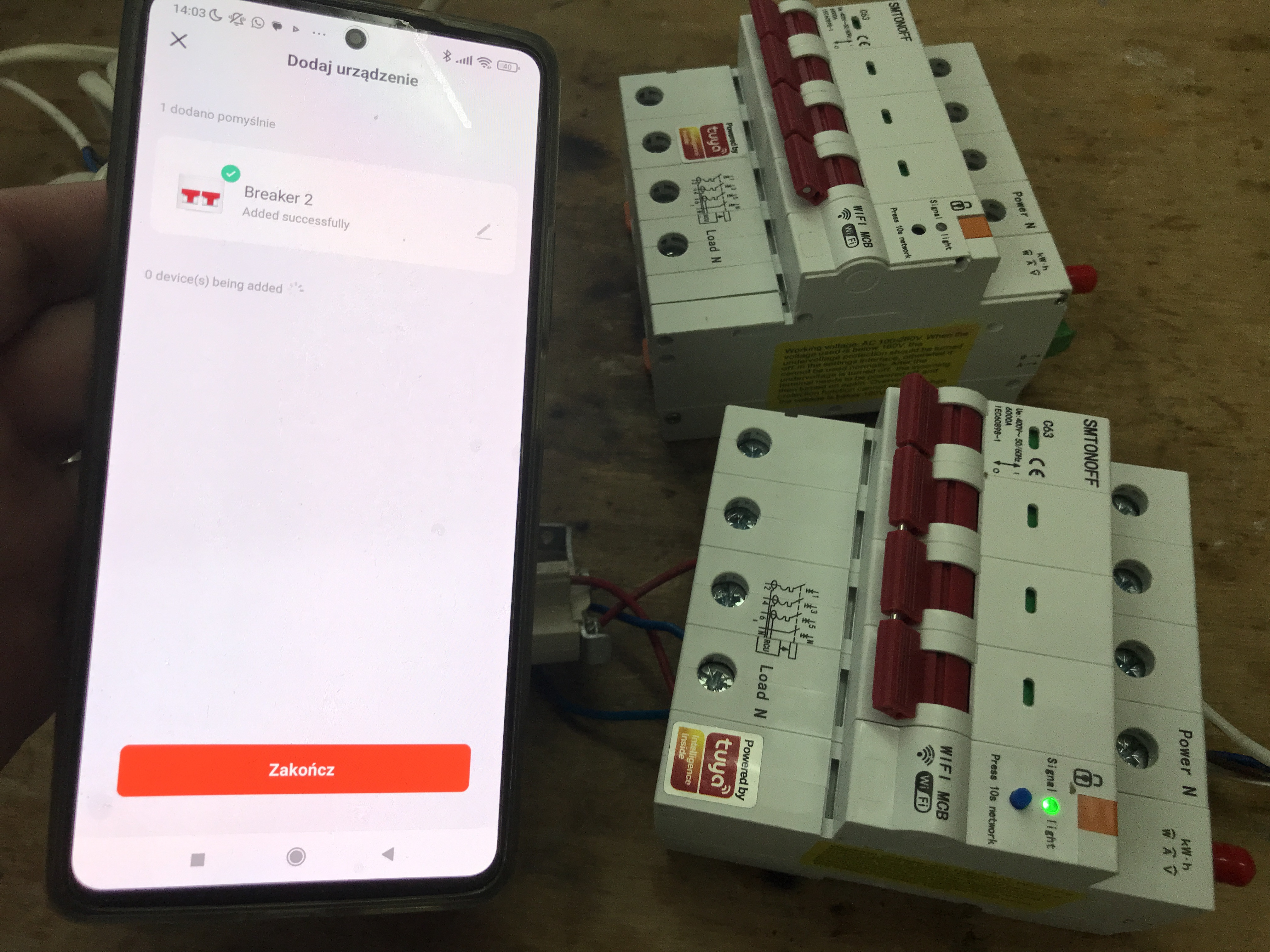

The RESET button on the housing is used for pairing. Proceed as with other Tuya devices:
Smartphone displaying successfully added Tuya device next to two 3-phase energy meters. .
Immediately afterwards we can control and read the measurements. Here is a short video presentation:

thermiq 06 May 2025 11:23
The SMTONOFF meter in the picture is described here: https://www.elektroda.com/rtvforum/topic4119922.html [Read more]
