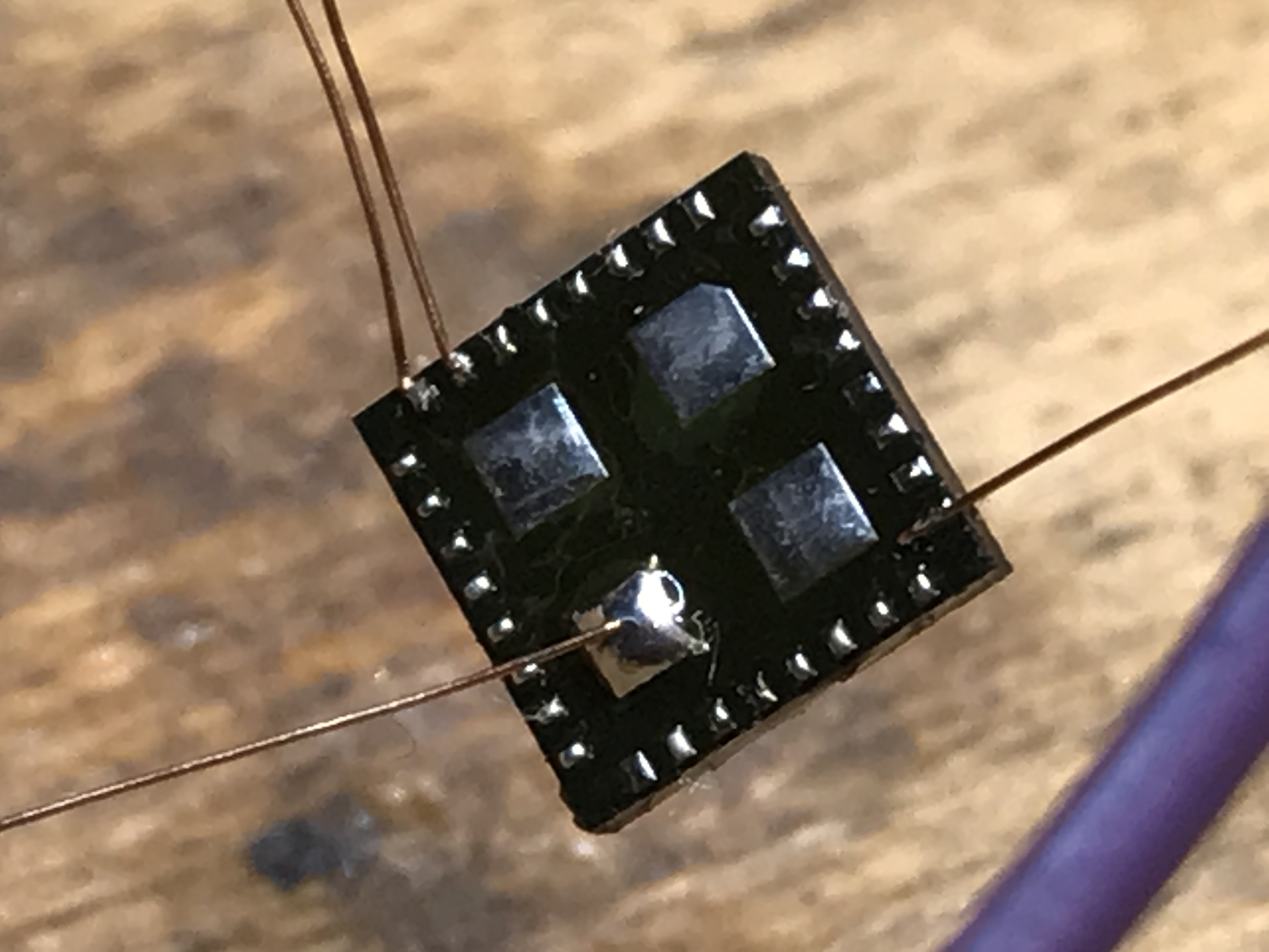

Second flashing method And so, I had to remove the T34 from the board with hot air. I added some extra flux and lowered the air flow to avoid affecting nearby components.
Here you can see the pad that I damaged (not the resistor pad, but the tiny pad of the other UART pin):
Then I decided to solder directly to QFN pads, but this time I used thin wires:
It is also recommended to secure them in place with some hot glue or sticky tape, because it's still very easy to tear the pad.
Here's UART soldered:
And then ground (large pad) and power (3.3V):
Full circuit:

I cleared up the T34 pads with flux and solder wick. Then I added flux on the PCB and decided to reuse the solder that was already there.
After a brief heating, with a small air flow, the module has slightly moved itself in place and seated itself correctly. I had no corrections to do myself.
Luckily the soldering turned out to be very easy and device worked at the first try.

Summary New devices with T34 devices are still certainly flashable, you can do that just like you'd flash BK7231N.
This particular plug can be still flashed without desoldering T34, you don't even need hot air, just a cheap soldering iron, but don't repeat my mistake and use a very thin wires to access UART TX and RX. Then you can just feed either 5V to the input of AMS1117-3.3V or 3.3V to the output and it will flash just fine.
Otherwise you'll need to desolder T34 chip with hot air. It's still possible and in my opinion it's actually way more easy than it seems. Soldering to T34 pads is also relatively easily, as long as you use flux and a correct type of wire. Just don't apply force or you'll rip them too. It may be safer to secure T34 wires in place with some hot glue to avoid pulling them accidentally.
Soldering T34 back is also easy, I just cleared T34 pads with soldering wick and added flux to the board, I didn't even clean the old solder. Old solder melted just fine. I will try to make a video with it soon, but that's for another topic.
So, summing up, T34 devices are still flashable and it's still possible to do it in most cases even without hot air. Did you encounter any T34 devices so far? Let us know! We can help you with running your devices 100% local, without the cloud and with Home Assistant.

Why do T34 UART pads rip off during soldering, and what's the best wire size and technique to avoid damaging them?
The pads rip off because they are tiny SMD landing points and thicker wire adds too much mechanical force. In the failed attempt, one pad detached after the author used wire that was too large. The fix was explicit: “use thinner wires,” then secure them so movement does not pull the pad. The safest technique is to use very thin wire, plenty of flux, almost no pulling force, and strain relief with hot glue or tape before moving the board. [#21486284]
What's the safest way to solder directly to T34 QFN pads when a smart plug has no accessible RX/TX pads?
The safest method is to remove the module first, then solder very thin wires directly to the QFN edge pads with strain relief. 1. Lift the T34 with hot air, extra flux, and low airflow. 2. Solder thin UART wires to the exposed QFN pads, then add GND and 3.3 V. 3. Fix the wires with hot glue or tape so they cannot tug on the pads. That method was used successfully after a board UART pad was damaged. [#21486284]
How do you remove and re-solder a T34 module with hot air without disturbing nearby components?
Use extra flux and lower the hot-air flow so the heat reaches the T34 without blowing nearby parts away. The author removed the module that way, then cleaned its pads with flux and solder wick. For reinstallation, flux was added to the PCB, the old solder was reused, and brief heating let the module self-align on the pads. The result was successful on the first try, with no manual alignment correction needed. [#21486284]

Thank you for this tutorial I also have few smart power plugs with this chip and I will try to flash openbeken. When I flashed tasmota on other smart power plug I need to put GPIO00 to ground and after... [Read more]
That's a good idea, thank you! I will try this next time. Regarding GPIO0 - no, there is no GPIO0 for Beken. Just supply power from good power supply, connect RX and TX, and do power off/on to reboot. Of... [Read more]
I see GND is at the bottom of the chip. Where at the top I can find GND? [Read more]
There are many ways to find GND. You can use LDO regulator as a reference: https://obrazki.elektroda.pl/2997903400_1777887062_bigthumb.jpg Or you can find bulk capacitors and use their ground side. ... [Read more]
thank you for info. I just ripped off a pad so I have unsoldered chip and now I will try this way. Just one more question what I should flash on that T34 a BK7231T or BK7231N? I tried to flash what I... [Read more]
T34 is BK7231N. Getting bus failed is normal, because while it's getting bus, you need to reset the plug - usually via disconnecting 3.3V wire (or 5V one ,depending on how you connected it). Basically,... [Read more]
I did that I have unpluged 3.3V and than plug it back but still the same error bus failed Added after 3 [hours] 29 [minutes]: I manage to flash openbeken on chip and soldered it back and now smart... [Read more]
I have tried to flash this chip on board and it looks like I burned the chip. Is it possible to buy that chip or some simillair which will work if I just replace that chip? Is there any slot, where I... [Read more]
