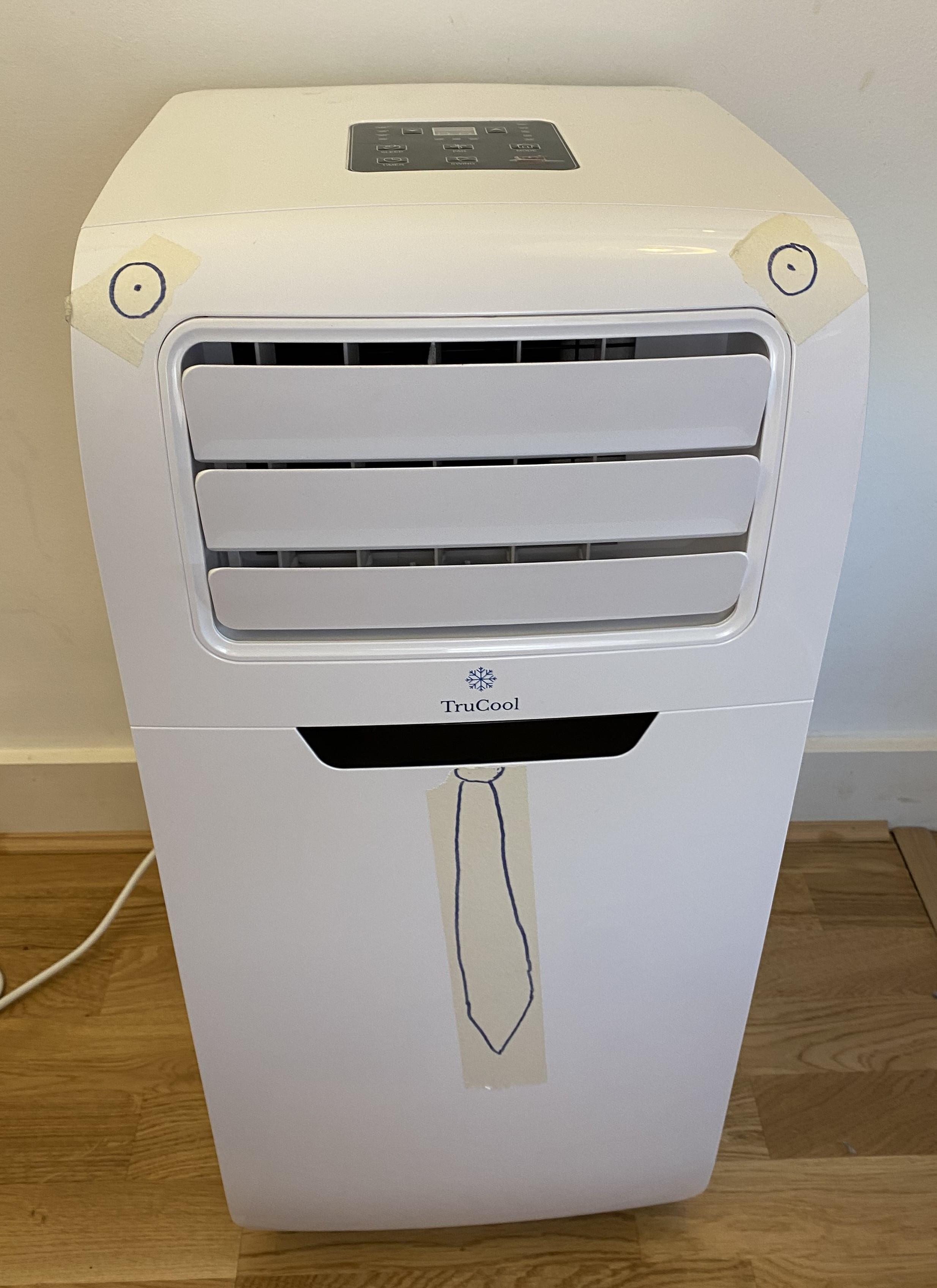

This is the cheapest AC that was available on Amazon. When I saw it had Wi-Fi and was a Tuya device, I knew I had to at least tear it down.
(Eyes and tie are aftermarket upgrades)
