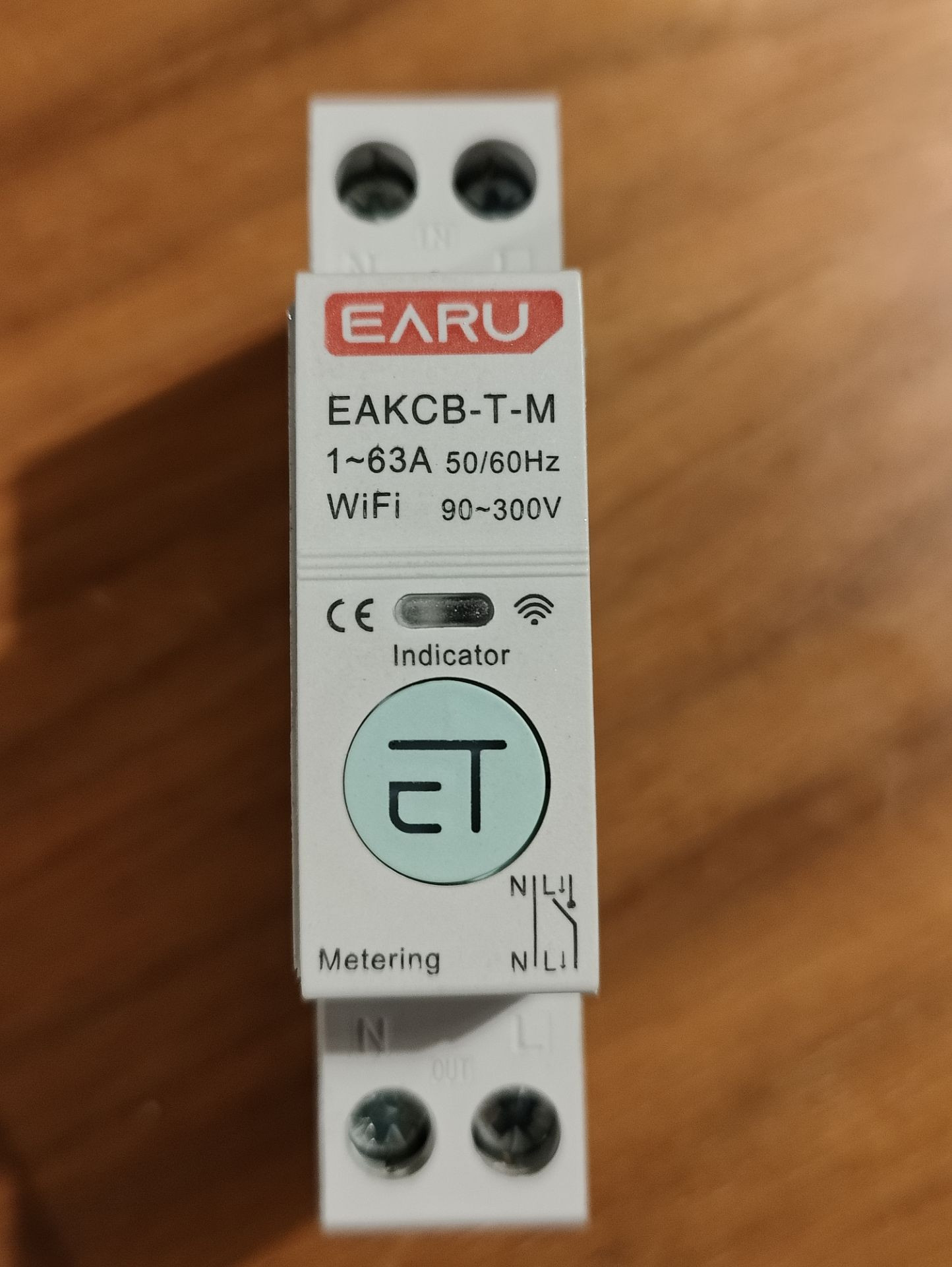

Hi Guys,
I post this information, as a work/response for old threads for this device : Earu EAKCB-T-M.
Device is not listed in device database.
Device was listed as work in progress 3 years ago
Device was reported unstable (restart when button pressed) (Original Polish thread here)
Room temperature not reported, but some information already existing.
Device characteristics
CBU board using BK7231N chip.
Magnetic Polarized Relay (energized only when switching) using Relay Driver IC MD7620 (Shanghai-Mingda-Microelectronics).
Watt/Volts/Amp/Power factor/Frequency meter: BL0942 chip.
Room temp (well electric box temperature) from onboard thermistor.
Flashing device
Flashing is straight forward.
You need to open the device (6 small rivets to drill), then it opens.
CBU doesn't need to be de-soldered from PCB.
You need a 3.3V power supply, to power cycle device when asked for by BK7231 GUI Flash Tool.
Connect TX/RX and GND to your USB/Serial adapter, launch BK7231 GUI FlashTool, and start writing firmware.
When BK7231 GUI FlashTool ask to power cycle power, just supply 3.3V to VCC pin and it should work.

I ordered two Earu relay from aliExpress, at the cheapest price (as I always do!).
By the way, I don't have any interest with EARU, even if my forum name is earurelay. Was lazy to find a nice name :)
One relay was working OK, the other experience the same behavior. Rebooting when switching.
I tried many differents things:
Swapping relays.
Then, I checked capacitors, hoping that they were faulty.
Bad earu relay capacitor (marked with a X) : 4.3uF instead of 4.7uF (400V).
Good earu relay capacitor: 4.3uF instead of 4.5uF (400V).
Bad earu relay capacitor (marked with a X) : 442uF instead of 470uF (16V).
Good earu relay capacitor: 469uF instead of 470uF (16V).
I even checked both primary resistor. Same 10.3 ohms for each (10 ohm from color code).
T7 tester displaying a resistor value of 10.3 ohms
Even by swapping all this components, behavior is the same.
The good one is still working, even with 'bad' capacitor.
And the bad one doesn't work, even with 'good' capacitor.
I noticed that CBU board is not well aligned with main PCB on the 'bad' one. I will try ti reflow and align it.
EDIT: I did it, nothing change. I think voltage regulator IC is weak.

tkordus 22 Sep 2025 16:02
I have similar RDCBC2-WIFI devices that I use for measurements. After about 9 months in both of them the 470uF/16V capacitors faded, so when I open them I recommend replacing all of them right away :)... [Read more]
divadiow 23 Sep 2025 07:28
http://github.com/OpenBekenIOT/webapp/pull/226 [Read more]
kaczakat 06 Oct 2025 14:18
Congratulations on your progress. I have a question related to this unit, what ideas do you have for restoring the housing to its original condition after reaming out the rivets? There are tubular rivets,... [Read more]
earurelay 12 Oct 2025 21:36
Hi Kaczakat. Well, I just screwed some M2.5 screws inside rivet hole. This fit perfectly, and keep it tight. Youare right, you can use tubular rivets, but I never tried. [Read more]
earurelay 14 Oct 2025 21:29
Hi again Kaczakat, Here is what I do at home. 2,6x16mm screws. https://obrazki.elektroda.pl/9331459300_1760470161_thumb.jpg [Read more]
savalex1977 19 Mar 2026 14:38
I fixed the reboot by increasing the power supply. I soldered two BP2522F chips in parallel. https://obrazki.elektroda.pl/9415167300_1773927422_thumb.jpg [Read more]
earurelay 20 Mar 2026 13:29
Brilliant idea! I'll do the same to quickly fix my bad devices. Thanks ! [Read more]
