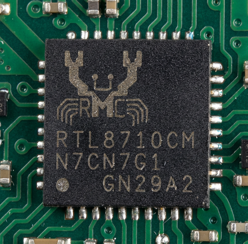

RTL8710CM can be found in various IoT devices, but in this case we'll present a simple smart switch compatible with the Meross app, model MSS810HK-UN V7.0. It can control a single light up to 150 W (for CFL and LED) or up to 400 W (for incandescent lights).

Device board is marked as DzMrWFS1JDQ-K V1.6 2023-08-11, and the WiFi module inside is using RTL8710CM. It also has an onboard flash memory chip, just like some ESP modules do. That's where firmware is stored.

Desoldering WiFi module
This WiFi module has programming pads on the back, so it's not accessible without desoldering. I had to use some flux and copper wire to clean the pads and remove the module.
Wi-Fi module mounted on a PCB with chip components and screw terminalsClose-up of a PCB with electronic components and screw terminal connectorsPCB with electronic components including Wi-Fi module and 3.3μF 400V capacitor
WiFi module is marked as MR2EHK_REV7.0. The four pads on the back are marked as GPIOA_0, GPIOA_13, RX and TX. The bottom pads are not marked.
Green PCB labeled MR2EHK_REV7.0, GPIOA_13, RX, TX, held by metal tweezersElectronic module with RTL8710 chip and PCB antenna held by tweezers
