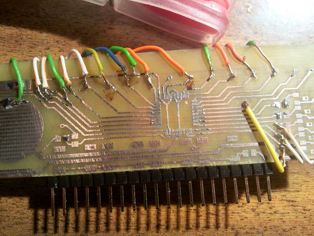

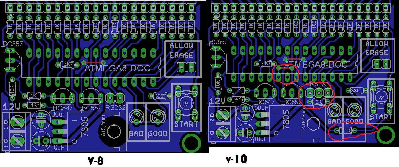

    I made a compilation of my colleague's version and I would like to ask if there are only 3 differences in pcb between version 8 and 10 because I made the chip in version 6 and I had to cleverly add 1 resistor and now I will have to make these 3 corrections. Adds a version comparison and the idea of making a fix.
    Atmega Fusebit Doctor (HVPP + HVSP) - fix fusebits Atmega Fusebit Doctor (HVPP + HVSP) - fix fusebits
    Ps. There is no single hole on the plate at a distance and the plate is swinging.

    After 1, not version 8 or 10 or 6 because you don't know what's going on. Plates are labeled sequentially 2c, 2d, 2e, 2f, 2g, and the last 2h :)
    Past 2:
    manekinen wrote:
    PCB v.2h:
    - RX pin and 10K pull resistor added
    MUST add a resistor if you are upgrading to 2.10!
    My colleague forgot to add this resistor in his drawing, and it is important when updating the program to 2.10. Without it, the RX pin will be in a transient state and eggs will just happen. After that everything ok. Reset pull-up resistor optional, solder in case of problems.
    And one hole is missing. It can be made in the place of a power socket and the wires are soldered :)

    It's about the differences between pcb 2e and 2h or there are only 3 differences between the versions marked in my post above (I marked the resistor in a circle in the second photo and it is gray in 1 photo).
  • #130 9312315
    manekinen
    Posts: 1629
    Help: 76
    Rate: 2360
    And there is actually a resistor, I did not notice :cry:
    There were no more changes, you can do :)
    2c - the first published version
    2d - resistor pulling the patient reset line has been added
    2e - a resistor pulling the patient's VCC line has been added
    2f - AVCC pin power supply added, this board appeared only in this topic
    2g - added pullup on reset pin
    2h - RX pin and pull resistor added.
    I have even more corrections glued on the board (from the bottom), because it was the first prototype board - 2a.

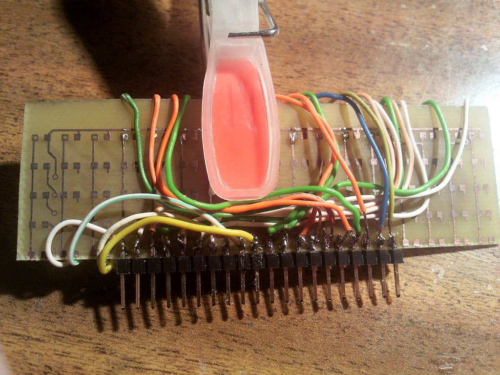

    If someone was interested in SMD adapters for circuits:
    Pin compatible with Attiny13
    Pin compatible with Attiny2313
    LINK
    about half way through the page
    If someone does not digest Cyrillic - LINK
    Although the description is the same as in the original.
    Even a clothespin can be used, it only needs a strong spring.

    AHA, plates for atmega fusebit doctora will be available soon :) So if anyone else is planning to build, I suggest you wait :)

    Ok in the attachment, version 2.11 with the setting 2400 - not tested.
    Tiles in the 2H version - nothing will be changed, no one reports any errors, so both the board and the soft are finally ok :)
    • 2.11_2400_m8.rar (10.84 KB) You must be logged in to download this attachment.

    Hello colleagues
    Some time ago I was building uProg - a different layout from the Author of this project.
    Unfortunately, because of my indolence, I tried to program the Mega328P processor - powered by a 3V battery - with the USBAsp programmer operating at 5V.
    After the 2nd attempt (i.e. after the 2nd CPU :) ) I contacted a colleague mannequin to explain what I am doing wrong. It turned out that the catalog note describes the maximum voltage difference between the power supply of the target circuit and the programmer at the level of 0.5V. This was the cause of the death of these two processors.
    I asked a colleague mannequin o designing a set-top box / adapter to save processors in SMD casings - I wanted to check if, by some strange coincidence, the processors survived - they just blocked ...
    Something like this arose:
    At this point, I would like to thank the author for designing both the Doctor and the adapter.
    I used such paper clips for mounting - they work perfectly
    I cleaned the legs of the soldered circuits with a braid and attached to the adapter:
    After a few tries - due to the lack of contact on the key feet - I got the following result:
    AUTOMATIC HVPP MODE
    Init programming...  DONE
    Read signature...    7F 7F 7F - FAIL!
    Trying T2313 pinout..7F 7F 7F - FAIL!
    No chip in socket or chip does not responding
    Please try again...
    After pressing even harder, the log appeared:
    AUTOMATIC HVPP MODE
    Read signature...    1E 95 0F
    Searching chip...    no names in 8kB ver
    Chip erase...        DONE
    Read fusebits...    L:46 H:D0 E:FD
    Should be...        L:62 H:D9 E:FF
    Lockbits...          DISABLED (FF)
    Writing 62 D9 FF...  DONE
    Verifying...        L:62 H:D9 E:FF - OK!
    35 fixed chips
    Thank You
    So the processor is operational ... I immediately started the second damaged processor and after the initial effect:

    They both live ... The remaining question of ISP efficiency. I connected to the programmer and read the signature - it started. To be sure, I uploaded almost 32kB soft and verified it - it was positive.
    To check if the adapter is compatible with other processors, I tested it on:
    Mega8 Tiny2313 Mega32 Mega328 and Mega128
    The latter in the photos below:
    Log:
    AUTOMATIC HVPP MODE
    Read signature...    1E 97 02
    Chip erase...        DONE
    Read fusebits...     L:E1 H:99 E:FD
    Should be...         L:E1 H:99 E:FD
    Writing E1 99 FD...  DONE
    Verifying...         L:E1 H:99 E:FD - OK!
    39 fixed chips
    Thank You
    So the adapter is suitable for saving even desoldered seemingly dead processors in SMD casings.
    I recommend it to everyone - you can significantly reduce the costs of our hobby :)
    Regards and thank you, my colleague mannequin for any help
