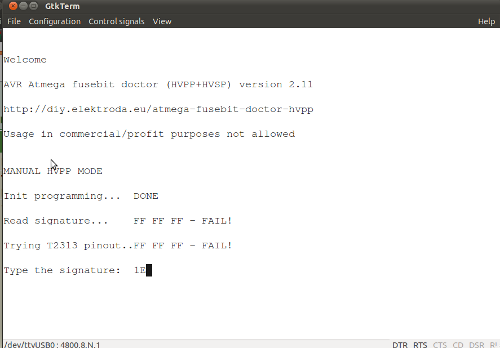

  • #157 9990802
    novak512
    Posts: 55
    Hello, after such a long break. :) The academic year has started, so it is time for a little self-education. :P
    The doctor has finally been launched. The error that caused him not to act was, of course, a short circuit on the DATA5 line. I tried to write down the different coffee grounds on the working machines and then compare them with those from the doctor. It turned out to be reading lfuse correctly, while hfuse was wrong.
    The short circuit was so slight that I found it only after painstakingly checking the short circuit between the patient lines with a meter.
    I managed to unlock 2 atmegi8s, but I ran into a problem with the remaining 2 atmegi8s and 3x 2313. In both cases everything indicates that their signature is damaged. Is it possible for such a large amount of uC to be defective?
    log for AT2313:
    Init programming ... DONE
    Read signature ... FF FF FF - FAIL!
    Trying T2313 pinout..FF FF FF - FAIL!
    Type the signature: 1E910A
  • #158 9990884
    manekinen
    Posts: 1629
    Help: 76
    Rate: 2360
    Hello. It's nice that the error was found :)
    A damaged signature is beyond repair. No programmer will do it, it's Atmel's secret how they write these signatures :) If this information leaked out and it was possible to do it at home, think how many painted layouts would hit the market ...
    So these tiny2313 are working, but to be able to communicate with them from avrdude you have to use the option -F which will skip reading the signature.
    As for atmeg8 - in my opinion they are dead.

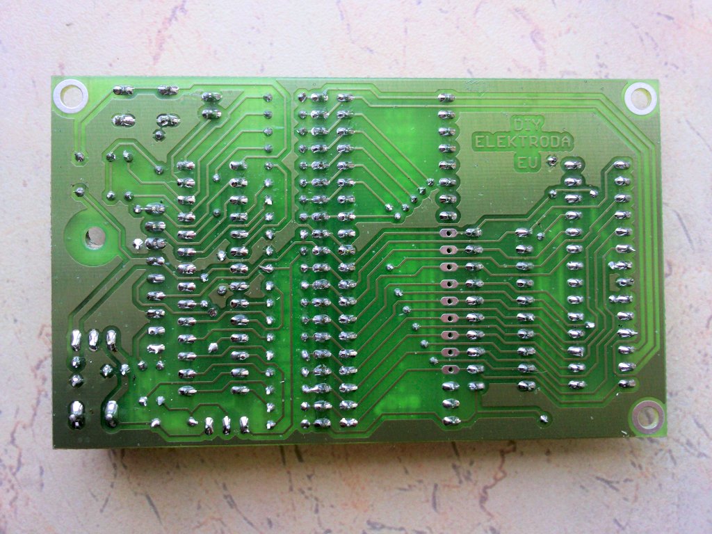

    I would like to remind you that I have tiles for this layout, if someone has a problem with making their own (and it is a bit dense), then I invite you. I soldered my circuit to the factory PCB :)
    Atmega Fusebit Doctor (HVPP + HVSP) - fix fusebits Atmega Fusebit Doctor (HVPP + HVSP) - fix fusebits

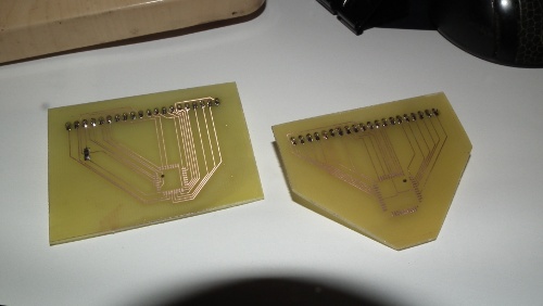

    zdarecki
    Posts: 25
    finally I mobilized myself and put together this system in the smd version.
    tile patterns in pdf after printing are smaller, I adjusted by enlarging in the printer settings - 100.5%
    the system practically takes off from the first shot there were no problems
    2 atmegi8 in a DIP housing were up, it was supposed to be great ;)
    while in the smd housings (of course a different adapter) I had 2 atmegi16 and 3 atmegi8 blocked (mainly I was counting on them) and the defeat of the fusia cannot be changed.
    It drove me to connect a working atmeg8 ... and it joined the scrap box.
    I would think that these atmegs are completely blown (they were all blown with kontrollerlab, I discovered such a bug in it), but why did it break out efficiently?
    I checked the adapter, there are no gaps, no short circuits, what is it?
    I modified the programmer to version 2.11 but the manual option did not bring anything new.
    best regards
  • #160 9997584
    manekinen
    Posts: 1629
    Help: 76
    Rate: 2360
    Write more details. What LED is on? Such a thing is due to the fact that one of the smd adapter pads does not connect and thus the fuses transferred to the prock are wrong. Try to align the pads and / or apply more pressure to the pads.
    You write that the manual option does not help, that is, your system is connected to the terminal ... What does the terminal say? What are the fuses after saving? It's best to paste some logs.

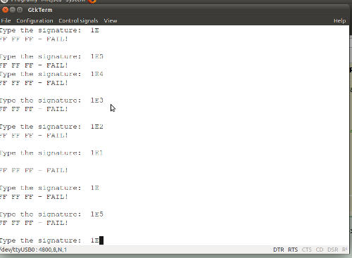

  • #161 9997849
    zdarecki
    Posts: 25
    LEDs in auto mode: briefly lights up green then flashes red
    below adds a screenshot from manual mode

  • #162 9999373
    manekinen
    Posts: 1629
    Help: 76
    Rate: 2360
    There must be some babol on the board though.

    zdarecki
    Posts: 25
    I have no idea what this adapter does not suit, but I know 100% that it's his fault.
    I made a single adapter for the atmega16 and one of them got up, the other stopped showing signs of life.
    there is progress, so I carve the adapter for atmegi8

  • #167 10004590
    zdarecki
    Posts: 25
    You can not choose any option, on the screen you can see that he is entering the numbers after 1E, I approve enter but it does not matter the program does not end and both voltages remain on
    screen
  • #168 10004612
    manekinen
    Posts: 1629
    Help: 76
    Rate: 2360
    Because you have to enter the signature to go further (the correct signature) ... hmm, in fact, there would be a handy option to cancel or something. Unfortunately, I do not plan to issue further updates because it looks like the program works flawlessly (nobody reports anything), but if necessary, I will remember about it :)

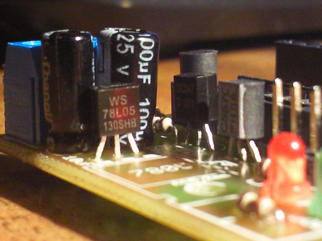

    manekinen
    Posts: 1629
    Help: 76
    Rate: 2360
    Is my friend the same person who wrote this on my website? If not, we already have two cases.
    And today, during the assembly, I tested the system with the 78L05 stabilizer - the version in the TO92 housing, max current 100mA. It is doing great, the current does not exceed 70mA (circuit assembled according to the diagram). It can also be successfully used interchangeably, it is cheaper, and it is enough to solder it like this:
