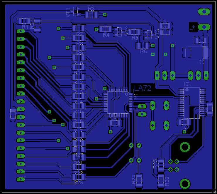

    As the SMD version is not very good, I tried to improve it.
    The whole was based on the author of the project.
    Atmega Fusebit Doctor (HVPP + HVSP) - fix fusebits
    Below are screens from the top and bottom of the board.
    Atmega Fusebit Doctor (HVPP + HVSP) - fix fusebits Atmega Fusebit Doctor (HVPP + HVSP) - fix fusebits
    In the attachment there is a picture of the board from the BOTTOM side of preparation for "ironing" and a list of parts.
    • Atmega_Fusebit_Doctor_SMD_cz____ci.txt (3.56 KB) You must be logged in to download this attachment.
    • Atmega_Fusebit_Doctor_SMD.pdf (34.75 KB) You must be logged in to download this attachment.
