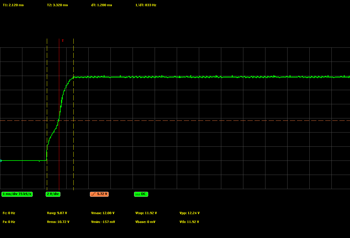

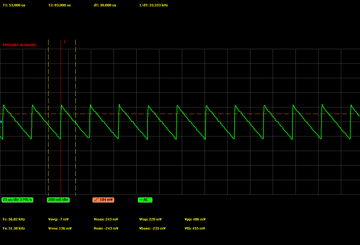

  • #247 13262090
    manekinen
    Posts: 1629
    Help: 76
    Rate: 2360
    My other device using HVPP, which has already been "created" since the beginning of 2013 and cannot be built, uses just such a converter based on MC34063, but as I suggested earlier, the whole converter is switched on with the P mosfet and there is only a pulldown and a capacitor behind it.
    The experiments took some time because I couldn't get the right output voltage. Pulldown had to be strong to cut the power off relatively quickly when the inverter stops, the capacitor would have to be large to smooth the peaks of the working choke. The whole problem is that the stronger the pulldown, the higher the oscillation at the output and you need to give a larger capacitor. The larger the capacitor, the longer the output voltage lasted after turning off, and a stronger pullup must be produced :)
    If I find a diagram somewhere (when I changed my laptop, I lost some of the documents), I will paste it, I only found oscillograms how the 12V line behaved:
    Unloaded output switched on
    Atmega Fusebit Doctor (HVPP + HVSP) - fix fusebits
    Loaded with 10mA (and still not enough)
    Rising edge:
    Falling slope:
    And such a thing was acceptable by the initiated system, although there were sometimes problems. With the loaded output above 10mA, i.e. oscillations greater than 0.5VPP, eggs appeared.
    More about the choke. I think I gave 330uH, it is known that the greater the noise will return to the 5V power supply, and this significantly influenced the work of the whole, the more that it was powered from USB via the ISP programmer. So you also need to put a large capacitor in front of the MC circuit.
    The voltage setting resistors are 3K9 and 33K from what I see on the pcb, but both were selected individually, one was the smallest and the other the largest of the entire tape - then with 5V at the input I got a nice 12V.
    If you can do it better and simpler, it will be nice if you share your knowledge.
