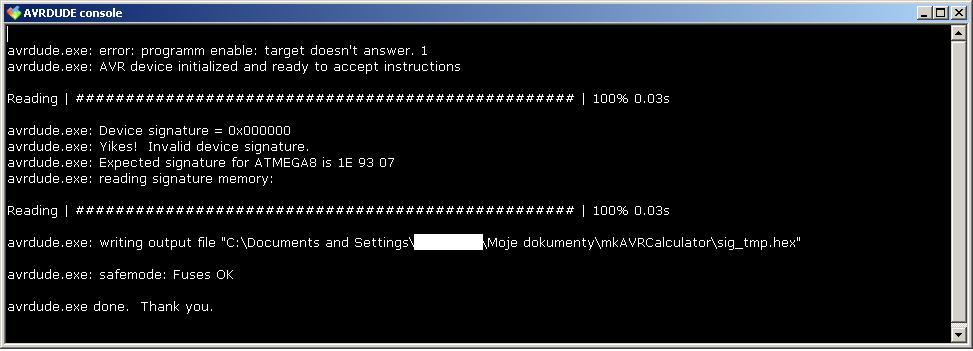

    I made this layout from http://mdiy.pl/atmega-fusebit-doctor-hvpp/, and downloaded the updates "UPDATE # 11, 04/30/2011:" I uploaded soft, everything is nice, but when I put some processor into the system without a shorted jumper EESAVE, the system is not repaired, only the green LED will flash for a while and the red LED will start to light up, but when I put the jumper on, the green LED will light up once, not more often when the system is pressed to the socket, and when it lights up, the system is not only his signature fixed
    avrdude: AVR device initialized and ready to accept instructions
    Reading | ################################################### | 100% 0.02s
    avrdude: Device signature = 0xc7c7c7
    avrdude: Expected signature for ATMEGA8 is 1E 93 07
    Double check chip, or use -F to override this check.
    avrdude done. Thank you.
    What can you advise me about this? :(
  • #214 11814375
    piotrva
    Posts: 6409
    Help: 625
    Rate: 735
    What you showed with AVRDude was reading Atmega8 as doctor or patient? Because, unfortunately, it is impossible to repair a damaged signature. Do you have access to RS232?
  • #215 11814439
    Czang16
    Posts: 41
    what I showed was the reading from the patient, but this atmega was quite functional, only after putting it in the doctor it broke :( no, unfortunately I can't access RS232
  • #216 11815379

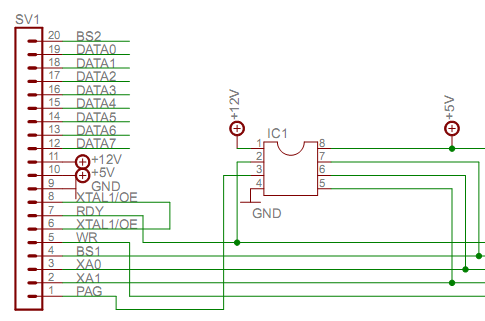

    I've blocked myself Attiny85. I don't have an overlay for tinny. How should I connect to the trap?
  • #236 12637659
    manekinen
    Posts: 1629
    Help: 76
    Rate: 2361
    According to the HVSP adapter diagram.
    Don't forget to short the XTAL1 and OE pins to force serial operation.
    Atmega Fusebit Doctor (HVPP + HVSP) - fix fusebits
