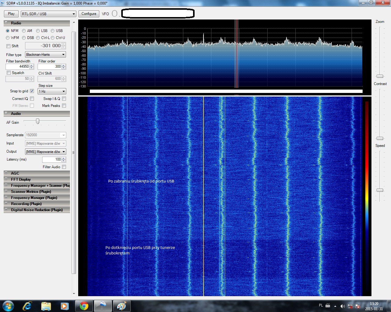

    Gentlemen, I need your help because I'm losing my patience :(
    For some time I have had sharp disturbances that can be seen in the screenshot below. Today I wrapped the tuner with sandwich foil and the interference slightly disappeared, but another problem arose, after touching the usb port on the tuner with a screwdriver / knife, everything improves, if I do not touch this port with a screwdriver, it is sneezing, someone has any idea to remove these disturbances? The tuner is powered on an extension cord from the computer's USB port, wrapped in silver foil and enclosed in a plastic box. Best regards.

    Connect the ground and see if it improves anything. Connect the grounding on the disconnected computer from the mains supply.
    I have the earthing connected a long time ago, the new electrical installation also has no problems with earthing.

    But where are you connected to the ground?
    Nom the pin in the socket is ...

    Do you use a laptop or a desktop computer? The fact that there is a prong in the socket (of course connected to the ground) does not mean that the ground is on the computer housing.
    If you have a multimeter, check (by touching the pin in the socket and / or the strip) whether the grounding is on the computer casing and on the USB port. If it is a laptop, then 99% there is no grounding on the laptop casing, and thus also on the USB ports, and thus it is not on the tuner.
    I use a desktop computer, the pin in the socket is connected to the ground, I know because I did the installation myself in this house, because after all, I am an electrician ;) The grounding on the computer casing is, as a curiosity, I will add that the same interference is when I use SDR with a laptop and a tablet, being with the same set, i.e. dongle + tablet in a completely different place, this interference was not Oo. I had a Not Only tuner that year The TV and later also showed such disturbances, although when I bought it, they were not there ....

    Well, let me tell you it's strange. It is true that I have various types of disruptions myself, including from energy saving light bulbs, converters in power supplies and other electronic equipment in the home. But, for example, after going outside the building (I live in a detached house) with a MiniWhip antenna on a mast made of PVC tube and a laptop, I have a surprising improvement in noise and of course the reception becomes clear but only if I take the Lenovo X61, I also have the T60 and the latter it generates interference even if I touch the Touch Pad, of course while running on the battery.
    If I were you, I would have thought about grounding and its various connection points to the computer and the tuner itself (from the USB or antenna side).
    The second option is that the tuners themselves either start to die slowly, or after a certain period of work they start to work differently, they heat up mercilessly. Alternatively, voltage regulators or converters built into the tuner begin to sow ...
    These are my wishes, I have never really approached the fight against interference with RTL-SDR. To listen to the frequencies that interest me, I use devices designed for this.
