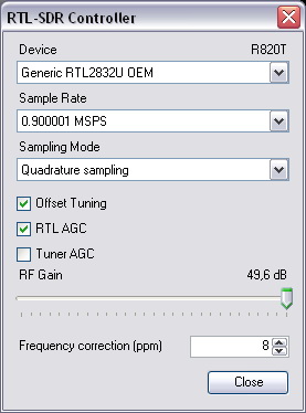

    Colleagues how to improve the sensitivity of the receiver?
    I can hear very little :( for example, when it comes to a taxi, I only hear the headquarters and not the cars.
    I have an old Alinco DJ-190 at home and I can hear everyone on a short antenna on it ...

    The program is SDRSharp - maybe something needs to be changed in the program?
    I connected the antenna with the Alinco DJ-190. Of course, I can hear everything nicely on the radio and unfortunately not on SDR - only strong stations.

    You shouldn't have such a significant difference in sensitivity.
    SDR RTL is less sensitive because I have various hand towels and scanners myself and I can see it too, but while for SDR you have something that is a relatively effective antenna, the difference between the devices should be felt only in the noise level, but the signal should be received.
    With these sliders for sensitivity in the program setting, you should not overdo it, because the effect will be opposite to the intended one. I suggest that you do not turn on the gain option at all in the "RTL AGC" and "Tuner AGC" fields, because this only results in an increase in noise and deterioration of the noise-signal ratio.
    Slider max at 70-80% and a sensible antenna fired outside the apartment as high as possible.
    A better option than using the amplifier in the "dongl" itself, which has a high level of noise, is to turn the gain in it to a minimum and to attach an appropriate external amplifier, which can be purchased in some electronics stores, "LNA".
    I will also mention that some DVB-T USB receivers do not have ESD protection in the form of a diode at the antenna input. The effect is that after a few games with a longer wire, the receiver circuit breaks down and the sensitivity of the device drops terribly. It should be checked.
    best regards

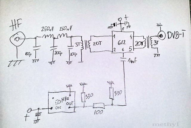

    By the way, I once promised to check the operation of the converter for ne612 in a system with a signal connection on one leg and connection via an impedance matching transformer, to both inputs of the mixer.
    So in the first case, despite the use of the gain stage on the 1st transistor, it was worse. Weaker signal and more noise. This layout with transformers is very good. A colleague kriss51 in the post "243" posted such an arrangement. I did with a simpler input filter and no high-pass output. I paste the diagram below. Out of the tested ones, this one wins with the signal level and small amount of garbage.
    How to use RTL-SDR on a cheap USB DVB-T tuner for HF and 64–1700 MHz?
    In the picture, the power supply of the chip is simplified to such an extent that I forgot about the 3rd leg (mass). I am writing so that there are no misunderstandings :D
    The second thing. If you want to have a clean listening session to the HF, then you must have a narrow preselector at the input, or instead of a low-pass filter, you need to provide switchable bandpass filters. Otherwise, unmerciful muck. On the 80, without the preselector, I only have clamor and distortions. After tuning with the antenna preselector, I have stereo ;)
    Preselector I recommend this:
    http://sp-hm.pl/attachment.php?aid=6802
    As for the simplicity of execution, it is divine and not only my opinion.
    Best regards !
