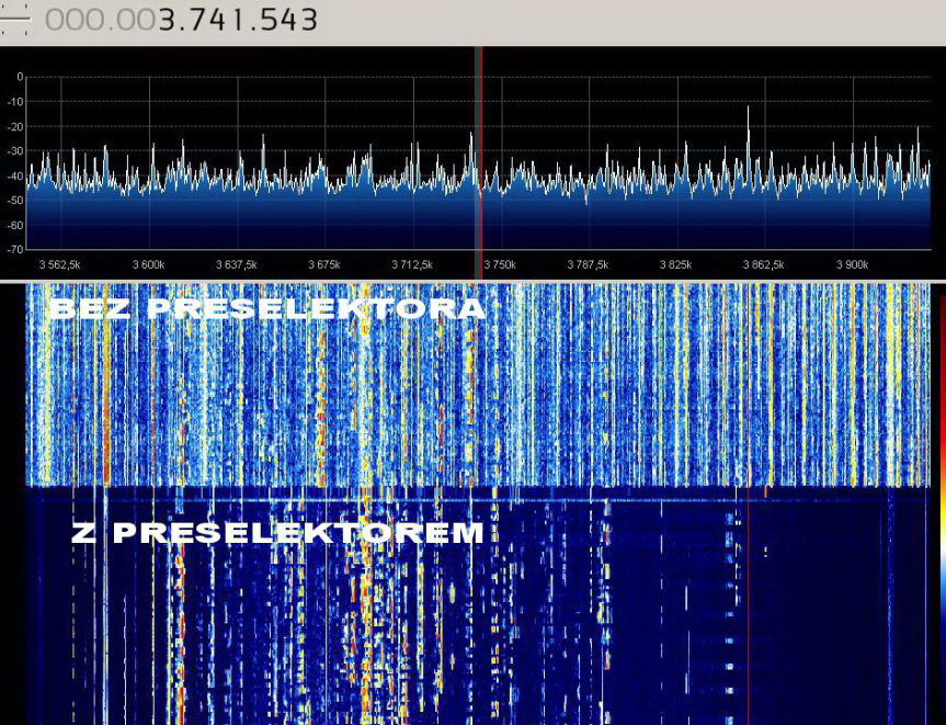

  • Preselector and isolated power improve 80-meter RTL-SDR reception
    #333 14301824
    methyl
    Posts: 183
    Rate: 32
    Maybe the picture shows the operation of the preselector more clearly.
    80M band. antenna LW + Un-Un 9: 1 yesterday, around 20?
    How to use RTL-SDR on a cheap USB DVB-T tuner for HF and 64–1700 MHz?
    Without the preselector, the reception of the 80 would be impossible for me, except with a narrow bandpass filter.
    I don't think I need any further comment :D
    The most important thing is to power the computer from a transformer power supply !!
    Power the converter from an akku / battery or a transformer power supply !!
    Give preselector or bandpass filters!
    There are a few other "tricks" but these are the most important.
    All these things change the listening experience tremendously, especially low frequencies.

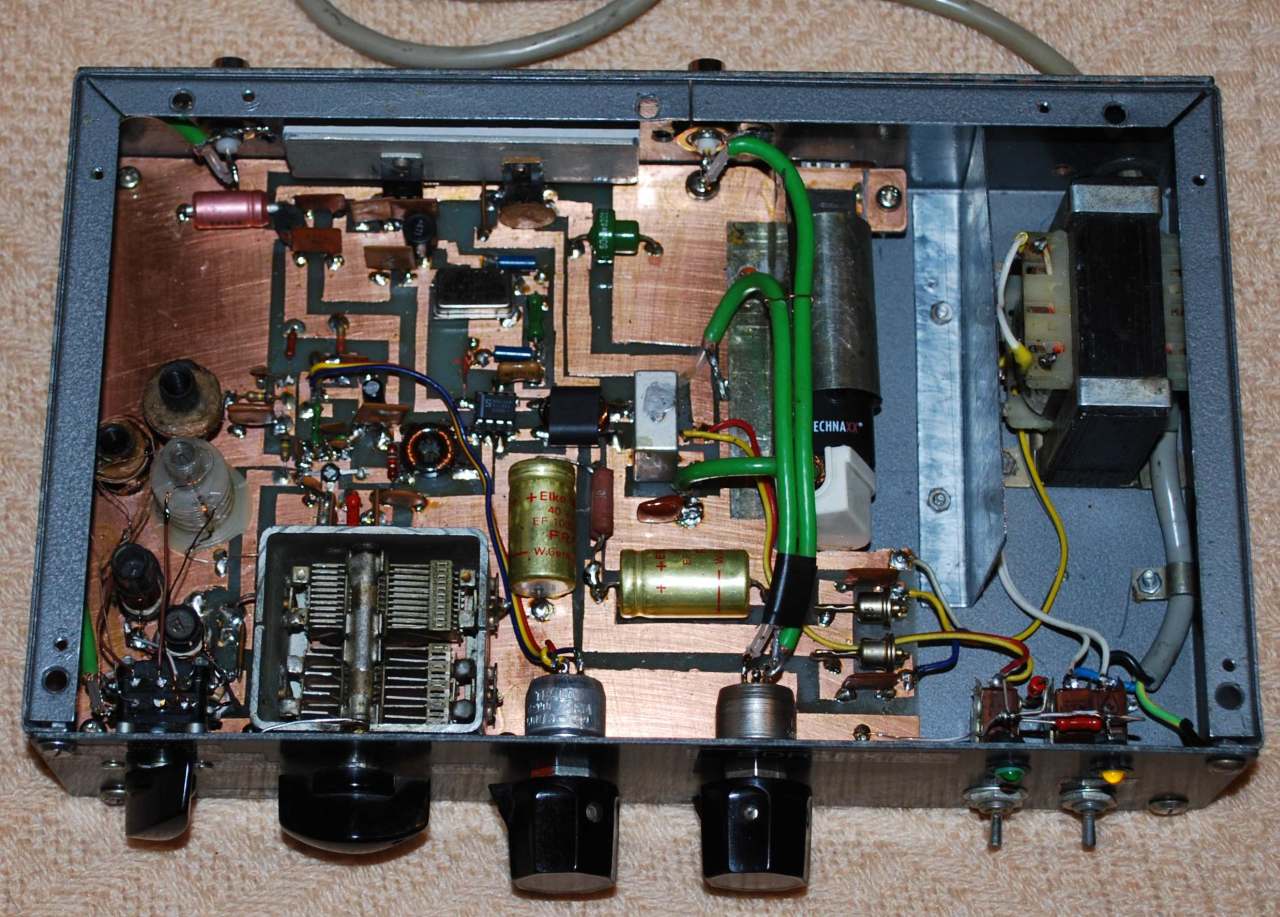

  • Coupled chokes and adjustable low-loss preselector layout
    #334 14307160
    mkpl
    Level 37  
    Posts: 5678
    Help: 306
    Rate: 863
    Interesting this idea with winding the air coil as a toroid.
    It works fine for you until I envy ... my receiver is breaking something (disconnects in the system) ...
    An interesting trick is to make a coupled choke for the power supply and separately for the signal lines. Then the problem of computer and power disappears :)
    I also recommend such a layout.
    It allows you to adjust the preselector bandwidth in a wide range and attenuates it practically to zero (the preselector in the passband does not attenuate the signal).

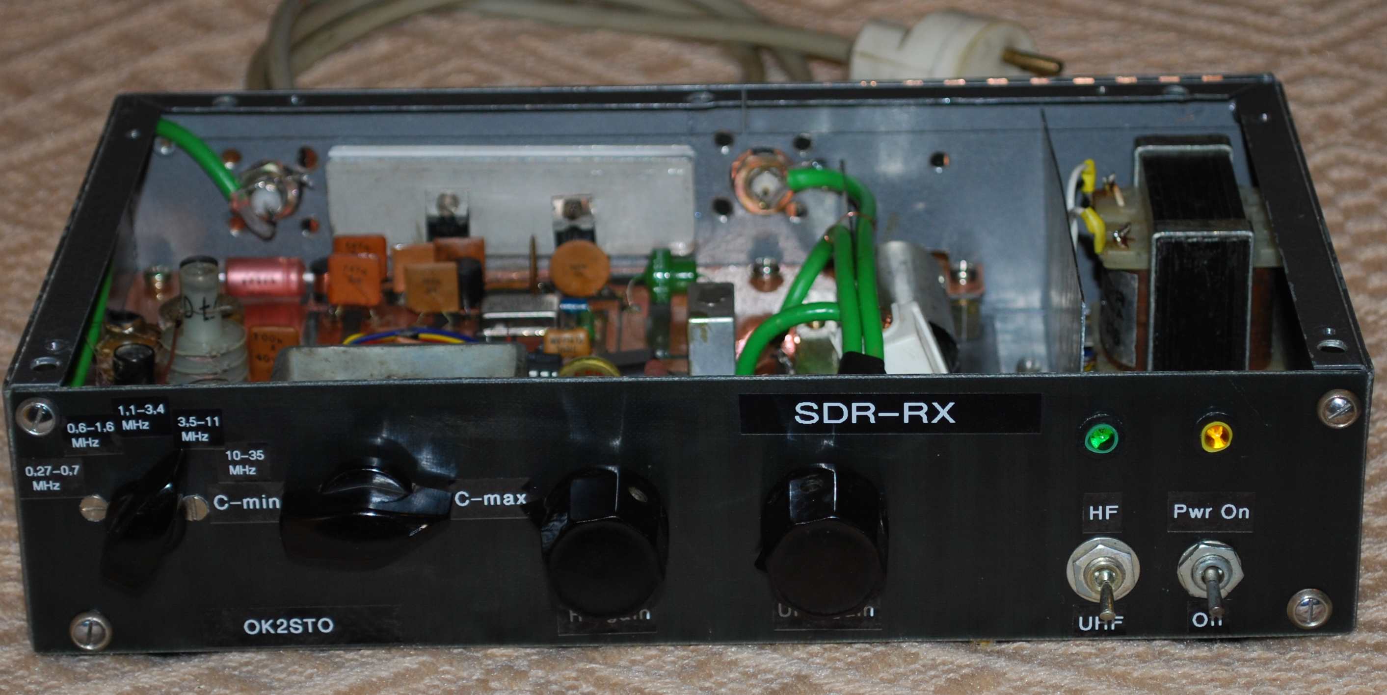

    This is how I made this receiver from the magazine, from what I found in the basement, I did it a little, the coils tuned at the input classic, almost toroids, also classic tunes are 7812 and 7805, at the UHF input they are a potenciometer as an attenuator,
    I did mix as my colleague Methyl wrote above.
    The receiver is blinking, only 0.5 - 2.0 MHz is lower sensitivity.
    Jard
