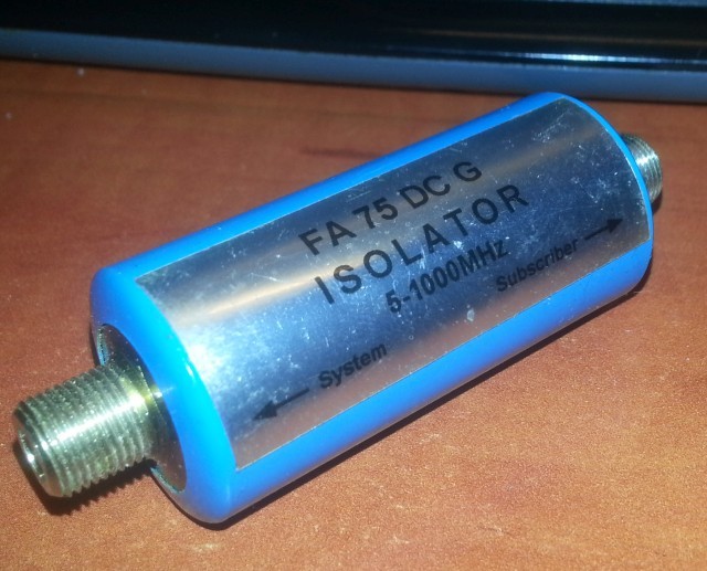

    So, connecting a shorted CB antenna will damage the tuner? Then what separator to use?
    Is something like this good?
    How to use RTL-SDR on a cheap USB DVB-T tuner for HF and 64–1700 MHz?
    OKAY. I connected with this separator. Overall, the reception is now better on the air than CB.
    I just wonder why when someone transmits it on a waterfall, I see it as if it is transmitting on three frequencies at the same time?

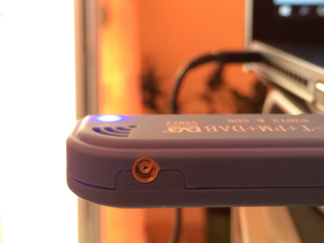

    Hello, let me connect to the topic. Well, I bought a dvbt tuner on the Allegro and, as probably many people, I have a listening problem. Actually, apart from the FM radio, you can't hear anything else. I installed everything according to this manual http://sq6net.blogspot.com/2014/07/instalacja-rtl2832u-i-sdr-na-windowsie.html
    Perhaps it would have to be calibrated and I don't know how. Or maybe it's about the antenna, for now I'm using the tiny one from the set? Have I made a mistake elsewhere?
    For now, this is what my screen looks like, at this point you should hear something from the Balice airport and here the wall is empty.
    https://drive.google.com/file/d/0B3cbjinycuj9c0NfQjdIQlEwb1k/view?usp=sharing
    I will be grateful for your help :)

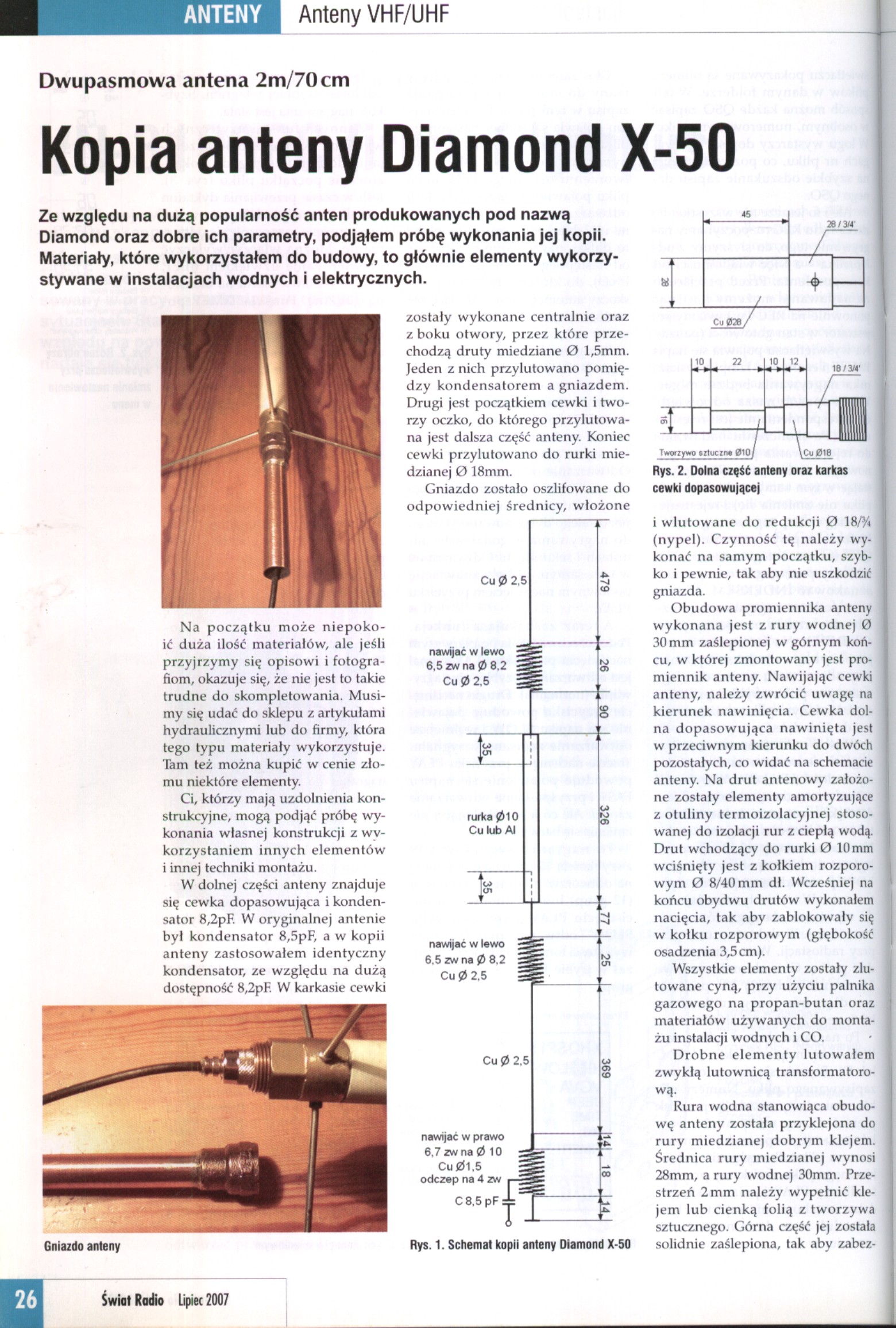

  • Diamond X50 clones and PGA103 amplification improve satellite reception
    #556 14933990
    jagroszek
    Posts: 10
    I recommend copies of the Diamond X50 antenna
    It works very well, you can hear satellites quite well, eg SATCOM and others.
    The basic rule is that the antenna should have horizon visibility, i.e. the appropriate mounting height depending on the installation in a given location.
    The reception can be significantly improved by using an amplifier based on the PGA103 + circuit with a selective input circuit for the frequency of interest. If someone wants to play, you can make several circuits using the relays from the link below.
    http://allegro.pl/ultraminiaturowy-przekaznik-w-cz-teledyne-usa----------------------.html " target="_blank" rel="nofollow noopener ugc" class="postlink inline" title="" > http://allegro.pl/ultraminiaturowy-przekaznik-w-cz-teledyne-usa----------------------.html
    http://www.ok2kkw.com/zzz/hb9afo_pga103.htm " target="_blank" rel="nofollow noopener ugc" class="postlink inline" title="" > http://www.ok2kkw.com/zzz/hb9afo_pga103.htm

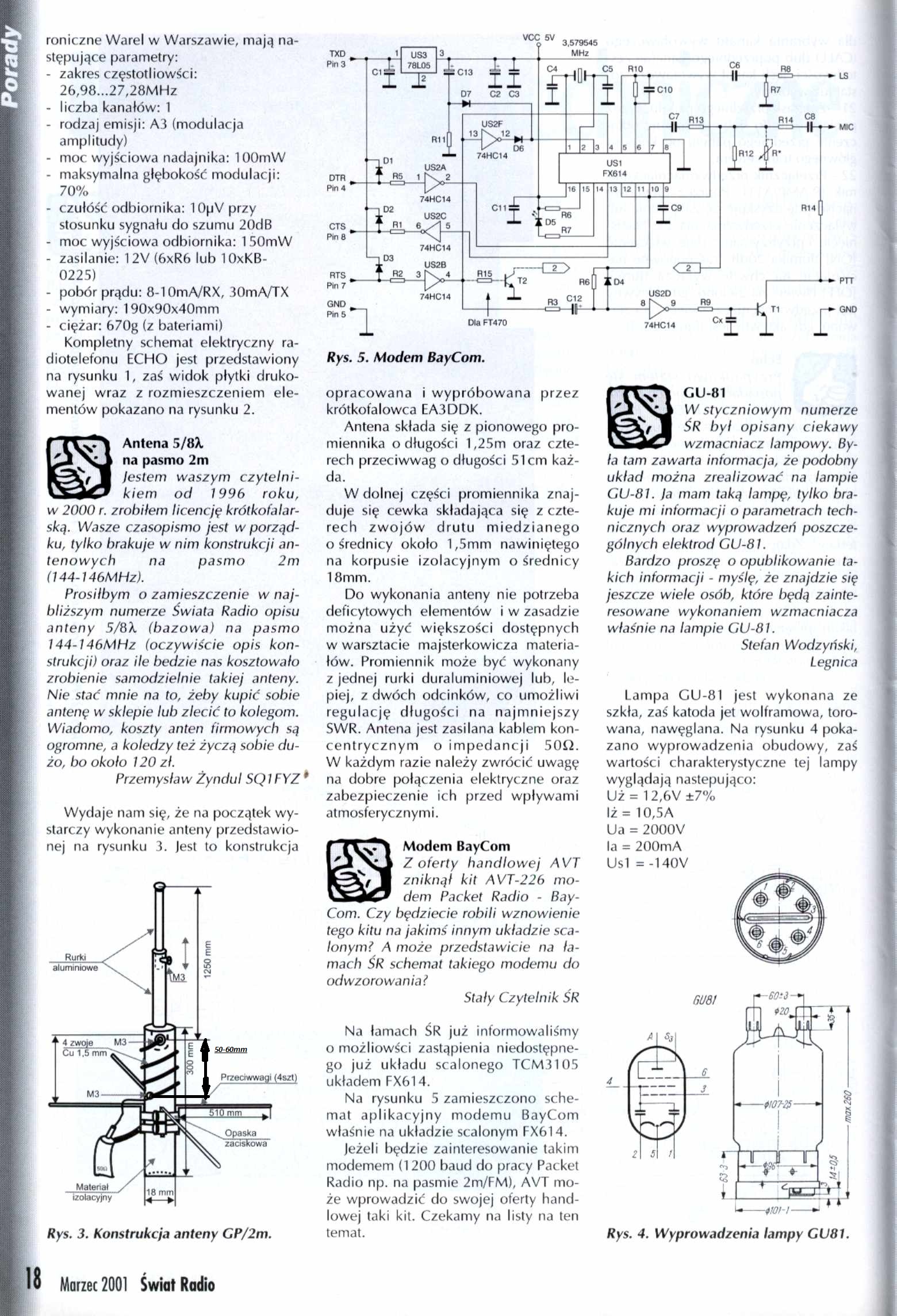

    I have the antenna as in the article in the photo and I receive stations in the KF to 900Mhz band and to be honest it is a simple antenna for the scanner and it does its job. I recommend it because it can be made of the available parts of the radiator with a counterweight from the CB antenna, and counterweights from rods from the TV antenna. I am over 10 years old and I think it has better characteristics than the Diamond X500. Often, when propagating on it, I receive more stations than the neighbor on the X500, come live next to me.
    Added after 5 [minutes]:
    Below I added a photo of this diamond X50 because this pdf is something incomplete.
    How to use RTL-SDR on a cheap USB DVB-T tuner for HF and 64–1700 MHz? How to use RTL-SDR on a cheap USB DVB-T tuner for HF and 64–1700 MHz?

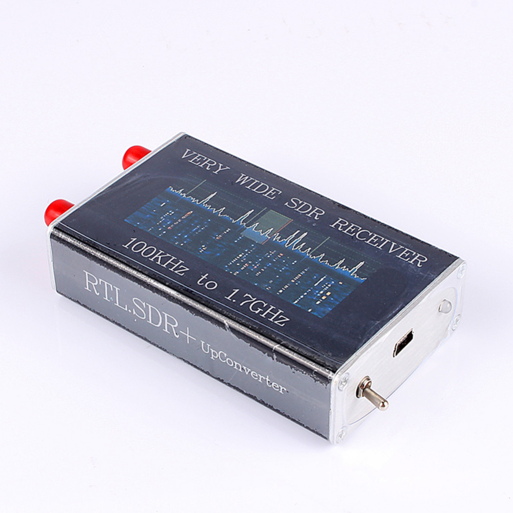

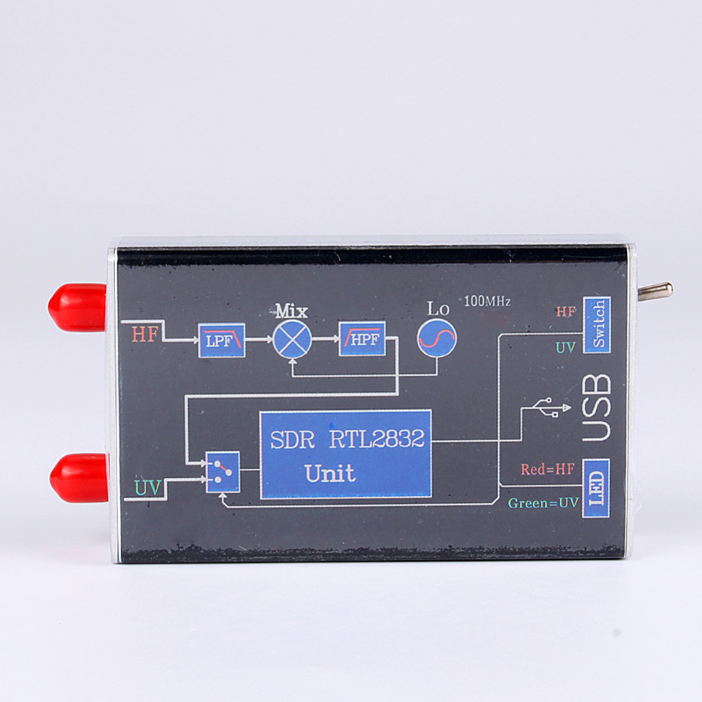

  • Comparing ready-made RTL-SDRs with DIY shielded enclosures
    #568 14996839
    MORZEBALTYCKIE
    Posts: 51
    Hi. As you probably know, Chinese RTL-SDRs mounted in large housings with HF and VHF outputs have been on sale for some time.
    I didn't look at the design, but it looks like a dongle + converter on one board + antenna sockets.
    The whole thing is quite expensive compared to the USB-stick version.
    I have a question is it worth pushing into it? Any of you have already bought and used such equipment?
    Is it better to remake the dongle yourself? So sockets, a shielded USB cable (+ maybe some ferrite filter, as colleagues used in the subject) and of course a decent, shielded housing? I don't care about the KF converter, I have other equipment for the KF.

  • Asking which receiver version performs best on upper bands
    #570 14996914
    MORZEBALTYCKIE
    Posts: 51
    It is about toys like in the attachment.
    It is a pity that there are no photos of the guts, but our eastern friends also offer a DIY version (thanks to which you can play, for example, in winding the coils), but all this is too expensive in relation to what it offers according to me. All in all, it's good that I found a version that even has a block diagram on the housing - it is clearly visible that the VHF module itself is used only with the dongle module. And there are indeed filters at KF.
    Maybe you know which version is the least problematic in reception on the upper bands?
    I used to have such a factory version and it was rather thin.
    Of course, the antenna is the basis, the installation has been working for a long time, I'm just looking for a digital receiver.
