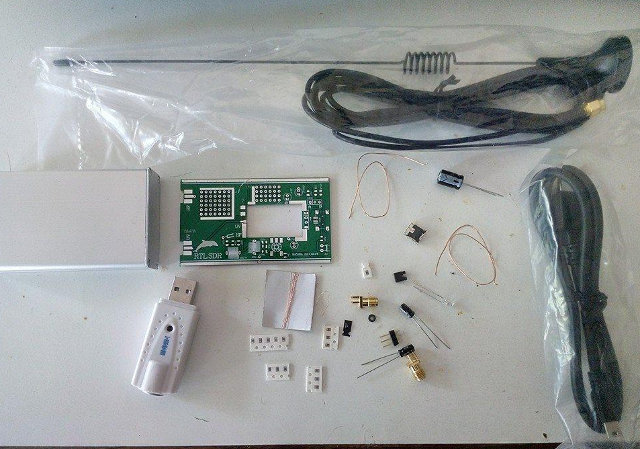

    Pictures of guts very similar are here.
    How to use RTL-SDR on a cheap USB DVB-T tuner for HF and 64–1700 MHz?
    It is clear that it is an ordinary dongel soldered to a PCB on typical components, on which we have a low-pass filter, a quartz generator powering the mixer, the diode mixer itself (double-balanced) and a high-pass filter at the output. I will look for an identical photo yet.
    Write what ranges are you interested in, but in general, you should give a high-pass filter that cuts off the radio range and it is good to cut off the GSM bands and everything that is strongly given after the receiver enters. The best resonant antenna for a given range is DC shorted.
    I do a high pass filter for the receiver is a pimple, I can help.

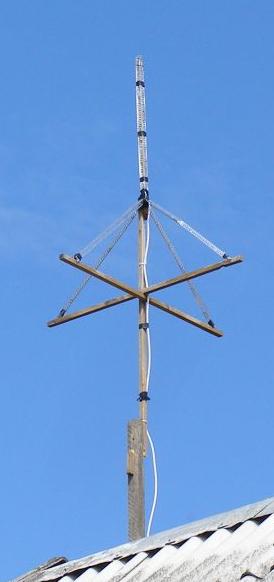

    It is best to put a ready-made antenna on a plate. There is a lot of it on the net. Biconical, bicone, antenna for scanner or anything else and look for. Broadband antennas come in many varieties and designs.
    Check out some photos of making such antennas, even from clothes hangers :D
    Link
    Here is a description of another implementation:
    Link
    Basically it's such a widened vertical dipole. Instead of the arms of the dipole, there are cones, e.g. made of metal mesh, sheet metal, or just a few wires on the contour of the cone.
    The length of the wires that make up the cone can be taken as 1/4 of the length of the longest wavelength that we will receive. Such a calculation is sufficient for receipt.
    Maybe I'll paste some theory later.
    Google "AWX ANTENNA" is also such a two-cone only one-dimensional and does not collect the signal evenly from all directions. Interesting because it can be made as a simple antenna for transmitting two bands 2m / 70cm but it is for those with a license ;)

    To be sure, before your purchase, I will add again that it is an ordinary USB whistle "SDR RTL" with an additional converter board attached when you want to go below 30MHz and manually activated with a switch. If you are not interested in KF, buy a regular R820T or R820T2, you will save a lot of money ;)

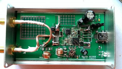

    I hasten to explain that the receiver from the post
    https://www.elektroda.pl/rtvforum/topic2353101-540.html#14996914
    it is not built like the receiver shown above. The nicely taped one from the quoted post looks like this:
    How to use RTL-SDR on a cheap USB DVB-T tuner for HF and 64–1700 MHz? How to use RTL-SDR on a cheap USB DVB-T tuner for HF and 64–1700 MHz?
    and it uses the DIRECT SAMPLING modification on the Q channel as I remember correctly and has no converter. The set also includes the Nagoya UT-102UV, and of course it's not worth the money.
    If it was built on a mixer (converter) it would be a better solution and it would be worth giving more for it.

    Yes, right here you can see that in this performance it is direct sampling.
    But in the previous one, both in the PCB layout and on the colored sticker on the housing, you can see that there is a built-in KF converter there.
    Also, I think that the option with a converter is better, as long as someone is interested in listening to KFu at all. You can see a simple low-pass filter in the photo and a transformer on the ring attached directly to the chip. I used to play like this and even that was perceived, but it pissed me off the most that above half the frequency of the local oscillator, i.e. 28.800MHz, so 14.400 began to receive what it should and additionally mirror what was below. You have to give switchable filters or bandpass filters. Then it would be good to listen to it.
    Here you can see the above system better:

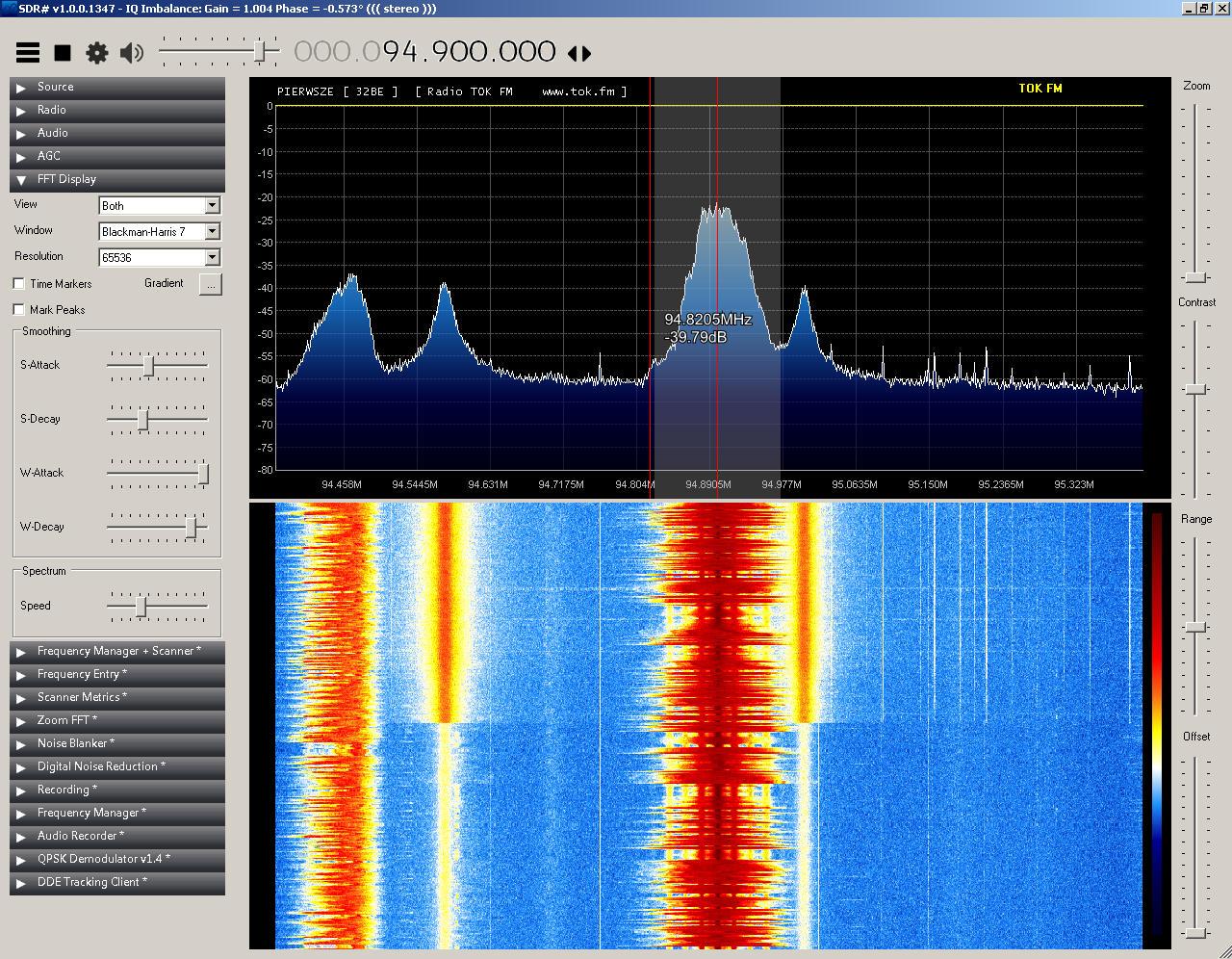

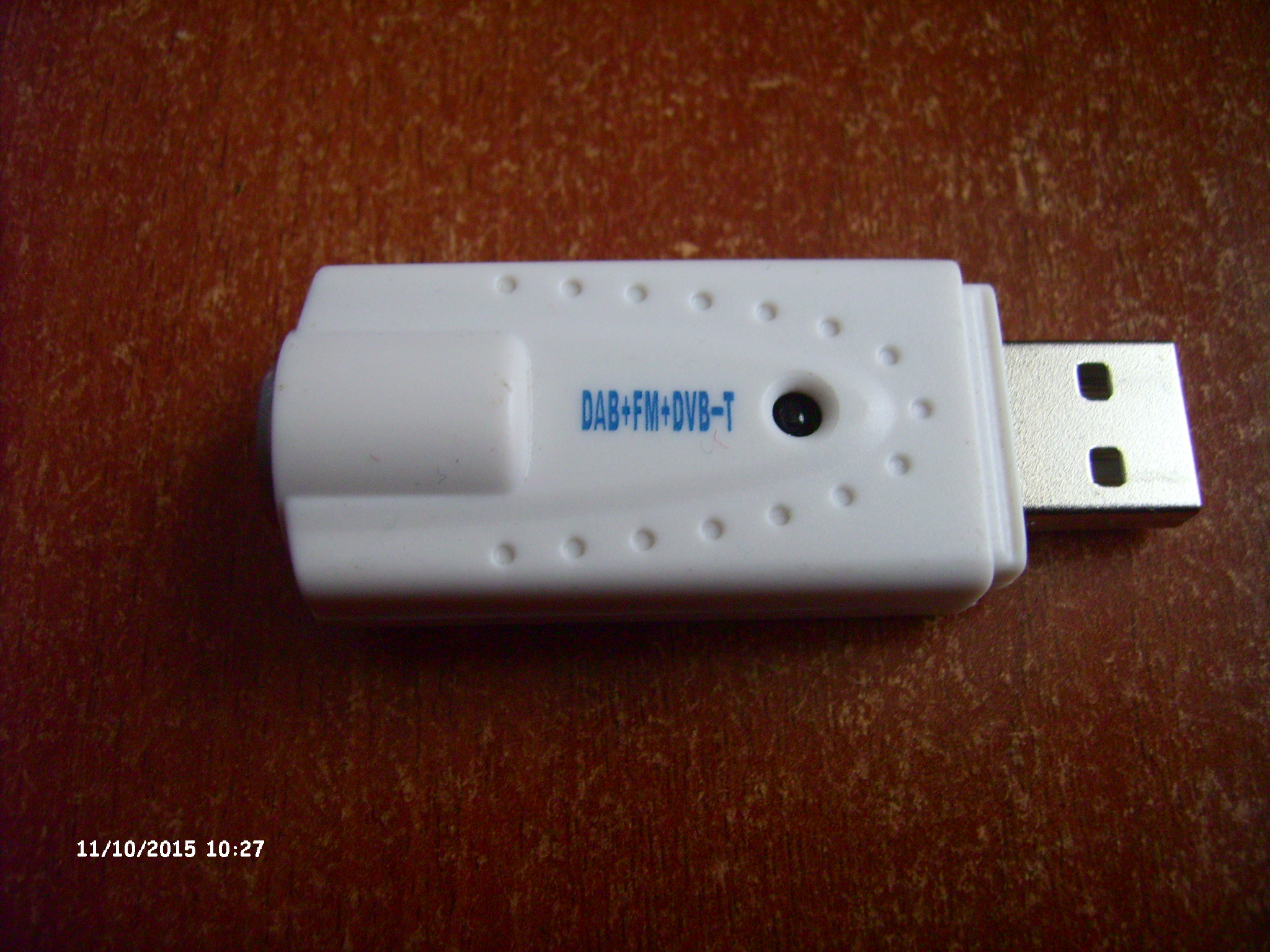

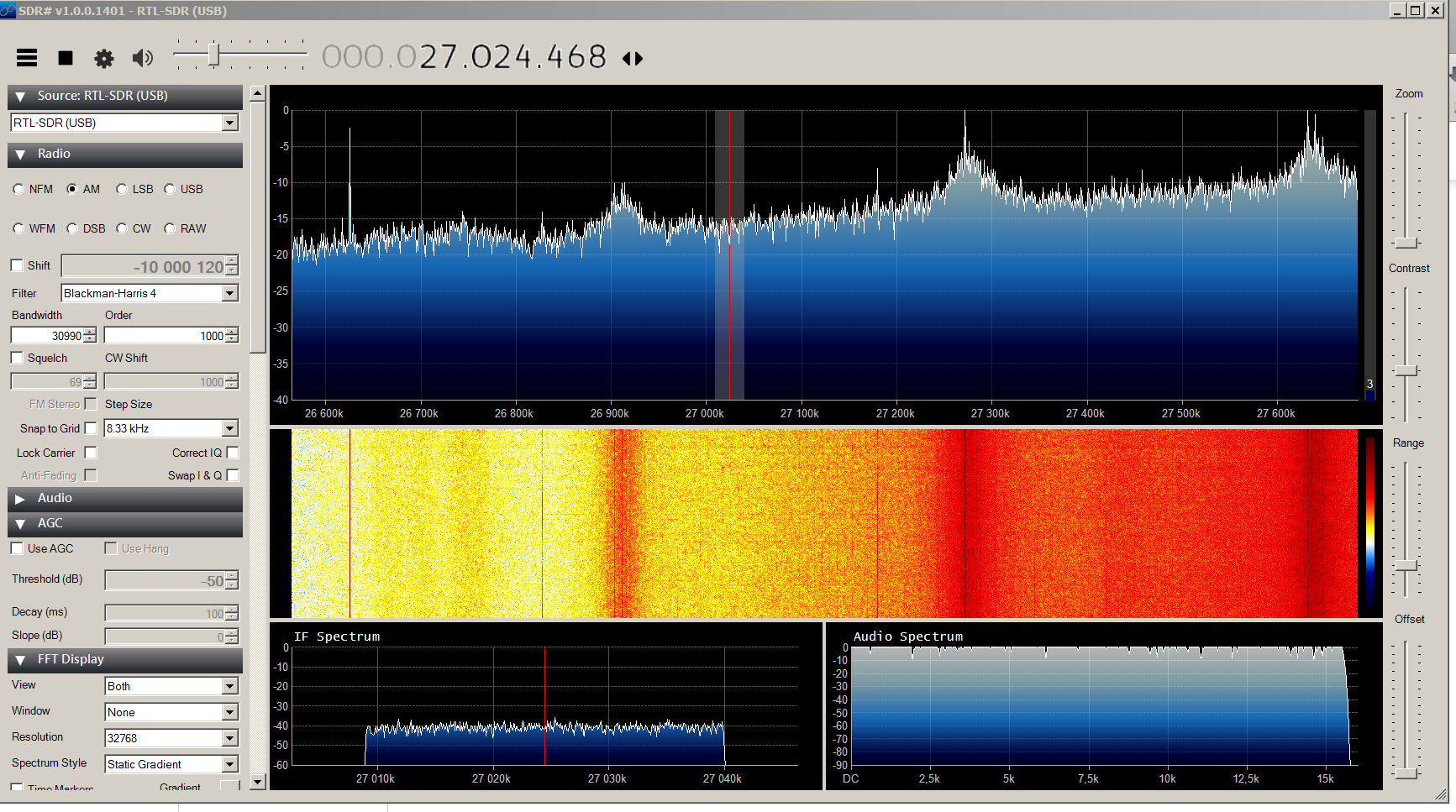

    For several days I have been playing a bit with listening to different bands, but something does not work out too much I will add that I live in the countryside, low-rise buildings, flat area
    The tuner is such an invention
    I have good reception of the FM radio band and some aviation band. On other frequencies I do not catch anything even though something should be

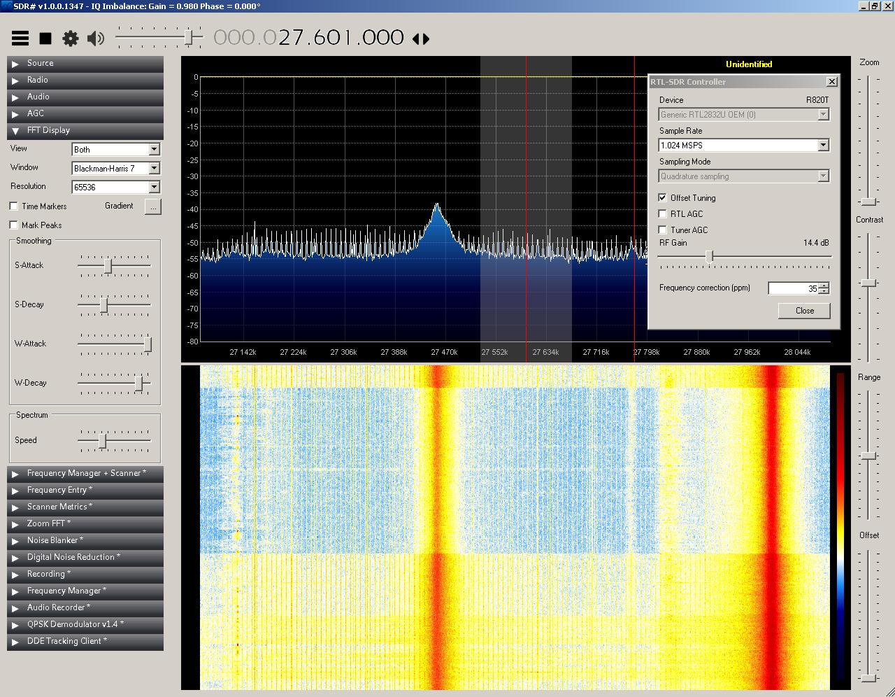

    For example, in the range of 26-30MHz I should catch something because CB works there and for me there is total silence, and no matter how in the program I set the parameters

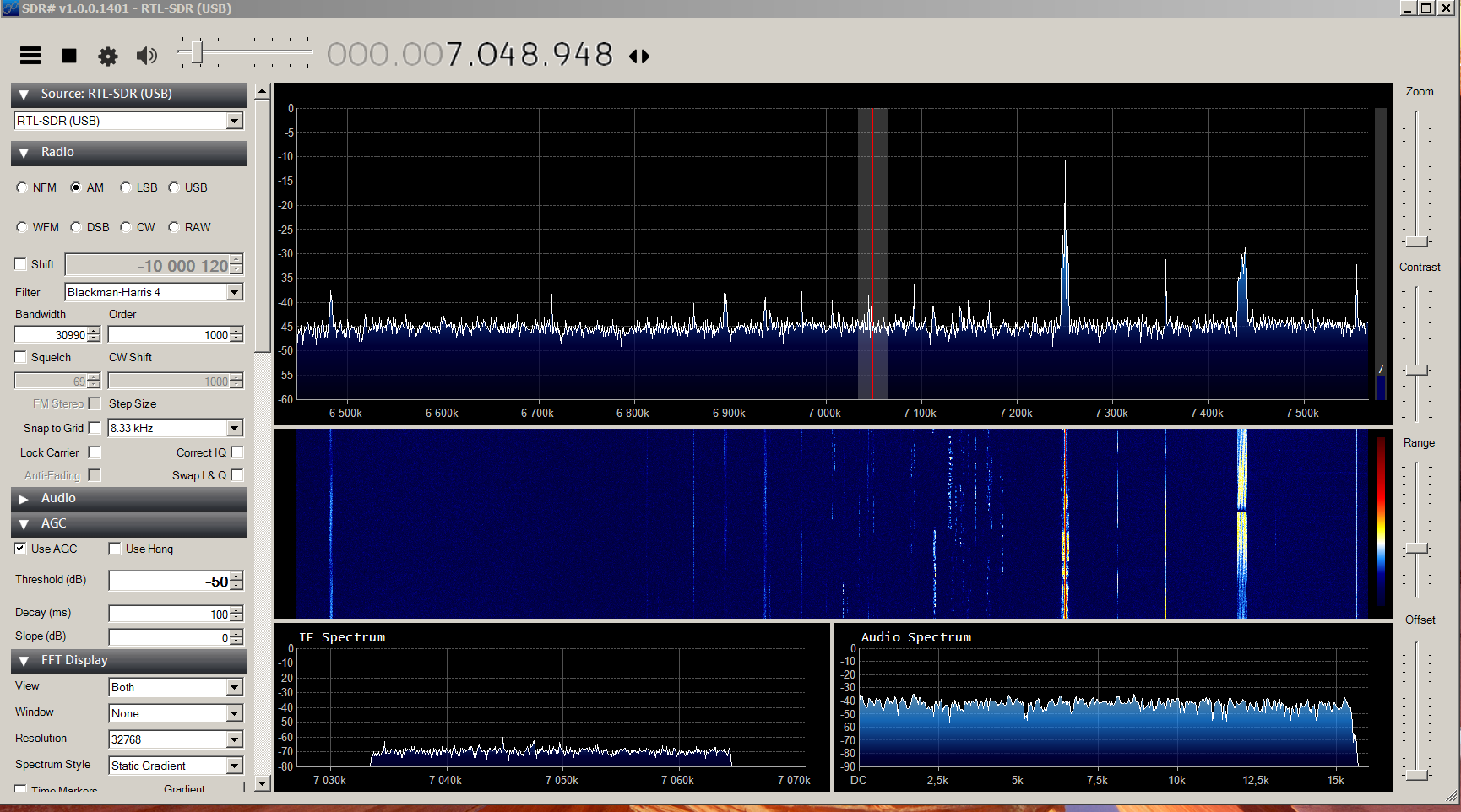

    There are only a few radio stations around 7Mhz and nothing else
    In the vicinity of 160-180Mhz there is nothing left and the services should broadcast in this band
    I carried out tests on various makeshift antennas. I wanted to see if I would catch anything in the CB band and the services. If I caught anything, I would make an antenna for the selected band or buy something ready-made
    Now I wonder if I am doing something wrong that I only have a radio and aviation band or maybe I live in such a radio hole
    If someone could direct me in action, I would be grateful

    Bandwidth below 25MHz in these tuners is a mistake, either building a converter or doing Direct Sampling. Makeshift antennas? What do you mean? The services are not broadcasting non-stop. You are quite far to the cities so there is no strange silence. Throw the antenna a few meters up and it will start moving. Set the gain higher in the program.

    I have 15 km in a straight line to the city
    Makeshift are various "sticks", straight dipoles or TV antennas I just wanted to check if something is coming to me I am surprised only that I have nothing from the CB band
    I had the antenna about 8-10 m above the ground because the cable did not allow higher up
    Can you test on a TV cable? I have it much more than this 50ohm
    Possibly, it remains to take the risk and buy a ready antenna. At most, I will utop a few zlotys ;)

    There may be a TV cable, CB is not crazy about the range either. If you do not live near a busy road where there is no police car with a video recorder or it is not "drying", then silence. Check if you receive a digital phone around 168-170MHz.
    I will only add that if you played with TV antennas with an amplifier (mesh inventions) and you had the tuner gain set to MAX, there is a good probability that you beat the R820T.

    The best thing in eliminating interference from everything was the solid installation of approx. 1 m of 1.5 mm copper cable to the USB output and removing the metal tip from the USB extension (both on the dongle side)
    The tuner is T2.
    In the pictures, the effects before / after and the applied antenna:
    How to use RTL-SDR on a cheap USB DVB-T tuner for HF and 64–1700 MHz? How to use RTL-SDR on a cheap USB DVB-T tuner for HF and 64–1700 MHz? How to use RTL-SDR on a cheap USB DVB-T tuner for HF and 64–1700 MHz?
