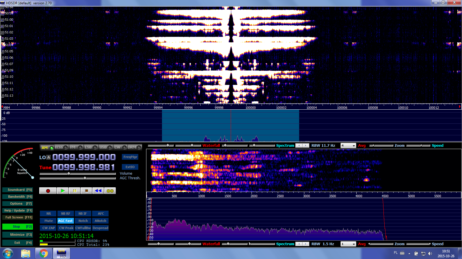

  • RTL-SDR setup and distorted audio troubleshooting request
    #613 15096875
    Lisu815
    Posts: 90
    Tempted by a cheap receiver with a wide range, I bought this:
    SDR RTL2832U R820T2 USB DVB-T scanner 25-1700MHz
    For the received set it was required (as the seller wrote) to install the program from the website:
    http://www.hdsdr.de/index.html
    I fired up the program, turned on watch, and I hear distorted noise and my voice, distorted too, of course.
    After writing to the seller, he spreads his hands and writes, please visit elektroda.pl ...
    I have no words.
    Maybe someone here will know how to start and set up this contraption?
  • #615 15097291
    Lisu815
    Posts: 90
    I have no idea what and how to set it up so that I can receive something. I do not know if it is damaged or incorrectly positioned.
    It picks up some distorted noise, and a microphone is injected from the laptop so that I can hear my distorted voice and see it on the spectrum.
    This is my soft:

  • Software selecting microphone instead of RTL-SDR tuner
    #622 15103061
    Lisu815
    Posts: 90
    don_viking Thanks for the program, I unpacked and worked on it a few times but it was a mess with every try.
    I unpacked the program and HDSDR and SDRsharp and there was such a problem that even following the instructions, the program did not pull the signal from the tuner only from the microphone so that I could hear myself.
    I thought what I found would come in handy.
    When running the program, should I change it like on the screen?
    With the SDRsharp program ready, it was also linden, I drove in turn and also got stuck

    Have you installed the SDR drivers?
  • #624 15103096
    Lisu815
    Posts: 90
    Yes, I installed for both the first and second as in the screenshot, if that's the case.
    Generally, as it was supposed to be in the description.

    The first screen shows that HDSDR does not have the EXTIO.dll library - you need to copy it to the program folder. And honestly, I also suggest to bypass HDSDR and run SDR SHARP first.
    Also show a screenshot of the Windows Device Manager with the tuner connected to USB. As is the libusb tab in the tree - expand it and take a screenshot.
    I probably wrote on this topic (I'm not sure) to use ZADIG version 1.1.1.139 to install drivers for SDR - other versions often cause problems.

    SDRsharp is also simpler and more organized in my opinion. And it has a wide and narrow FM.
    I took a screenshot and unfolded the windows, maybe they will tell you something.

    Remove this device from the device manager (delete), install the Relatek drivers for DVB-T reception, then install the drivers for SDR with the Zadig program in the version as given above.
  • #629 15105244
    Lisu815
    Posts: 90
    I fired but I can not find this software from what I read, it is USB 2.0
