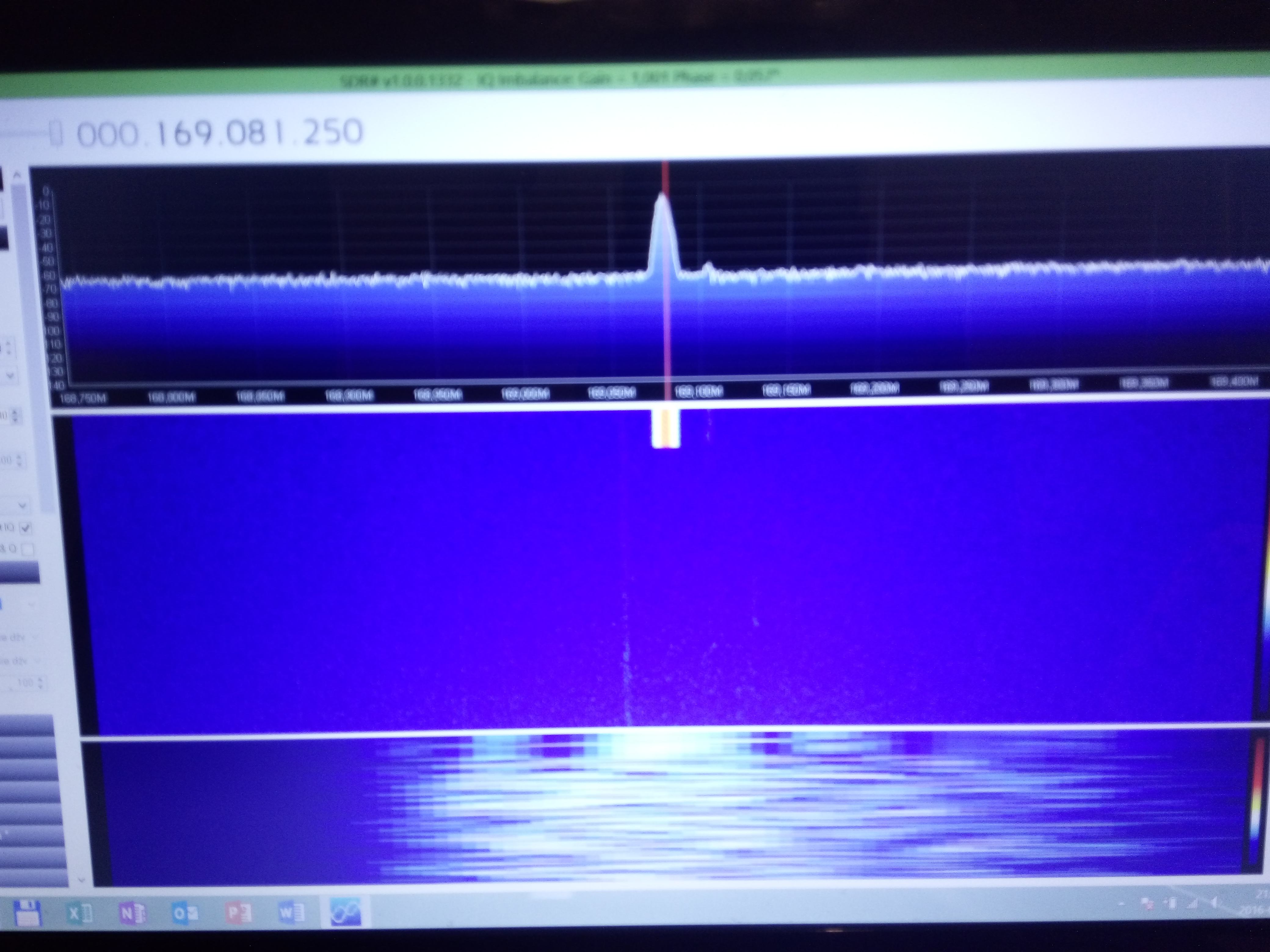

  • 48 cm antenna receives FM but not voice traffic
    #704 15337134

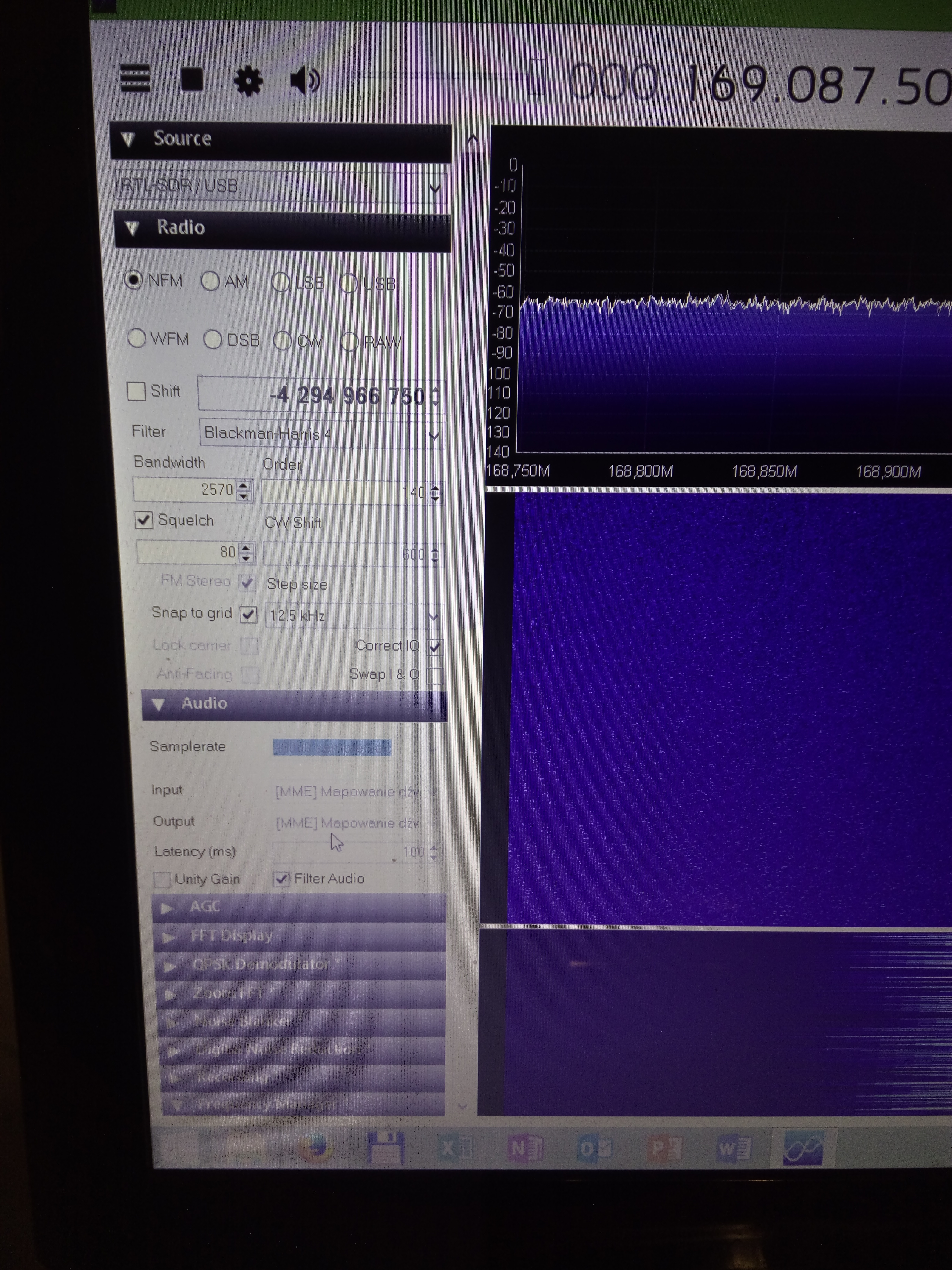

    czakos
    Posts: 85

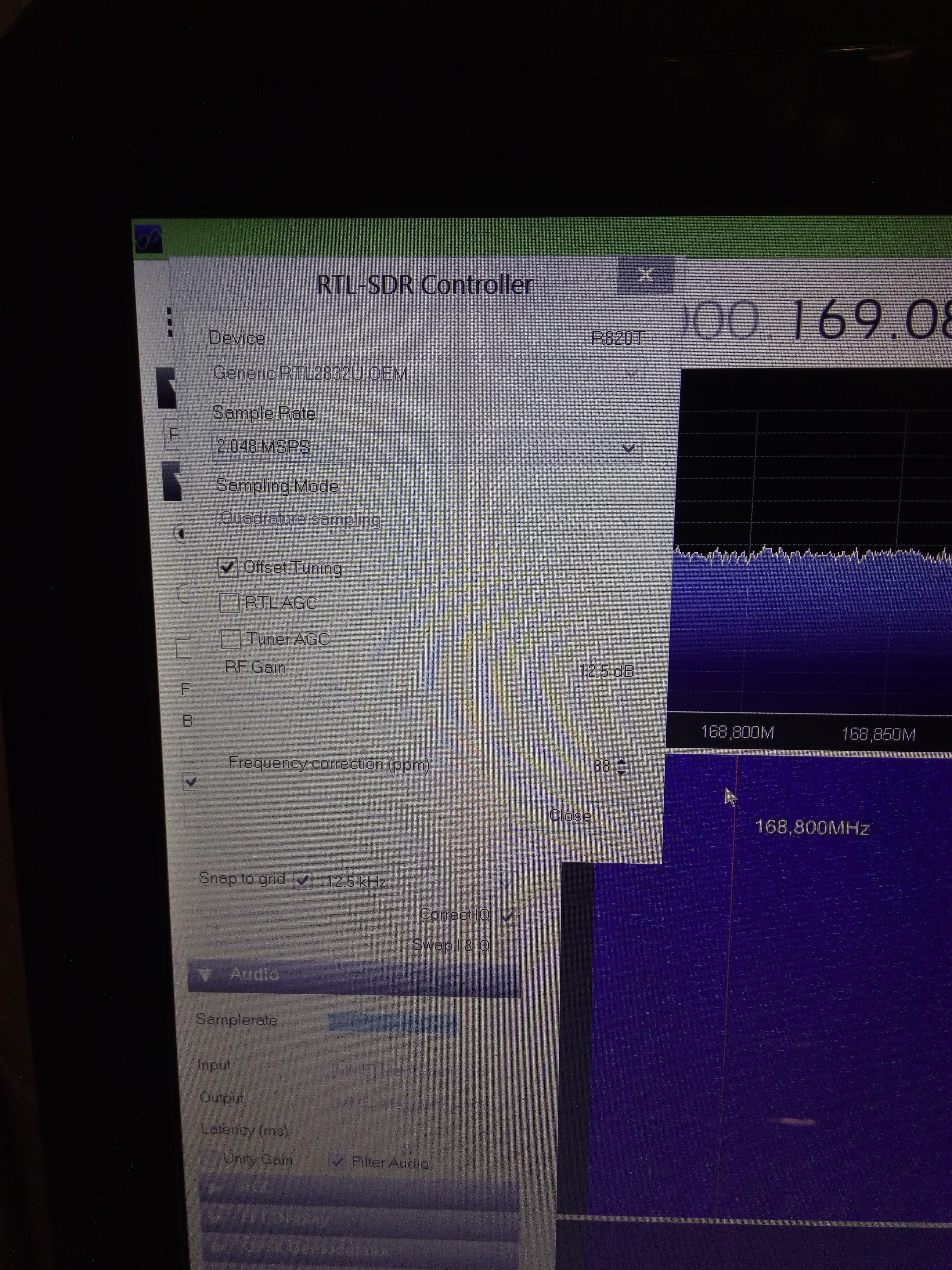

    And how about the bandwidth filter, order filter, and step size 12.5? Cramps I will gather again that I only sit at the computer and fly with the antenna :)
    I made an antenna for the 48 cm for the wing and, despite the signal, you can hear everything but the conversation; / I'm attaching screenshots of course sdsharp from my friend don_viking from the attachment. Judge for yourself, I will add that rmf fm plays beautifully :D How to use RTL-SDR on a cheap USB DVB-T tuner for HF and 64–1700 MHz? How to use RTL-SDR on a cheap USB DVB-T tuner for HF and 64–1700 MHz? How to use RTL-SDR on a cheap USB DVB-T tuner for HF and 64–1700 MHz? How to use RTL-SDR on a cheap USB DVB-T tuner for HF and 64–1700 MHz?
  • NFM/WFM settings, frequency correction, and 169 MHz DMR identification
    #705 15338749
    don_viking
    Level 21  
    Posts: 562
    Help: 14
    Rate: 136

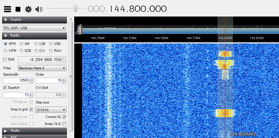

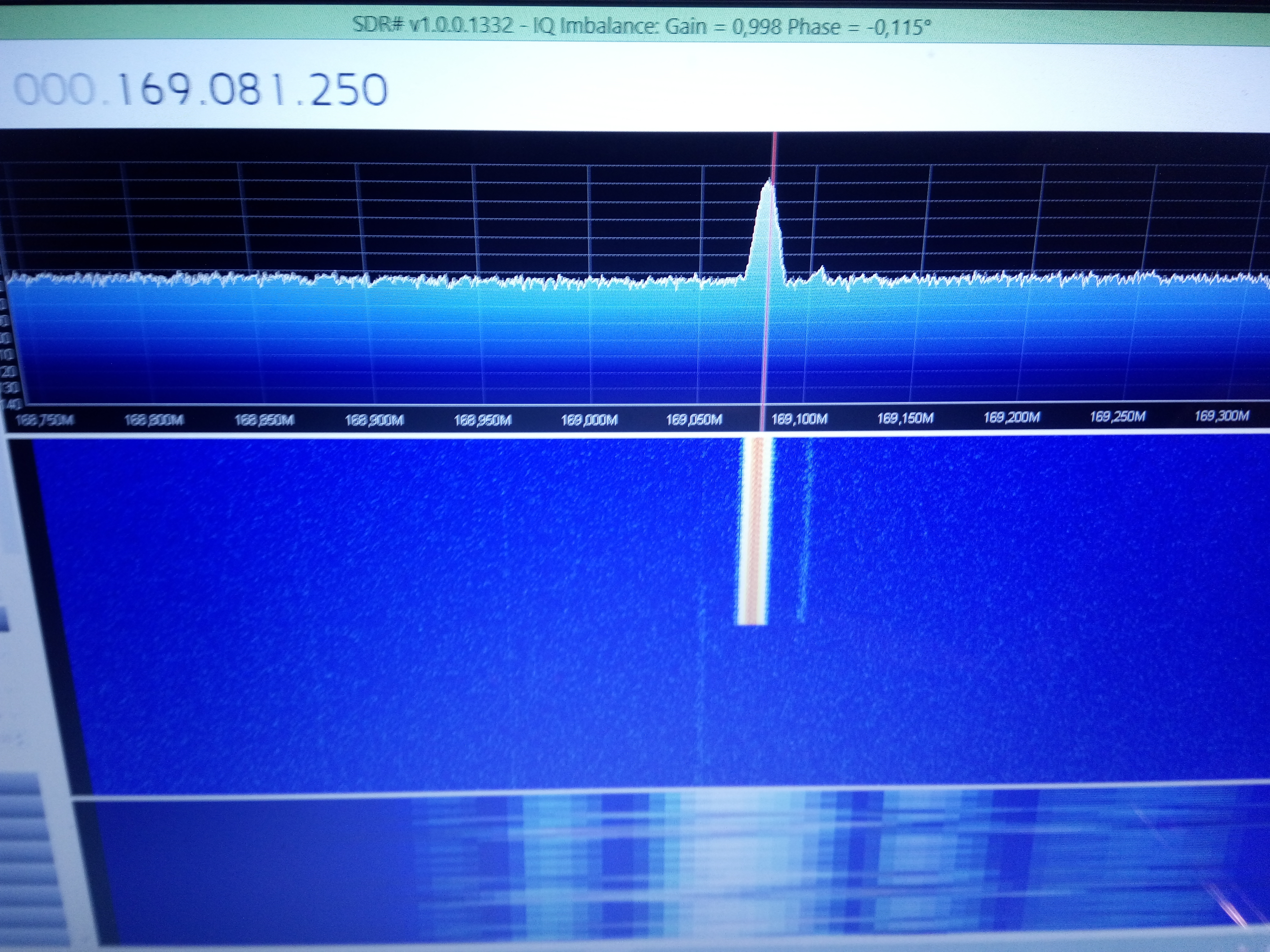

    Hello "czakos". On the first photo, which I posted below, you have the best settings for receiving narrow FM, i.e. NFM. Wide FM, otherwise WFM, is best heard and works in stereo when set as in the second photo. There is also the issue of setting the frequency correction because the pictures show that the signal is received a little to the left of the center of the set frequency. You will have the best sound when it is in the middle of that red line which goes vertically when you hold the mouse in the middle of the screen. besides, what you receive on the 169Mhz frequency is a digital DMR ambulance signal. Ambulance transmits digitally as also marked "kriss51" So you have nothing to look for on this frequency under normal conditions.
    I would like to add that it is better to make photos of the desktop with the "prt sc" key at the top of the keyboard, open the pait and paste the photo and save.

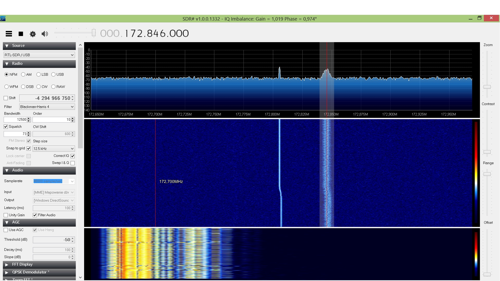

    First of all, the tuner is working properly, you are just looking for the wrong place. In the band from 168Mhz to 174Mhz there are services that mostly use digital communication. Look lower or all higher between 420Mhz and 470Mhz. I recommend visiting the website of the Office of Electronic Communications, the link of which is provided below. There you have to select the appropriate provincial branch and save the file to disk. Radio permits are available in the file and the frequency and other necessary data are also given there, but unfortunately it is not written whether the station broadcasts analog or digital. It is always the first step, you set the frequency and wait for something to move in the ether.
    https://www.uke.gov.pl/pozwolenia-radiowe-dla...-sieci-radiokomunikacji-ruchomej-ladowej-5458
  • #712 15341677

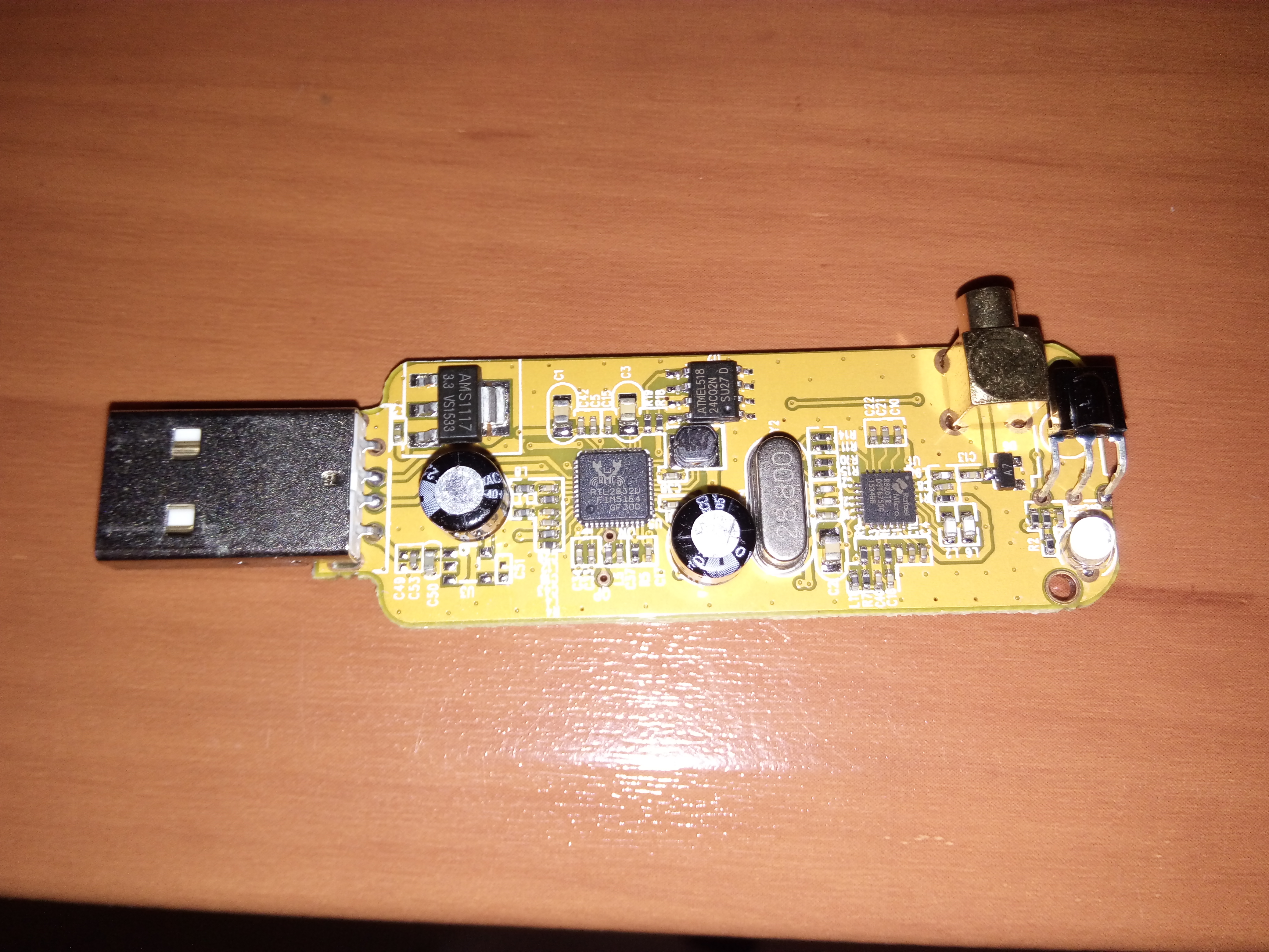

    Thanks a lot, tell me if A7 under the antenna input is this protection diode? And won't any of these antennas do better than my self-made dipole. Buddy Viking, is there any plugin, so that I can set the psp frequency range and let sdsharp scan this range all the time, I mean to set myself and not sit and wait for something to appear and then set something like a normal scanner from uniden. best regards

    Yes, the SOT23 A7 element is a double protection diode in this system.
    Antenna it all depends on what you want. For a wider range it is better to buy a prefab, but for a narrow band you can also make a pretty good antenna on which you can hear a lot.

    You probably won't get rid of it, I also have similar interference there, despite the lower amplification. The only thing you can try is switching to different ports. In my laptop, there is one port where I have little interference, others are unacceptable. Even a recorder or a hard disk can generate interference, the port itself also generates interference somewhere there was once a problem on a forum.
