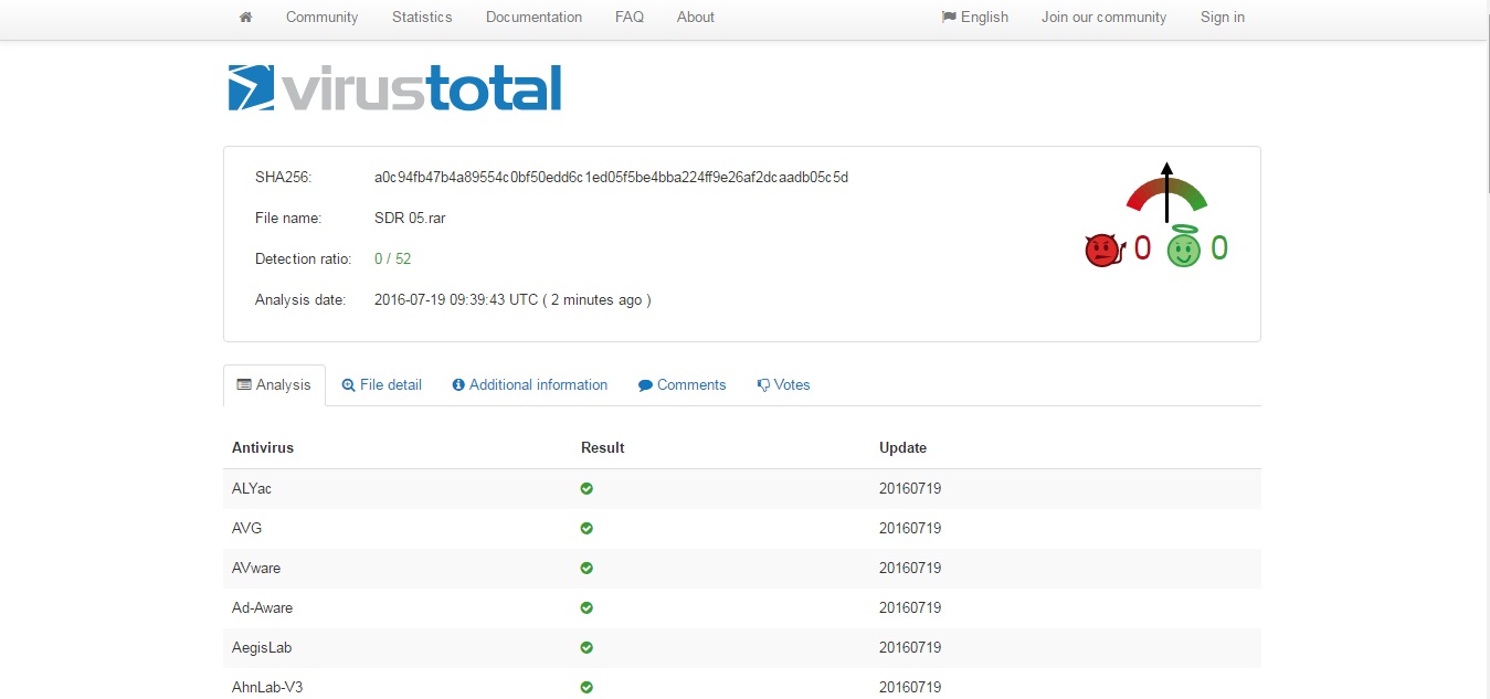

    Information for those who have the SDRSharper program. There is a new version 05k, although the file is named 04k. I have tested it for myself and it works satisfactorily. Below is a link from where you can download the file.
    http://www.qsl.net/sdr/SDRSharper_04k.zip
    And here is the rest of the version.

    I do not recommend this file !!! It includes Trojan: Win32 / Spursint.A! Cl
    And it's not a new version. It is from 31-May-2016

    AVIRA PRO does not detect any Trojan. If you indicate a newer version of SHARPER - which as far as I know (I may be wrong) was not supposed to develop due to the infringement of SDR # copyright - then we will be grateful.

    edi730 I have Norton Secutite Internet paid version and it doesn't show me any Trojan, I don't know what antivirus you have and where you got this information from. The last available version was v0.3h from 2015. Like a colleague lysy1980 he mentioned due to copyright infringement was not supposed to be developed, but maybe they did it quietly because since May there has been no mention of a new version anywhere. The only file I found on the web was on the other site as I gave it.
  • #907 15816441
    edi730
    Even Windows Defender reported that the file contains a Trojan. Does not matter...

    The file probably does not contain a Trojan, only you probably have a Trojan that tries to infect the archive when you open it.

    I add my version of the SDRSharper program in the attachment where you can listen from 1MHz up. Below 15MHz you need to give a gain of at least 90 percent not full and you can turn on RTL AGC, although if you have a good antenna you do not need to. If you have a bad antenna, if you want to listen below 15MHz, it is enough to connect the main cable of the cable without the ground. Anticipating subsequent entries about the alleged viruses, I post a screen from the file scan on the network.
    How to use RTL-SDR on a cheap USB DVB-T tuner for HF and 64–1700 MHz?
    • SDR 05.rar (2.39 MB) You must be logged in to download this attachment.

    For me, ESET ss full version did not find a problem in any of the peaks.

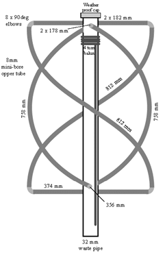

    Hello, I have not been involved in this topic, but I have had SDR for a long time and listens to different bands, usually 170-185MHz.
    I built a 137MHz quadrifilar helix antenna to receive weather data from NOAA satellites. I have one problem, the entrance to the roof is secured with a padlock (3-story tenement house) and here is the problem, if I put the antenna out of the window, e.g. a meter from the wall, I would be able to catch anything to be sure that the antenna is suitable for receiving it signal type? because it will be easy to get on the roof, but fly with it several times, etc.
    The second thing, the person who familiarized me with this topic said that good reception will be provided by a mesh antenna placed horizontally without a mesh. It is about the bands on which policemen broadcast, etc.
    The antenna is Quadrifilar Helix. The most ordinary. How to use RTL-SDR on a cheap USB DVB-T tuner for HF and 64–1700 MHz?
  • #925 15878050

    @ wtełek1 What is the antenna you built it with? Yes, if you put the antenna out of the window at a distance of one meter from the wall, you will receive something under favorable conditions ;) (instead of asking such questions, you would have done it a long time ago and found out for yourself ... preferably on a wooden brush - no, I'm not kidding!) The mesh antenna is the last resort, but in my opinion it is a dream come true.
