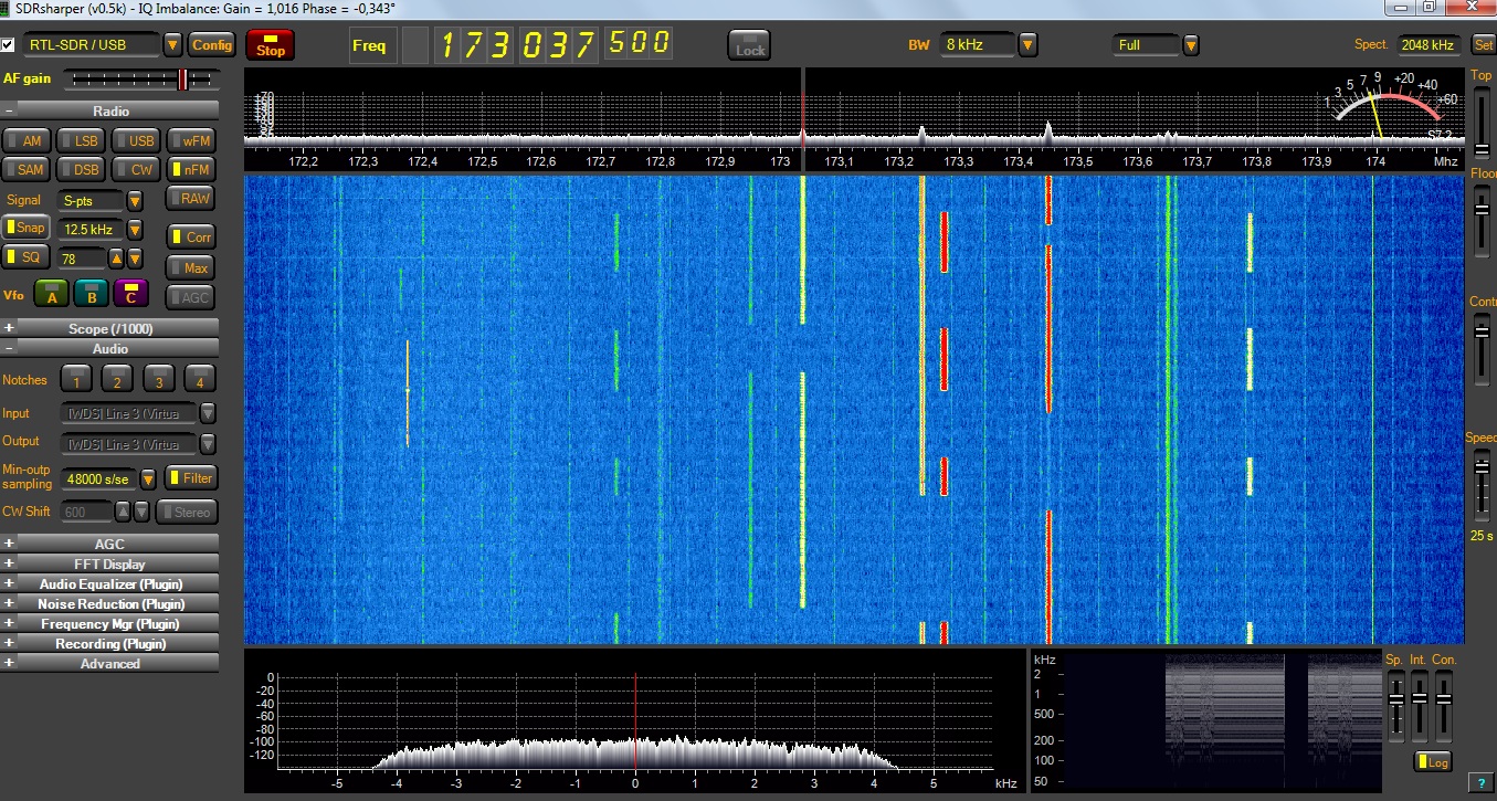

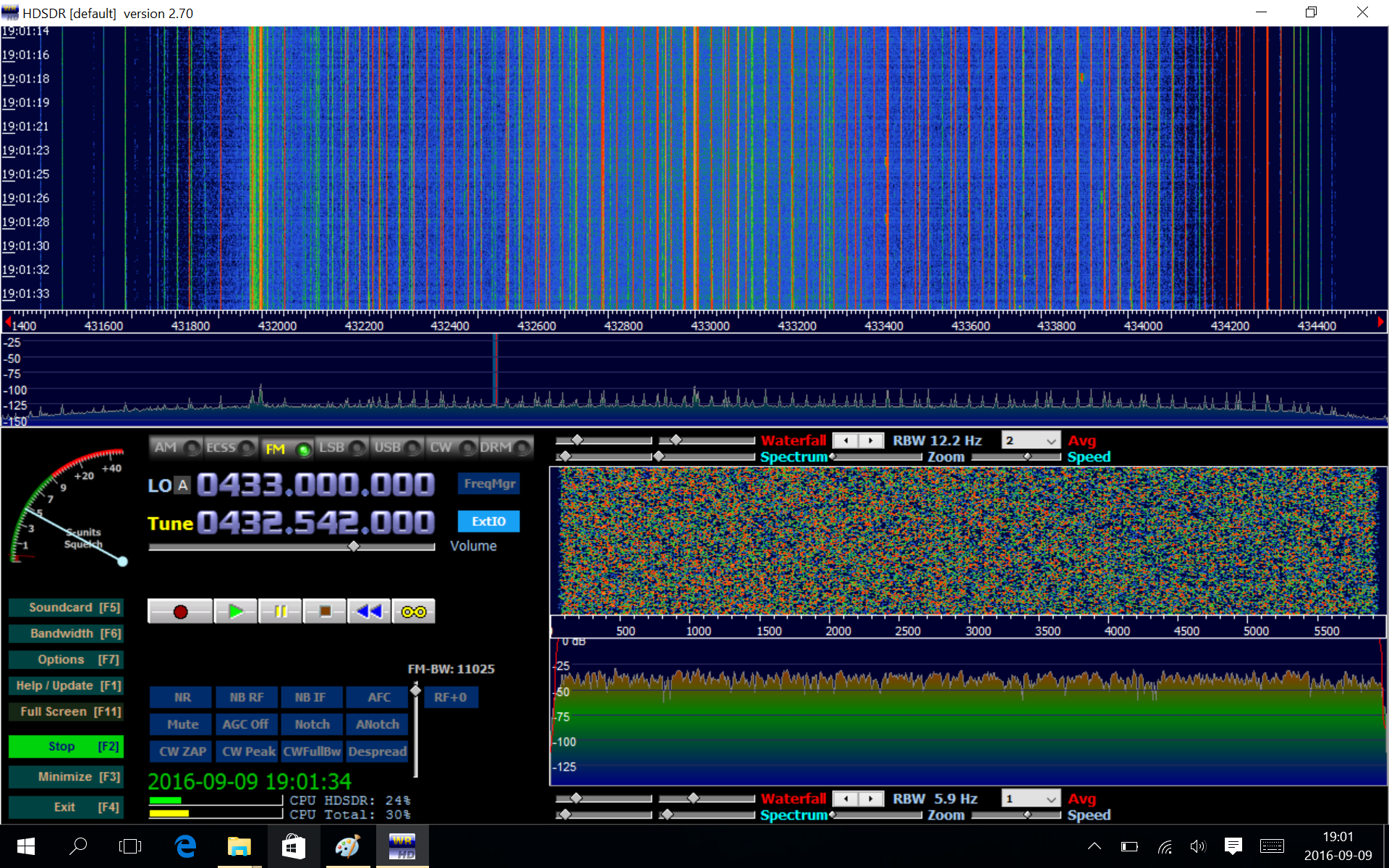

    Hello, I'm new here, but please help pw if you can
    I have:
    http://g01.a.alicdn.com/kf/HTB1oshRJFXXXXXxXF...TL2832U-R820T2-with-120cm-Cable-MCX-Connector .jpg " target="_blank" rel="nofollow noopener ugc" class="postlink inline" title="" > http://g01.a.alicdn.com/kf/HTB1oshRJFXXXXXxXF...TL2832U-R820T2-with-120cm-Cable-MCX-Connector .jpg
    and antenna:
    Albrecht Allband
    My point is that I can not cope with the configuration of SDR-Sharp and HDSDR programs, can anyone help me with e.g. TeamViewer?

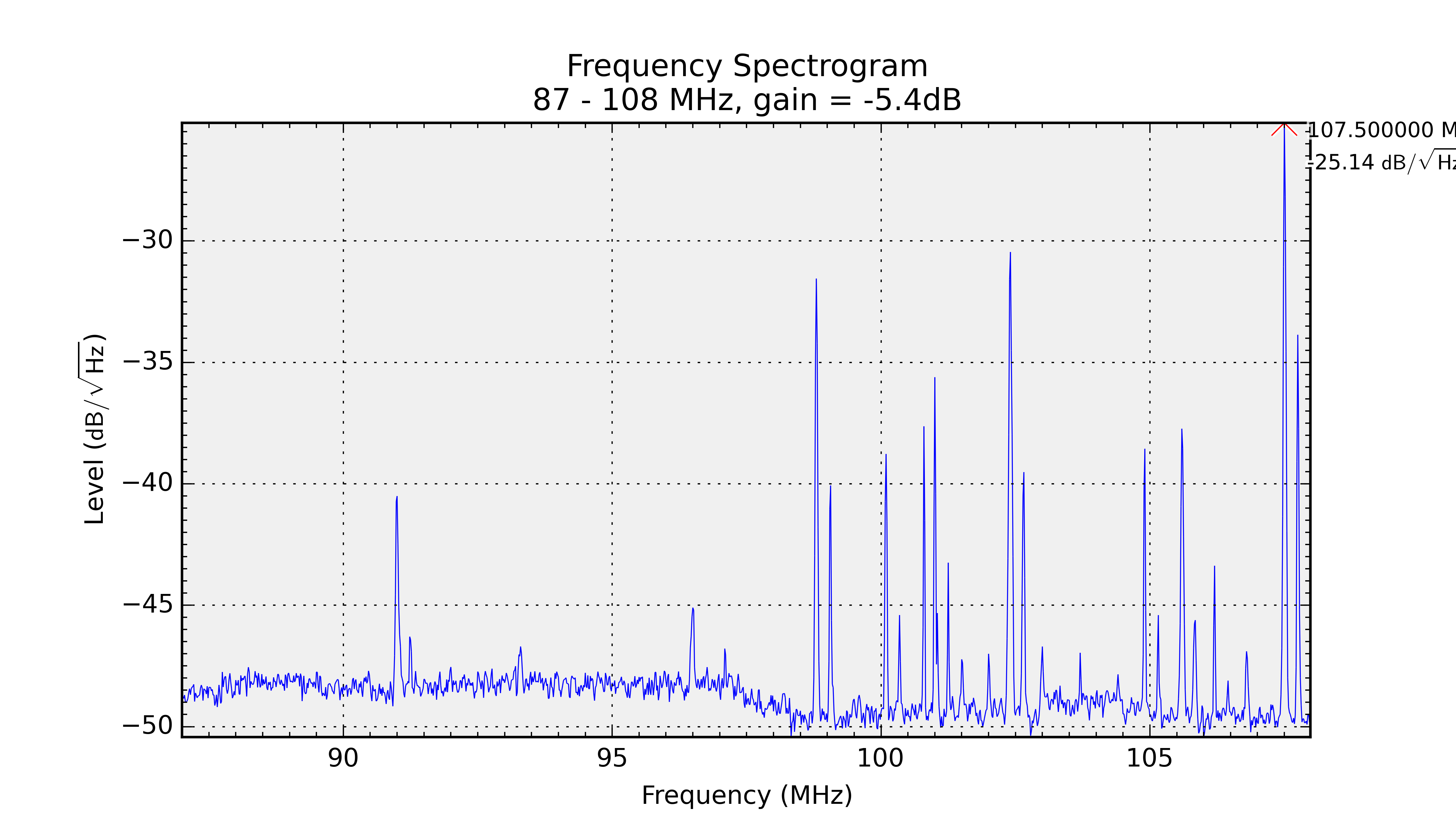

    Maybe I won't write anything new, but just out of curiosity, I compared two DVB-T receivers - typically Chinese, available at auctions for about PLN 40 in a black housing with the words DVB-T + DAB + FM with R820T tuner and blue LED and NOT LV5T Deluxe with the FC0013 tuner, which I recently bought for PLN 60.
    I used RLT-SDR Scanner for Windows, scanned the 87-108MHz radio band
    Black Chinese Tuner:
    How to use RTL-SDR on a cheap USB DVB-T tuner for HF and 64–1700 MHz?
    LV5T:
    The effect speaks for itself, which is also audible and felt when using, for example, HDSDR.
    If someone (like me) complains about poor results, poor sensitivity, etc., I suggest changing the tuner, and if someone is just going to buy, I suggest avoiding black Chinese inventions with a blue LED, it is better to add PLN 20 and not to tear your hair out of your head.

    don_viking wrote:
    I recommend these tuners in the blue casing, they are short-circuit proof and have better sensitivity than all others and have the R820T2 chip
    I just don't recommend them. Above you have a scan of the FM band, my tuner is black, but my colleague has the same blue, they both behave exactly the same. Anyway, worse sensitivity than the LV5 is audible when using HDSDR - stations that hum on this black noise, on the LV5 receive flawlessly.
    With the factory firmware, it is exactly the same - using HD Blaze (software supplied with the black / blue tuner) in my apartment, the black tuner does not catch DAB, and on the LV5 it catches DAB.
    Above 800MHz I did not check, because I am not interested in this band, while on VHF and lower UHF (500-600MHz) the LV5 is much better.

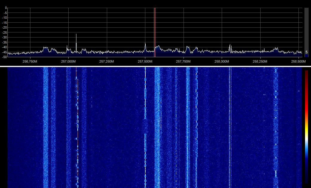

    It is not for sdrsharper, but for sdrsharp it is a scanner. In the topic of 910 thanks for your help, I will say that sdrsharper would receive better than sdrsharp because in Zabrze I did not receive the GLC control box on sdrsharp at 150.375 MHz, and on sdrsharper I receive at 5, it is a pity that there is no scanner as a plugin in the program. And this is what the program looks like for me. Thanks don_viking.
    • How to use RTL-SDR on a cheap USB DVB-T tuner for HF and 64–1700 MHz? Schowek01.jpg (320.63 KB) You must be logged in to download this attachment.

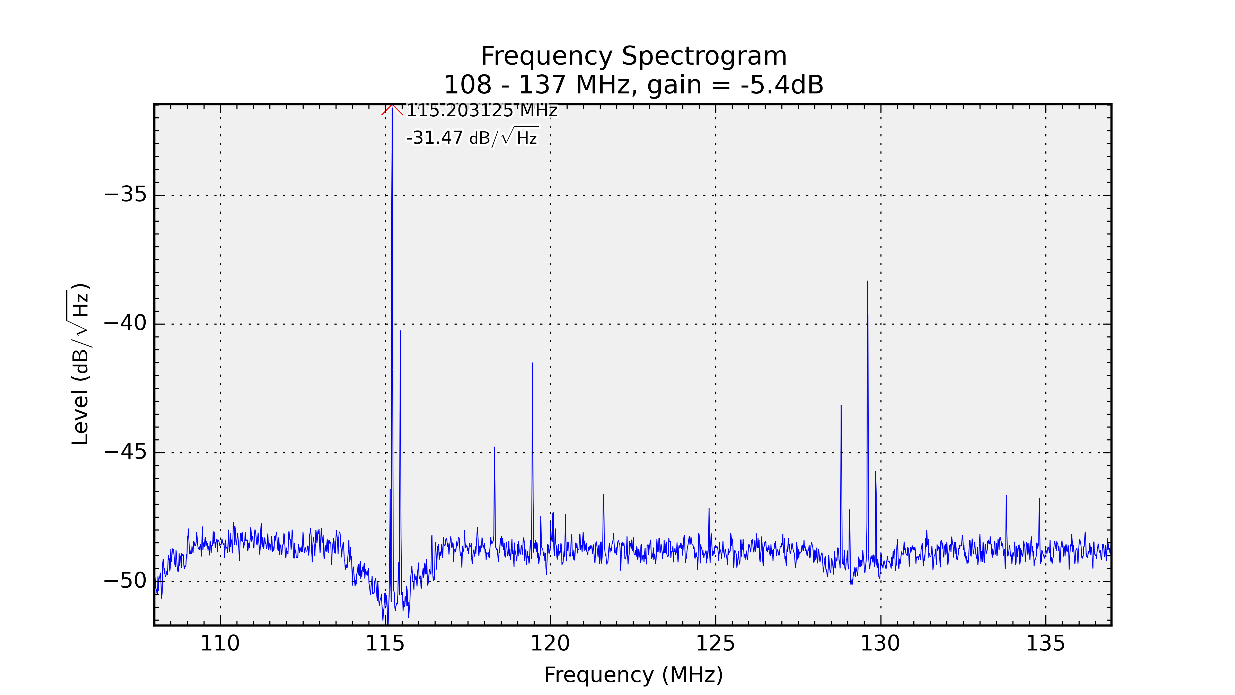

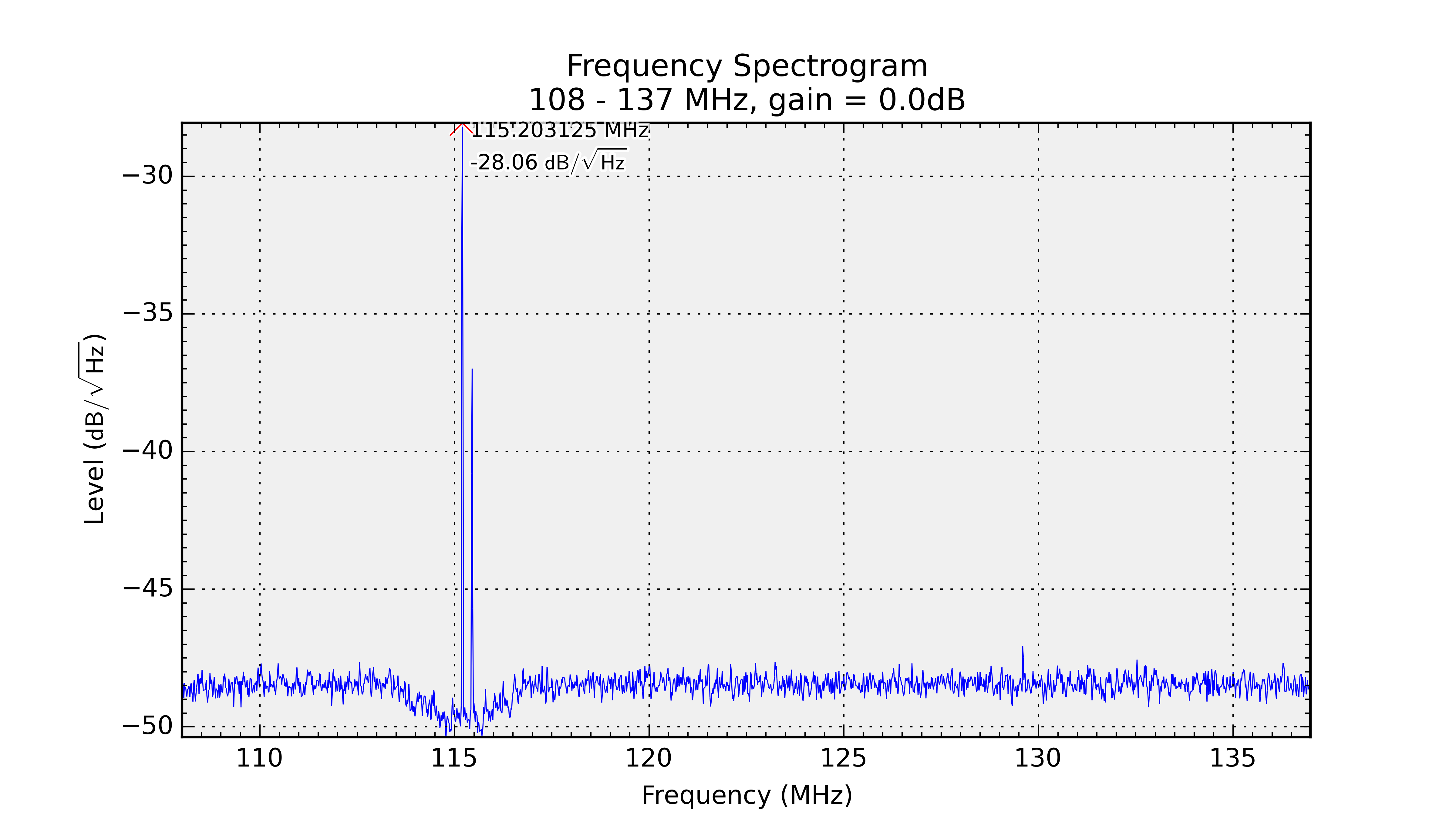

    Make a comparison with the same gain. I have a request for you. Wind the cable that you connect to the dongle 5-8 turns on e.g. a pen and check that the background noise does not drop. I reduced the noise by up to 20db, then experimentally added the core on which I wound it, the improvement is significant. It concerns inter alia interference received with the screen of coaxial cable. Could you compare both dongles on the same antenna on a segment of the band, e.g. 433Mhz and Airband? Maybe in the form of a screenshot from SDR #
  • #945 15921487
    Artur k.
    Posts: 25889
    Help: 1279
    Rate: 1701

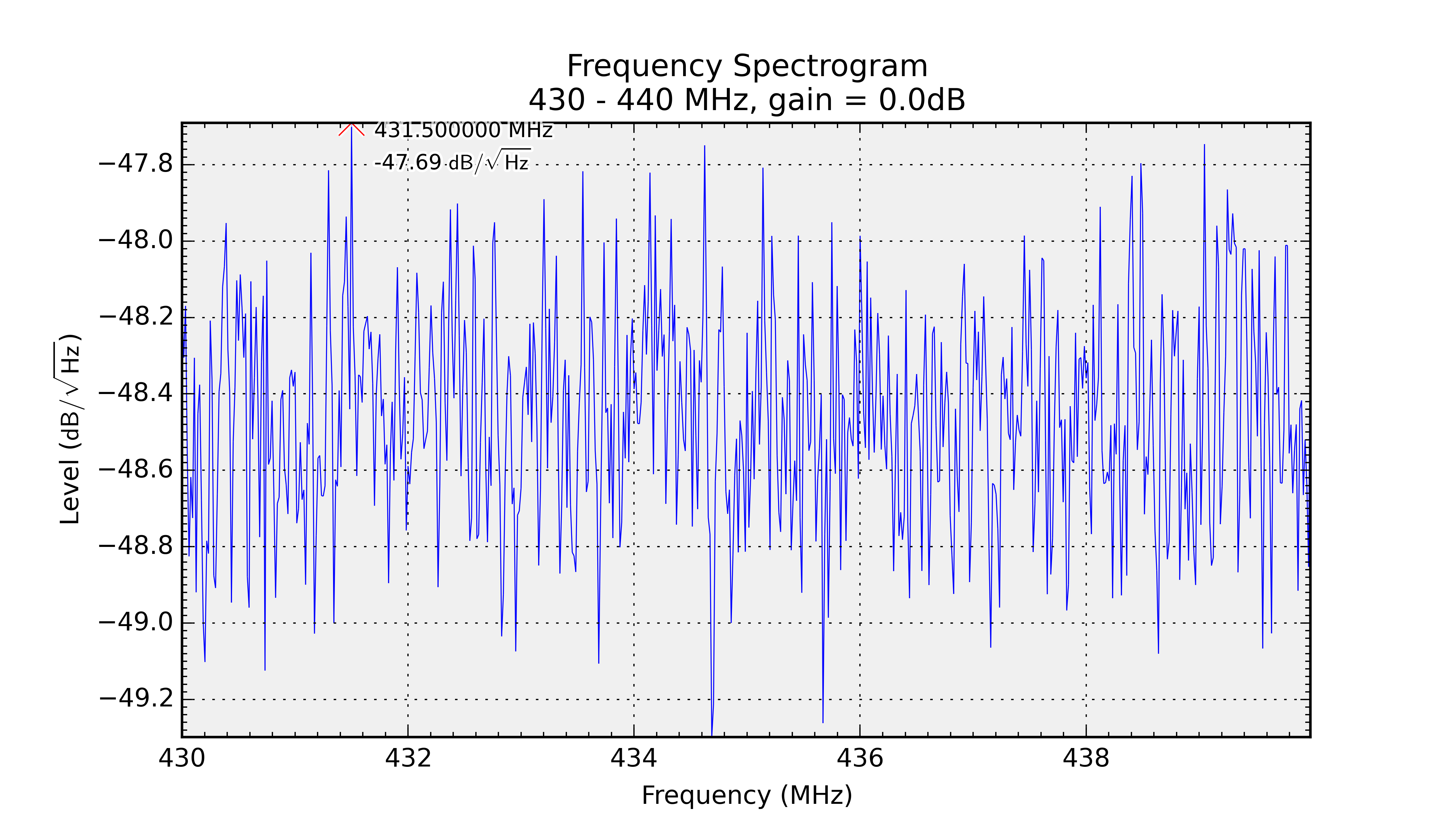

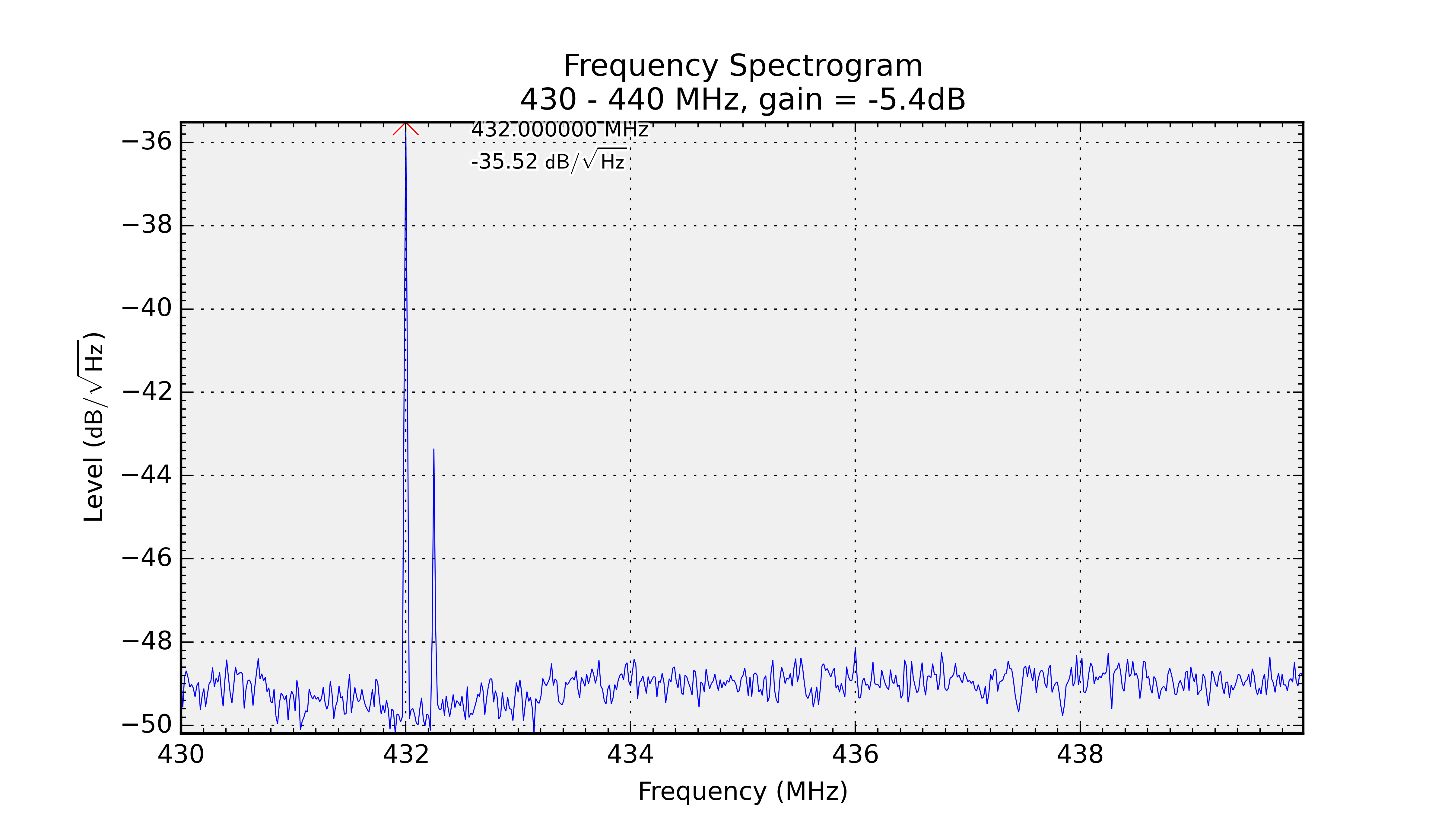

    Here, the attenuation of 5.4dB is even better. :) Unfortunately, mi program automatically sets the level to -5.4dB for the LV5T tuner and I can't choose 0dB. For the Chinese, however, it is set to 0dB and I can't choose -5.4dB. Apparently this is due to the difference of the tuners themselves (R820T and FC0013)
    Here you go, LV5T:
    How to use RTL-SDR on a cheap USB DVB-T tuner for HF and 64–1700 MHz? How to use RTL-SDR on a cheap USB DVB-T tuner for HF and 64–1700 MHz? How to use RTL-SDR on a cheap USB DVB-T tuner for HF and 64–1700 MHz?
    And the Chinese:
    Here you can also see another drawback of the RLT Scanner - it automatically sets the scale of the Y axis, if I can turn it off, I don't know how to set the interval that interests me.
    The antenna is the same in both cases - an ordinary car CB antenna set on the windowsill outside.
    The included antennas are useless.

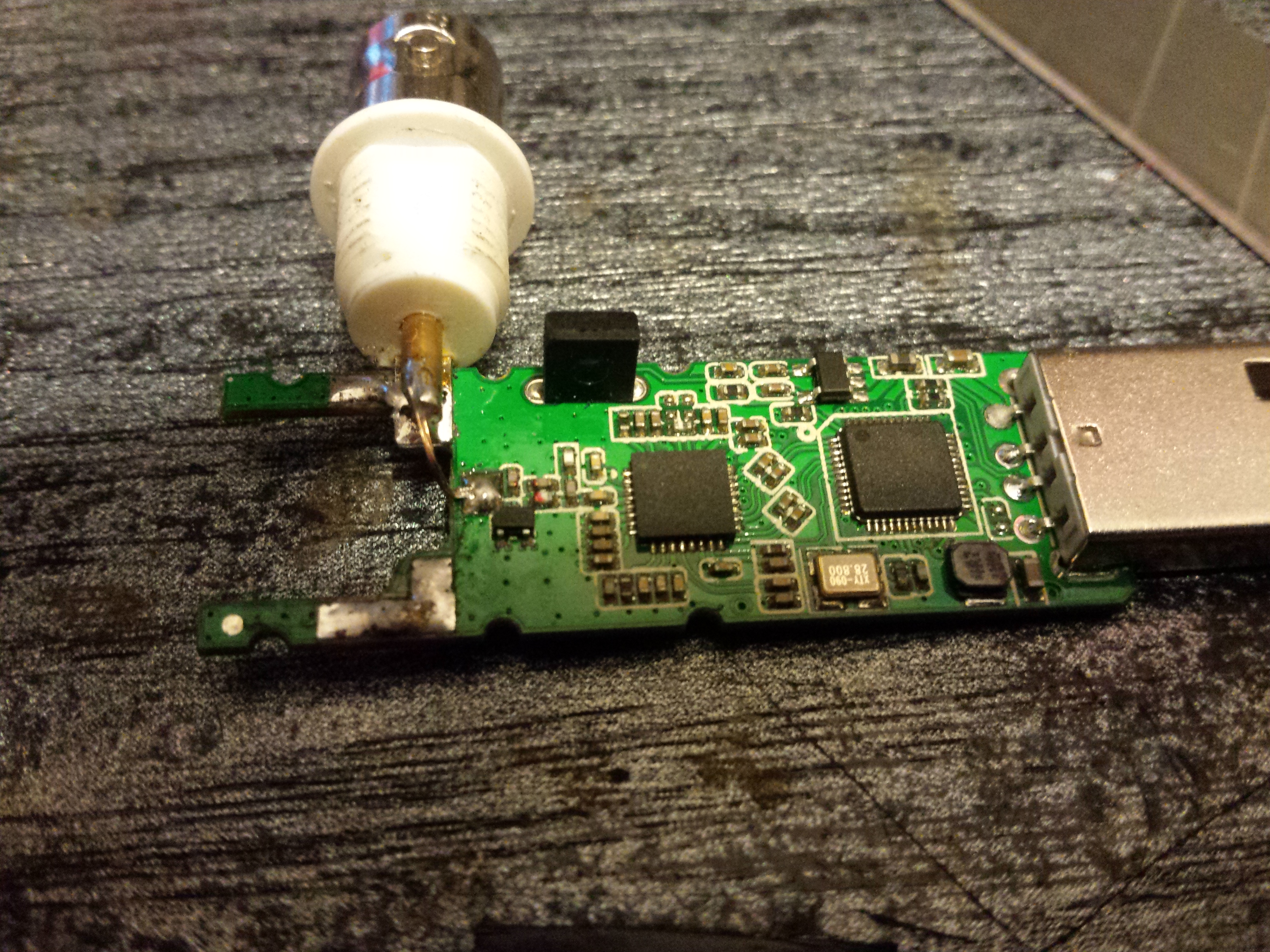

    #949 15938014
    Artur k.
    Posts: 25889
    Help: 1279
    Rate: 1701
    don_viking wrote:
    The problem is also the possibility of damaging the tuner during a short circuit at the antenna input because the factory tuners LV5TDLX do not have a protective diode on the input and you need to solder it yourself.
    In my life, I have not seen a device that can be damaged by a short circuit at the input. :)
    I also heard opinions that the tuner with the FC0013 chip is worse than the R802T, but my experiments with the Chinese tuner brand DVB-T tuner model and the tuner as a reputable manufacturer indicate something else.
    Maybe the R820T system itself is better, but it all depends on the entire structure and not only on the head system itself. This is the case in every area - you can use good quality elements and get the effect so-so, and someone else will use inferior elements and get a better effect.
    It is clearly visible in audio devices, computers, cars, etc. I will not write about audio, because it is a wide topic and you have to feel it. It is easier to use an example from the field of computers - as you know, there are plenty of motherboard manufacturers and these boards have different performance, although their heart is the same chips.
    Cars are also a great example, for example our Polonez with a Rover 1.4 16V engine reached 160 km / h and acceleration from 13.3 to a hundred. Meanwhile, the Rover with the same engine reached 182 km / h and accelerated to a hundred in 10.5 seconds.
    So what if there was a Rover engine in the south? :)
    PS Nobody's arguing here.

    #951 15938175
    Artur k.
    Posts: 25889
    Help: 1279
    Rate: 1701
    I think that LED was always there. Lack of a diode would be a cardinal design error.
    I found an article from 2013:
    http://majek.mamy.to/pl/rtlsdr-analyzer-from-dvb-t-tuner/
    You can see that the duodiode is there.
    It looks like the FC0012 version did not have LEDs:
    http://web2.osb.hu/z/pic/FC0012.jpg
    It is possible that the diodes are already built into the structure of the integrated circuit itself.
    You would have to look for datasheets and compare.
    At first glance, the arrangement of elements on the LV5T board is better from the point of view of interference than in the Chinese no name tuners.

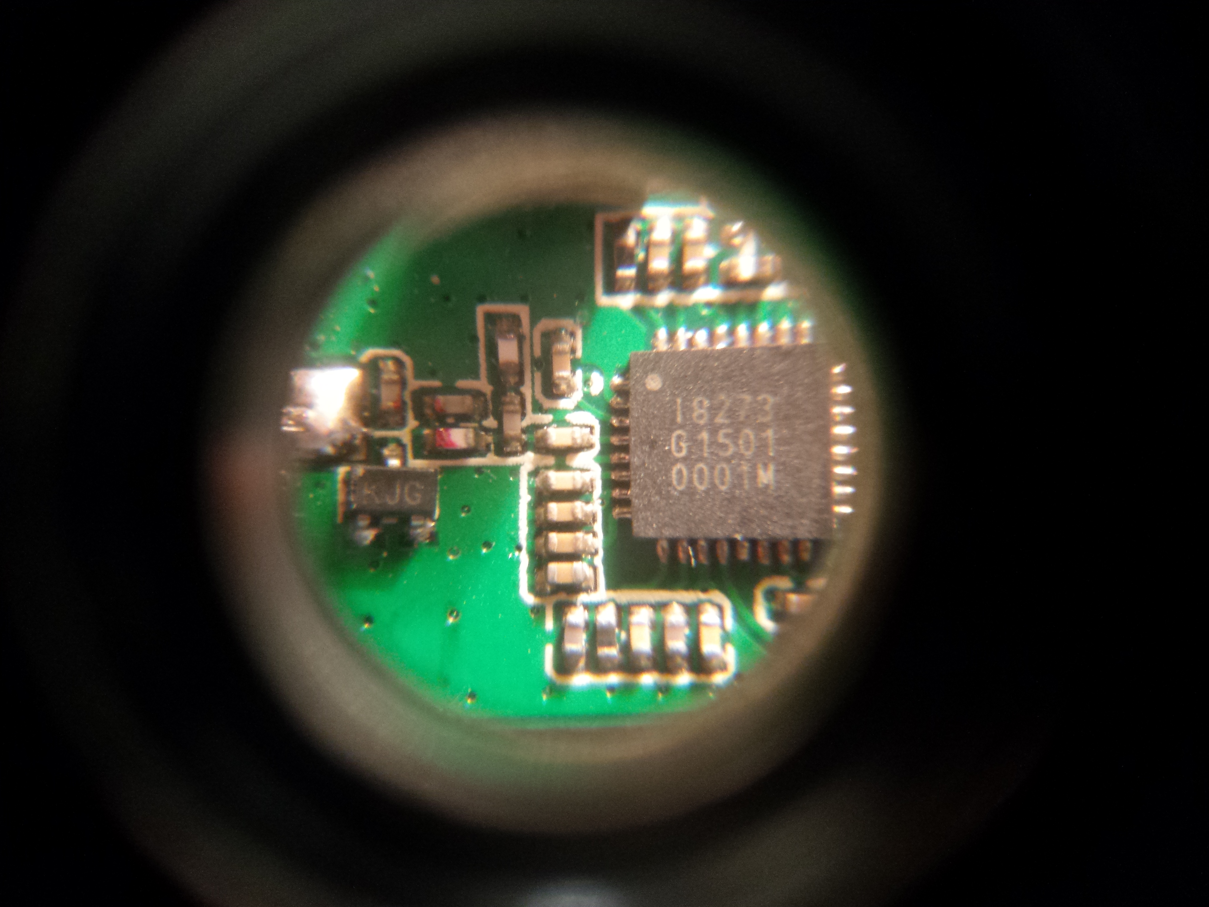

  • Older 2013–2014 tuners lacked the protection diode
    #952 15938769
    don_viking
    Level 21  
    Posts: 562
    Help: 14
    Rate: 136
    I had many of these tuners and none of them had this diode and I bought in various stores and described it in this post. https://www.elektroda.pl/rtvforum/topic2353101-510.html#14847822
    I gave some of the burned tuners under warranty and the photos of those that remained to me are below. There is not even a trace of their assembly. Of course, these were tuners from 2013 to 2014, as you can see from the first digits of the serial number and stickers. Maybe the new versions have a diode, but the old ones mostly did not. The 2012 versions had the E4000 tuner and a different design.
    Maybe other colleagues found tuners with a diode, but I have never had such a dongle.
    Maybe there is also a question of defective tuners, which do not have a complete set of components and are sold, for example, in promotion or cheaper in large networks. Only I used to buy from various stores.
  • Missing BAV99 diode indicates defective tuner batches

  • #954 15940746
    slu_1982
    Level 26  
    Posts: 1093
    Help: 47
    Rate: 339
    I am wondering what the tuner is actually installed on me ...
    Turns out it's the same version 1.1 as don viking has. But I even have other markings on the tuner. Ps. A cool macro comes out of the phone after applying a 20x magnifier :D

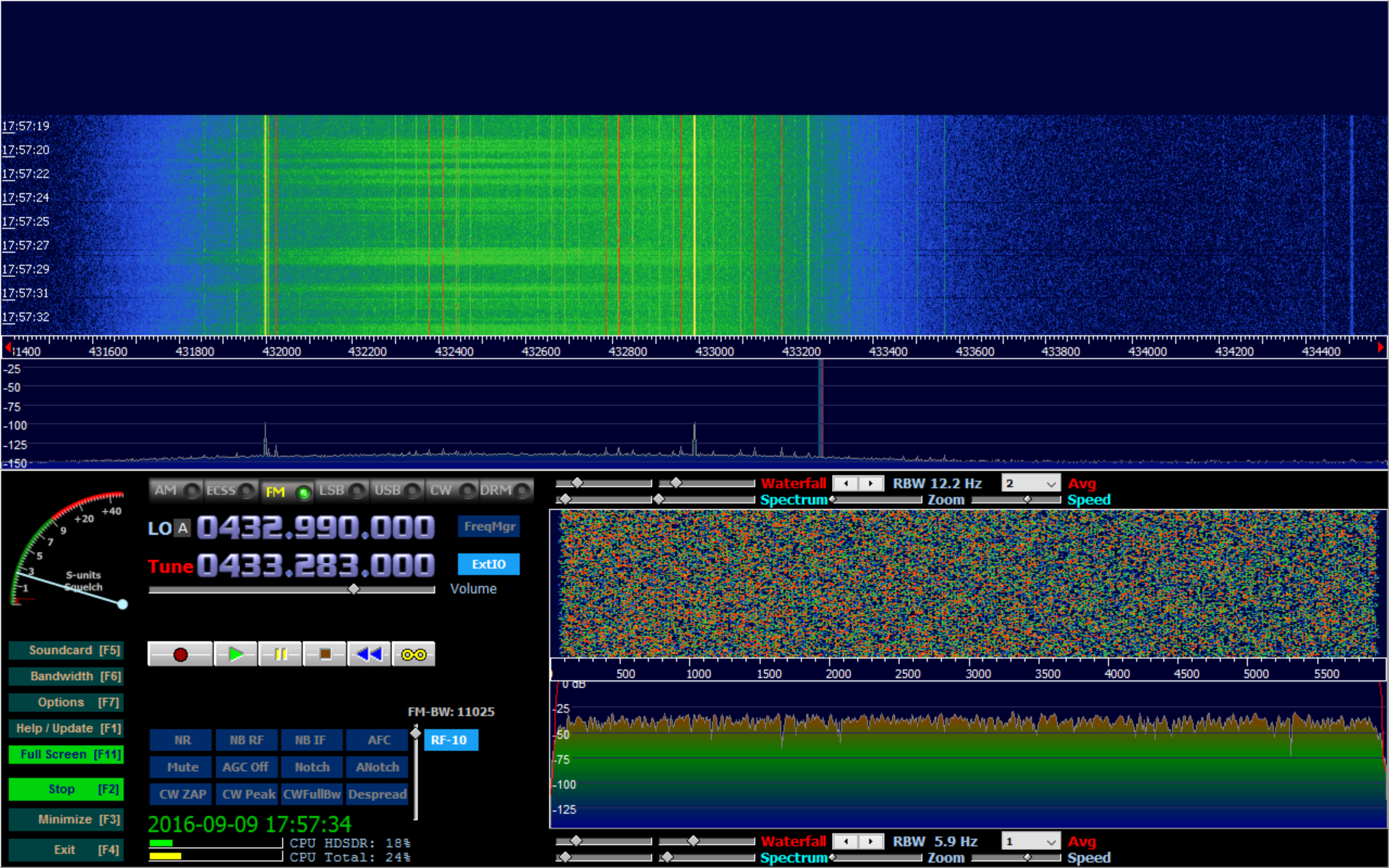

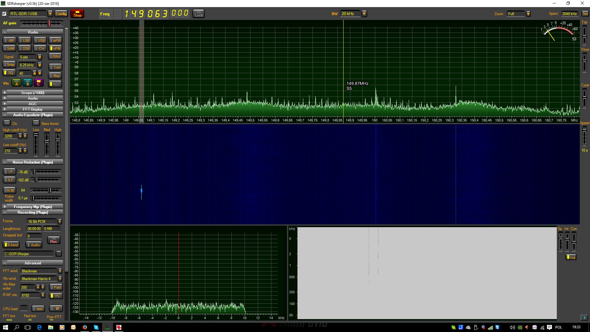

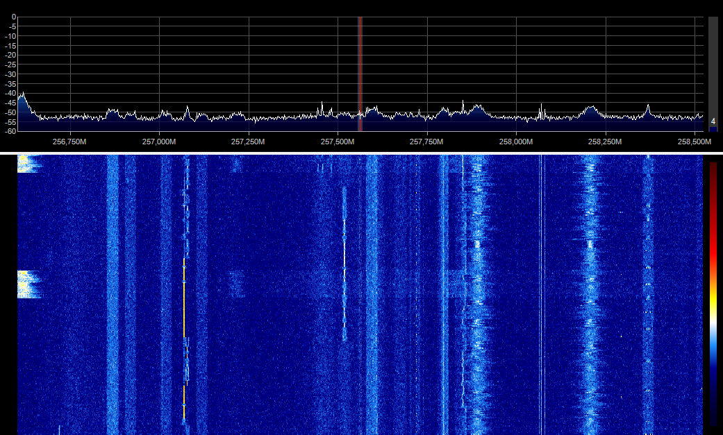

    #955 15941335
    Łukasz Gorzelski
    Posts: 312
    Help: 7
    Rate: 20
    Hello. I started to "play" with the SDR technique for some time. Searching through different frequencies, I found a very interesting signal. Its sound reminds me of a visit to the hospital ward of OJOM. From what I can figure out, it may be a clock signal. However, when browsing the exact bandplans, the transmission of such signals does not fit in the frequency range I found. Maybe someone came across something like this?
    The video is attached.
    • MOV 0387.mp4 (409.45 KB) You must be logged in to download this attachment.

    tygrysss
    Level 21  
    Posts: 1089
    Help: 9
    Rate: 79
    Hello, as I have recently been interested in the subject of SDR, I have a few questions.
    What is the best to buy now (I'm talking here at the tuner)? What antenna (I mean listening to aviation and local walkie-talkies) for this service, as long as the transmissions are not encrypted.
    What program is best for a layman? I have followed the topic, but once that some coefficients (technical abbreviations) do not tell me anything, I do not know what to decide on.
    Best regards.
  • Possible interference from overlapping signals or local devices
    #957 15941515
    Artur k.
    Posts: 25889
    Help: 1279
    Rate: 1701
    I did not find anything the same, but with me, even on an ordinary analog scanner, I perceive similar things. These are either the interferences of two other frequencies on which the data is transmitted and they just make up such a sequence, or some local device. Sometimes such sounds can be sent over the air by a phone, tablet or laptop. Currently, the ether is very littered with digital signals and signals from home appliances.

    Łukasz Gorzelski
    Posts: 312
    Help: 7
    Rate: 20
    Best regards.
    If we are talking about a tuner, the second version of the tuner with the RTL chip is enough.
    rtl2832u-r820t2-sdr-ads (Type in google, search for you on the Allegro)
    On this little device, you have half of Europe within reach. (With the right antenna, you can have the whole one.)
    Personally, I use this tuner with my own made antennas. One per 1090 mHz aviation band. The second for service. I can pick up PSP, OSP, SM, P without any problems, even downloading from 80-100km distant units. The same applies to the aviation bands (I receive these from almost all of Poland and even from neighboring countries.)
    The antennas I use are 1x kolinear 173cm, the other 148cm coiled (9x) for a lifeline.
    I can easily receive signals from NOAA, METEOR and the aviation band on the collinear antenna. The second antenna copes with the services without any problems.
    Local walkie-talkies transmit on PMR 446 (8 channels). To receive them, it is best to be close to them, as devices of this type have poor transmitting power. (In general, I live 8 km from the city and I receive different signals with a collinear antenna.)
    Maybe my statement is not satisfactory, but I am still a layman in this field, I am learning and, as the saying goes, "I combine". So far, the effects are satisfactory.
    ATTENTION ! You must have a permit for such practices.
    I will say this, I received the signal even when there was no power in my town. (SDR and Laptop on battery went.) Well, wi-fi, pc, electronics, household appliances are excluded.
  • Checking laptop and tuner as possible signal sources
    #959 15942185
    Artur k.
    Posts: 25889
    Help: 1279
    Rate: 1701
    For what internships?
    And did you rule out that the laptop and tuner itself could be the source of these signals? Besides, as I wrote - it can also be a smartphone or tablet.
