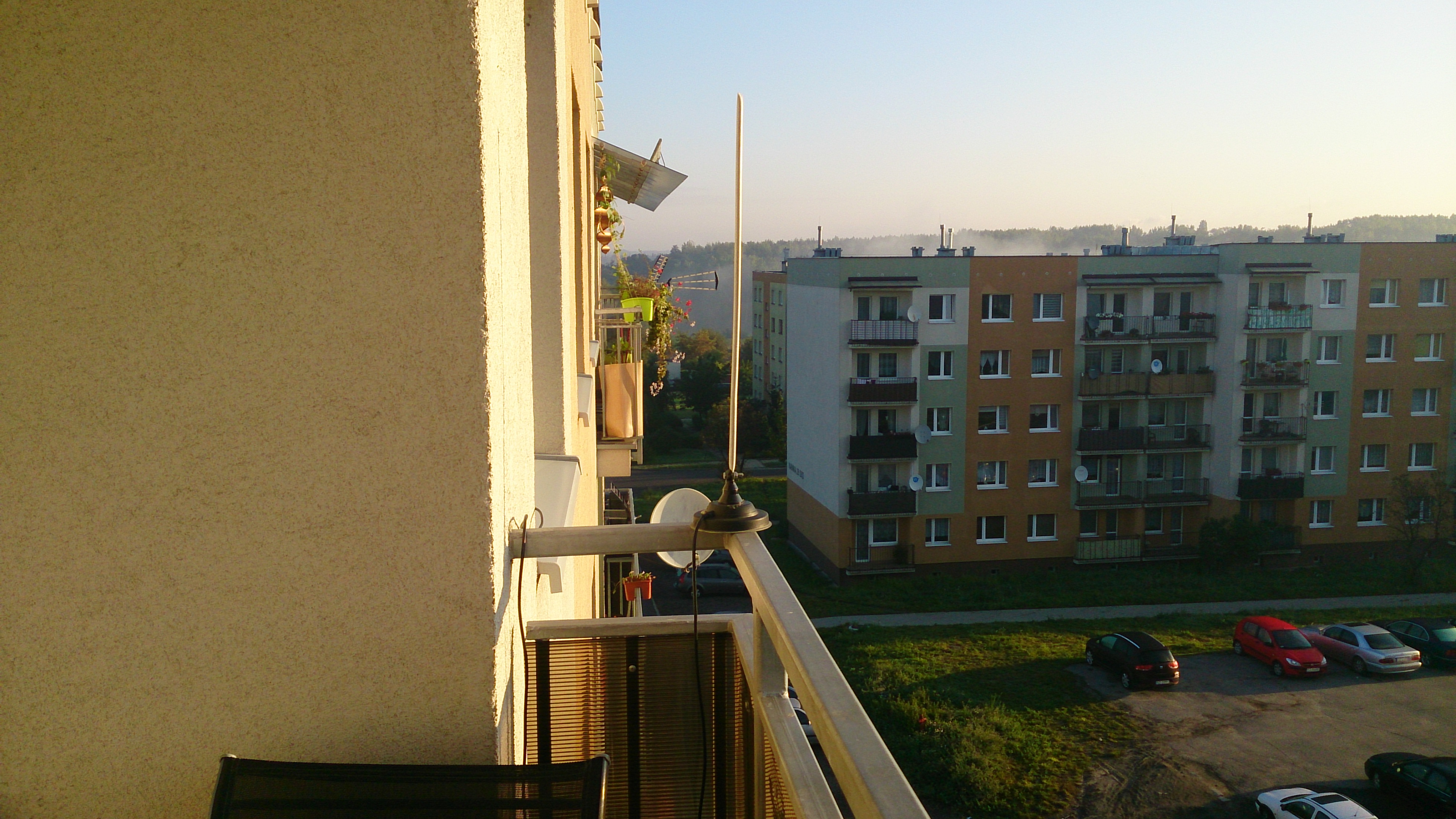

    And if there is a window sill, you can put something up, I have such an antenna on the balcony on the 4th floor and I receive stations within a radius of 10 to 15 km, you have to combine it in various ways. Recently don_viking has released SDR software for SDRsharper (v0.5V) and it is receiving very well. This is my antenna.
    • How to use RTL-SDR on a cheap USB DVB-T tuner for HF and 64–1700 MHz? DSC_1474.JPG (1.86 MB) You must be logged in to download this attachment.

    The fact is that the sill is, even a magnet would probably catch :) oki I will be up to date in October greetings, thank you.

    Buddy MRQPA see post # 961, this is my antenna on the balcony and above 100MHz it works fine, I receive within 30 km, and even planes can see 1090 MHz in the program How to use RTL-SDR on a cheap USB DVB-T tuner for HF and 64–1700 MHz? adds a program for observing aircraft in your area

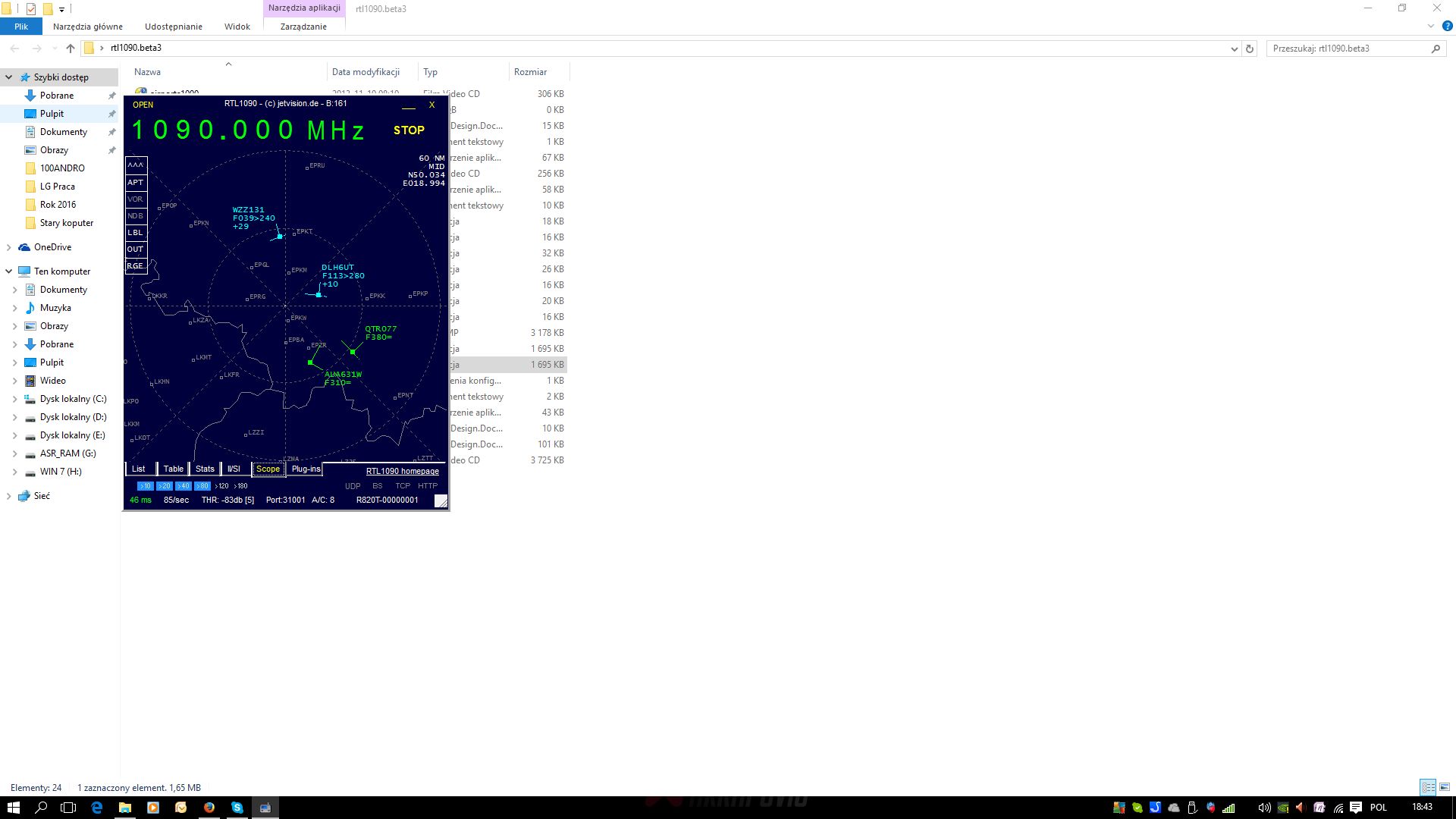

    A program for airplanes, my colleague SP5MET as a radio amateur has experience, but sometimes the samorubs work well.
    • rtl1090.beta3.rar (2.28 MB) You must be logged in to download this attachment.
