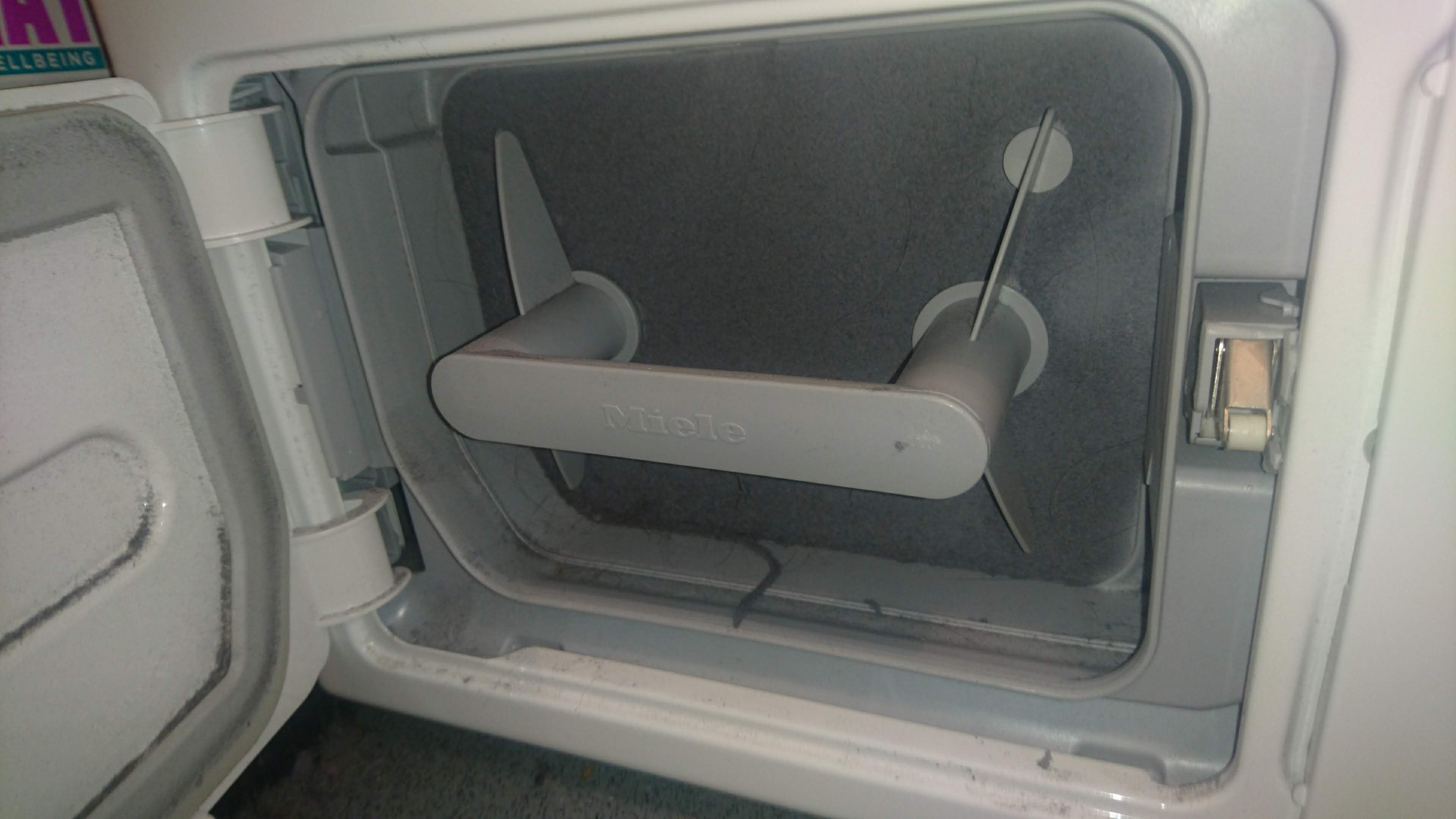

    Yesterday in my Miele a light came on suggesting cleaning the filter. It was enough motivation - the process itself is very simple, open the flap, pull out the handle on which the filter is placed, treat it with a vacuum cleaner, fold it, put it back in, close the flap.
    From this "scaring" here I decided to look at the exchanger - there is no trace of dust on it or any other type of anything after 18 months of use. I know that this does not answer the question of how Miele solved this problem, the foam filter is about 40mm, of which about 5mm is very dense, so it is able to catch all these small fluff flying in the air.
    The filter contamination sensor itself is also very simple - the dryer has a programmed amount of air that should be able to suck (with a clean filter) and if this value drops, the cleaning indicator lights up.
    The recirculation air filter is cleaned after each cycle and it is also very simple. If I have time, I will post a photo or two ...

    Will Nottellyou wrote:
    From this "scaring" here, I decided to look at the exchanger-
    You know that this is not frightening, but facts - maybe you have not read that this applies to heat pump dryers. Please indicate which Miele dryer model you have, because probably without a heat pump.
    I am asking you - any documentation and source of knowledge will be useful.

    Ok, a few photos, I hope they will be uploaded in the right order. Bosch Condenser Tumble Dryer: Comparing WTW85460PL Heat Pump Model and Conventional Options Bosch Condenser Tumble Dryer: Comparing WTW85460PL Heat Pump Model and Conventional Options Bosch Condenser Tumble Dryer: Comparing WTW85460PL Heat Pump Model and Conventional Options Bosch Condenser Tumble Dryer: Comparing WTW85460PL Heat Pump Model and Conventional Options Bosch Condenser Tumble Dryer: Comparing WTW85460PL Heat Pump Model and Conventional Options Bosch Condenser Tumble Dryer: Comparing WTW85460PL Heat Pump Model and Conventional Options Bosch Condenser Tumble Dryer: Comparing WTW85460PL Heat Pump Model and Conventional Options Bosch Condenser Tumble Dryer: Comparing WTW85460PL Heat Pump Model and Conventional Options Bosch Condenser Tumble Dryer: Comparing WTW85460PL Heat Pump Model and Conventional Options Bosch Condenser Tumble Dryer: Comparing WTW85460PL Heat Pump Model and Conventional Options

    I recently saw an identical sponge in a neonet store in some Beko pump dryer.

    Quite possible. the question of what is behind the sponge :) and how the air circulation is done etc. etc.
    It definitely looks like a heat pump model :-) And the exchanger is installed :-(
    A very nice system with several mesh filters one after the other - it catches most of the lint.
    As for this sponge, it looks like a filter for a grooved vacuum cleaner - and there you need a lot of power to push the air through such a filter with adequate efficiency.
    Additionally - in the dryer the air flow should be quite large in volume, and such a sponge does not look like it is able to pass a lot of air.

    I don't know, Miele has a hermetically sealed air circuit so it doesn't have to suck it all the time. As for me, it is important that I put in wet clothes and take out dry ones ...
    In my Dyson vacuum cleaner I have a filter that needs to be washed every few months, then a HEPA filter and that's basically it. Household appliances must be as simple as possible ...
