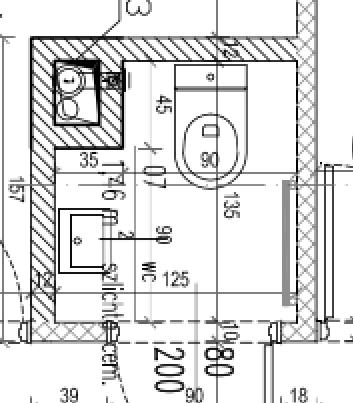

  • #386 17978112
    p
    Posts: 38
    Does it make any sense to put a dryer in a room 1.3x1.3 m (micro laundry)? The room is quite high (2.9m). The dryer would be placed on a Bosch washing machine that is already standing there. There is ventilation in the room (ventilation grille above the washing machine + door undercut), no furniture, no radiator. A "post" made of a washing machine and dryer would have about ~ 12cm of play on the left and right sides, a little less from the back.
    I wonder if there will be a problem with the need to constantly open the door while drying. Won't it get too hot in there at all?
    My guess is that you can only consider the heat pump version?
    Throw (obviously no toilet etc):
    Bosch Condenser Tumble Dryer: Comparing WTW85460PL Heat Pump Model and Conventional Options .
  • #387 17978152
    Borutka
    Posts: 1284
    Help: 125
    Rate: 414
    I have a room of 2.8 m by 1.5 m and there was discomfort with a traditional dryer, mainly due to the humidity.
    You can also install a fan in place of the grille, but my friend probably has a common ventilation duct with the toilet and this is the wrong solution. Besides, now having a heat pump dryer, I would not go back to the traditional one.
  • #388 17978196
    p
    Posts: 38
    I understand you now have a heat pump dryer in the same room and no problem with high temperature / need to open the door?
  • #389 17978210
    Borutka
    Posts: 1284
    Help: 125
    Rate: 414
    Yes. Although a heat pump dryer is also a source of heat, it can be noticeable in such a small room.
  • #390 17978241
    p
    Posts: 38
    How would you rate the noise generated by both dryers and compare it to the noise of a spinning washing machine?
