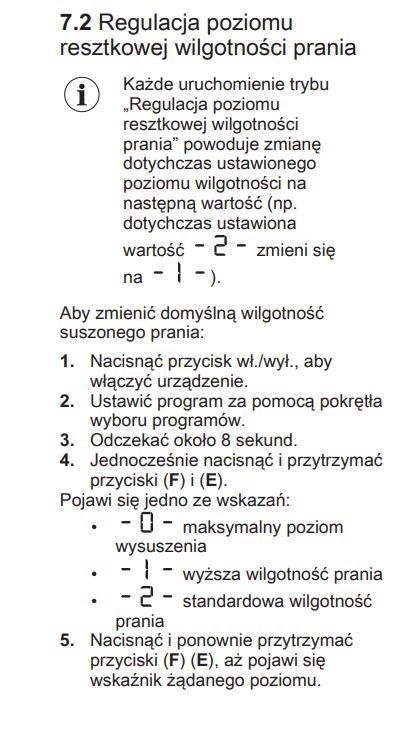

    Does anyone know what is really set in point 7.2 instructions for ew8h458bp?
    Is this the assumed laundry humidity after spinning?
    Or maybe an additional adjustment of the final level of laundry drying?

    You can adjust the final moisture content of the load to be dried.

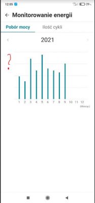

    andrew01 wrote:
    ..... when it comes to Smart add-ons - but how often is it used? Often times at first, but later I don't know. For this, however, there is a significant difference in the price of both devices.

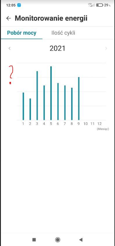

    When it comes to smart and management applications, LG is far behind. Their application is a "crap" ...
    so far (LG ThinQ) I do not know how much the washing machine uses, despite the built-in energy measurement function.
    Read the comments under this app ....
    For example :

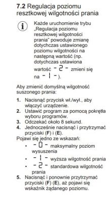

    As for me, it's a bit out of sequence:
    standard humidity is 2, higher humidity is 1 and the highest level of dryness is 0,
    logically it would seem that for 0 it should be - the highest level of humidity.
    Somewhere I read that these changes are made depending on the hardness of the water.

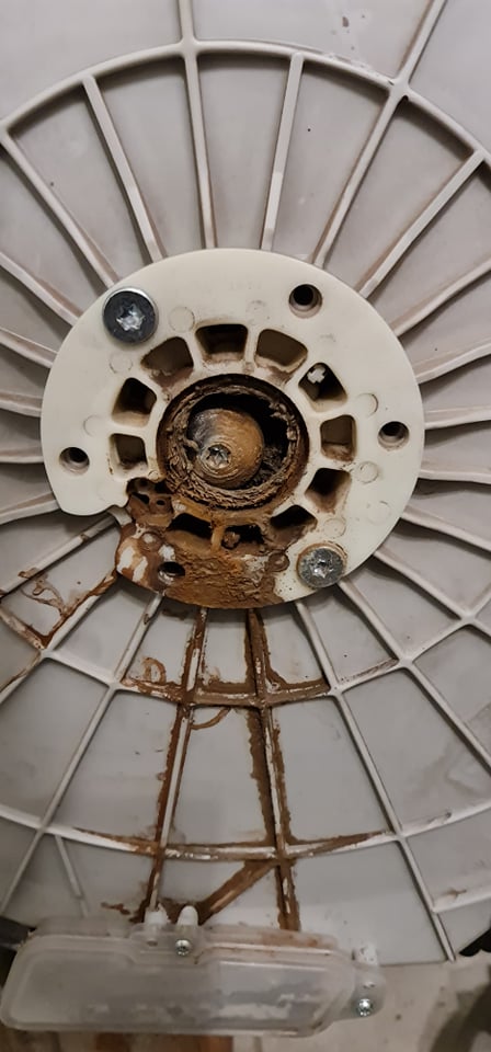

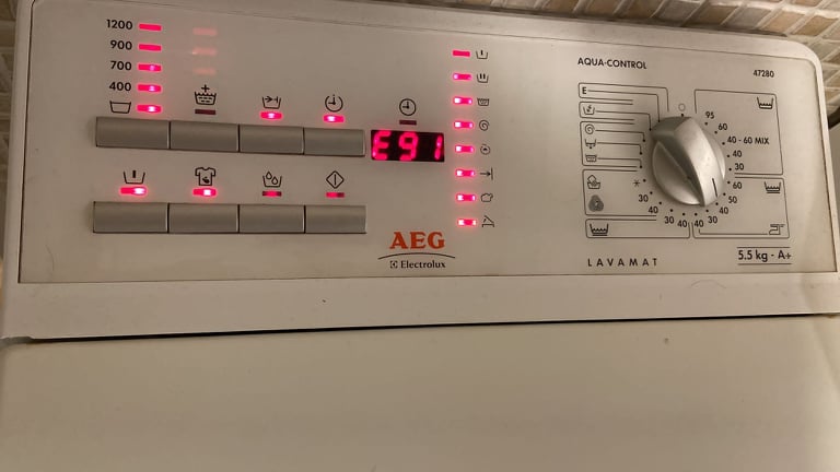

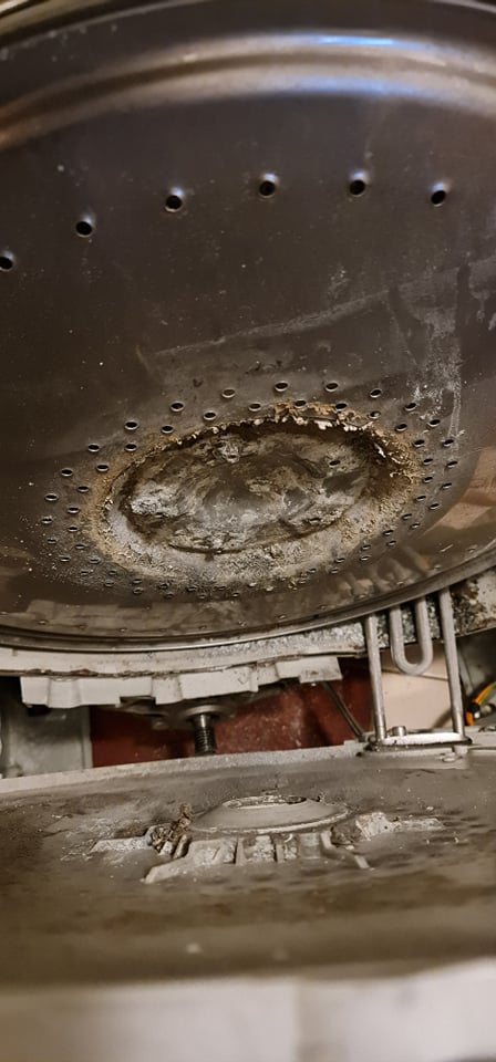

    A friend of mine just sent me such photos from the electrolux stable. I was in the showroom and I thought Bosch WAN2829EPL had a very small loading door, but maybe that was just the impression. But I am not able to determine which Bosh dryer to choose for this set.

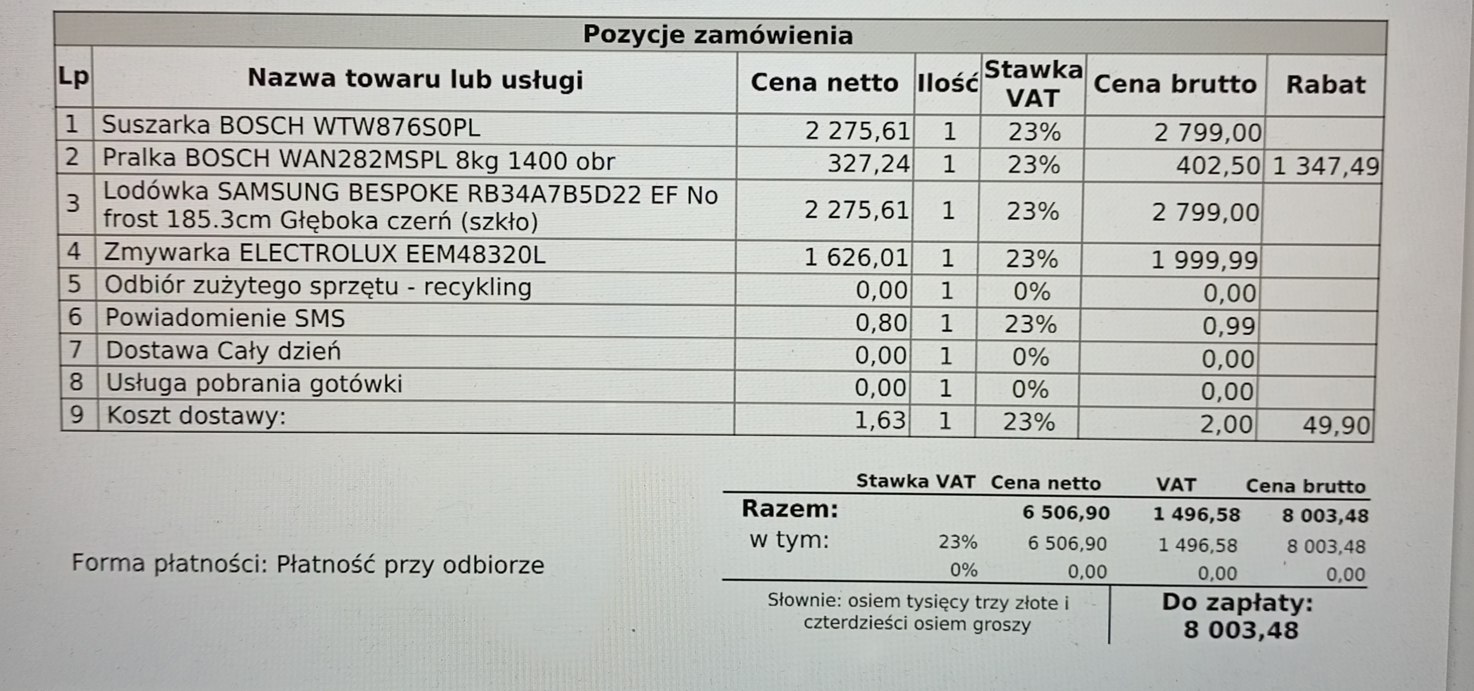

    However, I bought the Serie 6 but with the self-cleaning condenser option, namely the WTW876S0PL in the A +++ class for money not much more than the series 4.
    In addition, the Wan282 MSPL washing machine (I hope that it differs from the Wan2829EPL only in the colors and appearance of the programmer and the guts are the same).
    After all, I'm going to sleep normally today
    Aside from the fact that the photos have nothing to do with the issue of dryers discussed in this topic, but for your curiosity, the first two are a Whirlpool Top Load Washing Machine (AWT / AWE / TDLR or either of the Polar, Bosch WOT twins. , the damage usually occurs when the customer shovels the powder into the washing machine, the second photo, a broken bearing, also the user's fault, and the third photo is a well-20-year-old AEG that has lost communication between the panel and the module, most often due to cold solders.
    EOT

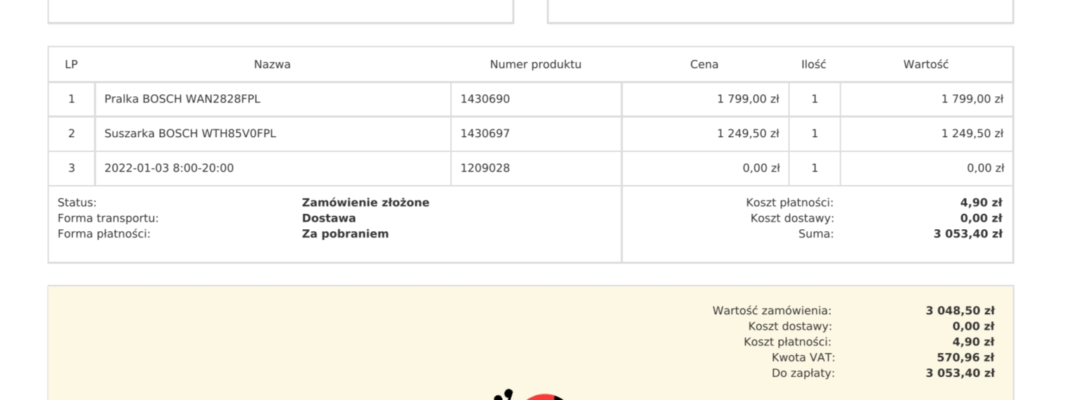

    I went for the smallest and probably the best line .. promotion in one of the dryer stores up to 50% cheaper. This is my first own washer and dryer so maybe I'll be pleased. Such a purchase seems optimal to me. If someone confirms it, I will be grateful. Thanks for the advice.

    Great offer and a decent dryer. Respect the instructions in the user manual and it should run smoothly.
