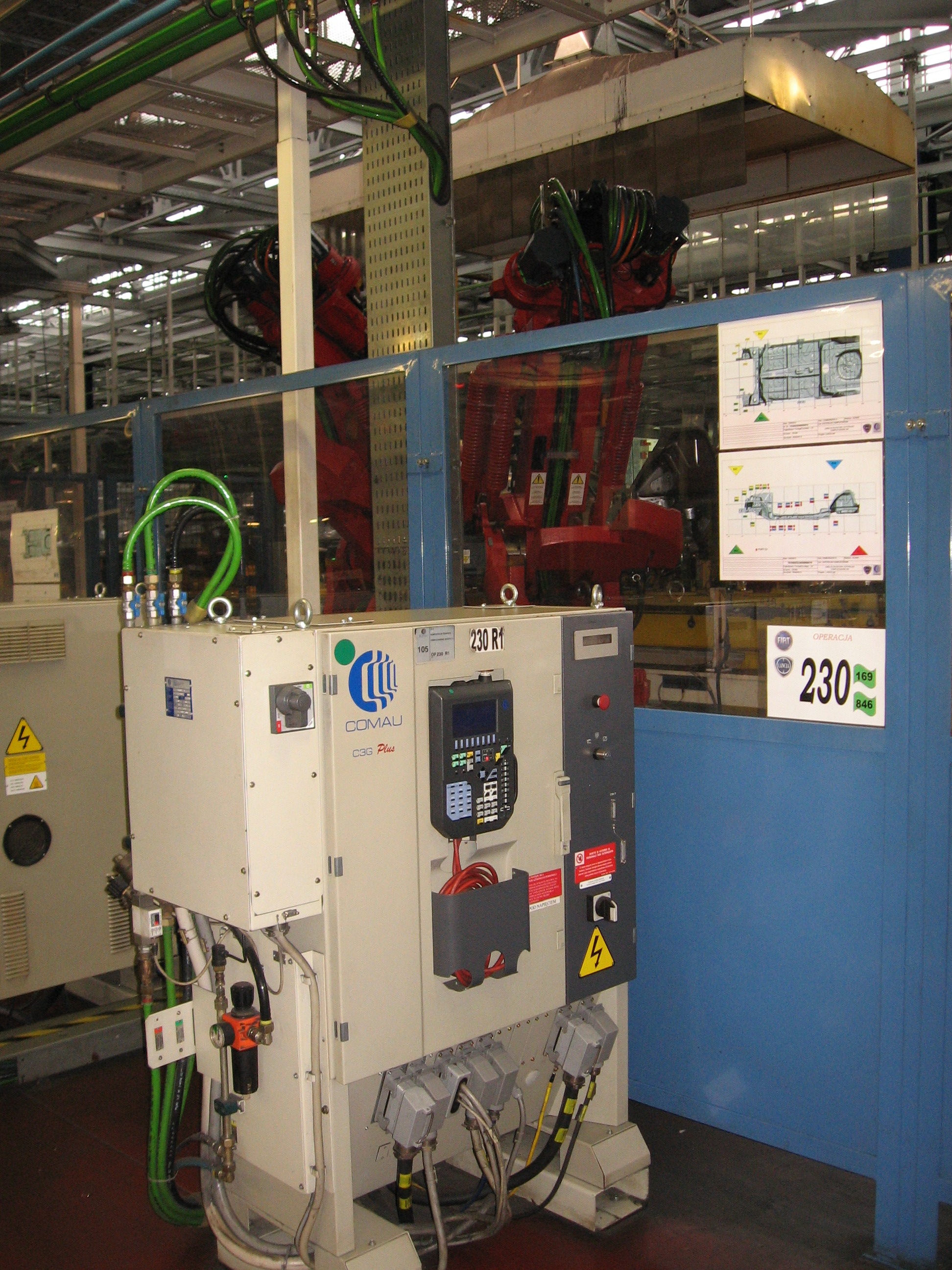

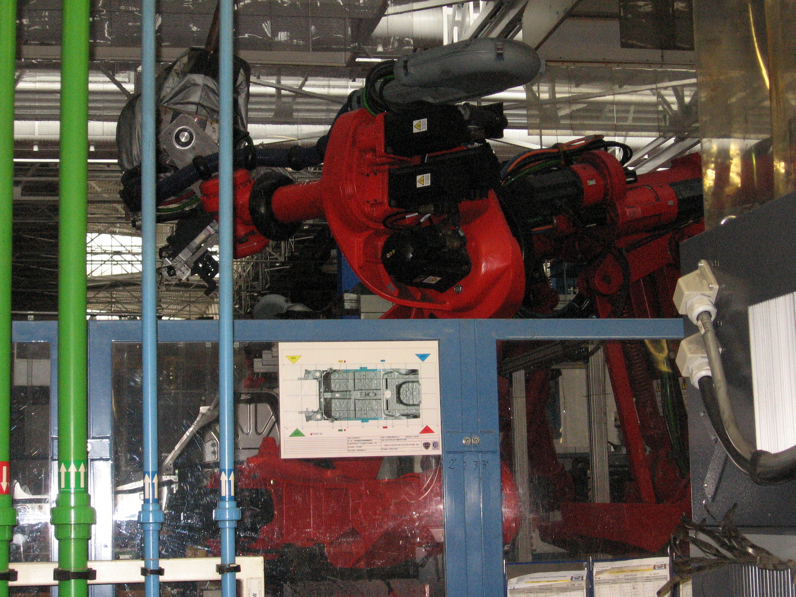

    Hehe, you have some pics from Fiat Auto Poland Tychy, I am enclosing an attachment with photos of robots, mainly Comau, but there are also hitachi and small ABB. All cooled with glycol. The exchangers are in the supply and cooling control stations. Each station has a so-called Pendant. Each is connected to the main cooling tower.
    In the last photo you have a 400 kg drum welding wire feeder.
    In the last photo you have a 400 kg barrel for welding wire
    Nice trip :) envy :D
