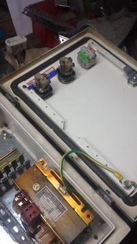

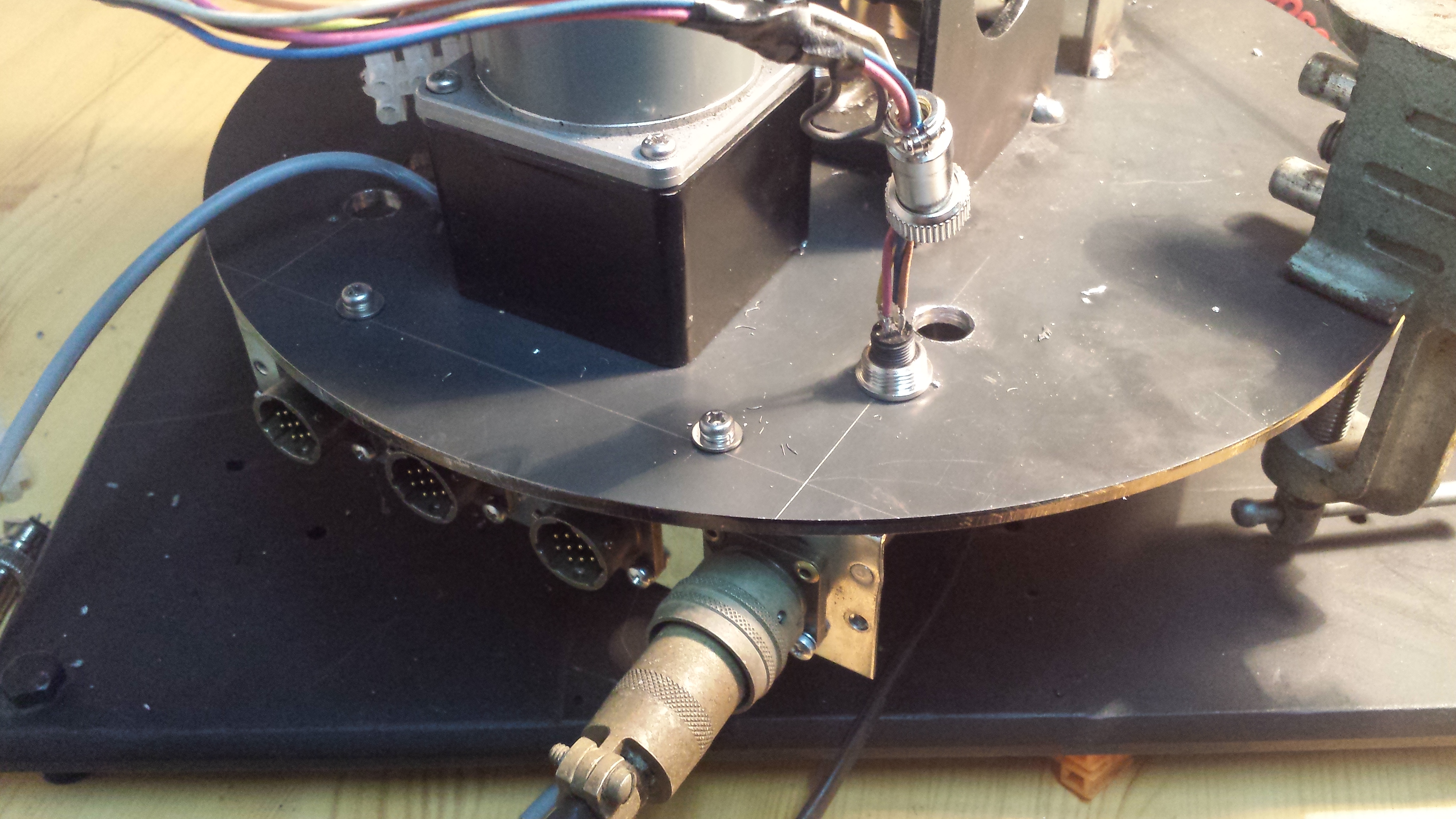

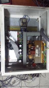

    But getting to the point. The robot that I have built, and in fact I am still building (although I have not done anything with it for a year, I do not consider this project finished) was not created for any specific purpose. As I mentioned earlier, I did something similar for the Olympics in the 2nd class of technical school and it caught me so much that another construction was created and I have another one in my head. Basically, not knowing why, I did not follow any robot.

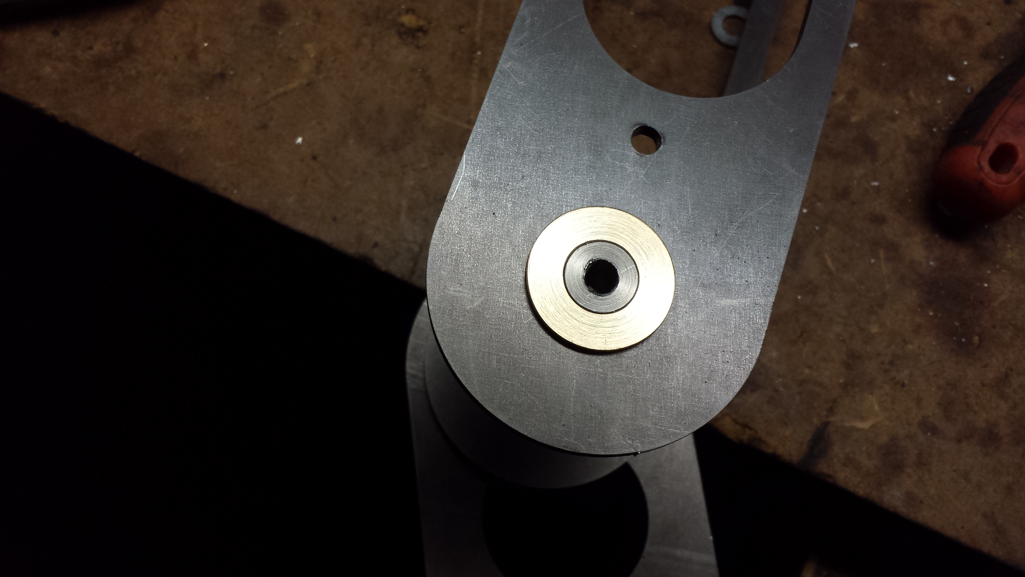

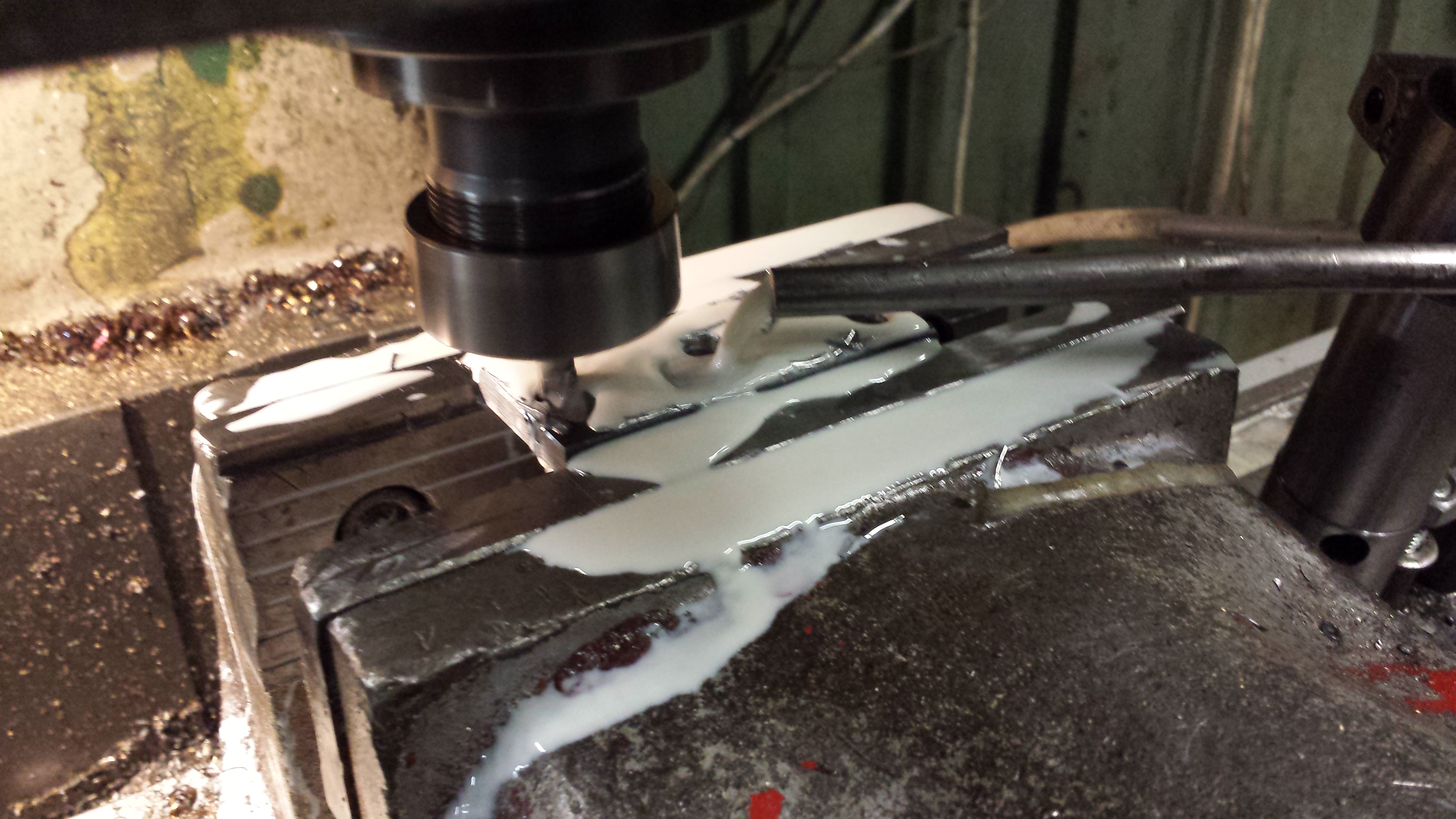

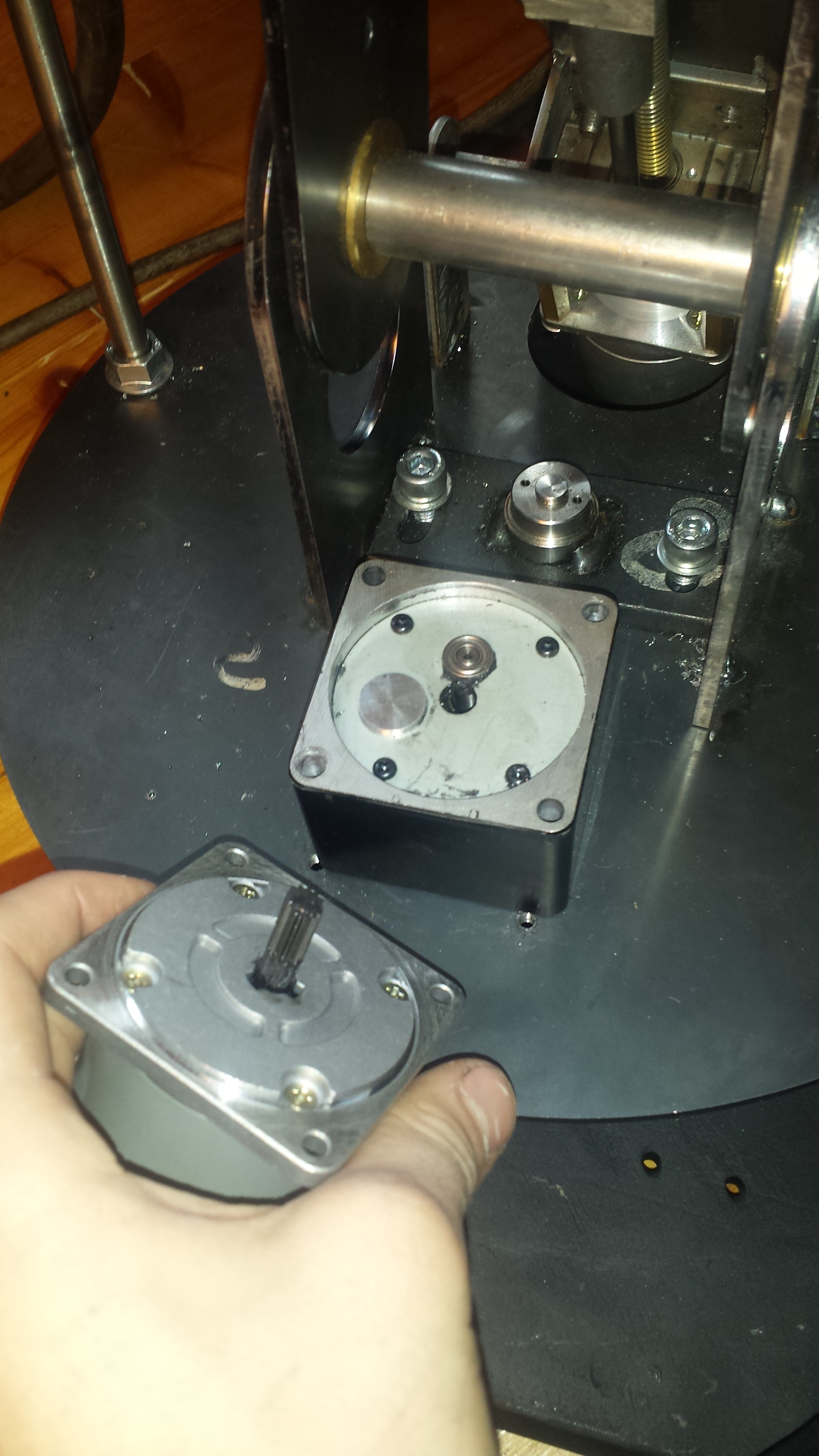

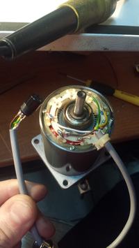

    All the mechanisms that are there are recovered, and more specifically in the junkyard, I found used medical equipment from which I twisted out the more interesting elements and replaced it with a few old burnt power tools. Due to the lack of any large resources, everything was rather done as it was.
    The whole structure was created so that as many elements as possible could be ordered to be burned on the laser.
    All moving parts are mounted on ball bearings, thrust bearings or bronze bushings and it is possible to replace them.
    The robot has 4 degrees of freedom, and the possibility of expanding to 7 if I add another controller and currently two relay outputs. As I did not have elementary knowledge of inverse kinematics at that time, the whole thing is controlled on the Teach In principle. The robot is controlled by the Mach 3 program. After starting the whole operation, drive each axis to the limit switch and reset the readings in Mach 3. Then we drive to the desired points one by one and enter their coordinates with GCODU.

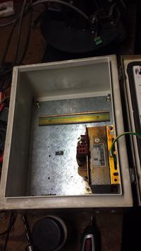

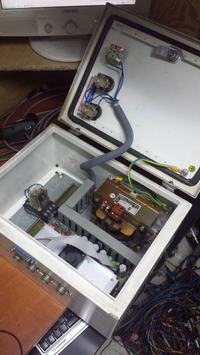

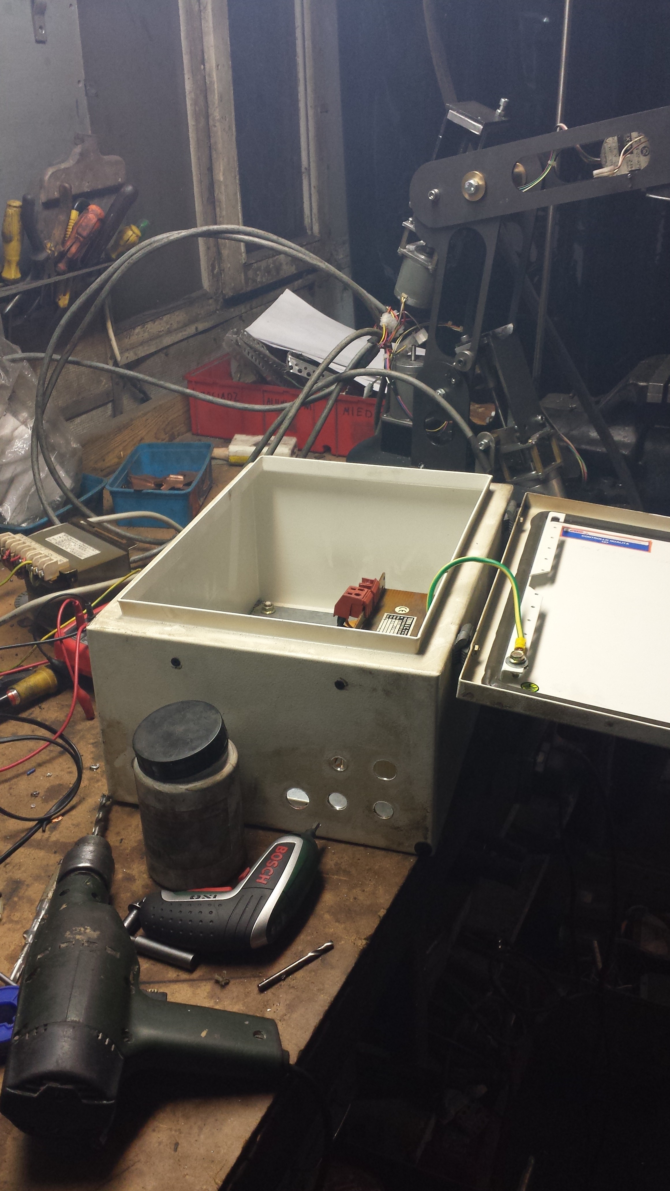

    I know that this is not a professional control, but the only one I was able to handle and adjust at that time.

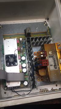

    As for the control system, I use a PC for this purpose. It is connected to an electrical box with a transformer, a 4-axis CNC controller, and a start-stop contactor relay system. Then, by means of high-class shielded cables, the whole is connected to the manipulator.
    The structure is quite complex, so it is impossible to describe the whole in just one elaborate. I am happy to answer any questions. Currently, I am a student of Automation and Robotics, so I am planning another construction in which the programming interface itself will be much more user-friendly. In addition, I have an idea for several improvements, such as automatic maintenance of the welding tip during operation as well as the systems for detecting "sticking" of the welding wire in the tip. The welding tip itself is a manual holder that has been reworked (shortened). The robot works with any MIG welding machine equipped with a Euro connector. So far, I have not done any serious welding tests with it because, as I wrote, it is more of a hobby work.

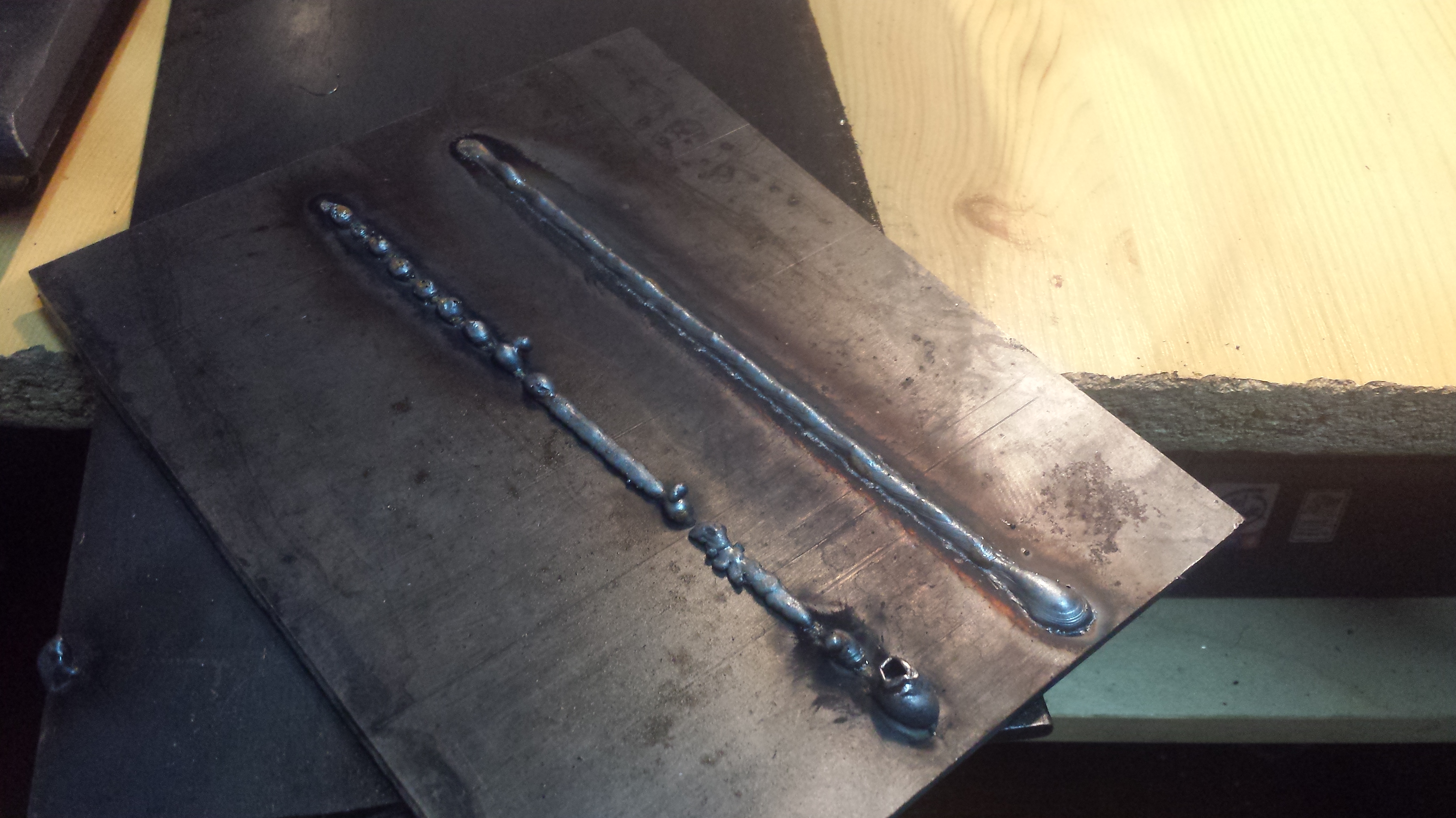

    Here is a photo of the first welding trials:
    DIY // CNC welding robot
    And a video from one of the robot's exhibitions. He then welded several dozen samples without any failure. Since I did it once, I had to fix one February and that's it.

    The welds you see there are just a sample of his first welding test.
    I was able to sort it out later. However, the problem with the structure is the lack of proper control, which means that the movement between the points is not perfect in a straight line. When I was trying to weld two flat bars, the robot easily connected them at the beginning point-wise, but when he was already making a weld along the length in the middle, the end, unfortunately, was a bit too close and the material was melted to the other side. This could be corrected by adding more intermediate points, unfortunately there was not enough time for such tests. Currently, I had to leave the structure at home because of my studies.

    I see. I am also interested in how the rotation mechanism is built in such robots. I was thinking about making a large base and giving a large thrust bearing around the entire circumference to give me a lot of stability. Unless, of course, I find such a bearing. Anyone here has contact with such robots and could someone tell me something?
  • #29 15524544
    TMK_M
    Level 22  
    Posts: 670
    Help: 38
    Rate: 23
    Board Language: polish
    You can't see much and I don't have time to take off the rest of the covers to see how it is built, but you can see that there is one large bearing in the center.
    The servo drive is mounted vertically and it looks like the planetary gear runs on a gear wheel mounted on the side of the fixed base.
  • #30 15536240
    cooltygrysek
    Conditionally unlocked
    Posts: 2813
    Help: 131
    Rate: 529
    Hello, the weld is made of poor quality and caused by a rather bad angle of the wire advance in relation to the material being welded. Please read about welding, in particular about the types of seams and the ways of conducting them, as well as the speed of wire and pipe feed. The selection of the appropriate voltage and current is also of great importance for smelting. As for me, the robot is great for DYI. How many kg can the arm lift? It would also be worth using a small counterweight on the rear axle of the arm, which would improve its movement stability.
