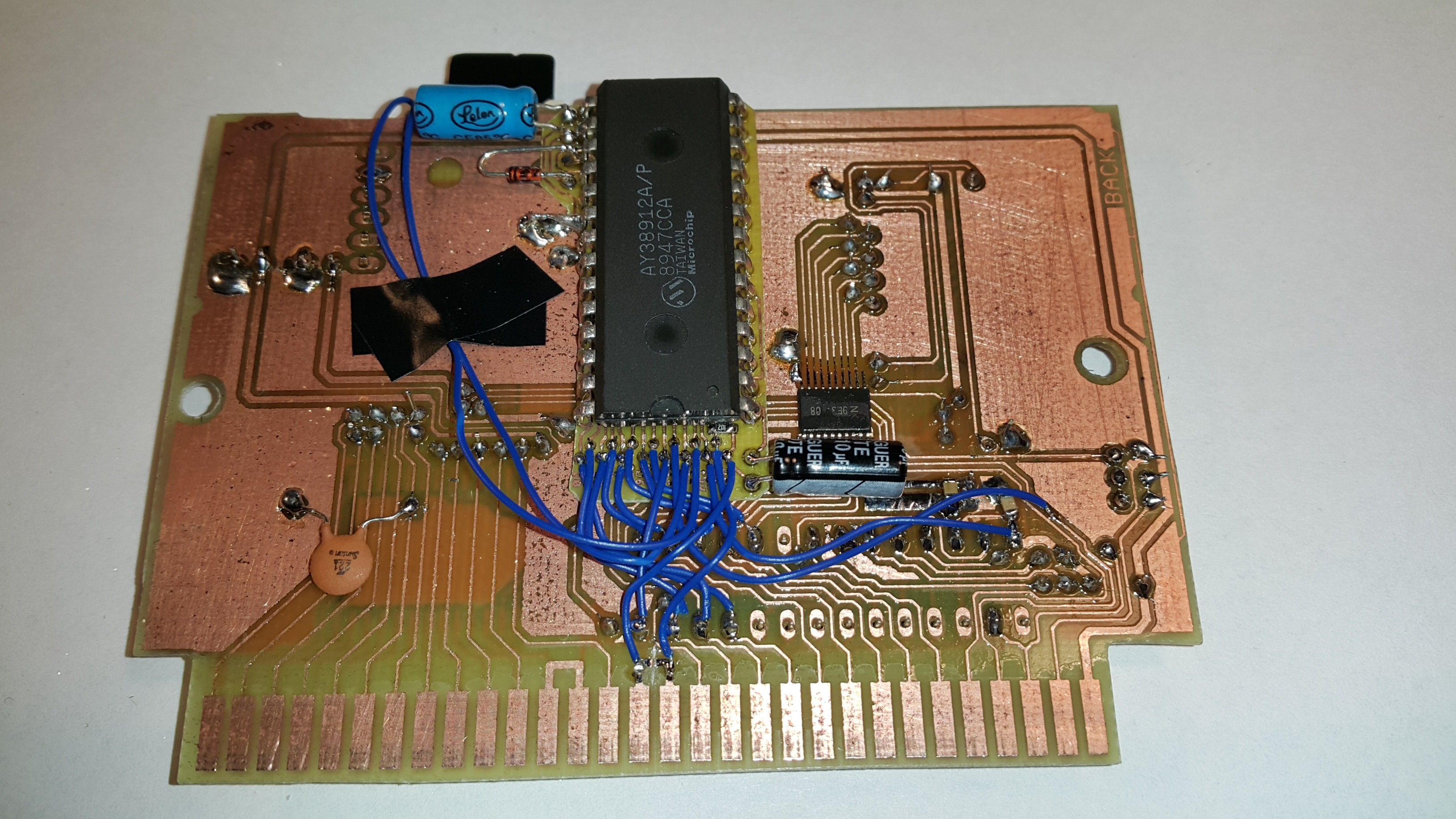

    KrzysioCart is not only a cartridge that allows you to play the most popular games. It is also a testing platform for rare mappers.
    Today I decided to implement mapper # 69 (Sunsoft FME7) support for sport. This is one of the few that allows you to mix additional audio channels (unfortunately only used in the Gimmick game). The mapper takes as many resources as the other mappers put together, so adding it to KrzysioCart as another one is not possible.
    Mapper # 69 as little which allows you to put a PRG-ROM bank in the $ 6000- $ 7fff space. KrzysioCart did not support such a method, so a minor modification was necessary - desoldering two vias and soldering one cable. The mapper operation, described in VHDL language, worked almost the first time after uploading it to the system. The processor cycle counter that this mapper offers (something like the scanline counter in MMC3) caused some trouble, but after a few hours it started working without any problems.
    The Sunsoft FME7 system has an internal generator of additional sounds. Its implementation in an FPGA circuit is not possible, if only because some external digital-to-analog converter would be necessary. The good news is that you can connect the AY8912 sound generation chip, which is compatible with it (by the way, also used in Spectrum computers).
    The whole thing was to fit in a standard cartridge housing - I did not want to commit a `` stack '' construction like some ;-)
    KrzysioCart Micro SD - a revolution for fans of the Pegasus / Famicom console. KrzysioCart Micro SD - a revolution for fans of the Pegasus / Famicom console.
    I decided to design a mini PCB. For this, I chose a very thin laminate (0.6 mm) so that everything could fit into the case. The idea was to look like this:
    The AY circuit itself also required undercutting the feet:
    PCB after production - accuracy down to a tenth of a millimeter. A word of caution for people who are firm opponents of homemade tiles - try to order such PCBs at the factory so that they do not chase you with a stick ;)
    After soldering:
    I fit like a glove:
    It is also not high, although you could have cut your legs a little more.
    After soldering the data bus, control signals and power:
    After completion, the whole thing should be closed in a tasteful housing ;-)
    Gimmick uses the processor in the console to generate music. The AY8912 chip, on the other hand, is used to produce sound effects - the sweet fart between notes comes from it ;)
    I accidentally swapped the lines D0 and D2 going to AY8912, hence the strange noise from it. After the correction, it is as it should be - I am enclosing a sample from the Gimmick game.
    • gimmick.mp3 (471.02 KB) You must be logged in to download this attachment.
