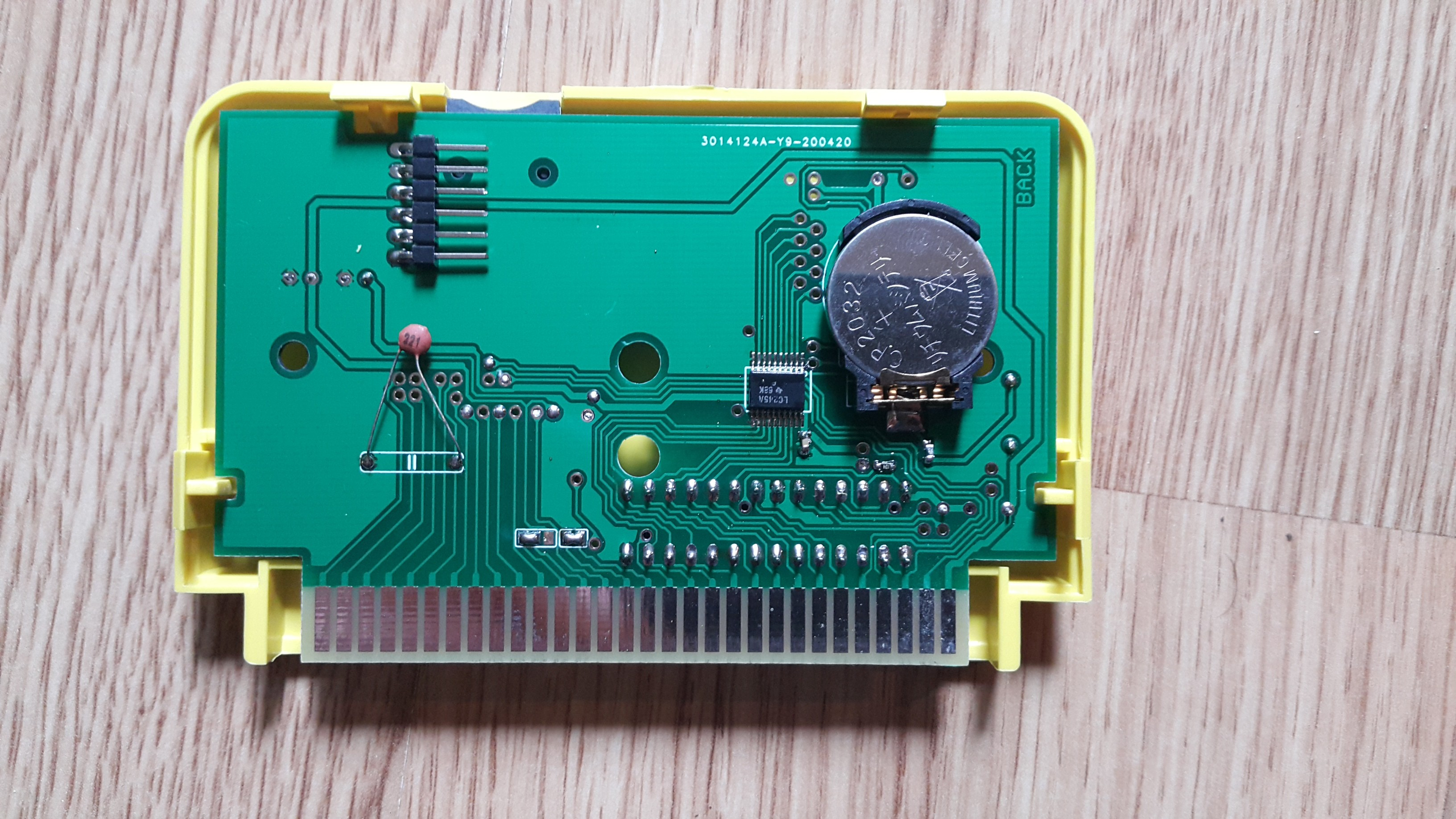

    For the more inquisitive, I will say that for a long time I had the intention of introducing a few modifications to the selector software (i.e. the part of the code responsible for operating the menu and the entire user interface) in KrzysioCarta
    * The main reason was to add a save persistence in the case of games that support saving and have a battery in cartridge releases, e.g. Kirby, Final Fantasy),
    * I also wanted to make some smaller changes according to the suggestions (e.g. automatic cursor movement when we hold the arrow or in the case when there are a lot of files in the folder - speed up the transition to the next screens),
    * and also correct some minor bugs (e.g. in some rare cases, after entering a directory, and then going back to a higher level, from some point on, items may be displayed incorrectly)
    Simply adding a battery to the cartridge would not solve the issue of preserving the record:
    KrzysioCart Micro SD - a revolution for fans of the Pegasus / Famicom console.
    * First, because the selector also uses this memory for its own purposes and the data saved by the game would be erased.
    * And even if you eliminated the use of this memory, after selecting a new game, the save from the previous game would be erased with the new one.
    So a different approach was needed.
    Of course, I had to start all the work by reviewing and analyzing the code that I hadn't looked at for 1-2 years. Unfortunately, with assembler it is so, that sometimes and after 2 days, looking at a fragment, I wonder not what it is responsible for, but whether I wrote it at all :) )
    The first step was to streamline the testing process. Believe it or not, the work cycle so far has been as follows:

    Fixes (improvements) compared to the previous version:
    * the cartridge has a battery that stores the contents of the internal RAM memory when you turn off the console. After restarting, the memory content is automatically transferred to the micro SD card (to the! SAVE directory), and when you select the same game again sometime, the save state is restored. Selecting another one when it DOES NOT CAUSE the loss of the previous write state. The files with the saved state can then be read on the computer and, for example, finish the game on the emulator or the other way round - the game started on the emulator can be finished on a real console.
    * adding support for mapper 30 - now it is also possible to play games created with NesMaker - a program facilitating game development or other unofficial titles with a size of 512 kB using mapper No. 2 (e.g. Battle Kid 2),
    * displaying subtitles was previously implemented as: 1) disable image generation, 2) display, 3) enable image generation, which caused flashing. Currently it is: 1) wait for vblank 2) view.
    * Display the names of buttons "A", "B", "SELECT" as graphics instead of text on the main screen
    * Holding down the down / up / right / left button scrolls continuously
    * When going to the next page with the list of files, the information from the previous function call is used, thanks to which the screen appears faster
    * Unicode characters> 127 (regional) will be displayed as a dash instead of something random.
    * wide range of housing colors with a choice of your favorite color

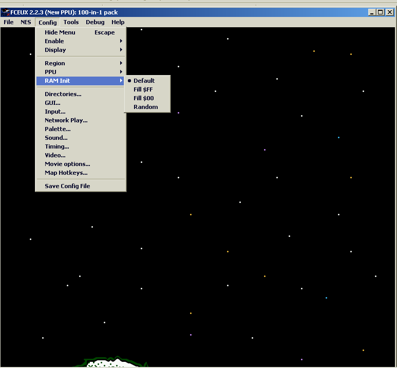

    Hi, I have been writing a pegasus game as a hobby for some time and I bought a new cruciform card with a write option to test whether the game will work on a real console and not only on an emulator :) The game works fine, but I noticed one thing that I wanted to ask out of curiosity. Namely, when I tested the game on the emulator earlier, I noticed that the values in WRAM are filled with 0x00 by default. So, taking the easy steps, I found that I would be checking if there are any saved game states based on whether the first byte from the address where I am keeping the save is non-zero. After starting the game on the console with krzysiocart it turned out that the game claims that there are already some saved game states, surprised I copied the .sav file to see what it looks like. And it looks like it is written by bytes 0x60 to 0x7F repeated 256 times each.
    I don't mind, of course, I've already changed the game code to make it work properly :) I just wanted to ask, out of curiosity, why is it that the initial values in WRAM when the game is launched for the first time are not different :) .

    The emulator gives the option of choosing how to initialize the RAM at startup (although I don't remember if it only applies to RAM from $ 000- $ 7ff or $ 6000- $ 7fff.
    Imagine you have a cartridge with no memory at $ 6000- $ 7fffi, and the game is trying to read the cell value from that address, e.g. $ 6005. What will he see?
    Data reading can be performed using various instructions, e.g.
    LDA $ 6005
    LDA $ 6000, X; X = 5
    LDX $ 6005
    LDA ($ 02), Y; $ 02 = $ 05, $ 03 = $ 60, Y = 0
    However, the common feature of all these instructions is that before the read cycle at $ 6005, the last value on the data bus was the high byte of the $ 6005 address, or $ 60. Why?
    For example, for the instruction "LDA $ 6005" the command code is "$ A9 $ 05 $ 60"
    The processor executing this command will generate the following read cycles:
    Adres     Wartośc na magistrali
    xxxx      $A9 ;kod rozkazu
    xxxx + 1  $05 ;młodszy bajt adresu
    xxxx + 2  $60 ;starszy bajt adresu
    $6005     $60 ;ponieważ pamięci WRAM w kardridżu nie ma, to nic nie wysteruje szyny danych w tym cyklu,
                   czyli na szynie będzie obecna wartość taka jak w poprzednim cyklu (linie danych zachowują się jak
                   pojemności)
    Some of the games, for unknown reasons (programmers' error? Deliberate action "obstructing" something) behave in this way - they try to read something from the memory, which in fact is not in this cartridge. This is what, for example, Battle Toads does - and if the value read is different than expected, the game will crash (surprisingly not immediately, but after the first level)
    Therefore, each WRAM memory cell in my cartridge is initialized with the value corresponding to its older address byte before starting the game, i.e.
    $ 6000 -> $ 60
    $ 6001 -> $ 60
    $ 6100 -> $ 61
    This method of initialization is to "pretend" the "open bus" phenomenon, that is, to imitate the behavior if this memory was not there.
    If you care about the consistency and correctness of the record, be sure to calculate a checksum of the saved data and also save it in the RAM, and then compare whether it is actually equal to what it should be.

    Thanks for the answer, I'll use a checksum. (I should have done this from the beginning, but laziness got the better of me :) now I have a lesson)
    Thanks also for the in-depth explanation, I did not think before what happens when we want to read a value from memory that is not there. It makes sense now.
    If I understand correctly, how do we read the value from the address $ 6101 without WRAM like this:
    LDX # $ 02
    LDA $ 60FF, X
    We will load the value of $ 60 into the accumulator, not $ 61? So your solution does not simulate the open bus phenomenon 100%? (yes, I know, I'm picking on, it probably couldn't have been done better: p)
    One more question, if we don't have WRAM, how does it work with CMP for example? If we use:
    CMP $ 6005
    the accumulator will be compared to the value of 0x60 and flags will be issued on this basis?
    And as for the Christopher Robin, it's a great job at an affordable price, keep it up!
    Unfortunately, yes, but only the emulator can mimic such things (of course I could turn off RAM for all mappers that do not use RAM by default, but even FCEUX does not).
    An interesting issue, because it does not only apply to RAM, but also e.g. unused bits in the joystick port - e.g. some games reading $ 4016 expect a value of # $ 40 or # $ 41 (e.g. Paper Boy)
    CMP $ 6005
    From the outside, the CMP instruction from the LDA is no different - the processor has to perform the same read cycles to get the value from memory, so it will behave the same.

    I see that KrzysioCart is still being sold. Therefore, I have a question - what is the issue of PCB thickness at the moment? The original version (i.e. the one made by hand) was a bit thicker than the connector in Pegazus. Has it been corrected?
  • All board versions were kept at 1.2 mm thickness
    #105 20347918
    phanick
    Level 28  
    Posts: 2956
    Help: 65
    Rate: 2840
    It was certainly not thicker, the first version (on a home-made PCB) was also 1.2mm thick.
    Then there was another version from the factory, in HASL technology
    And now (and it has been for a long time) it is a version with gold-plated contacts (ENIG).
    In total, there were probably about 8 different versions of the tiles, differing in minor details.
    All versions were 1.2mm thick, I always took care of that because I know that thicker plates push the contacts apart.
  • Questioning whether thick solder, not PCB, damaged contacts
    I know you said that and I believe you meant well, but I have a home-made KrzysioCarta plate myself and I know that it cracked the contacts in my Chinese Famicon with Aliexpress. That's why I don't take KrzysioCart out of it anymore. It is possible that it is not a matter of PCB, but a thick layer of tin, so this problem may not be present on the new KrzysioCarts.
    Anyway, I wanted to make sure.
    Are there plans for more mappers?
  • Tight socket and contact memory effect explained
    #107 20347973
    phanick
    Level 28  
    Posts: 2956
    Help: 65
    Rate: 2840
    It is not possible, I have never tinned the contacts in any cartridge. The first versions were made in housings that held the slot quite tightly, so if the cartridge is difficult to insert / remove from the slot, that may be the reason.
    If the cartridge has been sitting in the console non-stop for several years, the contacts may change their shape (memory effect), but also a lot depends on the quality of the socket.
    In this version of the cartridge (with once programmed logic) it is not possible to fit more mappers, but currently working on a different version in which the FPGA (different) will be reprogrammed after each game load and then the number of supported mappers will not be limited.
