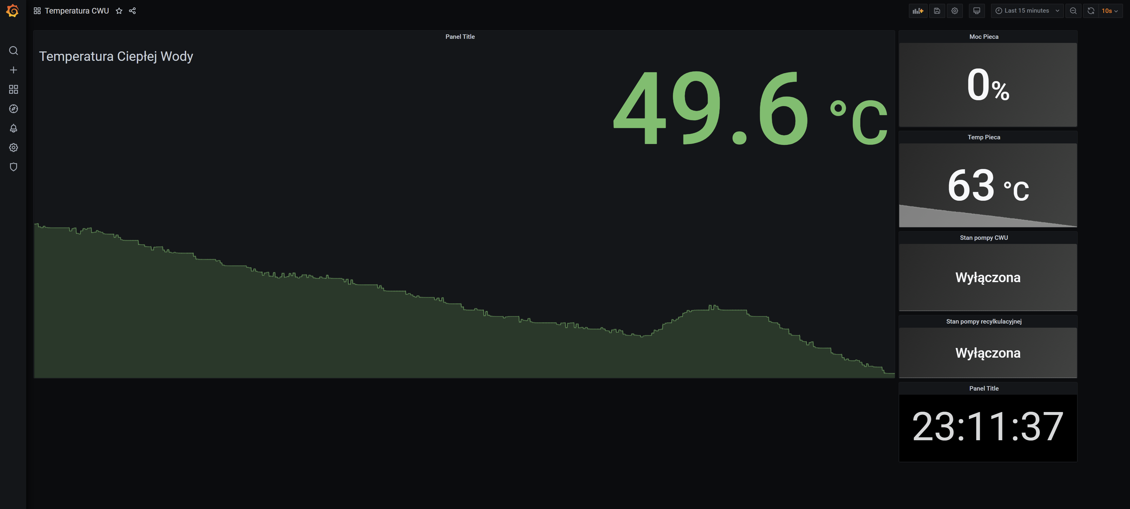

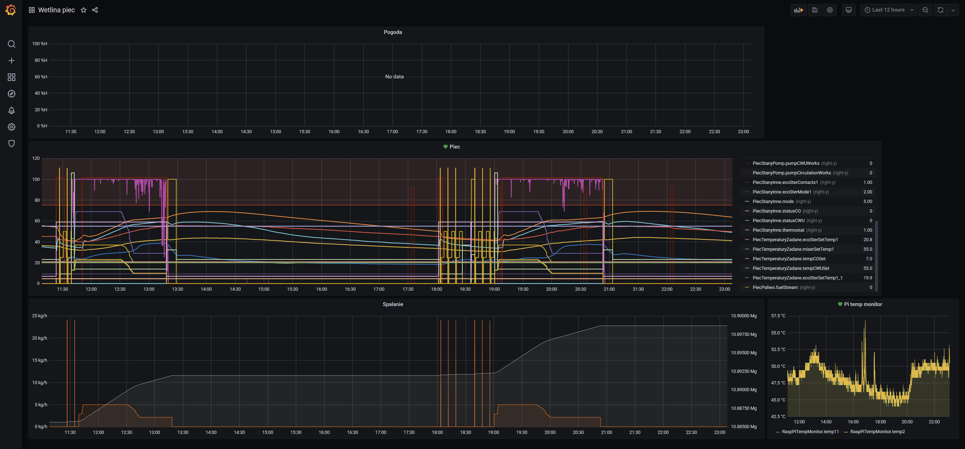

    I know this is quite an old thread, but thanks to it I was able to do a pretty nice oven monitoring with Raspberry PI and Graffany + InfluxDB.
    It looks something like this:
    Internet module ecoNet 300 and ecoLINK2
    On the subject of modes of operation - The answer is probably in the file ecomax.py, line 311.
    Code: Python
    Thank you very much to all participants of this post who made it possible to figure out this driver with their work.
