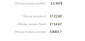

    With my Metal-Craft, I currently have:
    Panel "12.10.32"
    Module A "12.11.42P1"
    Touch T1 "1.13.71"
    ecoNET "" 3.2.3678 "

    Colleagues, I have a question.
    Has anyone played with logging in from EcoNET ??
    For the time being, I was extracting the data with the interval of 10 seconds and uploading it to CSV.
    From my observations it comes out (very randomly) from time to time in the JSON response we get one duplicate data, as a result, in order to make a graph, these shifted records need to be moved back one field.
    Does anyone have the same symptoms? I don't know, maybe it's some "babol" in the software.
    I call the script on an interval, haven't opened it for a while to check that this shift is not accidentally caused by opening a .csv (access blocking at this point), but no change.
    watch -n10 'python3 piec_csv.py'

    EcoMax 810 controller. I managed to get the details of the mixer that is connected to module B. A seems to ask B and gets the answer. However, all the sensors that are important to me are connected to the A module, which does not send any of its data. Has anyone managed to force the data from the driver?
    Unfortunately, in this case, the econet sources are not helpful, because most of the data does not seem to match (although turn on / off works ..)

    SławekSS, change commands work for me, in what you linked, I don't know if you noticed underscores were missing in the parameter name:
    http: // adreseconetawnaszejsieci / econet / newParam? newParamName = CWU SET TEMP & newParamValue = 44.
    I'm sending http://192.168.1.50/econet/newParam?newParamName=MIX_SET_TEMP_1&newParamValue=37 gets JSON feedback:
    paramName "MIX_SET_TEMP_1"
    paramValue 37
    result "OK"
    I check http://192.168.1.50/econet/regParams and see:
    settingsVer 15512
    editableParamsVer 10
    schedulesVer 0
    remoteMenuVer {}
    currentDataParamsEditsVer 0
    curr
    tempExternalSensor 1.845733642578125
    thermostat 1
    pumpCOWorks true
    mode 3
    mixerPumpWorks4 false
    mixerPumpWorks5 false
    mixerPumpWorks1 true
    mixerPumpWorks2 false
    mixerPumpWorks3 false
    status DHW 0
    tempCO 63.03253173828125
    fuelLevel 0
    pumpCO true
    tempCOSet 68
    tempBack 56.12420654296875
    contactGZCActive false
    mixerTemp3 null
    mixerTemp2 null
    statusCO 0
    boilerPower 78
    pumpCWUWorks false
    mixerTemp5 null
    pumpFireplace false
    mixerTemp4 null
    pumpSolar false
    mixerTemp1 37.05369567871094
    mixerSetTemp4 40
    mixerSetTemp5 40
    pumpCirculation true
    pumpSolarWorks false
    mixerSetTemp1 37
    mixerSetTemp2 40
    mixerSetTemp3 40
    pumpCWU true
    boilerPowerKW 14.207280158996582
    tempCWUSet 46
    contactGZC false
    pumpCirculationWorks false
    fuelStream 1.8214460611343384
    transmission 0
    pumpFireplaceWorks false
    tempFeeder 29.343154907226562
    temp DHW 45.083740234375
    fanPower 29.412567138671875
    you can see that he adopted mixerSetTemp1 because I had 38 before.
