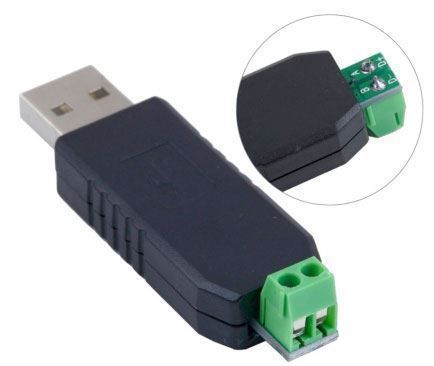

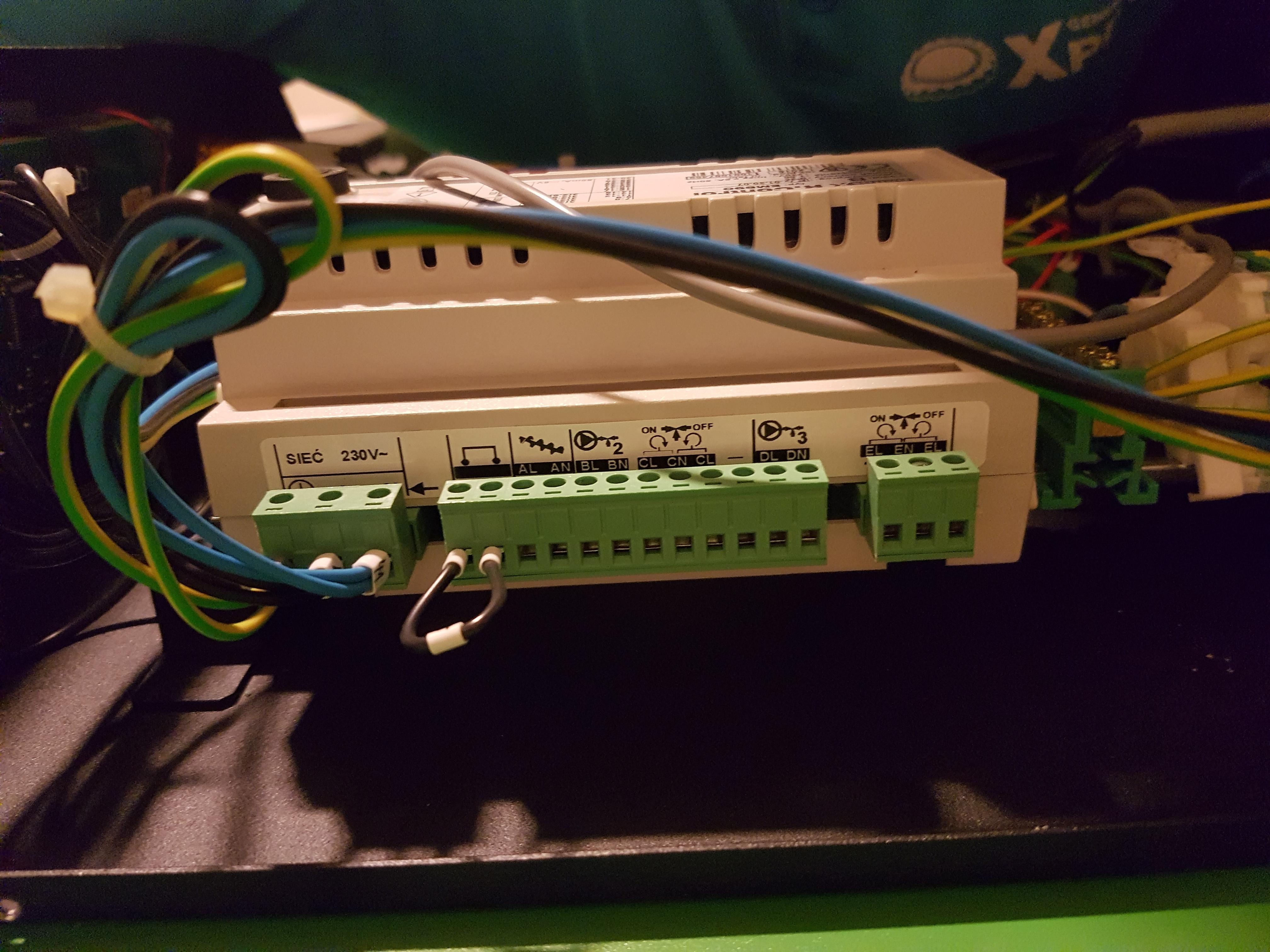

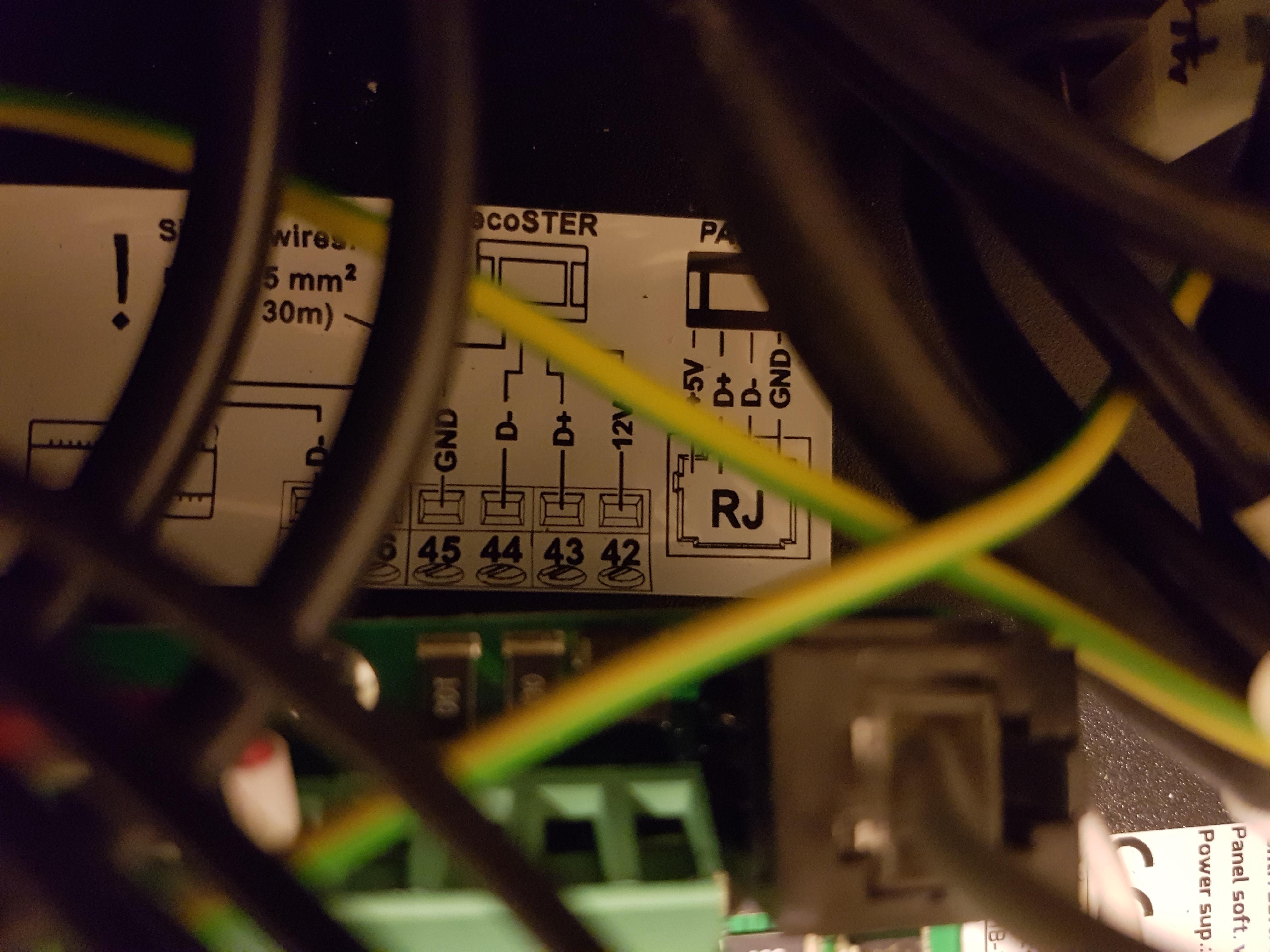

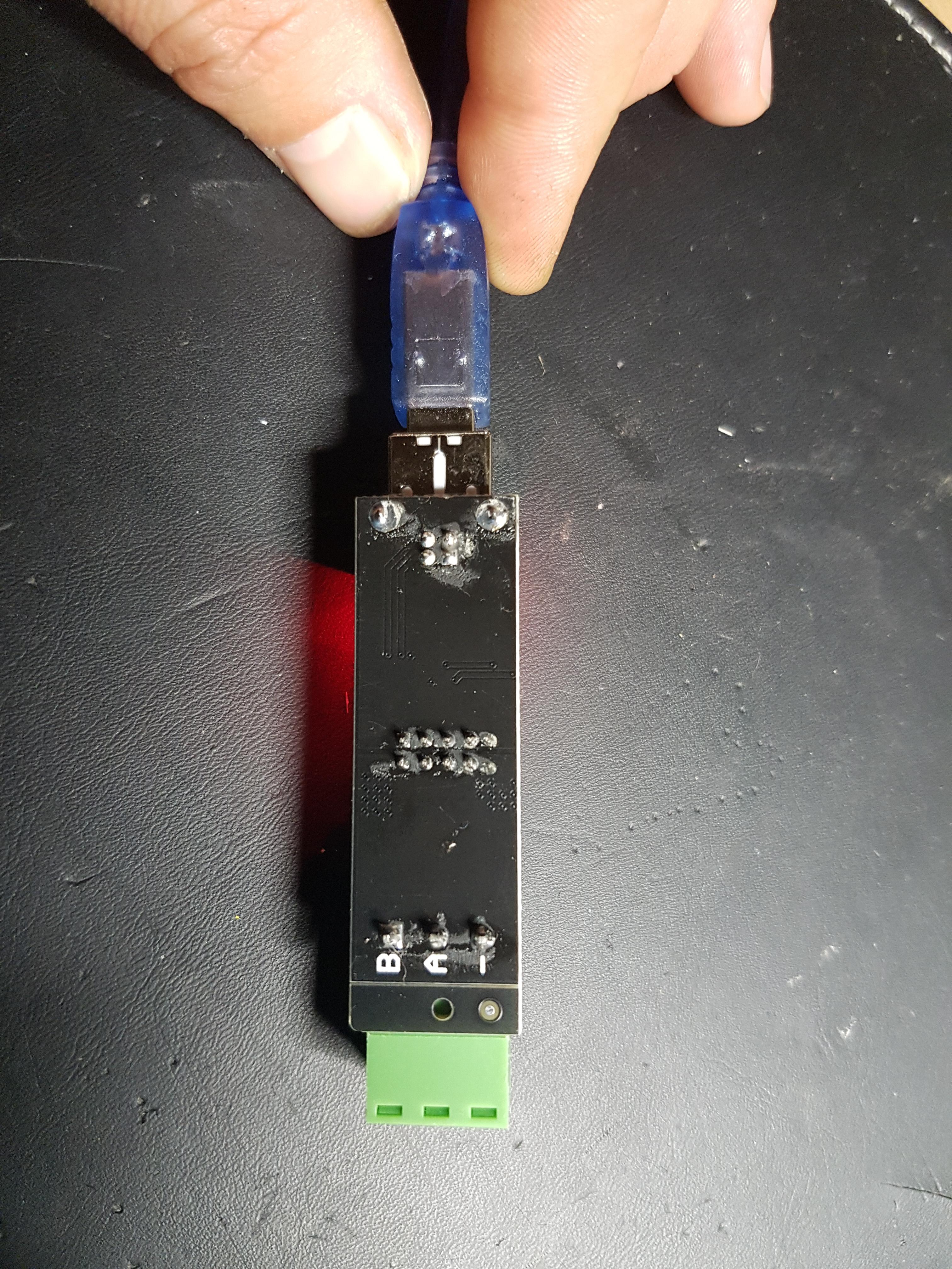

    Colleagues, I have EcoNet original + usb to RS485 converter.
    I don't have D + and D- on the converter but A, B and -. What to connect to?
    In the boiler controller, RJ11 socket, which, according to the plum instructions, must be used through a splitter to connect the ecolink via rj11.
    However, I can also see free connectors for the post-defeat thermostat on the controller and one more on the "power supply".
    Can I just plug the converter into any free D + and D-?
    Regards.
    • Internet module ecoNet 300 and ecoLINK2 20211007_213919.jpg (936.7 KB) You must be logged in to download this attachment.
    • Internet module ecoNet 300 and ecoLINK2 20211007_213841.jpg (1.07 MB) You must be logged in to download this attachment.
    • Internet module ecoNet 300 and ecoLINK2 20211007_214122.jpg (1.73 MB) You must be logged in to download this attachment.
  • #278 19645484
    SławekSS
    Posts: 726
    Help: 34
    Rate: 80
    D + = B
    D- = A
    - = GND, we don't use

    I connected, the diode on the converter is blinking, so there is some communication. However, the econet communication light with the controller does not light up, and the boiler controller does not see anything new in its menu. You probably need to make a cable for RJ11 as instructed by the user manual.
  • #280 19645593
    SławekSS
    Posts: 726
    Help: 34
    Rate: 80
    There are probably two RS485 buses. One for B, C, probe type accessories and the other for connecting the panel with A module and econet
  • #281 19645685
    Starterek85
    Posts: 565
    Help: 19
    Rate: 58
    After plugging in the RJ11 it works, that is, there is a connection to the server. However, after logging in to the econet, I get a message that the Internet module does not work with the device of this manufacturer. Please contact the manufacturer to purchase the correct version of the Internet module ...

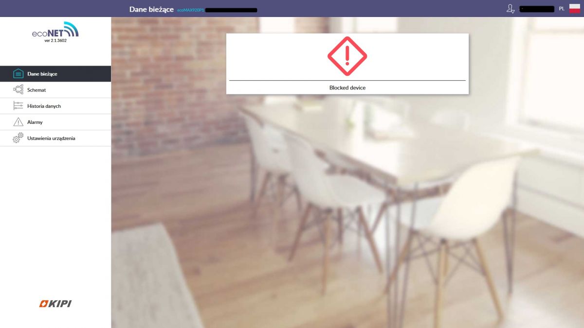

    I bought a second original econet2 (with the plum logo) It connects to the server, but it does not connect to the boiler controller.
    I do not know if econet2 is damaged or if this econet2 will not connect to the controller.

    Some boiler manufacturers have software designed for themselves, the so-called customization.
    For example, Kostrzewa, Kipi, Witkowski, etc. Only econets, purchased from these producers, will work with these boilers, the original pluma will not work.
    What is the boiler (manufacturer)?
  • #284 19657219
    Starterek85
    Posts: 565
    Help: 19
    Rate: 58
    SławekSS, you are absolutely right.
    I called the site. There is a "customization" service, it costs 180 PLN net.
    I can extract a skirting machine from the original fescue for "educational" purposes

  • #286 19663174
    chorchejs
    Hi,
    I have only one trivial question. Is the ecoLINK2 cable the same as any USB to RS485 converter (like any cheap from China). I need it for firmware upgrade in my regulator ecoMAX 860 D1 on Viadrus P7C with ecoUPDATER program from Plum.
    Thanks for your answer
  • #287 19663224
    Starterek85
    Posts: 565
    Help: 19
    Rate: 58
    Yes,RS485 to usb converter,but only with ftdi chip's.
  • #288 19663278
    chorchejs
    Sorry for another stupid question, but I'm a total electronic layman. FTDI chip's is what? I need the ecoLINK2 cable to try for a firmware upgrade in my malfunctioning regulator (not booting successfully, stop progress bar before reaching the end) and Plum says to me it may help. Can the upgrade with ecoUPDATER be possible with this? Thanks Internet module ecoNet 300 and ecoLINK2
  • #289 19663291
    SławekSS
    Posts: 726
    Help: 34
    Rate: 80
    This converter from the photo is on the CH340 chip. Econet has no drivers for it. Ecolink2 is based on the FTDI chip (https://ftdichip.com/) and only works properly with this.
    I don't know about EcoUpdater, but first you need to upload the correct drivers to the computer.
    In general, look for a converter based on a FTDI chip.
    https://ftdichip.com/product-category/products/cables/usb-rs485-cable-series/

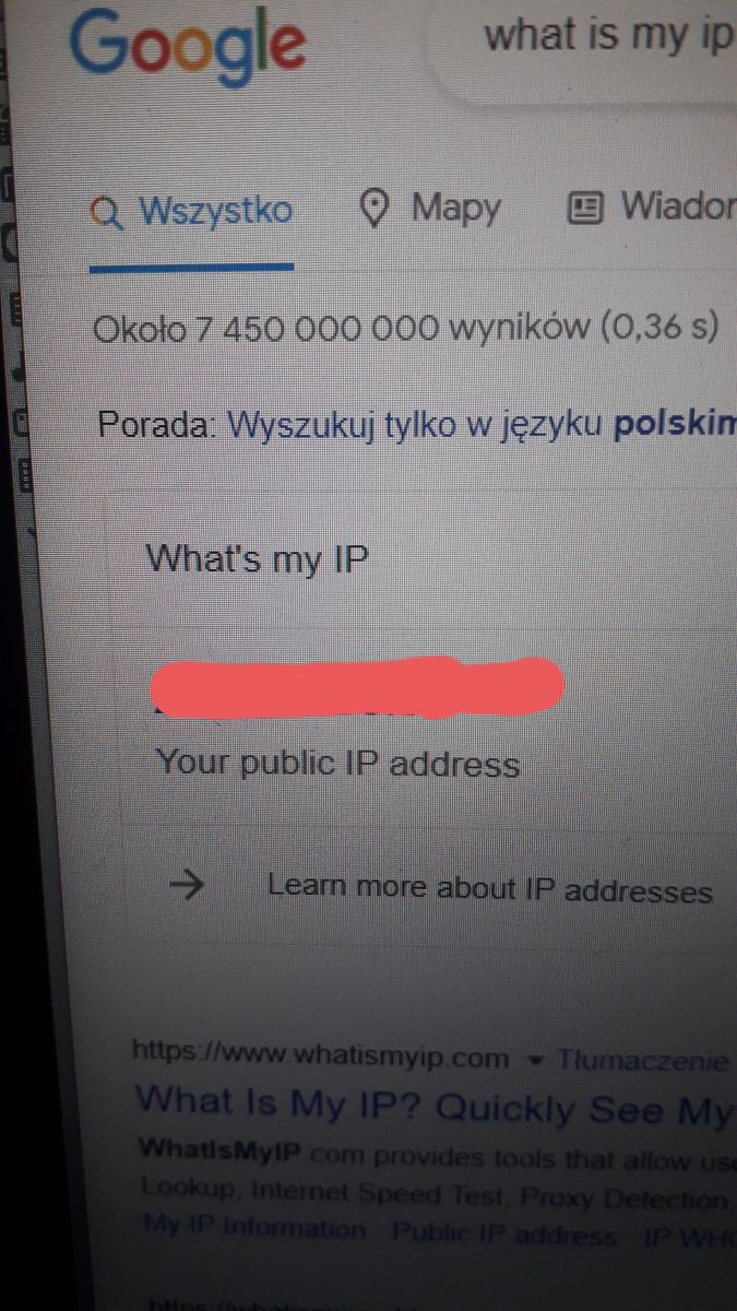

    How can I execute a command from outside the local network?
    "http://admin:admin@192.168.1.100/econet/regParams"
    I set up "port forwarding" on the router and using external ip I cannot read the settings. Seems like you need to know the port number for forwarding and I've tried various known ones.

  • #292 19707099
    martintro
    Posts: 37
    Unfortunately it doesn't work. I have tried the ports you suggest before. However, I checked again and it still doesn't work.
    "Unfortunately ... this page cannot be accessed. The site ...... externalIP ...... took too long to reply"
    What else could I have forgotten? Everything works locally. I'm working on an app and I'm stuck on an external connection.

    Is your external address public or private?
  • #294 19707634
    martintro
    Posts: 37
    The address is public to my knowledge. I check it with the "What is my IP" method by typing in the browser. This address matches and is the same on a few other devices. However, this does not match the router's assigned IP address. The router comes with a modem and a Virgin Mobile SIM card.

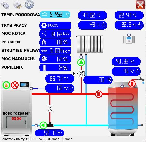

    Gentlemen, whether after connecting RS485 and setting the connection in HomeAsisstancie via the script:
    https://github.com/twkrol/econetanalyze
    Anything else you need to configure?
    Will everything appear in Entities or integrations?

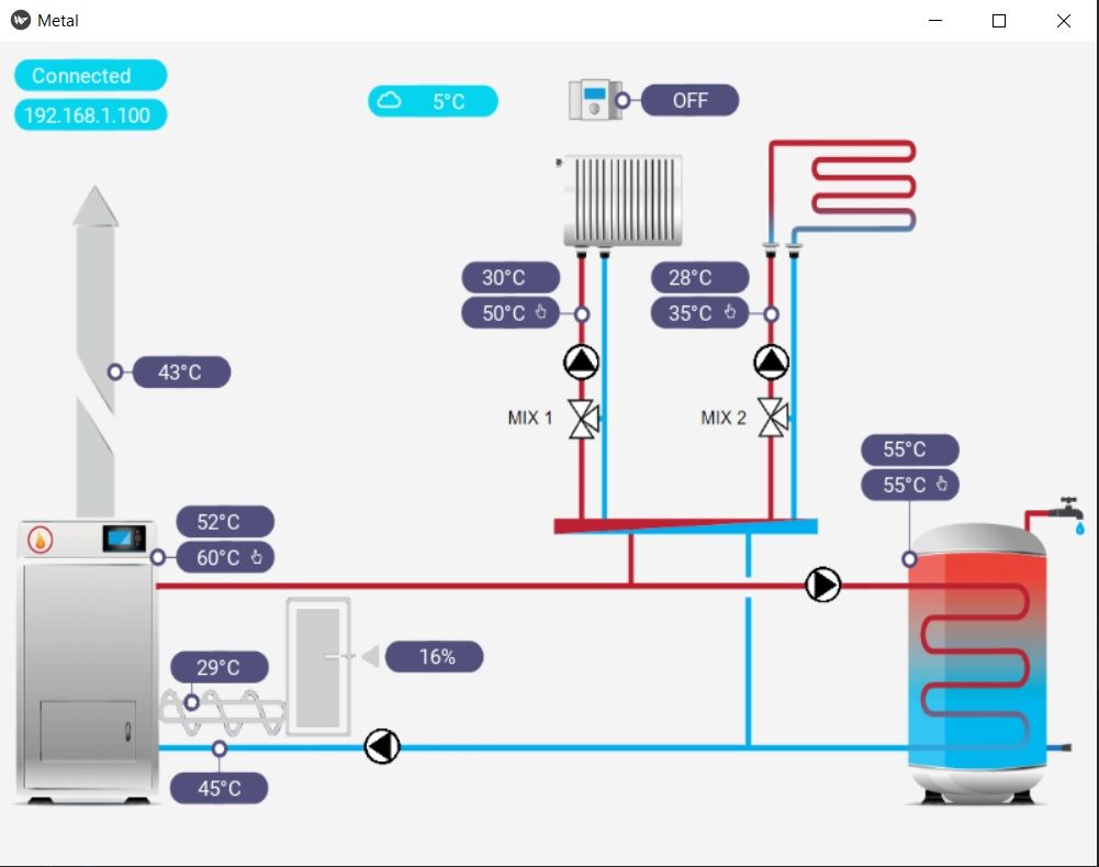

  • #299 19726615
    tusiek5
    Posts: 13
    For interested users of Kostrzewy stoves, I can provide a program for reading and changing the parameters of the furnace. You do not need to have EcoNet or its "replacement", the only condition is a computer with Linux or, in my case, a Raspberry with Rasbian, which acts as an intermediary device in communication with the stove and is a gateway for external connection and an RS485 / USB converter. The connection is made via VNC.
  • #300 19732170
    kajapa
    Posts: 28
    Rate: 10

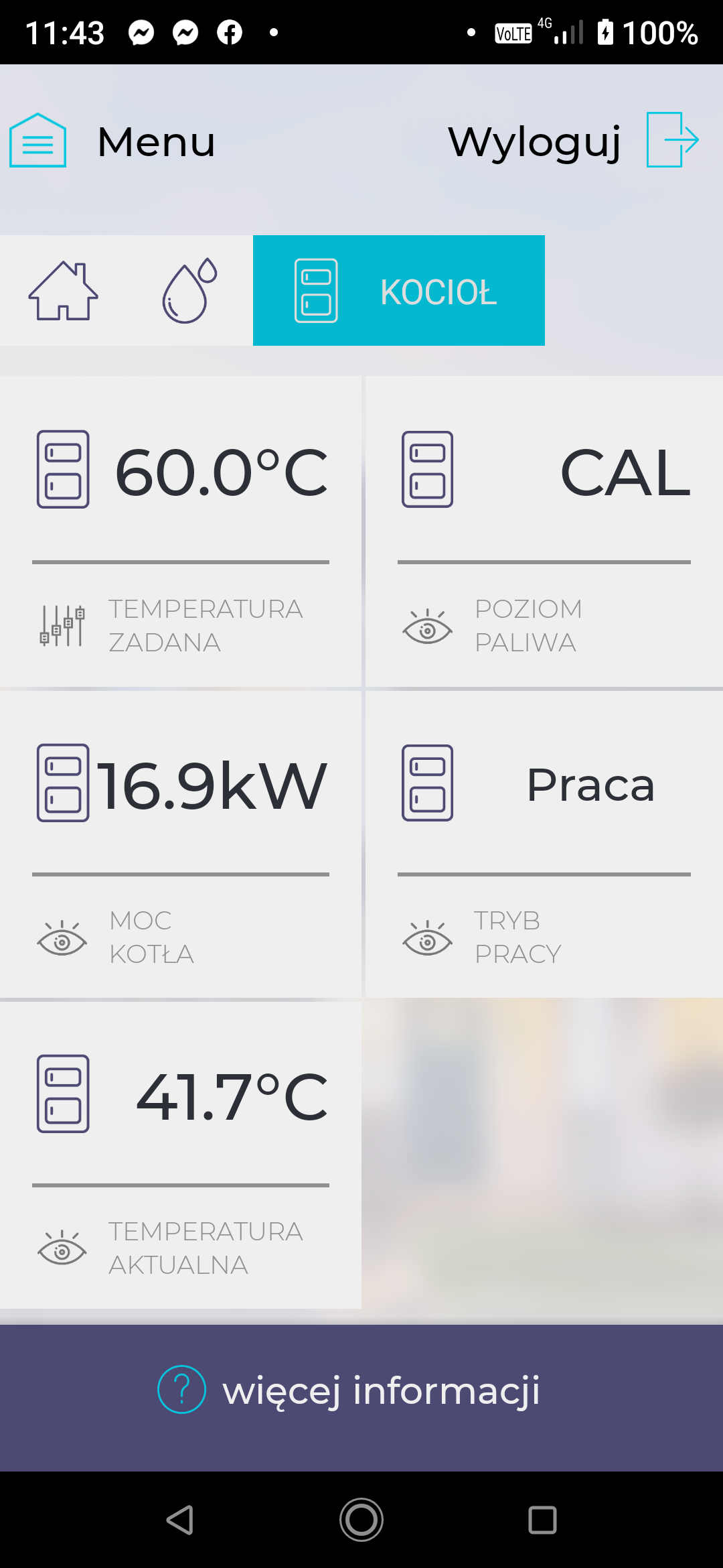

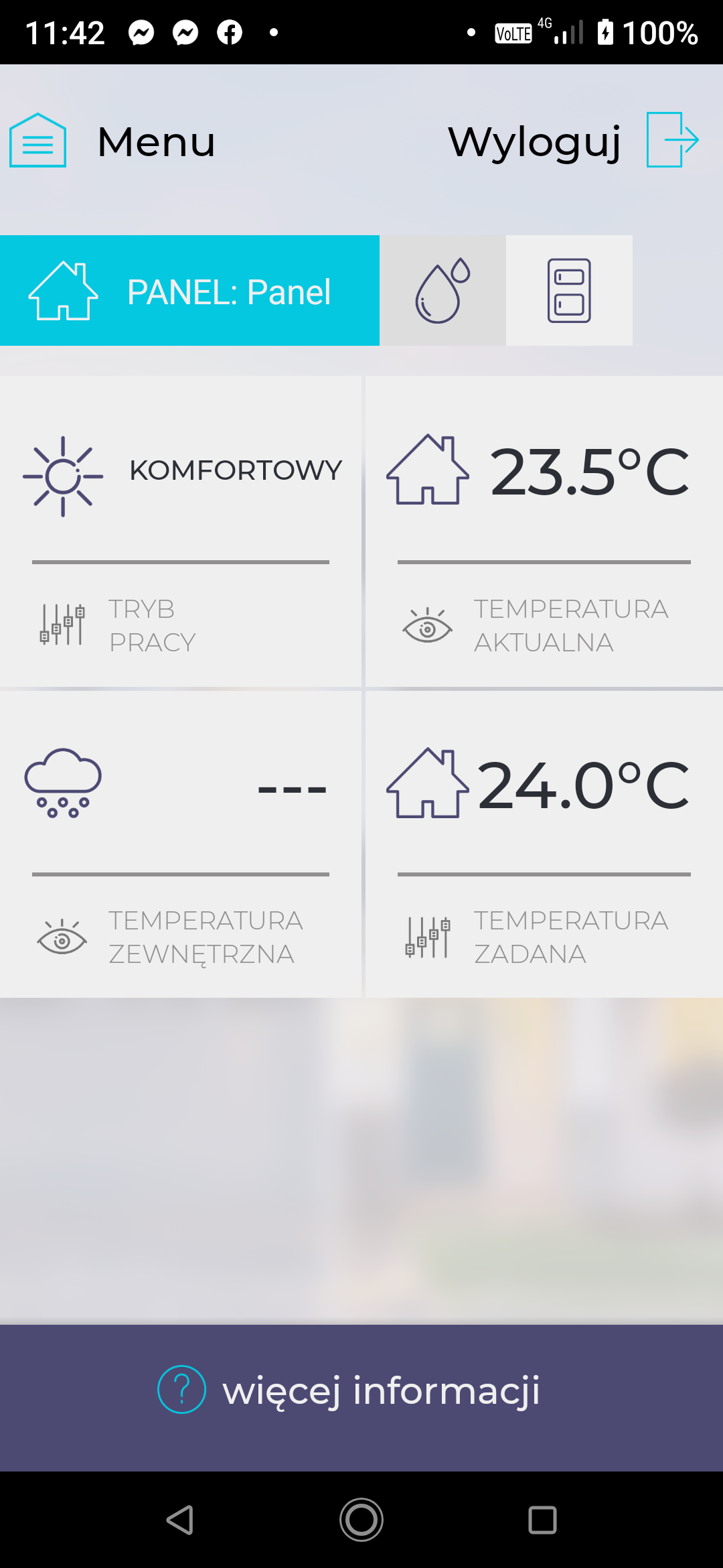

    In the end, I was able to complete the necessary things and connect the stove to the internet.
    -MR3020 v3.2 (stimulant) bought on all..ro locally, as it turned out from a friend from this topic, who was one of the pioneers
    -EcoLink (USB-> RS485 converter) bought on alie ... es for PLN 20 RJ telephone cable
    On the tp link I put "LEDE 19 with GUI" and then "eco-mr3020-v3-3.2.3678-em-fda69db834b649919bfeeecd8d955327.bin". The clone started up and connected to the router, first with a cable and then via the www via wifi. I connected it to the furnace controller and it generated a UID, thanks to which it was possible to register on econet24.
    The android app works as normal, but it's truncated and only has a preview some basic settings
    Internet module ecoNet 300 and ecoLINK2 Internet module ecoNet 300 and ecoLINK2
    and on econet24 I have the message "Blocked device"
    I do not know if I did the right thing to upload soft from @kashue and not "root_eco.bin" from @przemo_ns. And the second thing is that I updated the econet (mr3020) after connecting to the network when I popped up with information about the availability of a newer version.
    Maybe I should upload a dedicated soft for it? I don't know, any suggestions?
    Anyway, weird, the econet app works and the website is blocking.
    Thanks a lot to @ SławekSS for help.

How do I wire a USB-RS485 converter to the ecoMAX controller?
Match RS-485 A→D- and B→D+, leave GND unconnected. Most converters label A/B opposite to D+/D-, so connect A→D- and B→D+ [Elektroda, SławekSS, post #19645484]
Which USB-RS485 adapters work?
Only converters using an FT232/FT2232 FTDI chip enumerate as /dev/ttyUSB0 on ecoNET firmware; CH340 or Prolific devices are ignored [Elektroda, SławekSS, post #18292233]
Why does my clone show “device blocked” on econet24.com?
Plum’s server whitelists factory MAC ranges and brand keys. Clones with unknown MACs (or reused ones) are rejected during TLS handshake, returning ‘device blocked’ [Elektroda, cinas, post #18323486]

Quick 3-step test to verify bus health?
  1. Connect FTDI RS-485 A/B.
  2. Open serial 115 200 8N1; look for ‘TIME’ packets every second.
  3. Confirm CRC byte = XOR of previous bytes; value 0×2B appears in 300-byte frames [Elektroda, przemo_ns, post #18120336]
