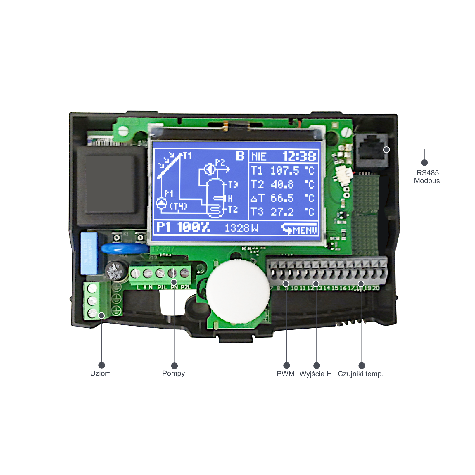

    I have an ecoSOL 301 controller and I would like to integrate it with HomeAssistant without using ecoLink and ecoNET.
    I would like to obtain data in a slightly different way, namely to connect in parallel to the CT6W (PT1000) temperature sensors using the MAX31865 module connected to the ESP8266 with the tasmota software loaded. I just wonder if this can be done, will I not damage my controller in this way, will the sensor not be distorted by such a connection?
  • #309 19781648
    webster21
    Posts: 17
    You can damage not only the controller but also the sensors themselves. And you can't make the correct driver based on esp8266? Additional sensors attached to the original ones. (the disadvantage is that you only have reading) the second way, as in trmacie, connect to the rs485 driver and read data. As the one you mentioned, it has a contribution to the econet and it has a contribution to rs485.
  • #310 19781751
    smirgol
    Posts: 165
    Rate: 10
    I can make my own controller without any problems and read the temperature even at 18B20, but the problem is the sensor on the collectors on the roof, where there is no place to mount a second sensor in the sleeve.
    The driver has rj with rs485 but from what I read it does not constantly send data and you need to connect a second module or send queries from the terminal.
    SławekSS wrote:
    EcoSol is one module and to catch the transmission you need to connect a second module, eg Econet300.
    Otherwise, you must send your queries from the terminal. What you catch is asking the driver if there is something connected to the line (or reporting presence and waiting for request).
    I'm not sure how to do this. I care about reading the temperatures T1, T2, T3, delta T, switching on the P1 and P2 pumps, the percentage of P1 pump operation. I would be grateful for any advice.
    This is what the driver looks like:

    You have to track on this RS485 connector which pins are used for transmission, connect there with some rs485 / usb converter and download the transmission with some terminal program. It is ekosol that will poll the buses, you can wave a program that will pretend to be econet. You just need to check if there are the same questions as with ecomax.

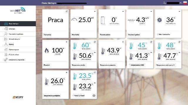

    Addresses You need to know
    http: // admin: admin @ local_ecoNet300_IP / econet / rmCurrentDataParams (parameter IDs and Names)
    http: // admin: admin @ local_ecoNet300_IP / econet / regParams (this You know, actual readings)
    To change via internet (now I changed the set point for burner)
    https://www.econet24.com/service/rmCurrNewPar...ITS&newParamKey=1280&newParamValue=66
    To do it locally You don't need to put ECONET_ID
    http: // admin: admin @ EcoNet300_IP / econet / rmCurrNewParam? newParamKey = 1280 & newParamValue = 66
    I hope it helped You.

Can I still monitor the boiler locally when the cloud is blocked?
Yes. Point a browser to http:///econet/regParams. The JSON payload exposes live temperatures, power, pump states and over 300 variables without cloud access [Elektroda, maki26, post #19044244]
How do I change a parameter via HTTP?
Send: http:///econet/newParam?newParamName=CWU_SET_TEMP&newParamValue=44 . The module replies {result:"OK"}. Use rmCurrNewParam?newParamKey=1280&newParamValue=60 for indexed values [Elektroda, OlexandrRom, post #19607120]
The reply says OK but nothing changes—what’s wrong?
EditableParamsVer must be >0. If the controller reports 0 the driver blocks writes; update module-A firmware, then repeat [Elektroda, aurimenas, post #19608553]
