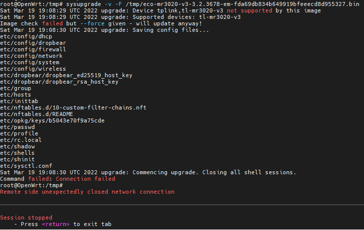

    #345 19940647
    dido83
    Posts: 9
    I need help / guidance ...
    I have TL-mr3020 v3.20 - I'm uploading bin to it (via TFTP because gui crashes an error - but I've already found somewhere that
    v3 only via TFTP goes) which could be found on the Openwrt website:
    https://downloads.openwrt.org/snapshots/targe...plink_tl-mr3020-v3-squashfs-tftp-recovery.bin
    after uploading I have access to the router only via ssh but after trying to upload econet bin from the command line, I trace all connectivity to the router.
    Here, as I understand it, I use openwrt for the new one and that's probably why it's falling apart ...
    I am loading recovery via TFTP and the router is alive ..
    1) Could someone give the path to version 18.x for mr3020 v3.20
    2) After uploading eco bin, how should this switch 3g / 4g - WISP - AP be set?
    3) Which pins on ecosol 301 are used for transmission ..
    Thanks a lot for your help ....

    #347 19940709
    dido83
    Posts: 9
    SławekSS wrote:
    and from this link I upload the file via tftp:
    tplink_tl-mr3020-v3-squashfs-tftp-recovery.bin
    none of the three available through the original tplink GUI failed and crashed:
    The uploaded file was not accepted.
    After uploading, I am at this stage that I upload the binary from this thread via ssh eco-mr3020-v3-3.2.3678-em-fda69db834b649919bfeeecd8d955327.bin
    I am doing:
    sysupgrade -v -f /tmp/eco-mr3020-v3-3.2.3678-em-fda69db834b649919bfeeecd8d955327.bin
    but this causes the router to stop assigning addresses from dhcp, rigidly as I set the address from the 192.168.1.x or 192.168.0.x network on the card, I do not find the router's address ...
  • OpenWrt can be flashed via tftp and GUI update
    #348 19940808
    SławekSS
    Posts: 726
    Help: 34
    Rate: 80
    Through the original GUI you will not play any openwrt.
    You can upload Openwrt with GUI via tftp.
    After uploading openwrt from its GUI, select the update and point to the .bin file with the econeta soft.
    Openwrt will tell you that the wrong file, etc. etc., and whether you really want to upload. You take it and you confirm. Soft econeta is playing.
    You reboot and you have an econet.
    The switch does not work, the router does not allocate addresses because it is no longer a router. Mr3020 takes an IP address that is assigned to it by another router.
    LEDs y have a different function than the factory setting.

    #349 19940996
    dido83
    Posts: 9
    And here is the problem because after uploading I don't have GUI, I only have ssh access.
    A similar situation to someone here with version v3.20: https://forum.openwrt.org/t/tl-mr3020-after-i...ling-openwrt-no-access-to-the-interface/48505
    soft econet after uploading via ssh, reboots and unfortunately does not assign itself any IP from the router.
    Screenshot of the software upgrade process on an OpenWRT router.

    #351 19941080
    dido83
    Posts: 9
    I made a fatal mistake :shocked!: I don't know how I didn't notice it. I uploaded the wrong econet ... I downloaded the binary from my friend's post @kashue Only after I verified what is in the post # 96, I noticed the differences.
    After uploading, the econet rises ... now only connecting to ecosol and we will see if it will work ...
    Thank you for helping everyone ...
    @SławekSS this is the same binary as previously downloaded ... on my version MR3020 v3.20 gui did not want to work .. but flashing via ssh goes flawlessly ....

  • MR3020 v1 compatibility question for ecoNet software
    #359 20091427
    popek9
    Posts: 104
    Rate: 26
    Hi everyone,
    I have been following this topic for some time, I have already completed everything and yesterday I was supposed to start uploading openwrt to the mr3020 router. However, I logged on to it and found out that I had bought the V1 version. Unfortunately, I have nowhere found any information whether this version is compatible with the econet software.
    Could someone tell me if this router will work? If not, I will return and look for the V3 version.
    Thanks in advance for your help :)
  • v1 router incompatible due to different processor and memory
    #360 20091611
    ufogufo13
    I made the same mistake. It will not run on v1. There is a different processor and less memory.
    I abandoned the search for v3 and, having dismantled the system image, I took the necessary files out of it and added the missing packages to the raspberry. The same effect, only no connection to the econet24 system.
    Regards
