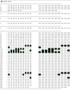

  • #366 20183709
    Hedva
    Posts: 6
    after lifting the cover of the BLAZE boiler, a frame with the address 0xE1 with a size of 660 bytes appears on rs485. Does anyone have a map please?

    Thank you
    Added after 3 [minutes]:
    in the frame 0x08 I also cannot find the status byte where the information is: 0: 'OFF', 1: 'IGNITION', 2: 'STABILIZATION', 3: 'OPERATION', 4: 'SUPERVISION', 5: 'BURNING OFF', 6 : 'STANDBY', 7: 'BURNING OFF ON DEMAND', 9: 'ALARM', 10: 'RELEASE'
    or the like

    What transmission parameters do you have set?
    This log does not appear to be valid, see post # 39 in this thread.

    Hedva
    Posts: 6
    Yes. The main difference is that I do not communicate with the ecoNET or ecoSTER module, but only directly with the boiler, the boiler frame starts at 0x08.
    These black memory blocks are already identified numbers from the boiler

    As far as my memory is correct, the internal bus is the same protocol but with a different speed. You do not see 0x16 - the end of the previous frame before 0x68, are you using the pluma driver?

    Posts: 6
    This is PLUM. 0x16 is the final byte, it is included in the data record, but I don't display it anymore on the console output.

    Posts: 72
    Help: 6
    Rate: 23
    Nobody is a fortune teller here, you should attach the entire log. What do you understand under "The main difference is that I do not communicate with the ecoNET or ecoSTER module" are you connected to the internal bus? I do not know if anyone was playing with the analysis of internal communication, I used to only look for packages regarding the lambda probe.
    It's best to upload a photo where you are connected.

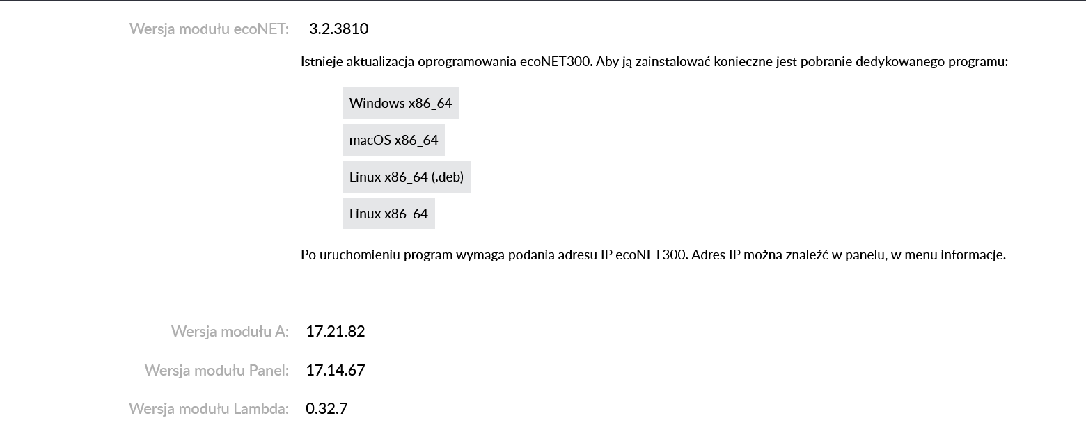

    Hello, yesterday I noticed on the 4pellet.pl website after logging in that an update for the econet module is available. Oddly enough, the update is done with a special application that lifts the soft to the latest and not as before by the website. Maybe it will be useful for those who struggle with uploading the software to a non-dedicated ecolink. In the attachment I am sending the app that updated my fescue ecolink to the latest version. After launching, just enter the local address that has been assigned to ecolink.
    • econet300-updater-windows.exe (7.1 MB) You must be logged in to download this attachment.
  • #383 20213277
    SławekSS
    Posts: 726
    Help: 34
    Rate: 80
    This application is available after logging into econeta24 in the "Device settings" tab, for those who already have a connection to econeta24.
    I did not use it because: 1.the update probably does not give anything, 2. he knows what this update is doing in addition to the update :)
