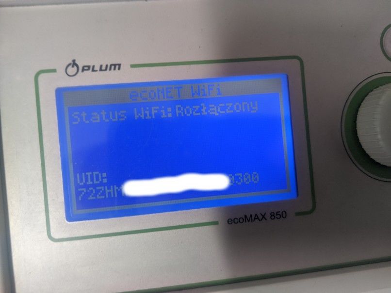

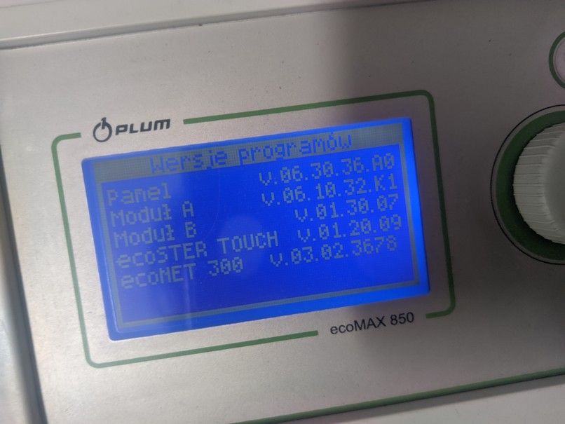

    Colleagues, I have such a problem with my MR3020 v3.2.
    I put OpenWRT on it (openwrt-22.03.2-ramips-mt76x8-tplink_tl-mr3020-v3-squashfs-tftp-recovery.bin) after which the router got up normally and then I uploaded OpenWRT by update (eco-mr3020-v3-3.2 .3678-em-fda69db834b649919bfeeecd8d955327.bin) but here as if the update hung up because I waited for 30 minutes and nothing changed. I have reset it with power and once plugged in I can't connect to it via LAN.
    I would like to add that the controller connected to the stove in this state sees it as econet300, shows the software version, but cannot connect to the network, entering the wifi name and password has no effect. After reset SSID keeps going back to OpenWRT....
    The controller also spit out the UID, but when trying to register, the message "No regulator in service. Make sure that ecoNET300 signals connection to the regulator and to the server."
    WiFi status: disconnected
    underneath UIDxxxxxxxxxxxxxxxxxxxxxxxxxxxx

    So you uploaded econet. You have a problem with your WiFi network. Try to connect ethernet

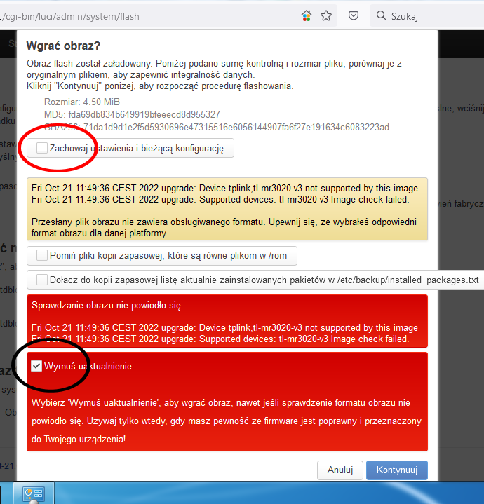

    Mad Jaro
    Posts: 424
    Rate: 15
    Okay, so this one (luci-19.07-snapshot-r10731-e68d589e7b-ramips-mt76x8-tplink_tl-mr3020-v3-squashfs-sysupgrade (2020_12_07 09_40_45 UTC).bin) uwala MR'a continuous boot.
    I uploaded (luci-21.02-snapshot-r16692-9cec59ca38-ramips-mt76x8-tplink_tl-mr3020-v3-squashfs-tftp-recovery.bin)
    and there is a web interface.
    I went into the updates, selected the econet file, shouted that I missed the incompatible firmware and it went. I'll go check the boiler later to see if it's working. Because now only one LED is on and I don't get any IP to log in to it. which is how it was before.
    But I have now marked some clean install without keeping the current settings.
    EDIT. The village went ok, connected, registered. So you had to do a clean install, because before that there was probably some garbage from OpenWrt.
    I leave the checked version.
