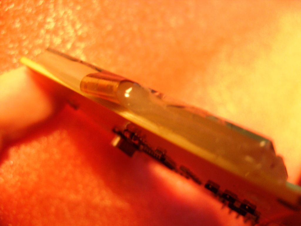

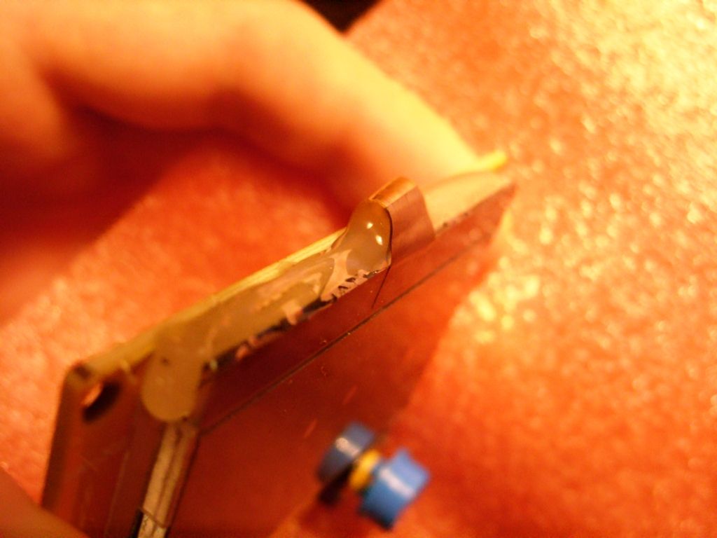

  • #642 20843016
    zasilaczen
    Posts: 444
    Rate: 72
    It is worth filling the empty space between the screen and the PCB with glue or silicone.
    This will help you avoid problems with the screen falling out and the ribbon breaking.
    Close-up of the gap between the screen and PCB filled with adhesive. Close-up of a PCB edge with applied glue or silicone.
