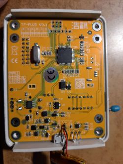

    Gentlemen, I think I fell T4 today :( . For example, I put a resistor, turn on the tester and "Testing ....", no results. I connected the oscilloscope to pins 1,2,3 (5s / div) and the first pulses from pressing the button are sent after 20 seconds (!) And then after another 30 seconds it turns off. After switching on, the 3rd pin is 1V and after sending the pulses it is still high until it switches itself off. The screenshots will show it better:
    LCR-T4 electronics components tester ATMega328 - Test and ReviewT4-prob...jpg (154.59 kB)You must be logged in to download this attachment.
    Of course, it was possible to detect NPN once, but it took several dozen seconds, resistors were not detected. What's happening? He died? Can you revive it or look for another one on Ali?

    Hey, it can be saved - Atmega328 is there so probably soft or scalak fell. You can download the batch to T4 and use the programmer to upload and see if something changes, if not, replace the processor with a new one and upload the soft - it should start.
    More on how to upload a software and a Polish version in this link.
    https://www.elektroda.pl/rtvforum/topic3372311.html

    Do not throw it away, you can not do everything right away - my friend I remember you used to help me because the nickname is familiar, so I will tell you.
    You can and the easiest way to buy a USB ASP programmer on Allegro or Ali or in any electronics store by typing USB ASP. When buying, you will get a KANDA 10pin cable + programmer as below
    https://www.ledats.pl/4764-thickbox_default/usb-asp-programator-tasma-idc.jpg
    For this you can buy a 6pin adapter because the tester has a 6pin connector
    https://abc-rc.pl/data/gfx/pictures/large/7/0/6207_1.jpg?33485
    But you can also use the cables for the contact plate and choose the ones you need to program the tester yourself, here are the pins you can't go wrong
    https://1.bp.blogspot.com/-RIw6-jo6I88/T-L4mk...I/AAAAAAAAAsk/HfLAdnZt8JI/s1600/ISP_KANDA.jpg
    in the tester, the pins go like this
    https://obrazki.elektroda.pl/1219969400_1503516373.jpg
    Just connect with each other and now you can use the MKAVR Calculator (paid version - from what I remember ATMEGA8 is in demo version and Atmega328 is in version after buying a license) but you can use AVRDudess which is free (correct me if I am wrong)
    And now, after connecting, you can use the detekt option to make the program try to detect the prock, if it happens, you need to set the fuse bits and specify the files
    Here are the files
    https://www.elektroda.pl/rtvforum/topic3372311.html#16675880
    The version of the tester with a blue button also says so in the post
    You can also write yes on the command line (console)
    avrdude -c USBasp -P usb -p m328p -U flash: w: TransistorTester.hex \ -U eeprom: w: TransistorTester.eep \ -U lfuse: w: 0xf7: m \ -U hfuse: w: 0xd9: m \ -U efuse: w: 0xfc: m
    Where you need to go to the directory where the AVRDude program is under dosem and run it with the above-mentioned command and have hex and eep files named as in the above line and set fuse bits like this
    L - F7
    H - D9
    E - FC
    Information found on the network, so you have to figure it out - the most important thing for the programmer to work - under the computer - drivers must be installed.
    As for the programmer with Arduino, I know that it is possible, but I have never played it - I made a programmer and also bought a second one, just like the photo I gave.
    Don't give up, take action.
    If a colleague lived nearby, he could personally give me a tester, we would upload the software or replace the prock and upload the software.
    Oh, when programming, the tester should be powered.
    Greetings ...

    Unfortunately, most likely the slinger failed. I bought a programmer, cables, uploaded the original soft and the same - nothing measures, the test does not pass. I bought a new 328P and will try to replace it on Friday.
    Oh, the soft from "Electrode" can be uploaded, but the screen is blank and nothing is displayed. Only works with the original (blue button version).
