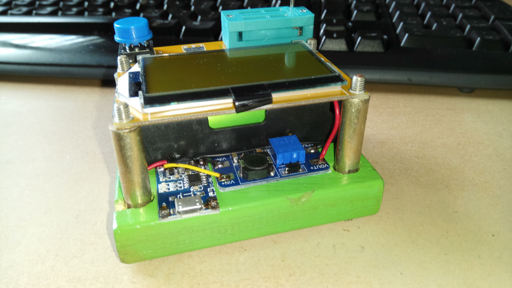

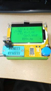

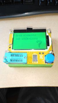

    LCR-T4 electronics components tester ATMega328 - Test and Review I have this tester for 2 weeks. It is with housing - measurement of frequency - frequency generator - checking of IR remote controls - temperature and humidity measurement - the rest was mentioned.Cena-65.72PLN-DIY version. I've seen here comparison of indications with the meter for 2500PLN. As for me amateur is great. it takes a couple of hours for me - 4 hours. Free delivery. I recommend it to everyone.
