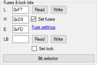

    PiotrPitucha wrote:
    And the grounds loaded?
    Yes. The last (E) for me was set - after reading it from the processor - on FD. Setting it to FC causes the T4 to not turn on at all or it turns on for a second, maybe two and goes out. FD and it works, except that it measures nothing (the LED sees for example as MOS-FET).
    LCR-T4 electronics components tester ATMega328 - Test and Reviewfuse.jpg (13.15 kB)You must be logged in to download this attachment. LCR-T4 electronics components tester ATMega328 - Test and Reviewfuseok.jpg (13.15 kB)You must be logged in to download this attachment.
    I log from programming:

    It is possible that I did not check the electrode software, so you say that you took the first steps ;) Bravo ;)
    Slingshot could fall, or actually measuring inputs from electrostatics, sometimes when you do not have the charges discharged from your hand, a spark jumps after touching the radiator - sometimes it could happen that you were holding an element and during checking, a charge could flow and damage the processor. And you have to remember about discharging the capacitors.

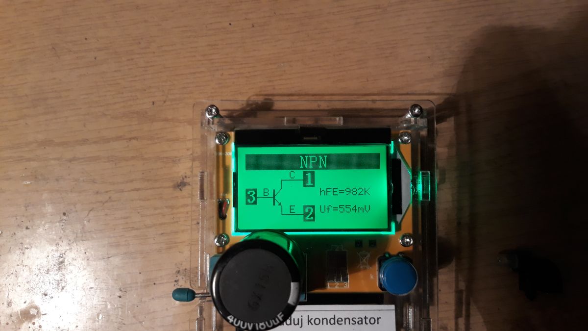

    And it went.
    There was a bit of tension because it was the first time I was dealing with this baby. There was no problem with desoldering, hot-air did its job. Then coffee (to calm your hands ;) ), flux, setting a new prock and soldering; it went without a problem. I downloaded the factory soft - and the tester started from the first inclusion. Calibrate and works as it worked :D .
    LCR-T4 electronics components tester ATMega328 - Test and Reviewpage.jpg (375.58 kB)You must be logged in to download this attachment.

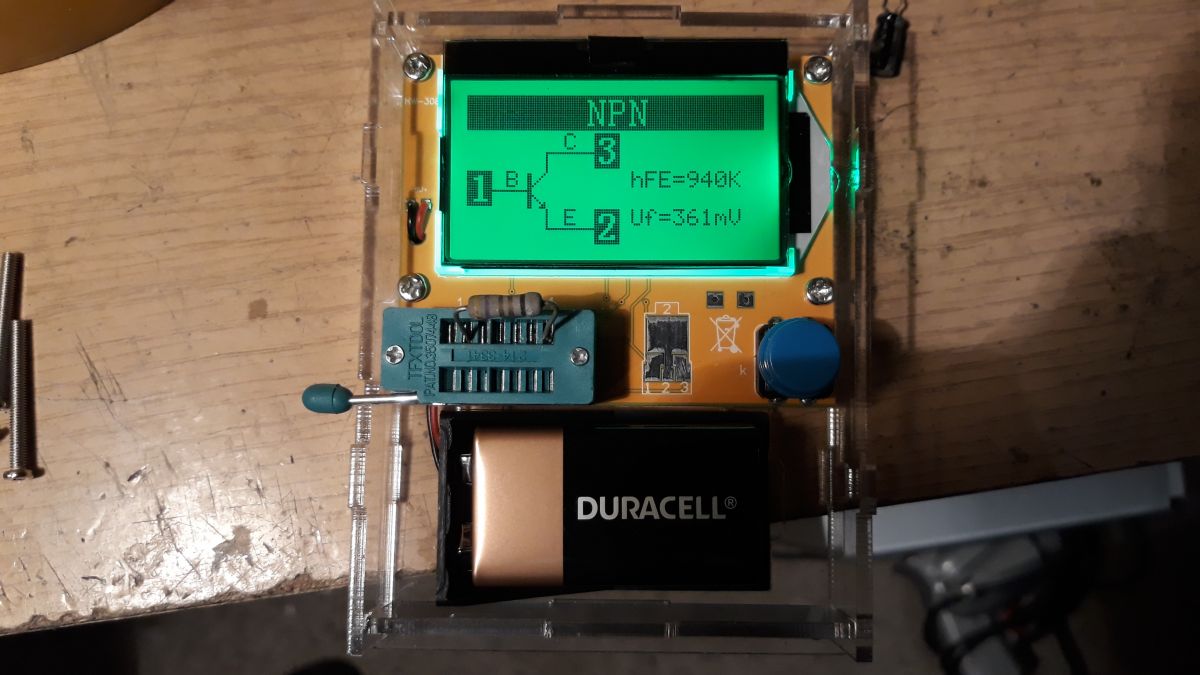

    Although I have a sticker on the housing "Discharge capacitor", I connected it without discharging and the display shows such pictures when measuring capacitors and resistors.
    LCR-T4 electronics components tester ATMega328 - Test and Review LCR-T4 electronics components tester ATMega328 - Test and Review LCR-T4 electronics components tester ATMega328 - Test and Review
    In recent posts, you write that the processor may have crashed. Unfortunately, I will not replace the processor, let alone upload the software. I only have to buy a new tester.

    Added after 1 [hours] 2 [minutes]:
    I read on the processor
    ATMEL
    MEGA328P
    U-TH
    35473D
    2007b3J
    Visually, no damage can be seen.
    I did the test without any element and it also shows interesting things.

    I tested a new purchase in the form of the LCR-TC2 tester. Everything was fine until the 22uf, 50V capacitor was inserted into the KAA sockets. Subject turned off. Thought the battery had run out. I connected to charging for an hour, but after turning it on again, this view appeared.
    • LCR-T4 electronics components tester ATMega328 - Test and Review IMG_20211229_090824.jpg (892.11 KB) You must be logged in to download this attachment.
    • LCR-T4 electronics components tester ATMega328 - Test and Review IMG_20211229_090652.jpg (908.76 KB) You must be logged in to download this attachment.
  • #621 19787717
    gumisie
    Posts: 17878
    Help: 1667
    Rate: 2480
    The capacitor was discharged?
  • #622 19787727
    zepter
    Posts: 276
    Rate: 17
    No. But before that, I checked it on sockets 1-3 and it was OK.
    • LCR-T4 electronics components tester ATMega328 - Test and Review IMG_20211228_230031.jpg (727.09 KB) You must be logged in to download this attachment.
  • #623 19787738
    Rezystor240
    Level 42  
    Posts: 9241
    Help: 689
    Rate: 1650
    zepter wrote:
    No.
    Then you have the answer. Capacitors always discharge before measurement.
  • #624 19787742
    zepter
    Posts: 276
    Rate: 17
    I know I made a mistake. But is it possible to test a discharged capacitor at KAA connectors?
    I would like to add that I tested the same capacitor on connectors 1-3 (several times) and it was OK, and when I put it into the KAA, the tester was damaged.
    Shouldn't it be damaged after inserting it into connectors 1-3 for the first time and not later in the KAA connector?
    I am asking because I would not like to damage the other one and know if it is possible to test other elements on the KAA connector.

  • #628 20417287
    hrvojezd1968
    I have two LCR T4 testers (no stripgrid) and I replaced the both ATmega328p... I tried all firmwares founded on the
    internet and always the capacitance measurement is not accurate. For example 4.7 microF shows 607nF on both pcb.
    I didn't write fuses & lock bits, only hex and eep files... I use extreme_burner_avr_v1.4.3 and avrdudeprog with usbasp.
    any idea please
    hrvoje
    edit: Lfuse: 0xF7, Hfuse: 0xD9, Efuse: 0xFC ... finally working fine :-)
  • #629 20418335
    Aress124
    Level 28  
    Posts: 1002
    Help: 152
    Rate: 212
    @hrvojezd1968 did you calibrate?
  • #630 20425161
    hrvojezd1968
    Aress124 wrote:
    @hrvojezd1968 Have you calibrated?
    this is my first contact with programming...
    without a fuse the atmega clock is 1 mhz and this is a reason for measures a
    capacity 1/8 real value. after fuse set clock is 8 mhz and everything work fine.
    hrvoje
