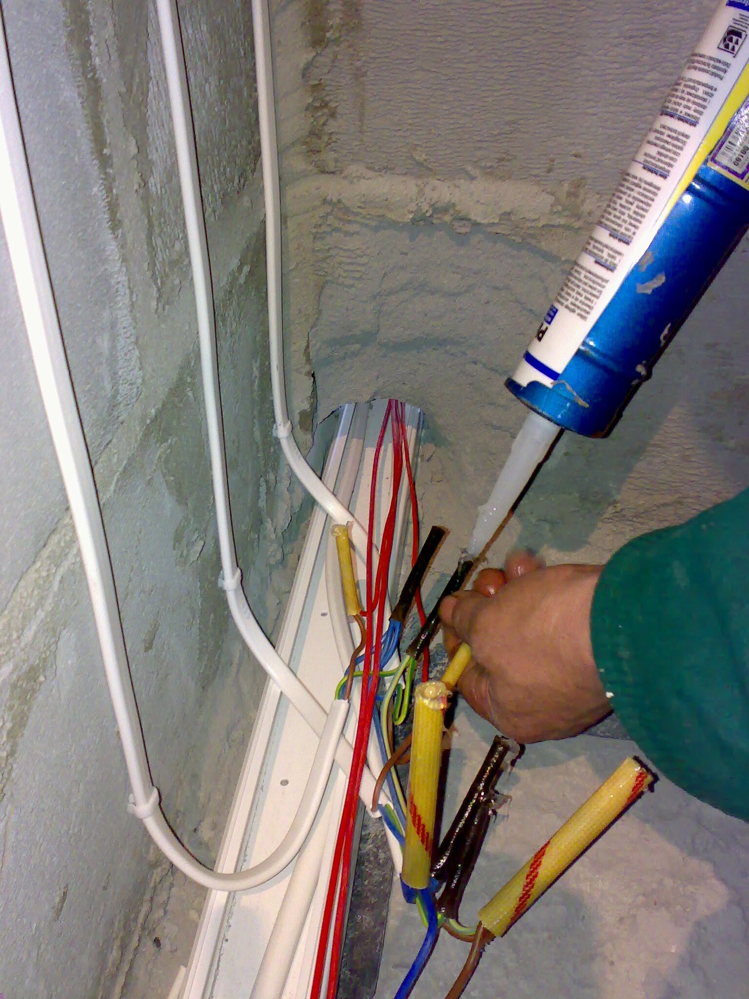

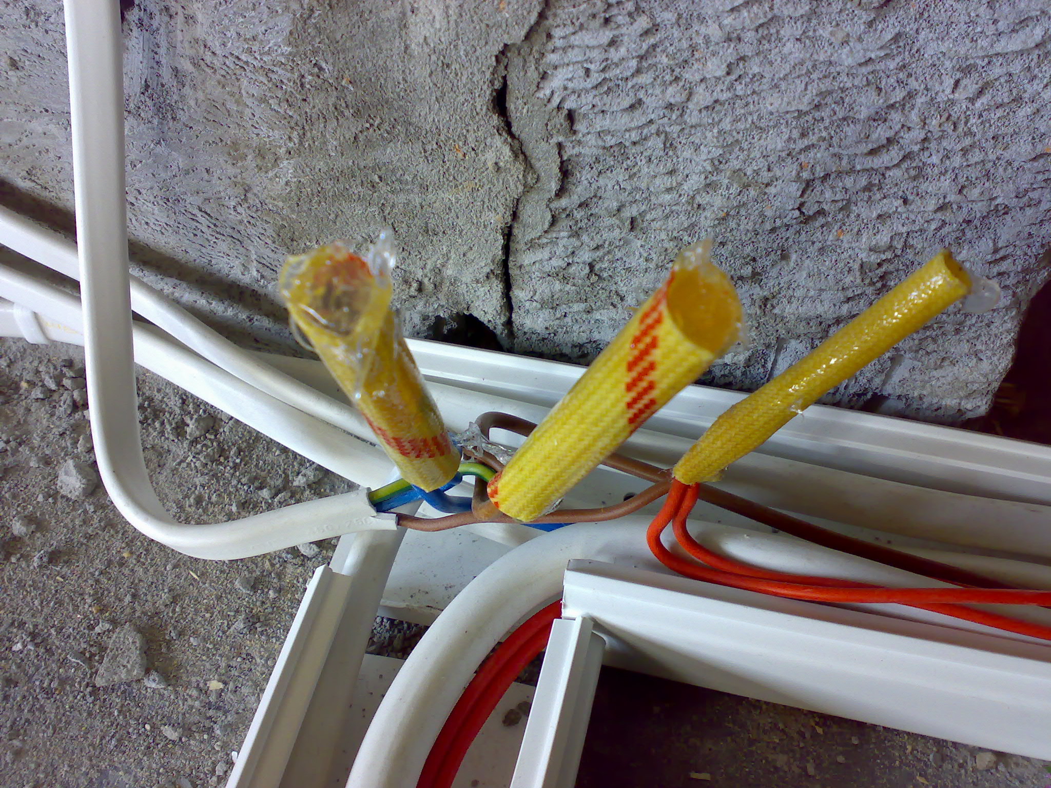

  • A damaged in-wall kitchen socket cable is repaired without installing a junction box, aiming to withstand a realistic 16 A load.
  • The repair twists the stripped conductors with two pliers, solders each joint using a gas soldering iron, cleans off flux, and insulates it with heat-shrink tubing.
  • The cable uses 2.5 mm² conductors, stripped by approximately 2 cm before twisting and soldering.
  • Adhesive-lined heat-shrink tubing restores the cable’s outer insulation after individually insulating the soldered conductors.
  • One neutral conductor was partly damaged about 3–4 mm from its end during twisting, but the repair proceeded without redoing the joint.

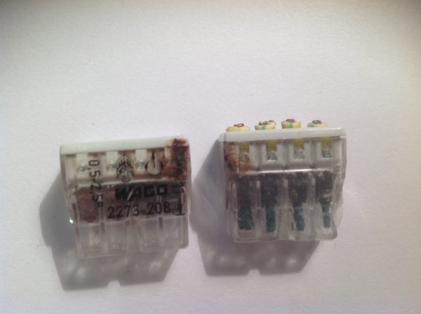

    Jarzabek666 wrote:
    Cable repair in the wall for years - that is, roast me electrode :)
    The effect of dampness, it is a pity that the manufacturer guarantees ... a lot of such connectors I personally fired in my life, for me there is nothing more reliable than a twisted pair soldered in very difficult places.
    What you presented in the photos is the PARTACT effect, not the effect of a bad connection.
    Bunnies in terms of the installation. I will not assume here whether the person who made this connection unskilfully put the wires through glands, etc. etc.
    The manufacturer of the guarantee for the operation of the couplings in a humid environment, which is indicated by the technical data sheet of the coupler that I have provided.
    "very difficult places to access." - Find the fault later :) !
    • 2273-208.pdf (194.78 KB) You must be logged in to download this attachment.

    Jawi_P wrote:
    But sculptures at once DIY constructions?
    Dude, " sculptures "???
    And it is an almost dry joint - 3M organized special courses, the completion of which allowed for connecting cables in lines in, for example, RWE.
    The most laborious and technologically complex were the oil muffs, on "leaden"
    I never trusted these connectors, I only used them in low power lighting circuits. I just do not trust a thin, resilient leaf, in a tight casing, exposed to the influence of moisture.

    polaklbn
    Posts: 594
    Help: 55
    Rate: 162
    Jarzabek666 wrote:
    polaklbn wrote:
    The manufacturer of the guarantee for the operation of the fittings in a humid environment does not provide
    Tell me if people use waco, do they measure humidity? Is it something I give, after all, in a year's time it may change dramatically because the manufacturer has special additions.
    robokop wrote:
    I only used them in low-power lighting circuits
    A year ago, I installed a bactericidal lamp from a reputable company, I got tired of its operation, everything inside had a quick-disconnect device, although not waco, but similar built-in nothing, I could give a guarantee, but time was running out, she had to work in the doctor's office. So even a 30W fluorescent lamp has outgrown these leaves.
    They may and may not do humidity measurements, but the wiring connections must be made in such a way that no moisture enters them. You know what moisture will do to the electrical tape on the "twisted pair" ?! Well, unless you cover the soldered areas with the repair coating in the cans ...

    Chris_W wrote:
    Imprecise. Moisture from the air is everywhere - sometimes it can be prevented from getting in, but it won't do any good, since it's also locked inside and waiting for it to cool down to condense on the most inappropriate places
    Well, I would say otherwise. In such an electric box there are temperature changes - related to heating the wires with flowing current and their subsequent cooling, and thus pushing and sucking fresh air into this box, with different water content - therefore the corrosion process can be moistened on an ongoing basis . In the case of Wago, it is not about the corrosiveness of the joint itself, but about a small contact surface. It is true that a colleague in the electrical department once wrote that he tested the connection with these connectors using thermovision and did not find excessive heating, but I still have a skeptical opinion about them.
    Although I will say on the other hand, in my parents' house, where most of the installations remained in aluminum, the inspection of the cans where the wires were joined on these porcelain bases with steel clamps showed that the connections looked as good as new - with no signs of corrosion of either the steel or the aluminum cores. at most a light patina.

    Personally, I am not convinced of soldering cables that can get hot. The repair done by the author seems to be very solid and will probably serve for years, although I would not do it at home. I am also against all connectors (possibly wrongly) in permanent installations. I wonder why the proposal of welding cables has not yet been made on both sides of the topic. Such a connection is practically indestructible (!) I know, because I have been at home for 10 years, and for 30 years in my father's case, the electricity is missing after the splices :) I mention this because I have already improved the "contact" installations for various electrics many times. In one friend's case, as soon as the oven turned it on, the smoke from the can flew (with time more and more). The occasional patching helped for a short time. When she found out that I could correct it, I did it my way - for 12 years without a bubble ... :)
    And what does it look like at home? Well, like below:
    Cable repair in the wall for years - that is, roast me electrode :) Cable repair in the wall for years - that is, roast me electrode :) Cable repair in the wall for years - that is, roast me electrode :)
    Twisting, welding, T-shirt, silicone ...

    Well, I haven't seen such a combination yet - congratulations for your fantasy. From today electricians have another needed gadget in their bag - a welder. ;)

    You write such crap that you don't want to read. Calculation of connection resistance, couplings, spells. The guest hit the can, twisted it, soldered and the ferment rose as in the Sejm. Twisted, insulated, it works. He thought about cutting in different places but forgot that he had x cm walls to break down.
    Welding wires in the wall ... stretcher cramps I don't believe I wouldn't have had such an idea if I was sober.

    Everything takes a second, and the welding machine is a small so-called safety transformer (that's what it used to be called) 24V. A carbon electrode on one cable, a standard clamp on the other (although a thicker piece of copper is enough to prevent the insulation from melting). The whole house flies in less than 15-20 minutes ... Great philosophy - I'm surprised you are great skeptics gentlemen electricians :)
    Back when my father was rewinding motors, it was the best and most reliable method of connecting the windings!
    The method is as old as the world, most rewinding motors have connections made this way.
    And about WAGO: As Pawlak said, "They invented these dumb machines, because they had no strength in their hands!"
