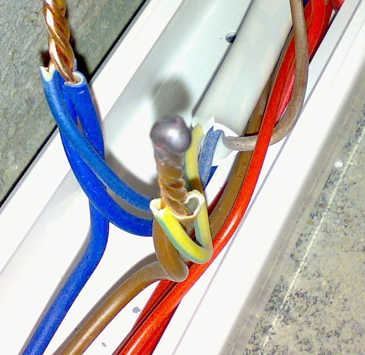

  • A damaged in-wall kitchen socket cable is repaired without installing a junction box, aiming to withstand a realistic 16 A load.
  • The repair twists the stripped conductors with two pliers, solders each joint using a gas soldering iron, cleans off flux, and insulates it with heat-shrink tubing.
  • The cable uses 2.5 mm² conductors, stripped by approximately 2 cm before twisting and soldering.
  • Adhesive-lined heat-shrink tubing restores the cable’s outer insulation after individually insulating the soldered conductors.
  • One neutral conductor was partly damaged about 3–4 mm from its end during twisting, but the repair proceeded without redoing the joint.

    Elclipse wrote:
    On the other hand, Mr. SylwkaK's post is a typical tinker industry that has nothing to do with electricity, in addition, the tone of the posts shows that you consider yourself an expert.
    "Knocking off" technology aside ...
    Let's look here:
    Cable repair in the wall for years - that is, roast me electrode :)
    Do I see correctly that the green and yellow wire is "skryped" with the brown ones?
    What the hell is this?
    Does the "specialist" in twisting, soldering and welding know that the colors of the insulation of the conductors are determined depending on the destination? The green-yellow color is the most important.
    Without going into details, I have a very unusual installation, which uses, next to an ordinary 3-core cable, a few hundred meters of a single wire, which was much cheaper than a double one, and which in my solution worked much better, because I did not have to struggle in a box ( and gutters) with a trunk of cables with a total diameter of only 5 cm and having the possibility of individual control from the fuse of virtually every assembly point (socket / switch). The fact that some connections in the gutter are "non-colored" is simply using shorter waste sections to connect the internal points in the gutter (and I have a lot of them there). Well, for the hell I have to cut 0.5 m from the entire roll as there is 0.6 m of waste next to it. Nobody will ever look there again, and even if someone insists and chucks concrete to prove something to me, you can immediately see which points are connected with another cable, because they lie a short distance from each other.
    As for the standards - three of them stick out in all socketsThe colors, as God's commanded blue / brown / yellow-green, so do not pick on such dupes, because they are the least important here.

    Well ... These key phrases should do the trick:
    SylwekK wrote:
    I have very unusual done installation
    several hundred meters of a single wire that was much cheaper
    some connections are "non-colored", it is simply using shorter ones waste sections for connecting internal points
    So you're doing the usual crap, bungling.
    And to make matters worse, you also promote it as a model performance.
    I wonder if you have a project signed by an authorized person for this "atypical" installation.

    SylwekK wrote:
    Of course you can take measurements, but what will it do? If this voltage appears there, then everything connected to the sockets will be suitable for the trash :)
    What will it do? It will give you sweetheart, but in the event of a power leak, the RCD will work and you will be rocked about the failure.
    Chris_W wrote:
    I am waiting for a colleague who was to measure the silicone insulation - it is worth knowing how it behaves under voltage ;)
    Here you go.
    In the morning, samples of universal silicone were prepared for solidification - forcing the silicone into the mold under the pressure of the gun - mold diameter approx. 6-7 mm. At. 17 samples were frozen - a measuring electrode about 3 cm long was driven into the silicone sample, then the silicone with the electrode was inserted into the salt water solution, measuring the insulation resistance with the MIK-10k meter:
    - Up = 250V, t = 1min. - 4 of 5 samples passed the measurement with the set time,
    - Up = 500V, t = 1min. - on 5 samples, 2 passed the measurement with the set time,
    - Up = 1,000V, t = 1min. - on 5 samples, 0 passed the measurement with the set time.
    - Up = 10,000V, t = 1min. - on 3 samples, by applying only the electrodes, a breakthrough through the sample was visible.
    PS When writing a measurement with a given time, I mean it withstood the given time value at a given voltage without automatically switching off and discharging the meter.
    EVALUATION OF THE RESISTANCE VALUE OF THE UNIVERSAL SILICONE INSULATION - NEGATIVE, COMPARED TO THE INSULATION OF THE CABLES USED.

  • Silicone insulation failed resistance tests at 250–1000 V
    #88 16574581
    polaklbn
    Posts: 594
    Help: 55
    Rate: 162
    JohnySpZOO wrote:
    Here you go.
    NOTES: The installation is not operational.
    I did not take pictures with insulation resistance - I did not have time for it.
    What, my friend SylwekK, will you say to it and how will you respond to it?
    Taking the above into account, the installation will not pass the acceptance measurements.
    (please do not read my message if you have not followed the thread from the beginning - my post taken out of context may prove to be negative in relation to the repair done by the author of the topic - which I consider to be well done)
  • Universal silicone shrinks and crumbles over time
