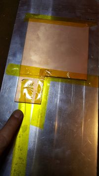

    I corresponded with the author of the original text on Instructable and confirmed that he actually owns the P2500W.
    With the rest how to take a good look at this photo:
    Printing with a laser printer on a PCB laminate
    this is the inscription P2500W, which the rest of the original author confirmed. :D
    while @lukasku told me that there are problems with the photosensitive drum and the possibility of its damage during the "first tests". The new one costs PLN 180.
    I would like to play with this construction, but I need to develop this subject of the drum. What to look for??

    P2500W is the name of the series, so I think that the last digits are only minor modifications, and the mechanism itself.
    while @lukasku told me that there are problems with the photosensitive drum and the possibility of its damage during the "first tests". The new one will cost PLN 180.
    Yes, I modified Panthum 2500 without "W". "W" is a sign of the wi-fi card, which is not needed for happiness and is more expensive.
    I'd love to play with this structure, but I just need to develop this drum theme. What to look for?
    Maybe in the simplest way, the drum is very delicate, (it seems to me that the Lexmark E260 / 460 have much stronger) therefore, everything with a contact must be smoothed and in case of any stop (when there is a PCB in the middle) ) it can not be dragged (this was my mistake), only unfortunately you have to disassemble the toner every time. Of course, this will happen at the beginning / testing of fun in printing.
    Due to the fact that I did not get the Lexmark E260 (that is the second printer from the link from the first post) I bought a Lexmark E460, which I am finishing by myself. I will try to show results in this thread. Greetings.

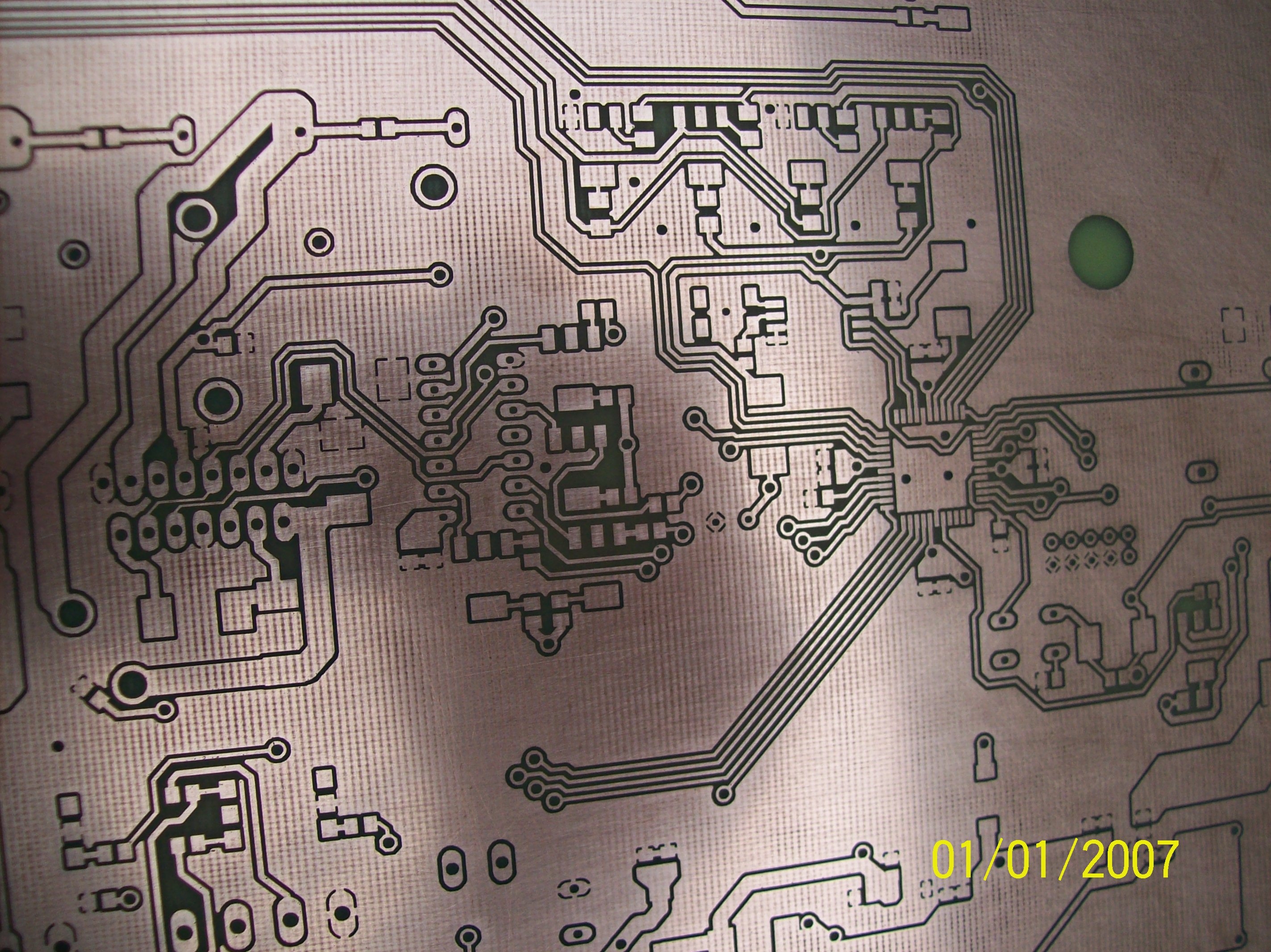

    First print tests with Lexmark (size of the 195x255 board, so almost A4 size)
    Printing with a laser printer on a PCB laminate :

    Show it after picking up how the toner reacts on contact with B327.

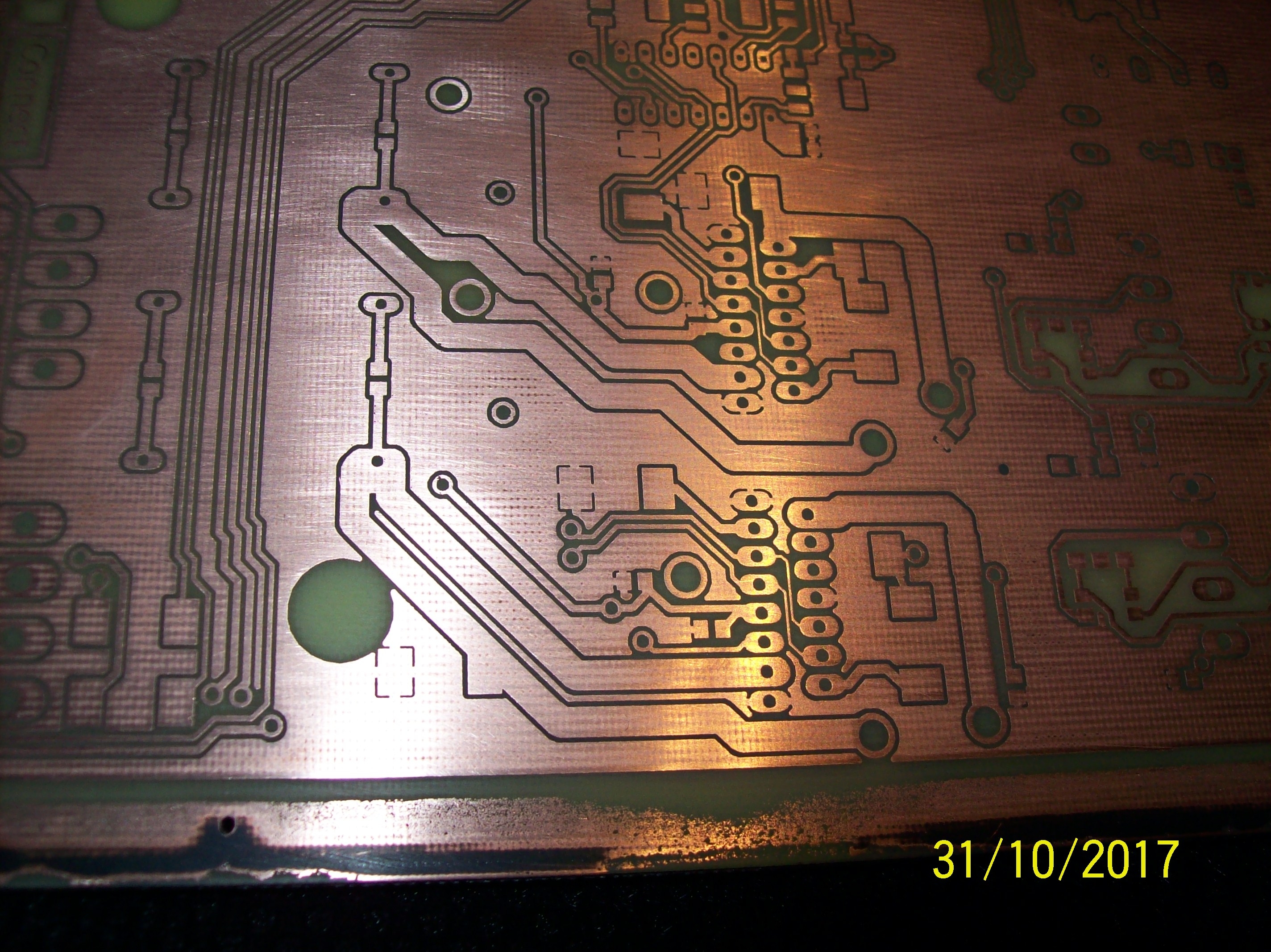

    It's hard to get a good photo with my camera.
    Printing with a laser printer on a PCB laminate Printing with a laser printer on a PCB laminate Printing with a laser printer on a PCB laminate Printing with a laser printer on a PCB laminate
    Double-sided plate, holes are in the range of 0.5 mm, as for me it is sufficient accuracy.

    And you found out what this toner is? Unfortunately, what I have in Samsung ML2165 (D101S) is some kind of stick and I often have clearances on larger copper squares and garnish through it until it starts me already termotransfer denerwować. [/ Quote]
    Did you correct something with a pen before throwing it in the etcher, because the pictures show that the paths are even and not ragged, and in addition large areas of copper are also undamaged until it is impossible that such a good toner is not bitten.
    Pozdr.
    I do not know what kind of toner, because I bought this printer about 5-6m ago and the company I bought in does not speak (maybe it does not exist anymore). I am not a chemist, but who knows whether the cause is not in some degree also the primer, or silicone (maybe react with each other). I did not have too much time and the problem with buying xylene in my area, so far I do not know the solvent.
    As for the correction, they were corrected (not counting the sides, because I wanted to widen the circuit on the perimeter of the plate), in three areas (approximately 2x3 cm), but because a bit less toner left them in the drum (I did not want to let go print again) and I preferred to improve the pen for sure. I print the printout and sometimes it is so that the dust-bound dust (these are microns, but under the light) looks like the uncoated copper surface. There were many such eyes (dust), so I took the risk of etching to see one hundred percent, whether it is connected to dust as I wrote earlier, or not the toner (luckily, my assumptions have worked). In general, if only the print is even, there are no problems with undercoating.

    I have a question, or rather a request for help.
    I made Lexmark e260D sublimity in accordance with with this tutorial or at least I think so.
    The printer takes a plate, but unfortunately there is not the smallest trace of toner on the copper. Nothing, nothing.
    Does anyone who did this modification have any idea what a mistake it is?
    Under this link film with printouts
    And a few photos:
    Does the tape (tape adhesive) conduct electricity? There are two options, either the board (software) does not fit in the time window (especially the emulation of the second sensor), or you do not dissipate the static energy from the board (although in this case there should be some traces of toner). It's also possible that you can not fit into times because you choose bad paper. I do not know what should be in the tutorial because I wrote myself, but try, for example, foil instead of plain paper. And so most likely to my eye, you do not turn on the sensor of the second marked in the tutorial "pis". Check the cables again and see if uC works.

    And here the accuracy of both sides of the double-sided disc
    Second page
